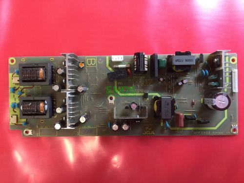

lcd tv TOSHIBA 32AV500P inverter board MPF3002 (PCPF0207 77C)
  • ANDRASONI LUCIAN
    • May 2012
    • 56
    • Romania
    I have this problem TV on the inverter module with the above code. It accepts the BL ON command voltage, but so much. Initial was defective Q50 = 2SK2837, after replacing it normally worked, then stopped with the current sound without the backlight . It is equipped with BD9766FV, FA5501A, 2904H212, RM601. The plate is quite "bushy", difficult to follow without a schematic. On somewhere I saw it would be equivalent to DPS-165GP (JQ10003), but it does not look like.

    Re: lcd tv TOSHIBA 32AV500P inverter board MPF3002 (PCPF0207 77C)
    You could probably try replacing the original inverter with a universal inverter if the CCFLs are good and if they are not good convert the CCFL backlights to LED backlights.
      It can not be, because it is not a simple inverter, and the power source (with PFC) for the inverter is also included Thanks!
        Did you check the fuse on the inverter?
            ... of course, but I've been through this for a long time,Thanks.
            I also saw the service manuals on "elektrotanya.com" I'm sorry!Thanks!
