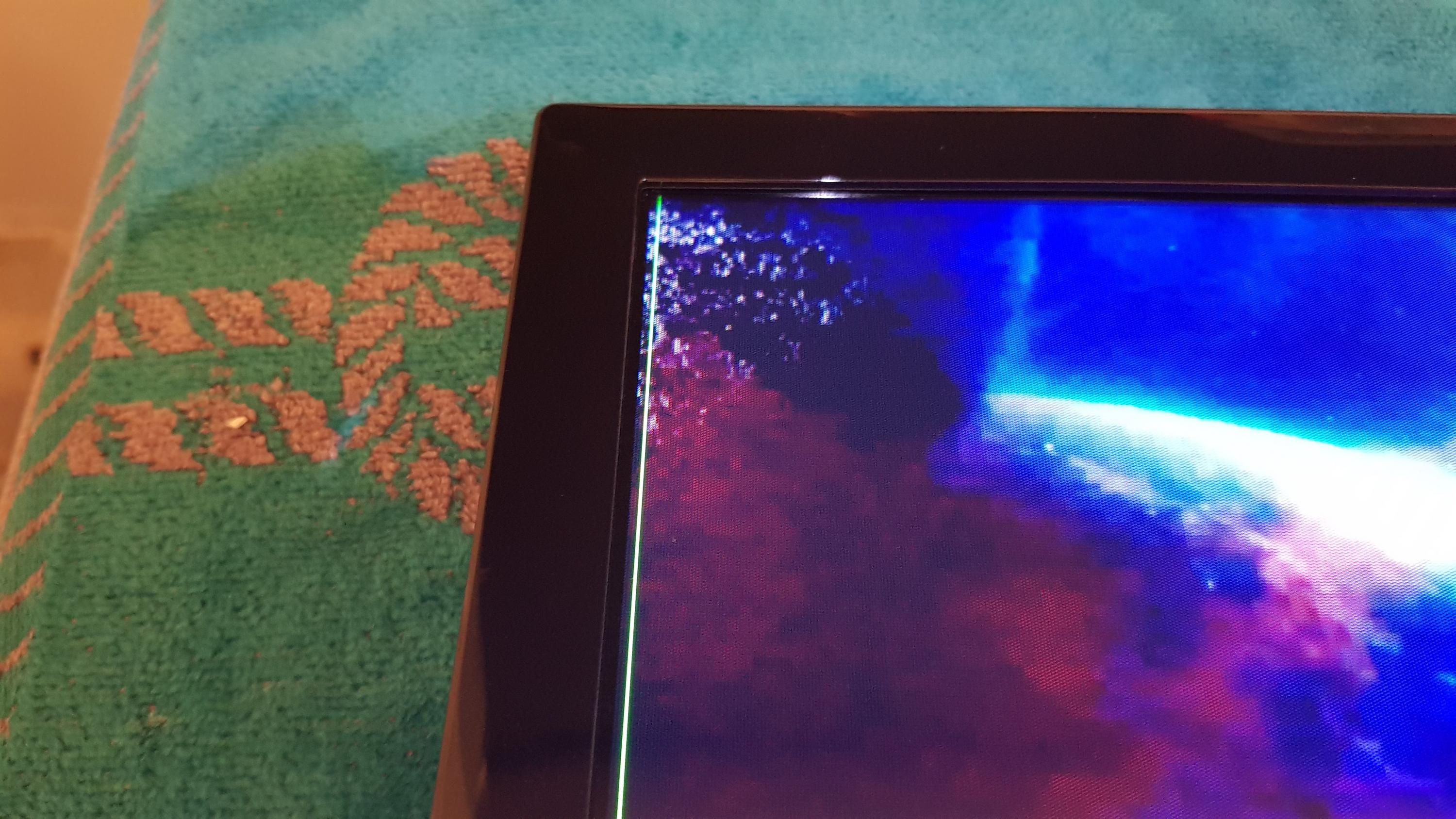

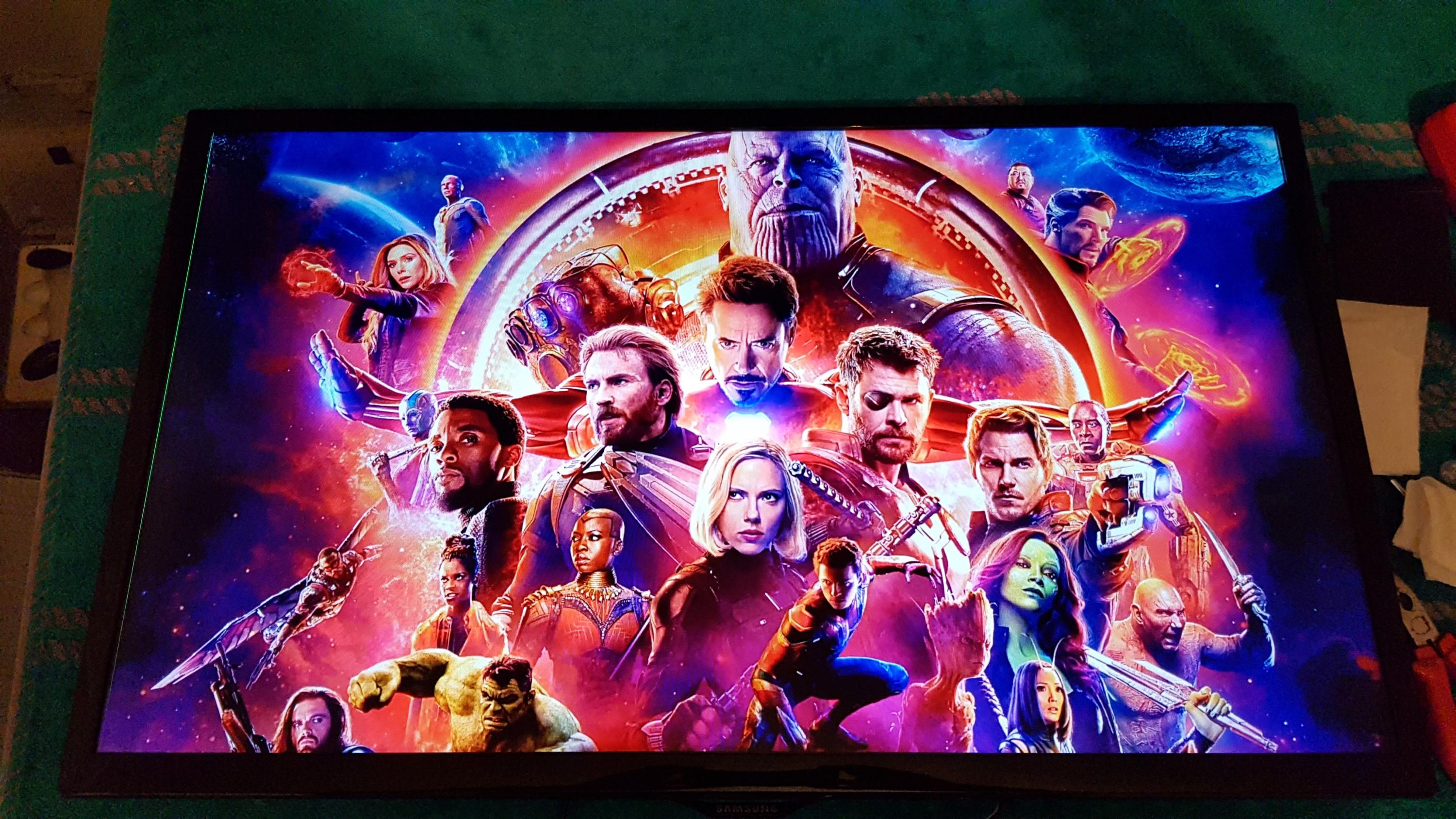

    Hi all this should be a quick one. I have a 32" Samsung with a pixel width vertical green line on the left hand side. The line fades out towards the bottom. It appears a couple of minutes after startup so not from cold. I've poked around and manipulated ribbons and such, and nothing has any effect on the line.

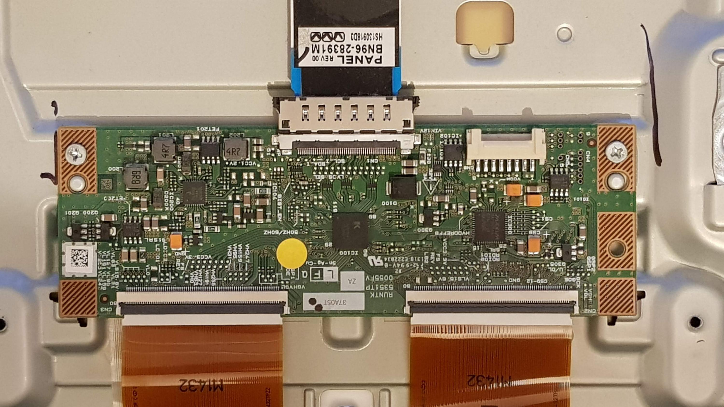

    If I remove the left side tcon ribbon, the left side of the screen is completely white and no green line (to be expected?).
    I'm guessing the LCD in a goner? A tcon fault won't create a single line will it?
    tcon = 5351TP0055FV

    Does anyone think it's worth trying another tcon board?

      Panel problem.

        warm the left corner up with hair drier and see if this line disapear

            NOT T-CON Bd. problem. This is definitely a PANEL problem.
