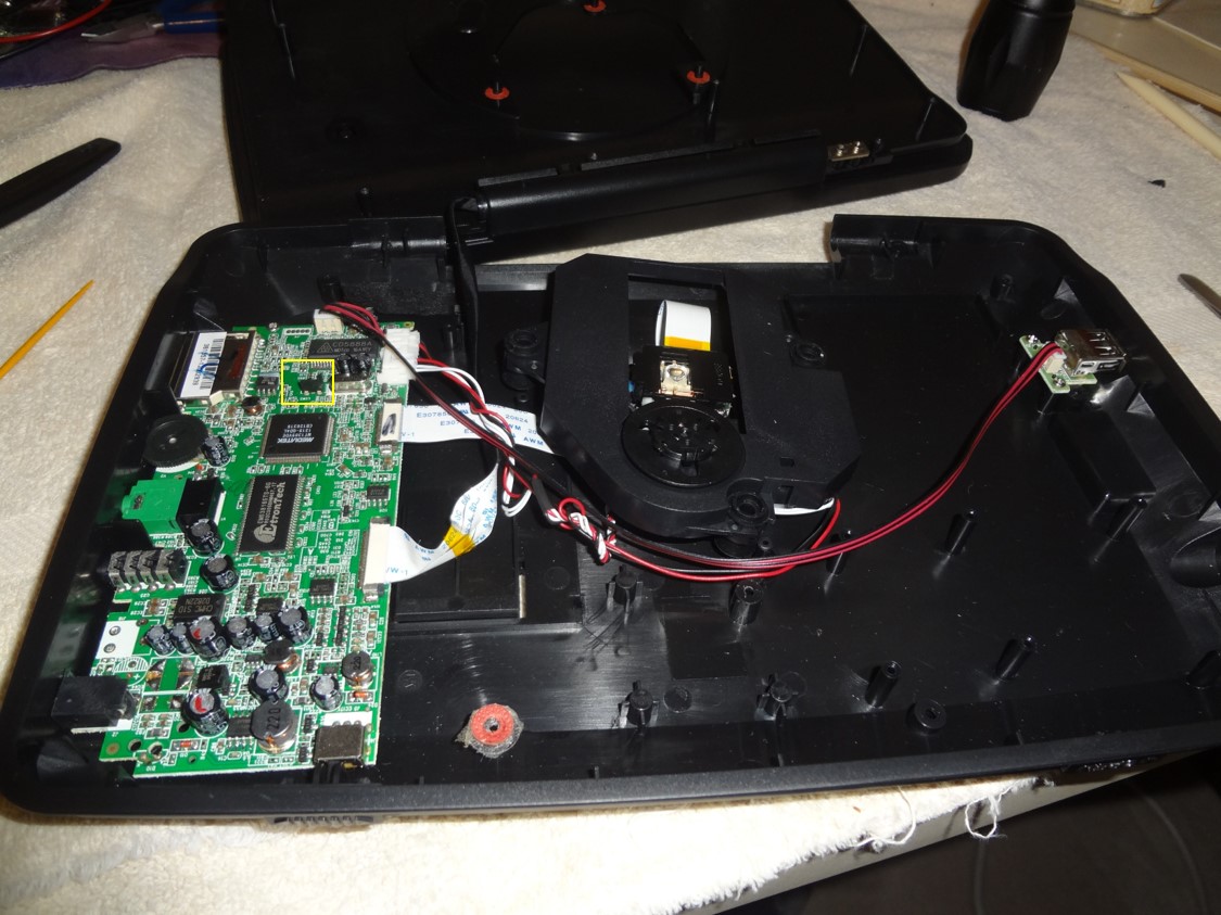

    my issue is this. i have two ematic portable dvd players i bought for my kids to watch in the car. They used them maybe two times and then both units quit working.

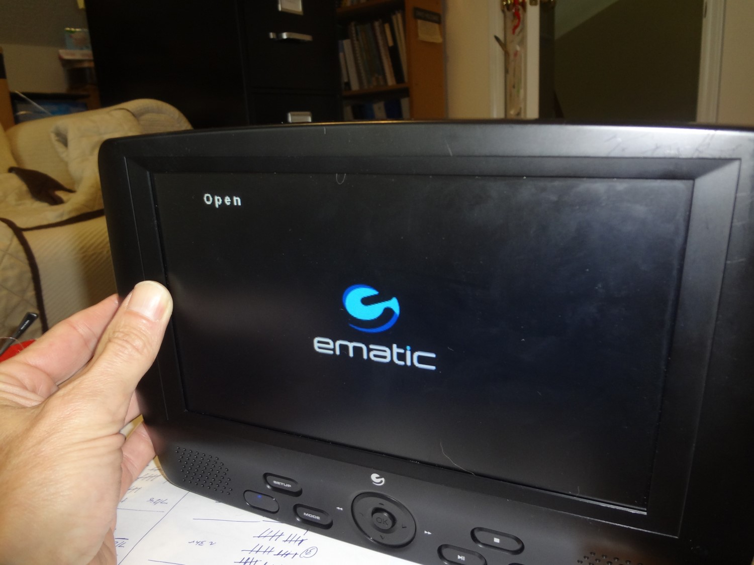

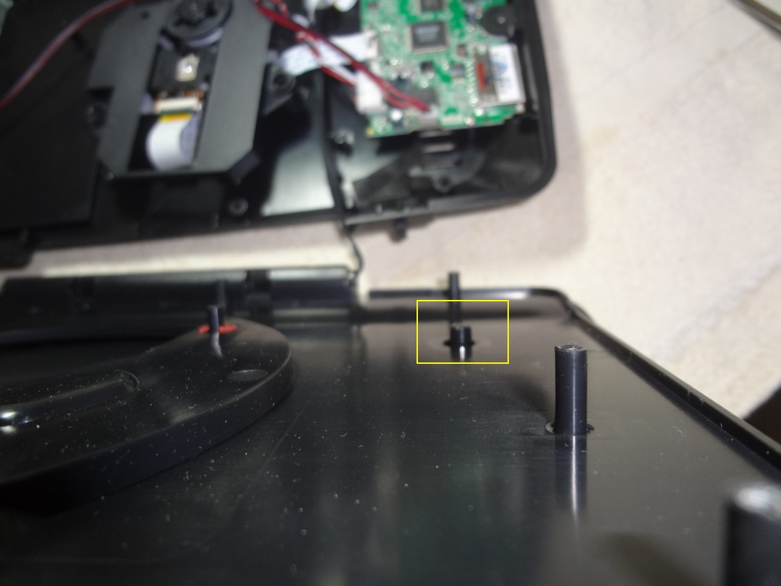

    Basically you put a dvd in the unit and what you see is what is shown attached picture "5_open_error". Bascially, unit thinks the "lid" is open so it wont play the dvd.

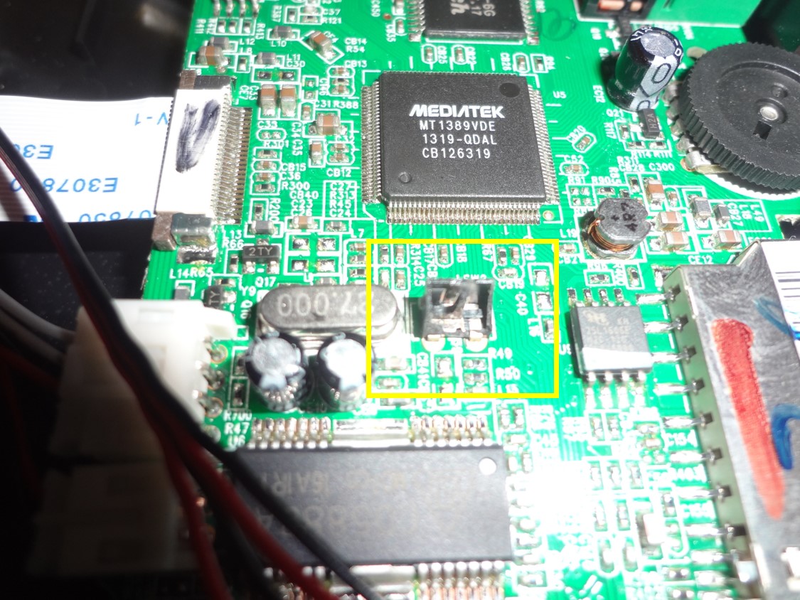

    I opened the dvd player and i noticed a round-peg type thing that goes into the guts of the dvd player when i close the lid (see picture "2_Round_peg_1"). So i now went into the "guts" of the player and found where the round-peg made contact (see picture "3_pic_of_board1"). I put a yellow square box around locationwhere round peg makes contact.

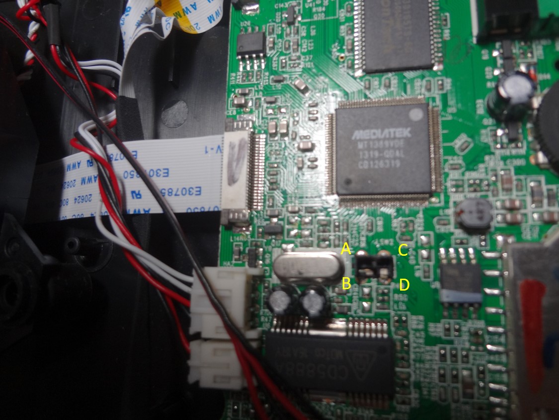

    i then zoomed into the location where the peg makes contact (see picture "4_pic_of_board2").
    If you look at the top-down picture you can see 4 terminals. A and B are shorted. C and D are shorted. There does not appear to be any connection between groups A,B and C,D. I dont see how the round peg has any influence on this item to let unit know that lid is closed.

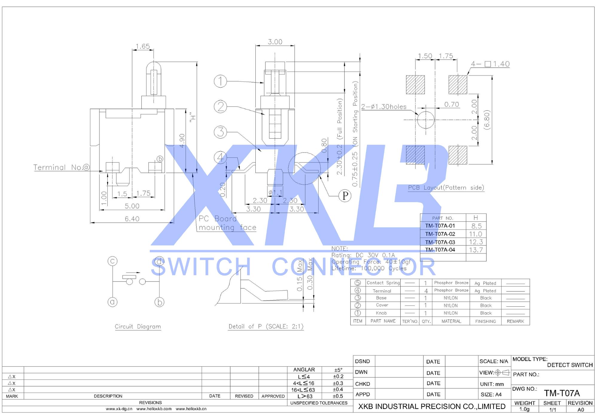

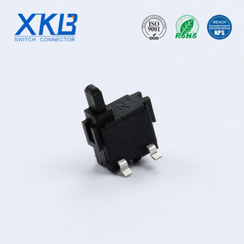

    Looks like the switch is broken and part is missing, it is just a spst surface mount switch and the small plastic acuator part is broken.

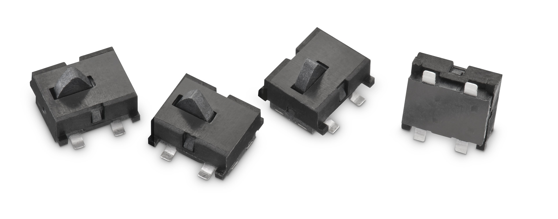

    It may have looked similar to this?

        They use 4 connections just to mount the switch ab are common cd are common the switch is normally open, when the door is closed the switch shorts a to c
        To repair it properly you need to replace the switch.
        The rest of the broken switch was likely somewhere inside the case.
        It may have looked like more like this one https://www.alibaba.com/product-deta...736028590.html

            If you can find the rest of it (or another one from other unit) measure the dimensions, then look at digikey etc. Likely will need to come from China
