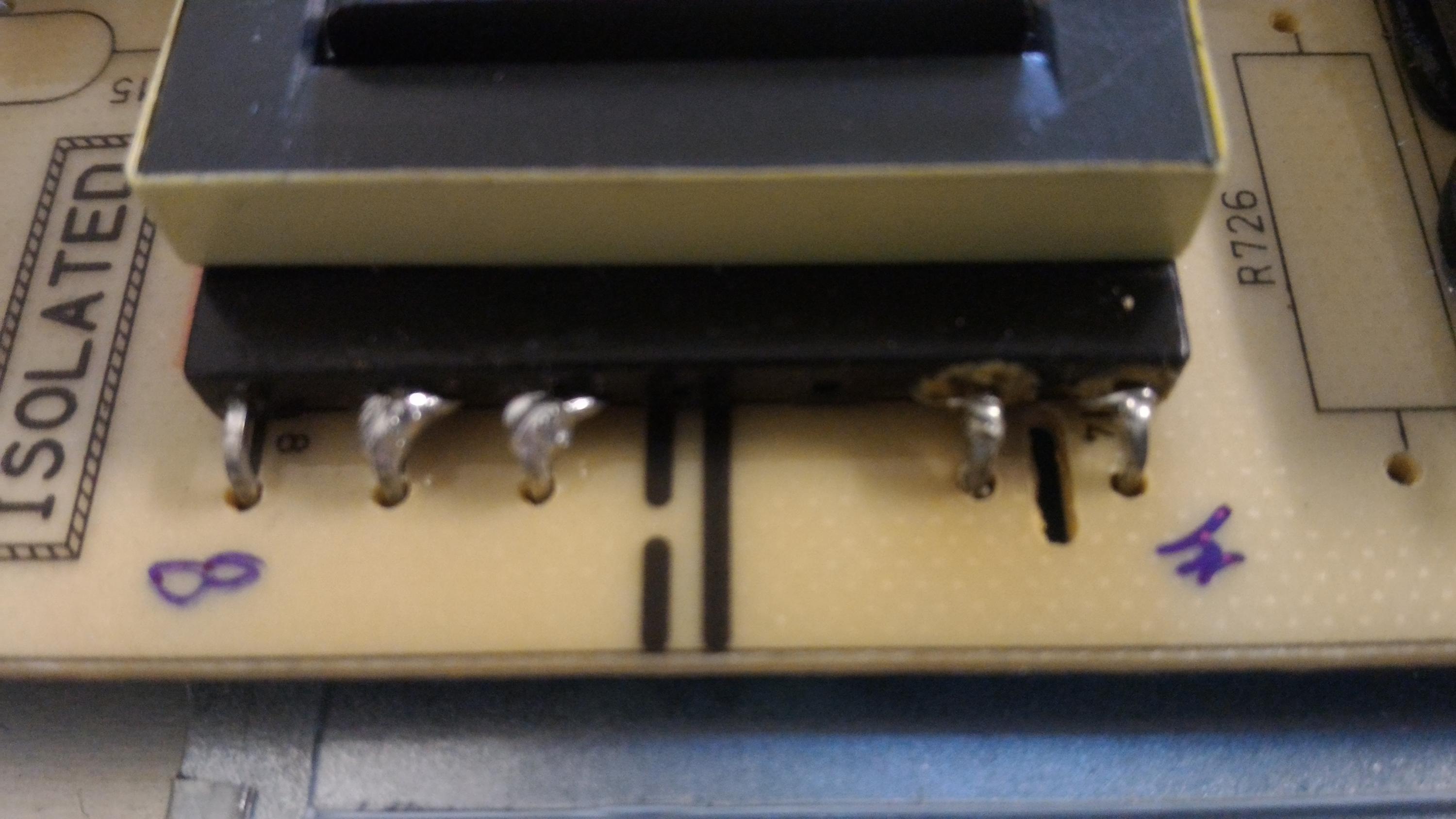

    Got a Toshiba 22EL833G with Vestel 17PW05-3 PSU - TV powers on, sound OK, no picture or backlight.
    With PSU disconnected - humming/pitching sound on transformer
    PL706
    Pin 1 - 20.8/22.5
    Pin 3 - 0V
    Pin 4 - 0V
    PL703
    Pin 7 - 11.25V
    Pin 9 - 5V
    Pin 11 - 5.5V
    With PSU connected to other boards, on boot - horrible pitching/screaming sound on transformer
    PL706
    Pin 1 - 20.8/22.5
    Pin 3 - 0V
    Pin 4 - 3.3V
    PL703
    Pin 7 - 11.25V
    Pin 9 - 5V
    Pin 11 - 5.5V
    With PSU connected to other boards, ON state - transformer silent
    PL706
    Pin 1 - 5.5-9V
    Pin 3 - 3.1V
    Pin 4 - 2.2V
    PL703
    Pin 7 - 11.25V
    Pin 9 - 5V
    Pin 11 - 5.5V
    C371 - 11.25V
    C735 - 29.6V

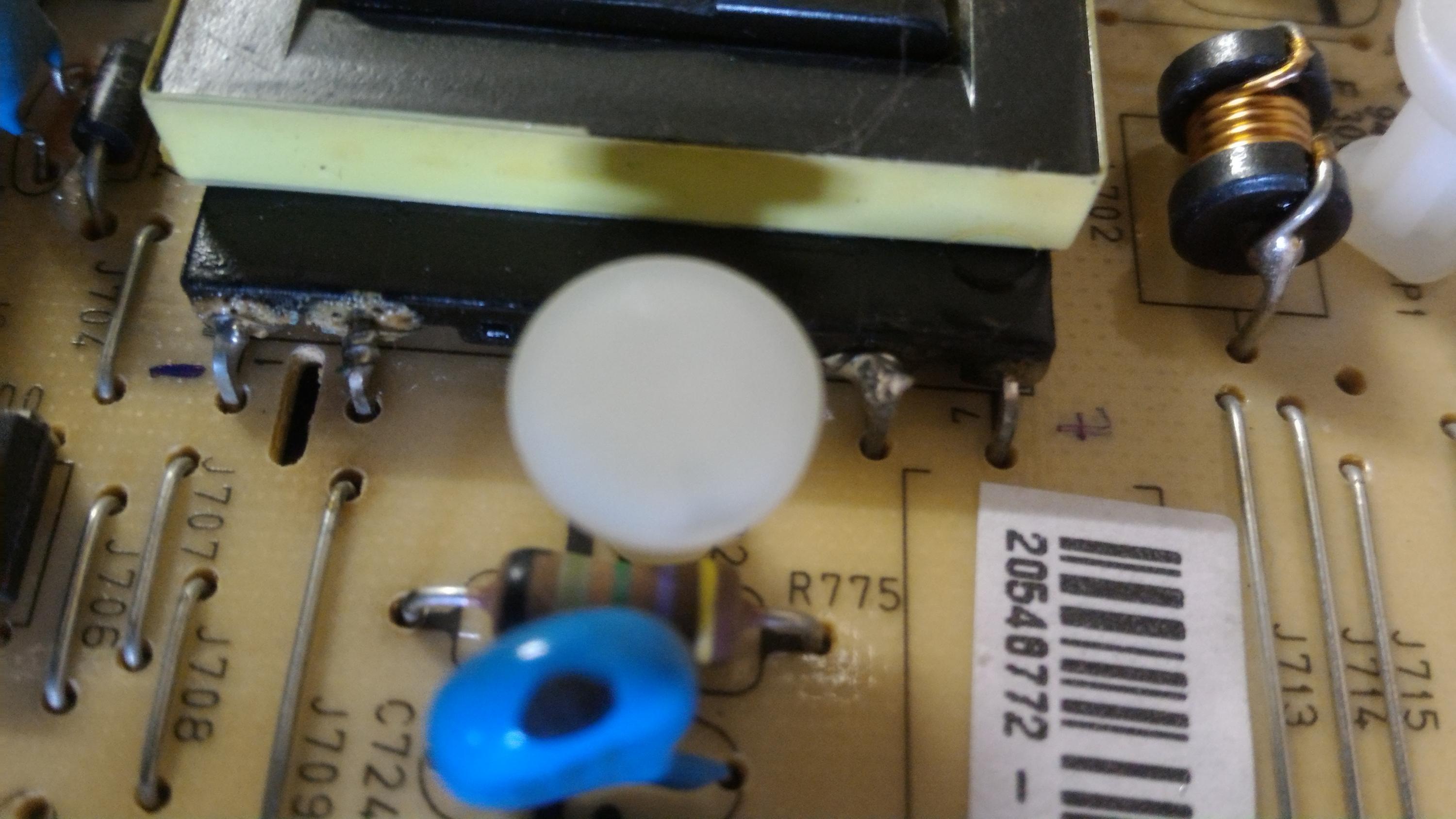

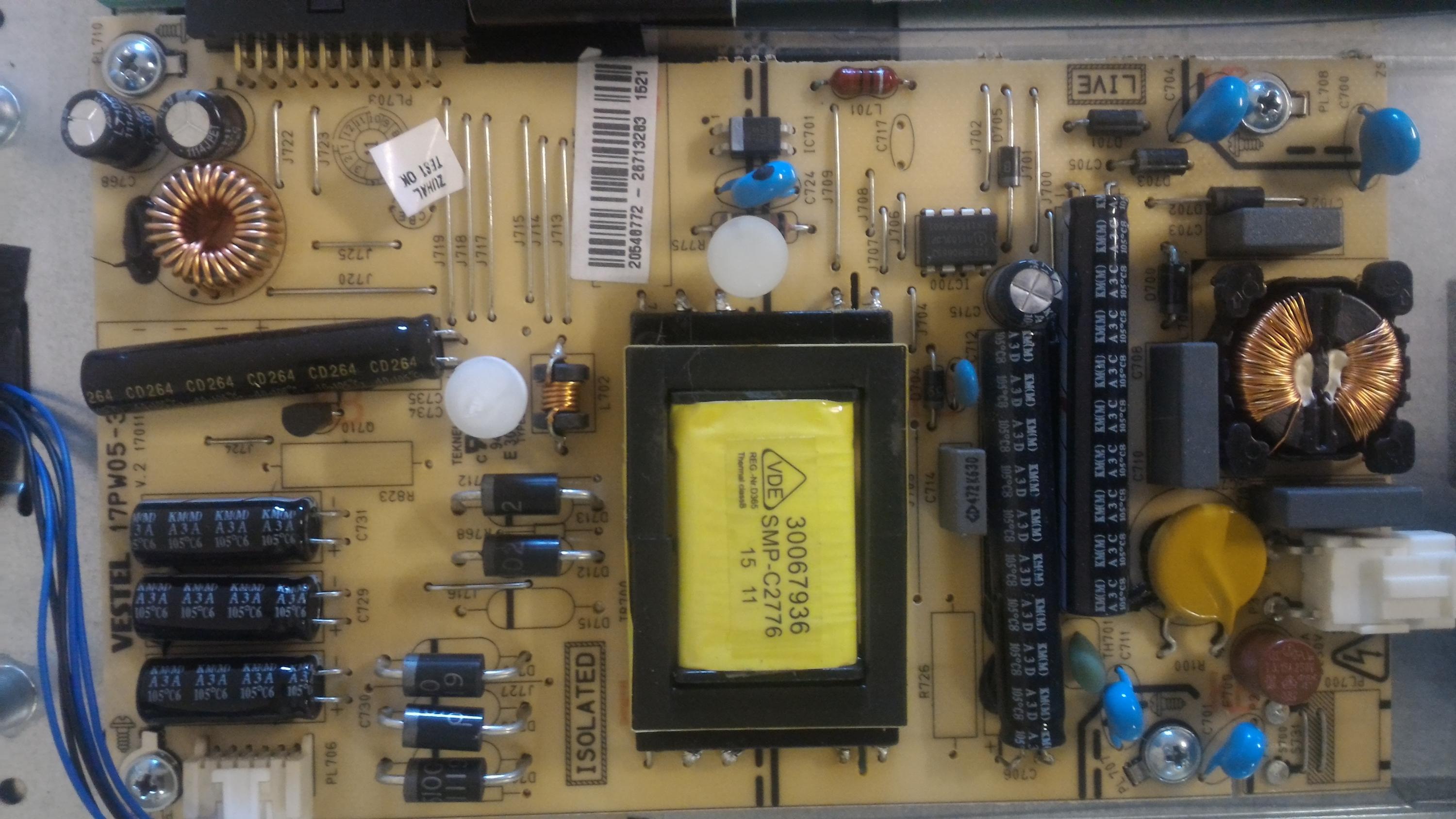

    No visible damaged on boards besides transformer pins (see picture)
    No shorts found between transformer coils/ferrite, no shorts found on diodes, transistors or capacitors
    Small differences from PSU schematics:
    IC700 not ICE3BR1765J but ICE3BR10665J
    D715 not present
    D712 and D713 not UF5402 but SB5100
    C734 not present
    I'm missing the obvious or could it something else?

    Seems like you have a HV Transformer short and/or bad CCFL causing this problem.

      The obvious them. Ordered a new transformer, will update when it arrives

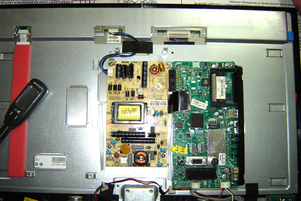

          Is this what the WHOLE back of the tv looks like? If it does I believe there is a led driver board under the tin.

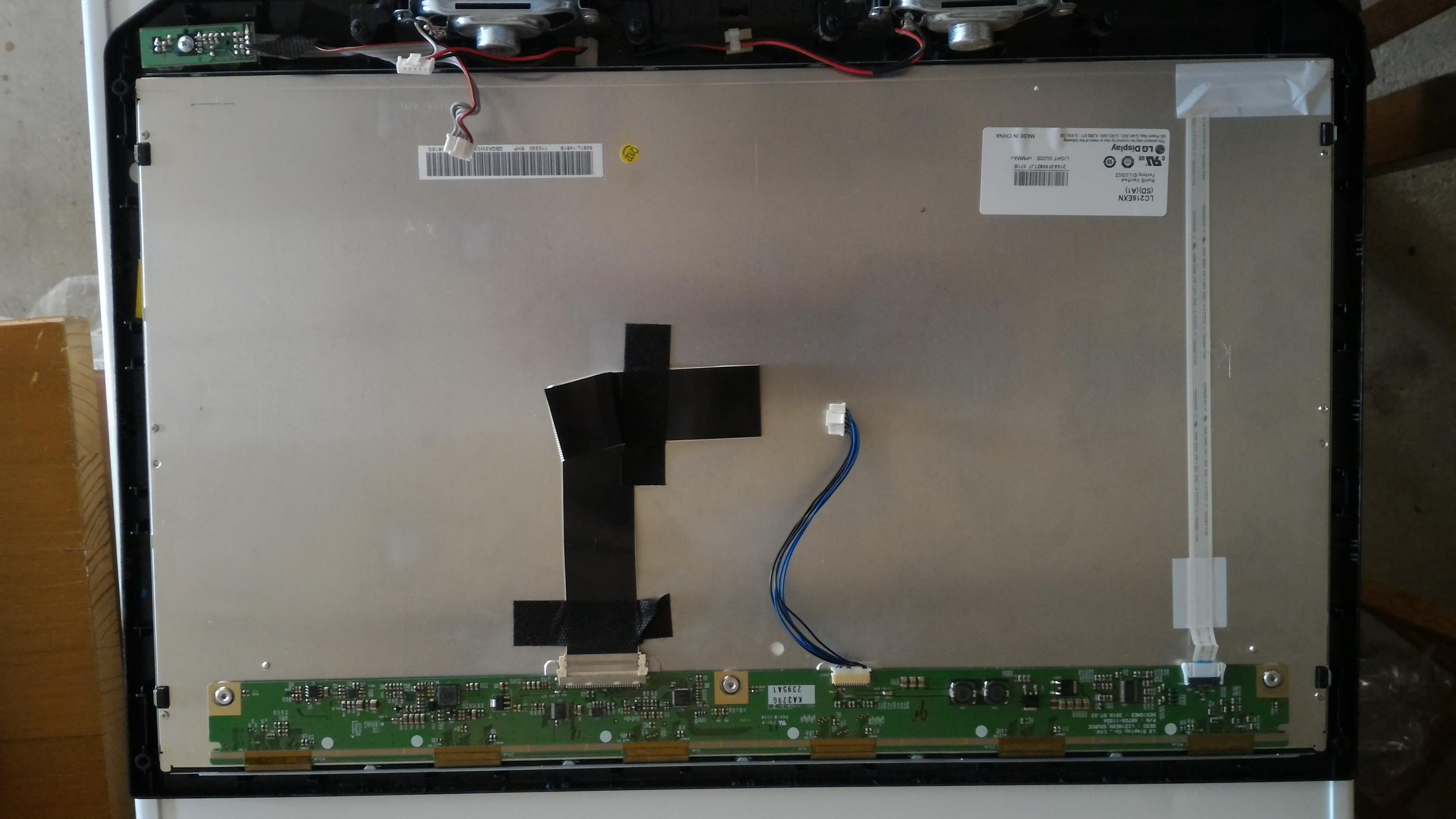

              Yes it is. Will post a picture of the whole back with cover of asap

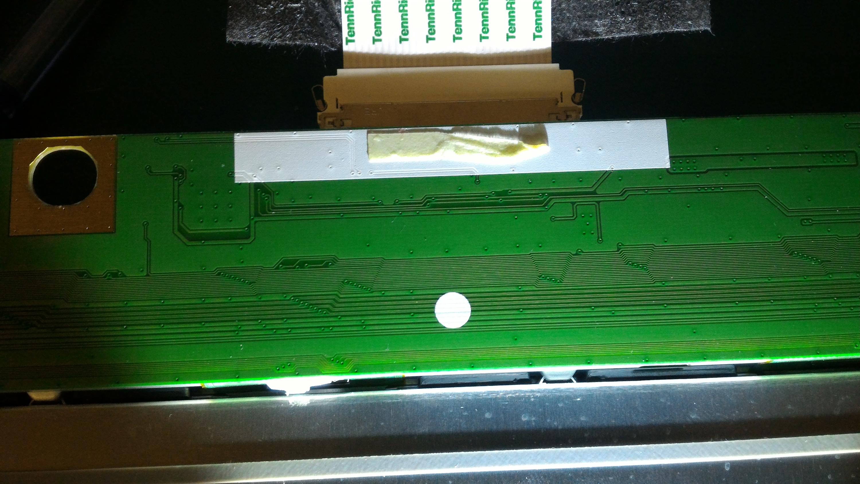

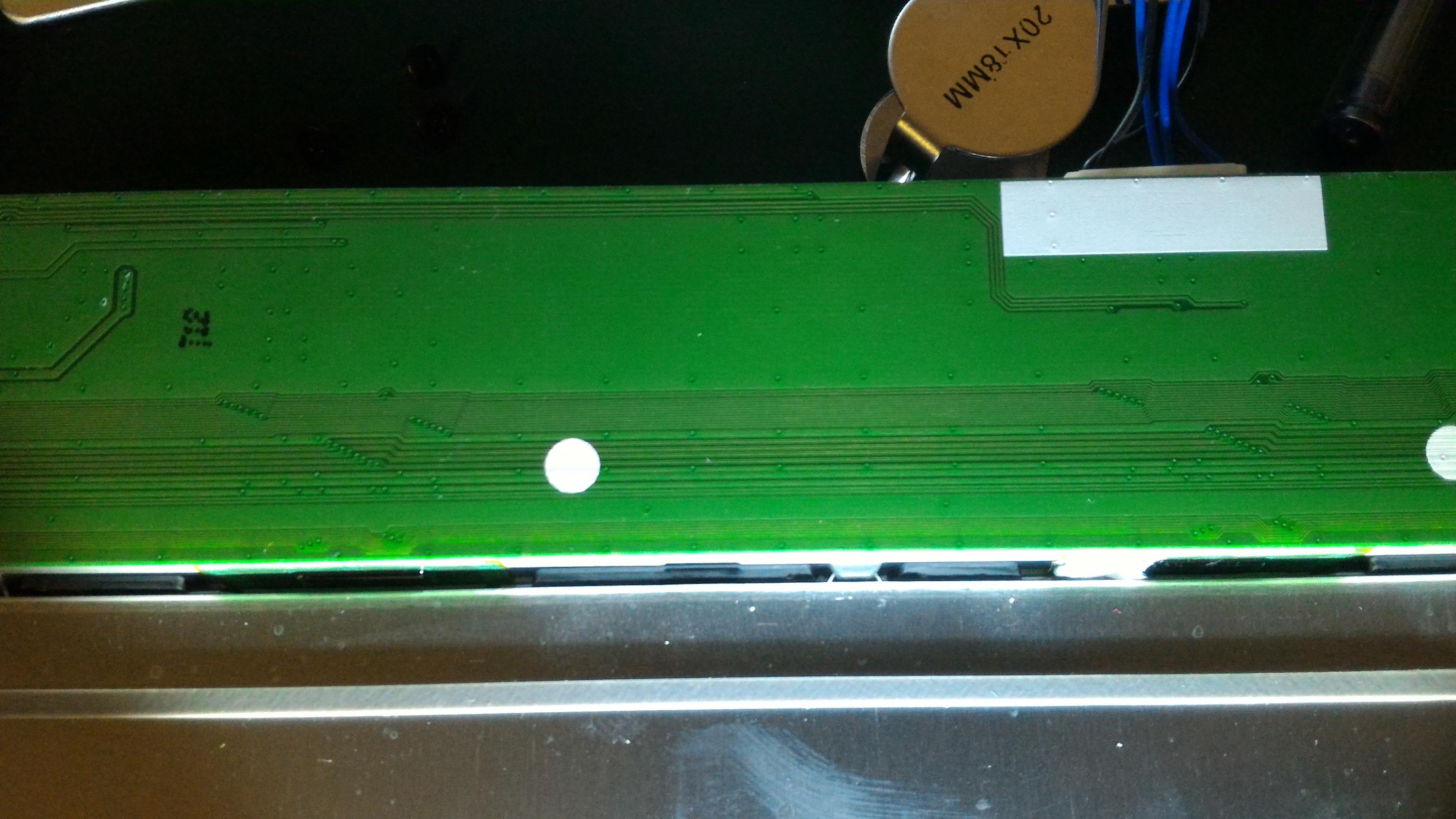

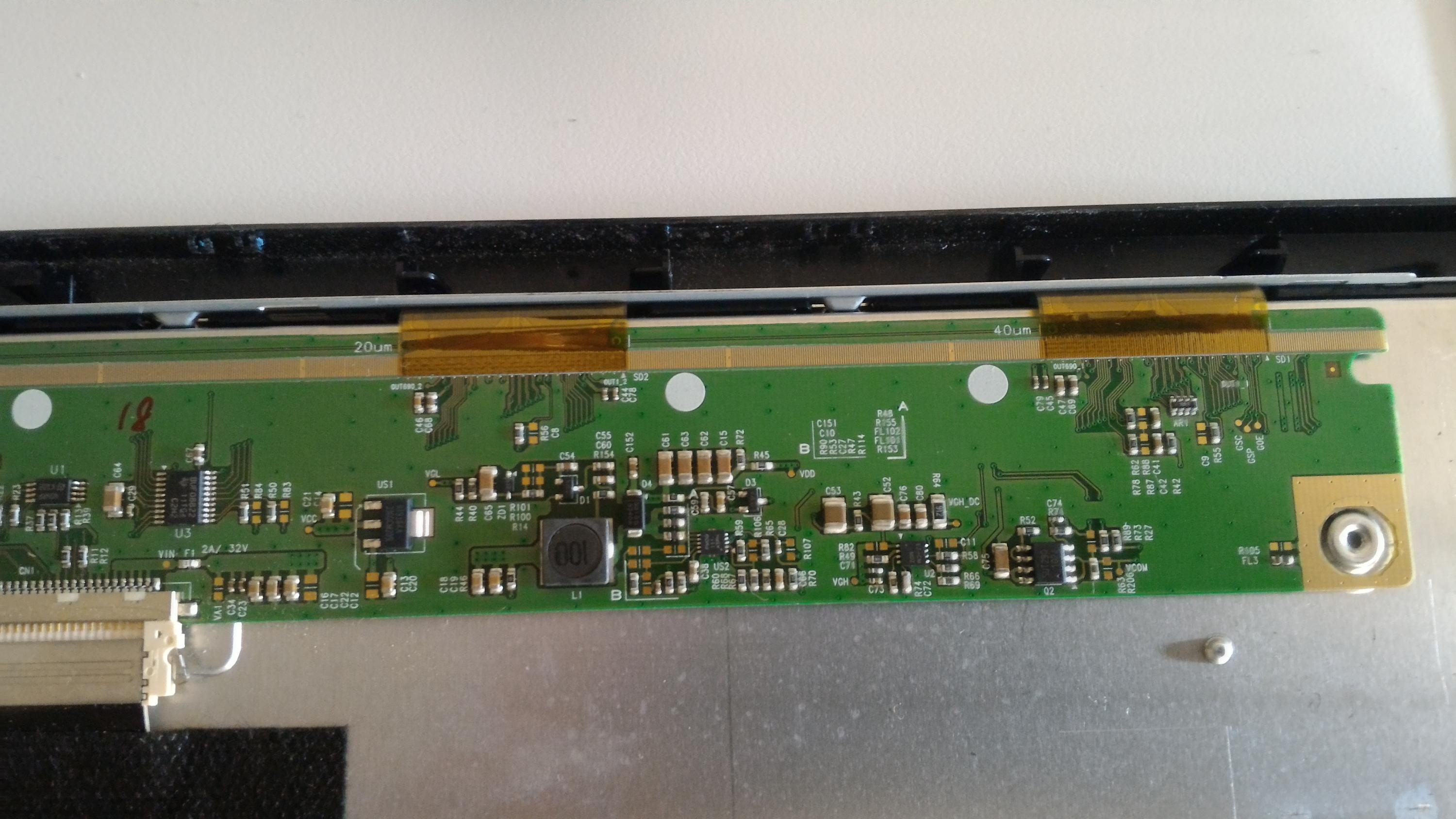

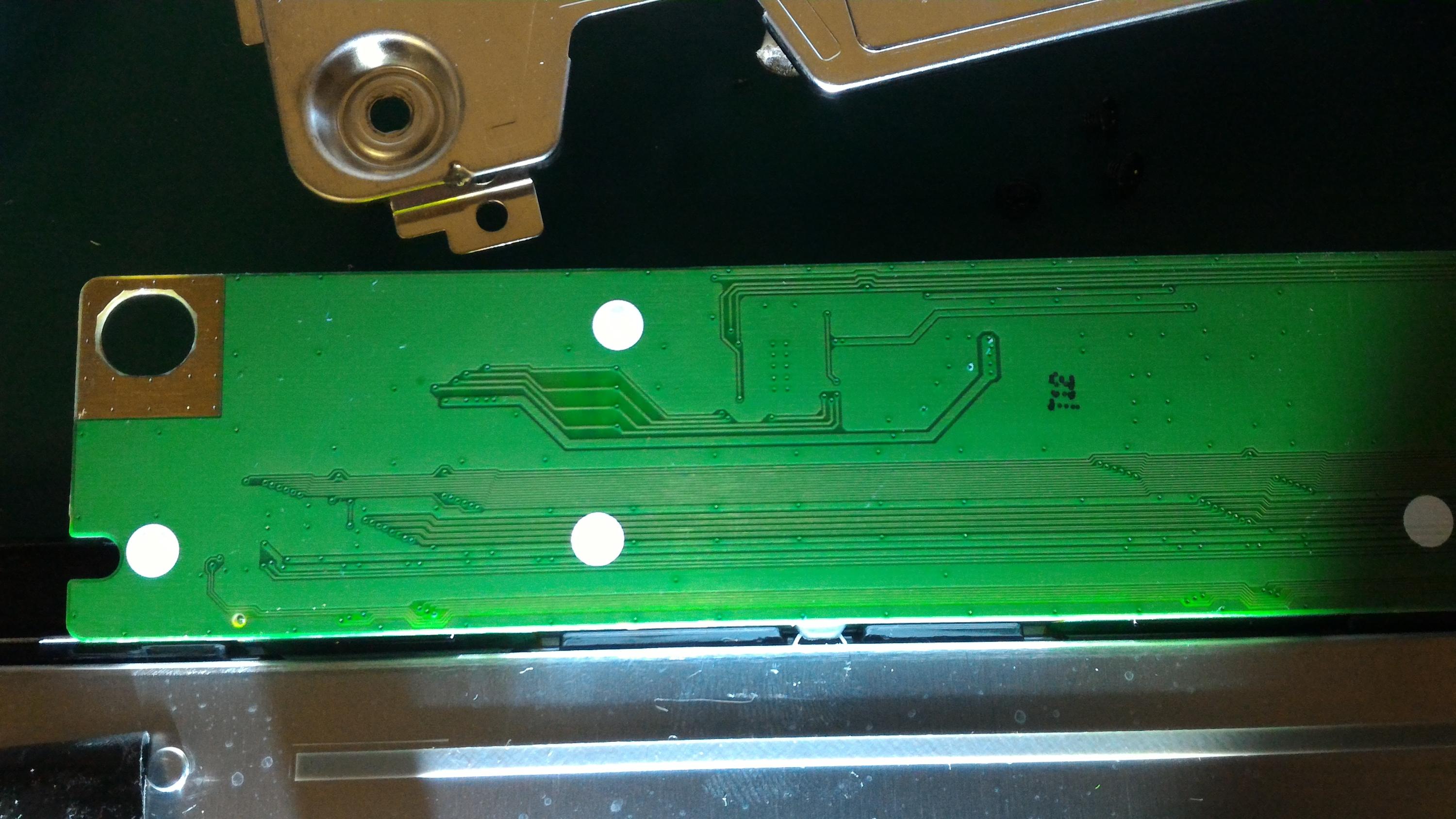

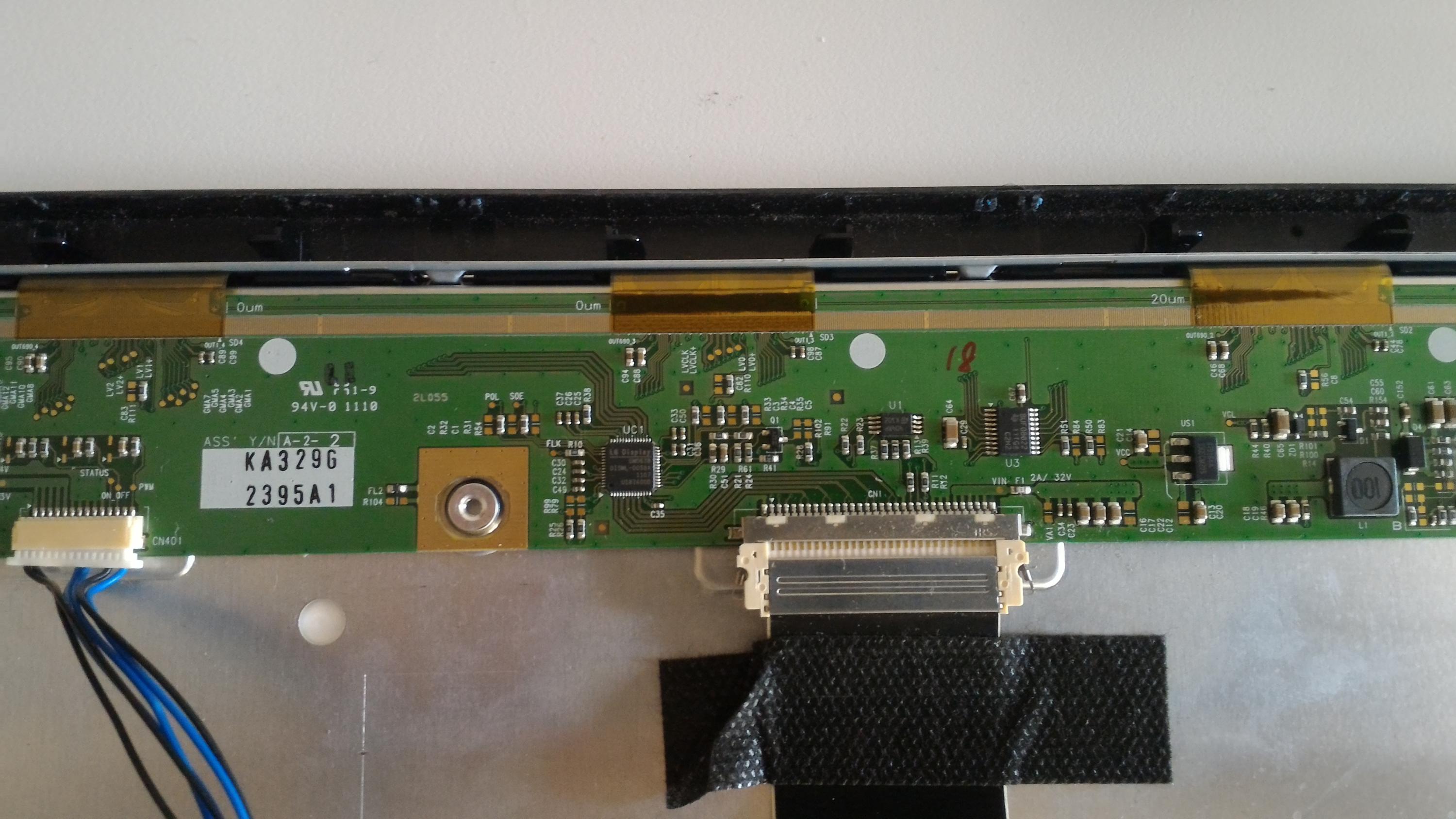

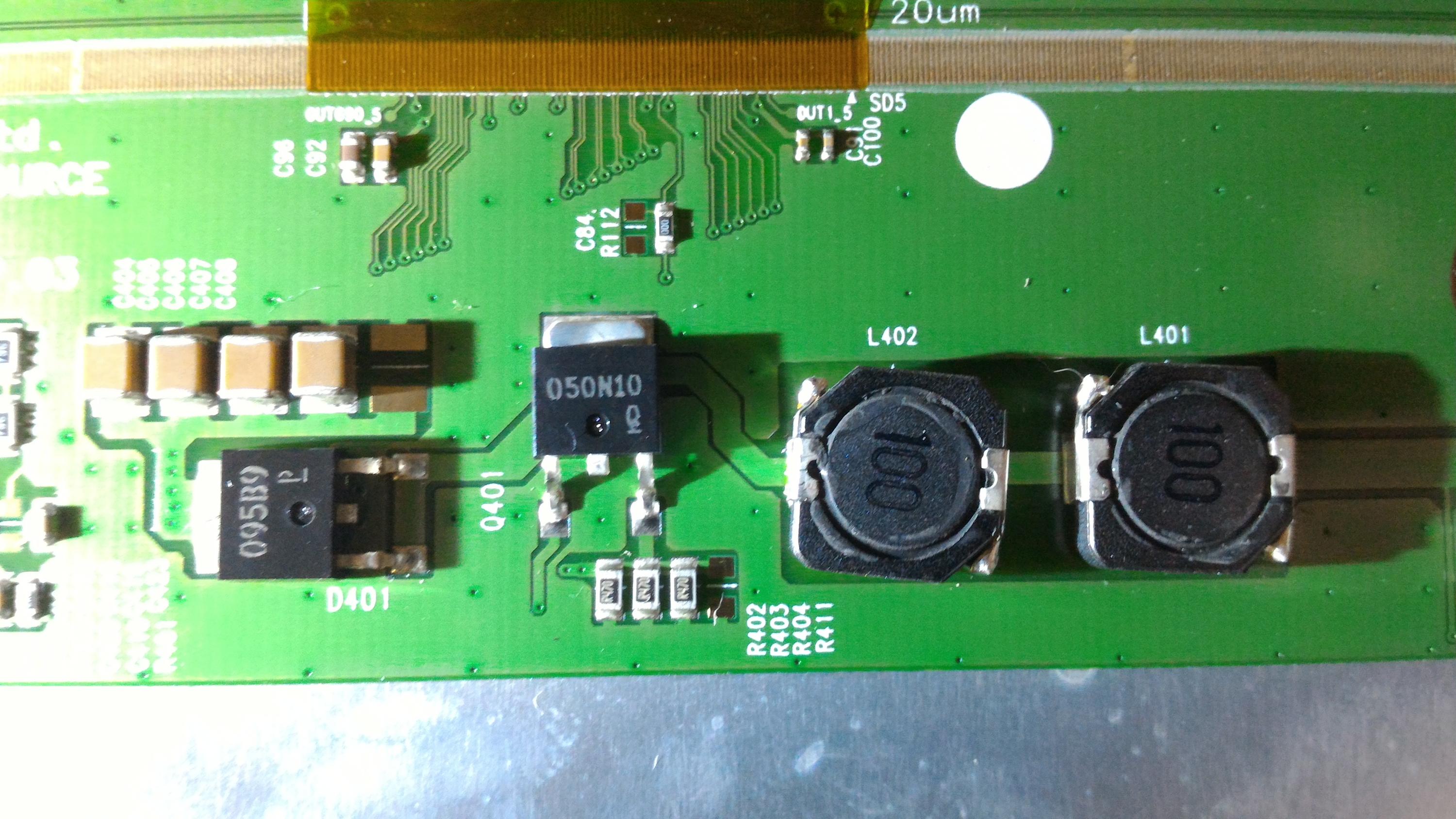

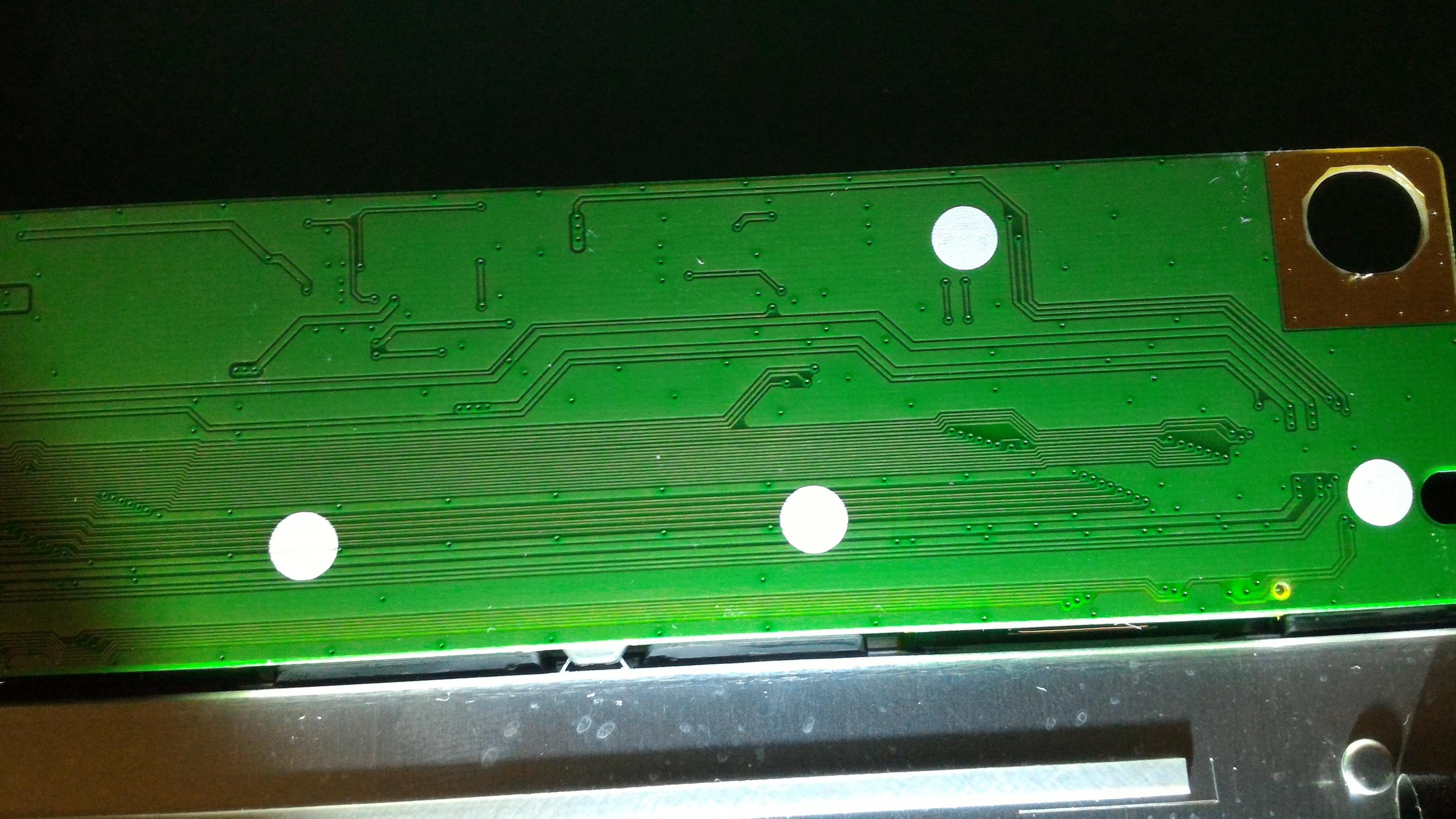

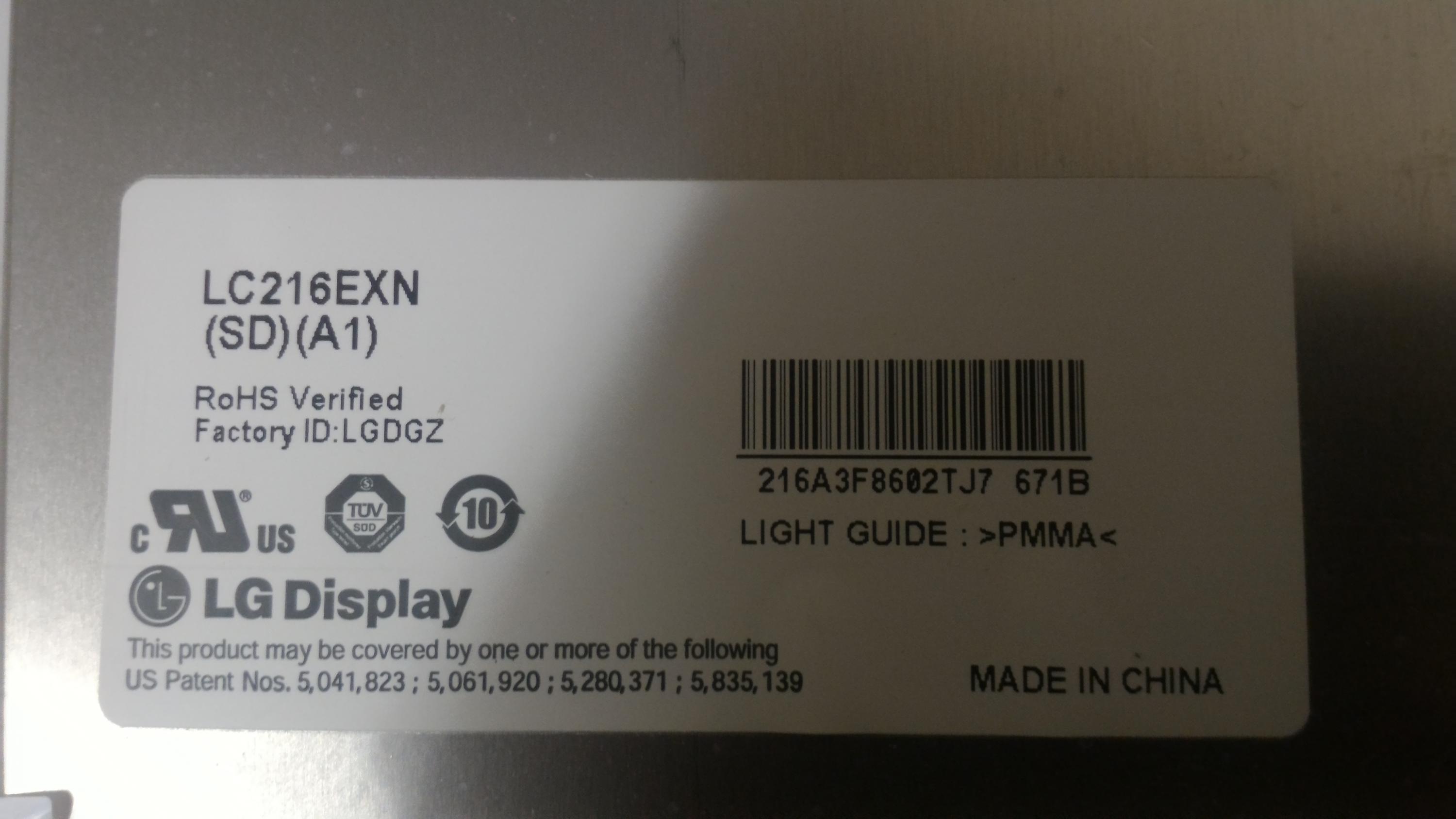

                Here they are
                Premium supporters get full download access and other benefits.
                • Andrew F. Ali
                  • Jan 2014
                  • 2450
                  • Trinidad & Tobago
                  • Electronic Repairs
                  Re: Toshiba 22EL833G with Vestel 17PW05-3
                  So this is a LED TV after all. I was expecting to see pictures of the Main Bd and PSU on the TV also. I was thinking HV Transformer that supplies the CCFLs. Guess I guessed wrong. Those voltages, though not spot on to what the legend says, are good. Look for cracks in the soldering especially the Transformer legs. Test the ESR of those e-caps. Tighten the boards hold-down screws.
                      Tested all ecaps ESR, all seems good, replaced anyway
                      The C375 24v rising to 29v when PSU is connected and PL706 Pin1 dropping from 22V bellow 9V seems good?

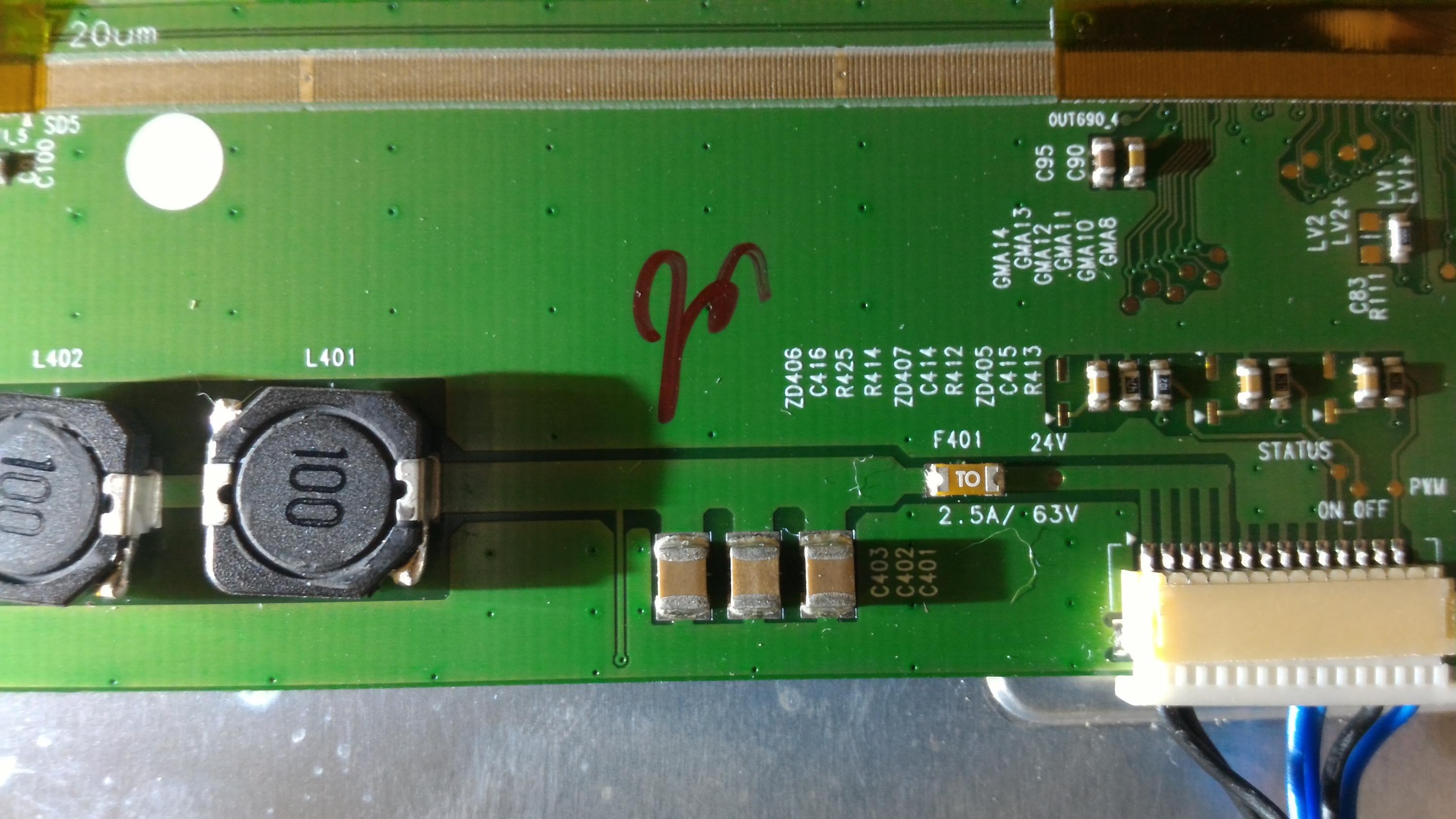

                        Check F401 on that top board, It might be open (2.5A/63V) Looks like thats what supplies the 24 volts to the led driver, That would also explain why 24 volts is a bit high, no current being drawn.
                          Fuse is good. Can't find any shorts on transistors, diodes and capacitors either

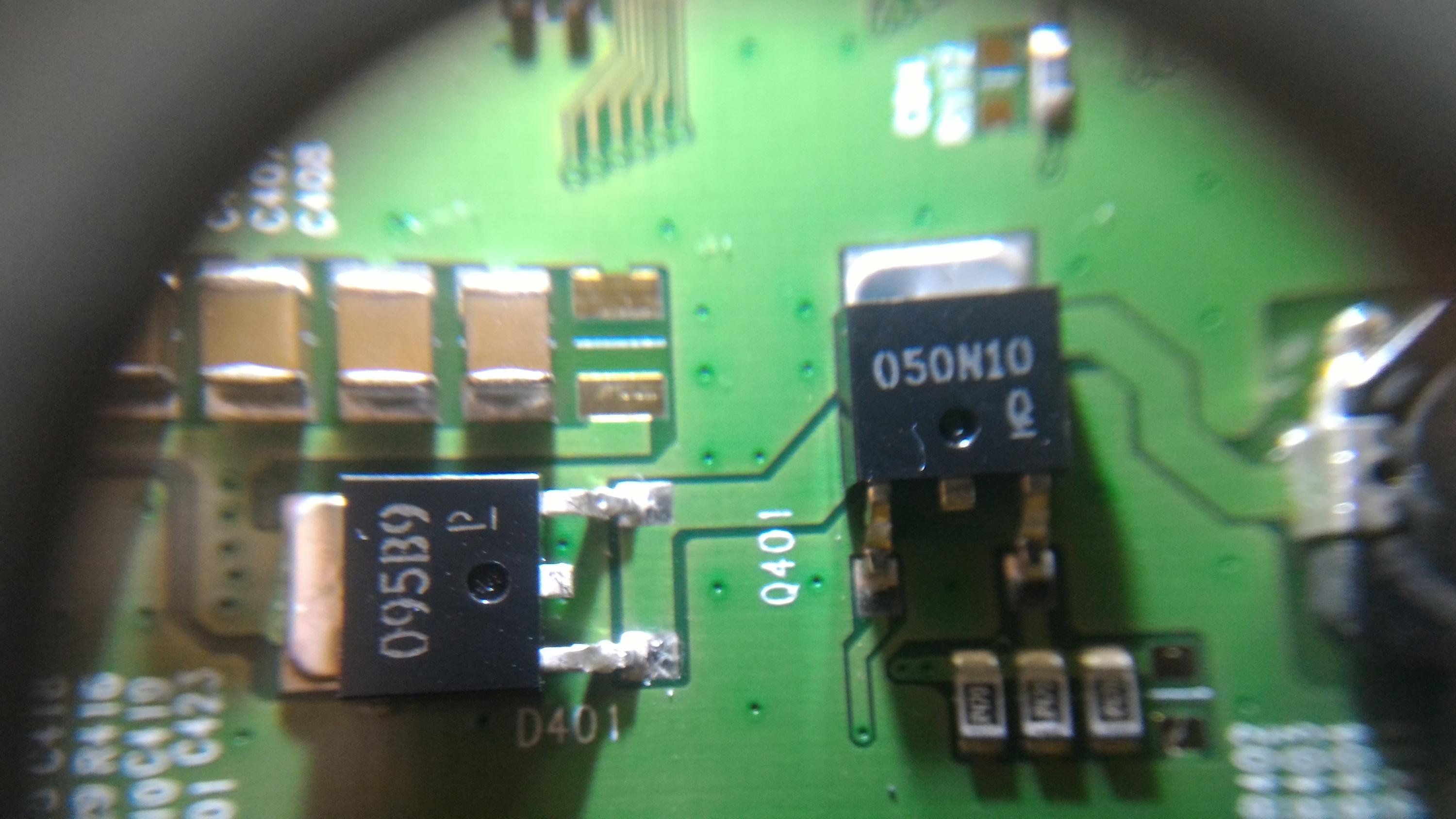

                            Have you ever tried shining a flashlight or other light at the screen to see if there is any video on the screen? you may need to press the menu to get something, It does seem like there are no backlights and you do have the BL_ON signal on PL706(3) I would check the voltages on the pins for the backlight leds, CN402, (the thin white cable)
                            Did you also check F1 (2A/32v) on that board? that fuse supplies voltage to the t-con part of that board.

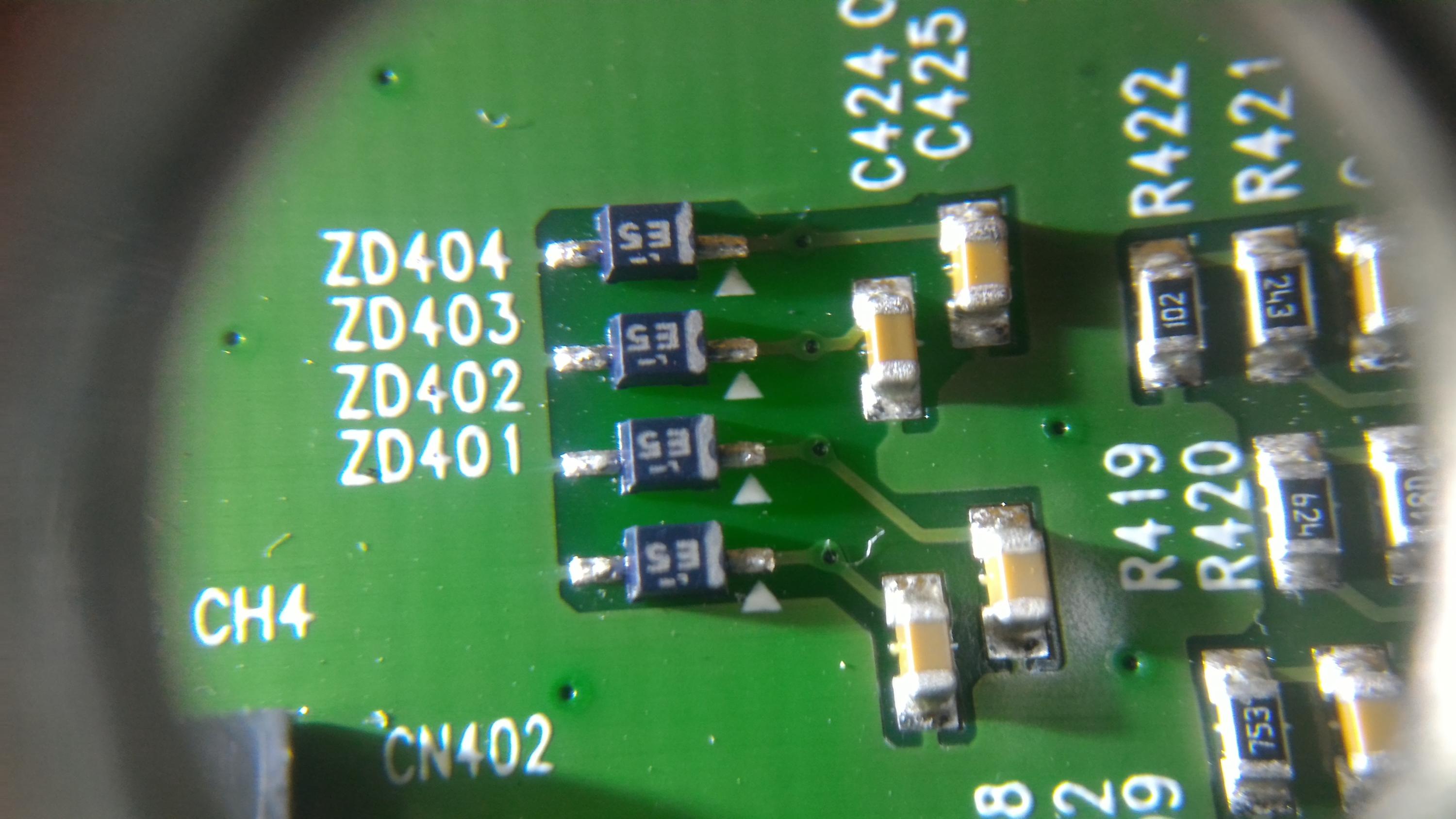

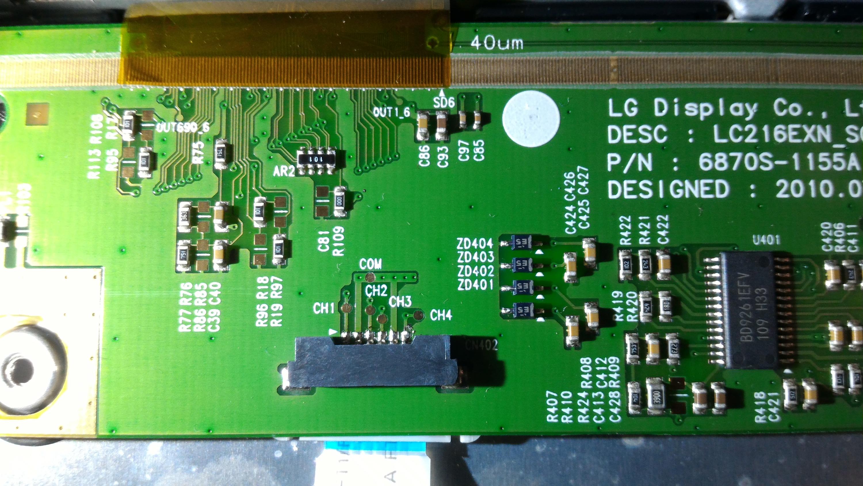

                              CN402
                              CH1 - 3.5/4.5V
                              COM - 5/7V (?)
                              CH2 - 2.5/4V
                              CH3 - 2.5/4V
                              CH4 - 3.5/4V
                              PL706 Pin 1 - 5.5/9V coming from PSU shoudn't be 12-24V?
                              Fuse F01 is OK

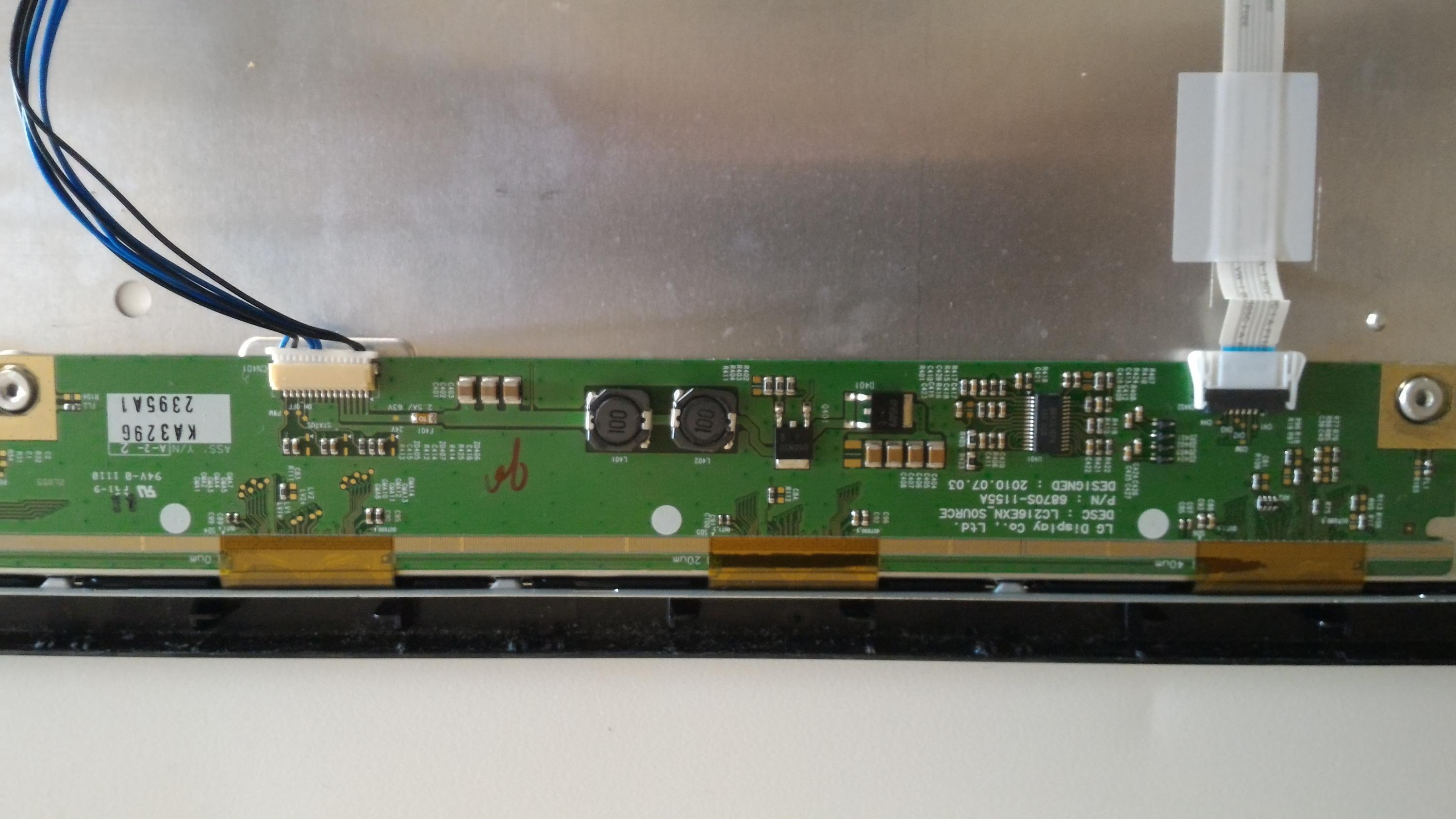

                                  Hi
                                  Got a few updates
                                  - Image is displayed, no backlight

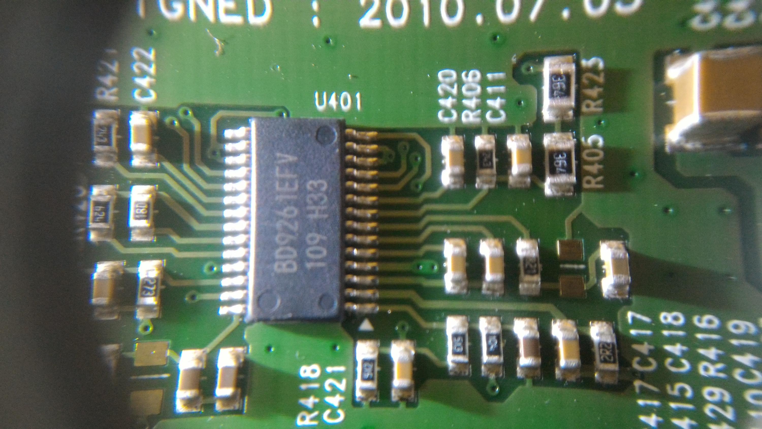

                                  - Horrible noise on PSU was solved with the new transformer, don't now if it was related to the problem or how long its been that way (TV's from my in-law).
                                  - If PSU is disconnected from from TCON (CN401) 24V stays up
                                  - If PSU is connected to TCON (CN401), with backlight (CN402) connected or not, 24V drops.

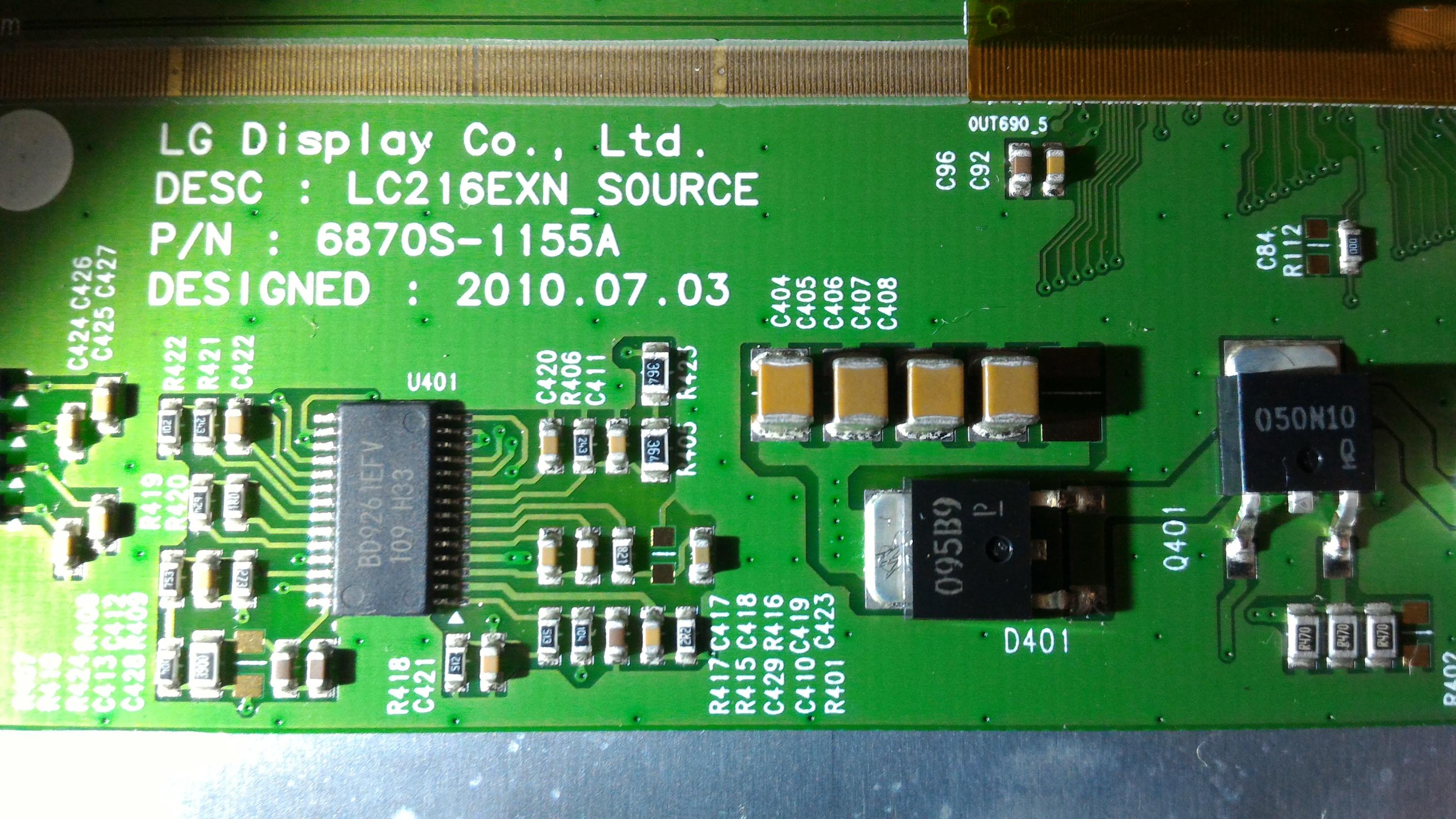

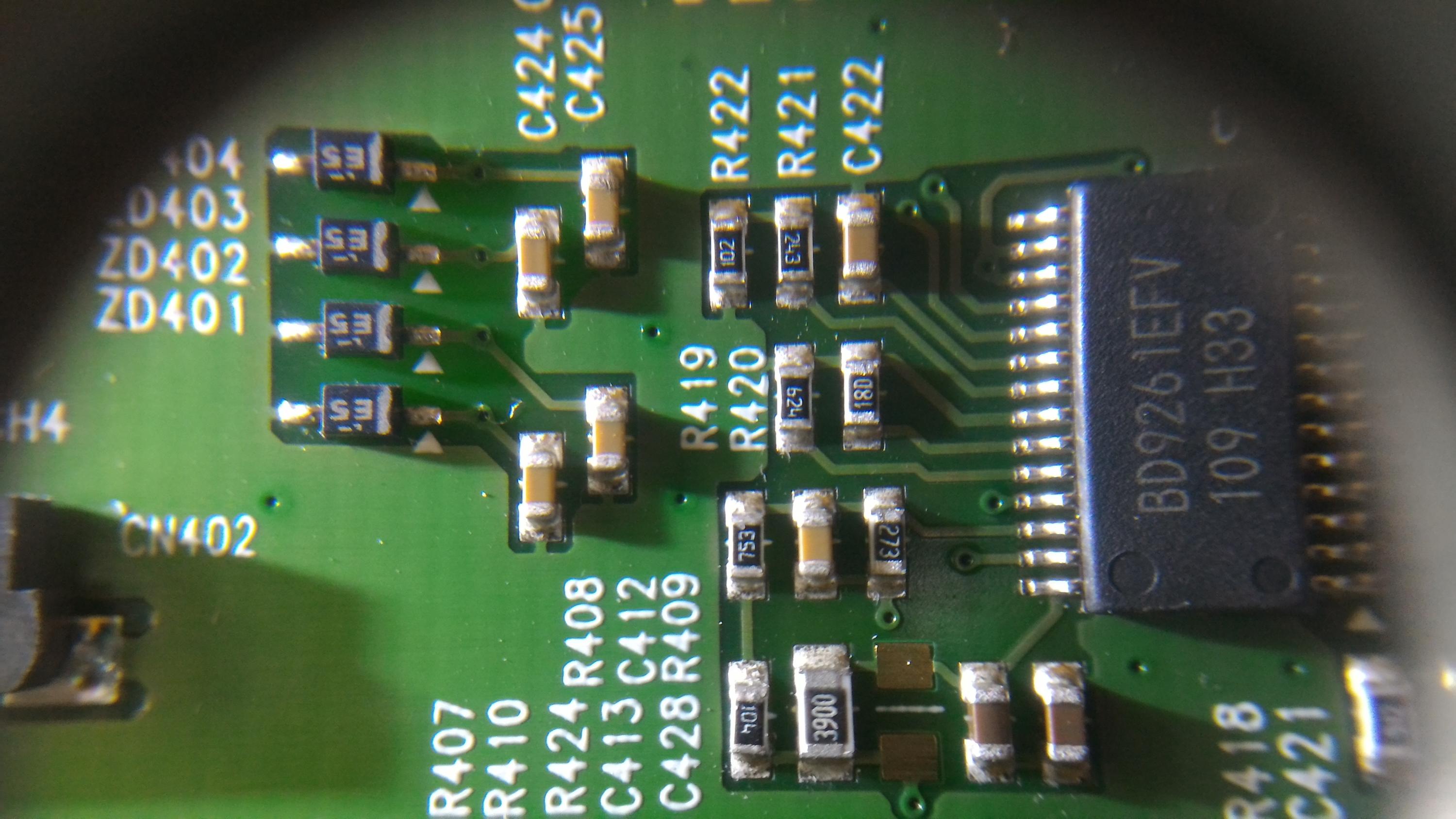

                                  From what I understand BD9261EFV (U401) is a safety chip, if it detects a problem in one of the 4 led arrays it enters safe mode, dropping the 24V, correct?
                                  • R_J
                                    • Jun 2012
                                    • 9672
                                    • Making Money
                                    That circuit takes the 24 volts and then boosts it to provide a higher voltage to light the led's. If it detects a problem, the boosted voltage will drop back to 24 volts. At no time would it just short the 24 volts, Check that the fet Q401 and the diode D401 are ok and not shorted, BUT if there was a short the fuse f401 would open. It looks like the power supply can not supply a solid 24 volts.
                                    If you check the +24 volts right at the cathode of the diodes on the power supply does it drop also?
