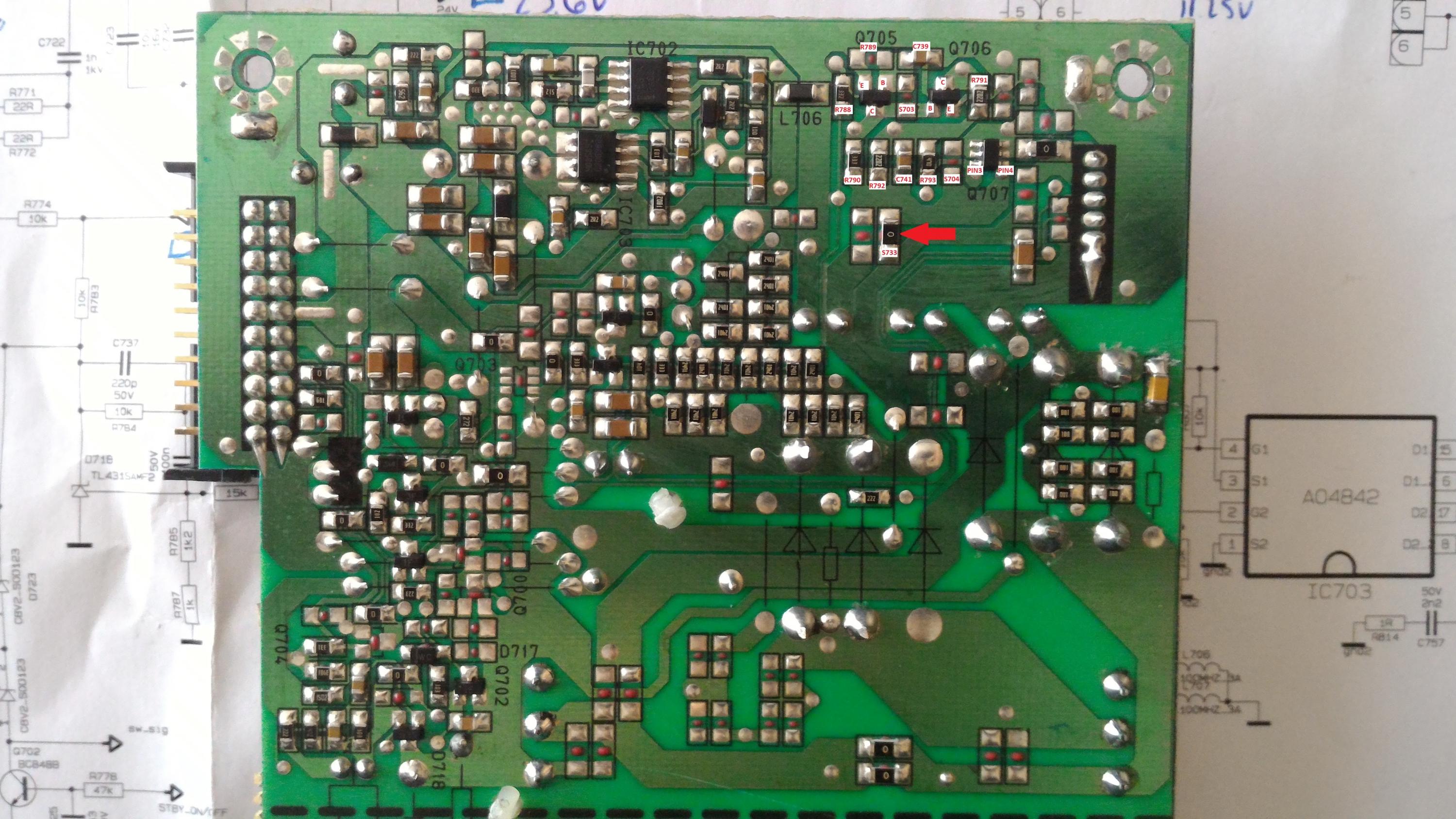

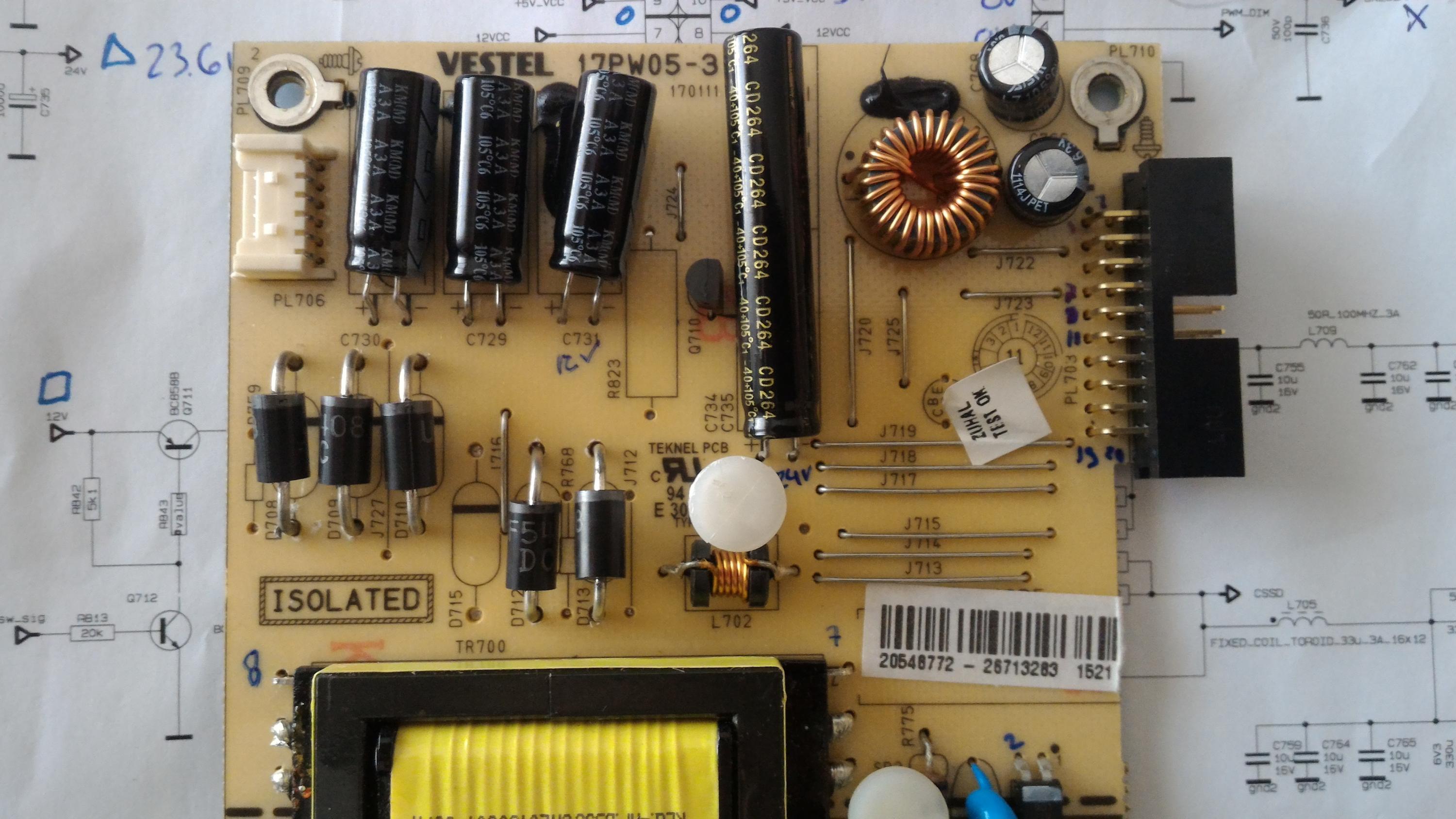

OK, I did not see the pin name in post 1. That is a big drop.
I also agree that he needs to provide the Voltage reading you requested: Does the 24 volts appear at D712/13? if it does see if those resistors R781/782 are used and if they are that they are ok.
