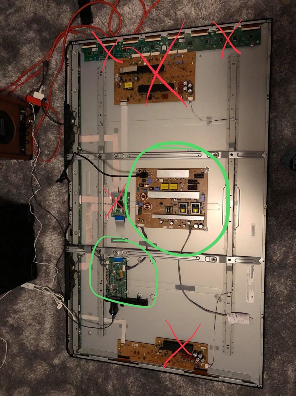

    I have a plasma TV that is sometime restarting for no reason.
    I replace the power supply and still have the same problem.
    If I unplug everything except the power supply and the main board.. still have the same problem.
    So, I conclude the problem is from the main board.
    I have redone all solder joint that was looking poorly but no change.
    Do you guys have any clue of wich part I should replace ?

    Look for cold solder joints on the PSU. Especially the components on the heatsinks and those transformer legs.

            Perhaps you have loose cable connector?

                Andrew F. Ali -> cables are fine

                  I agree with you here. A cold solder in the CPU could cause this too. Do you have a Hot air Station?

                    No, but I tried with a heatgun twice, same problem, there is a lot of plastic component so wasnt that hot. I'm good at soldering, maybe i can try to carefully heat all the pins.

                      That's a lot of pins that are very close together. Have you considered just getting another Main Bd. off e-bay or Amazon??
