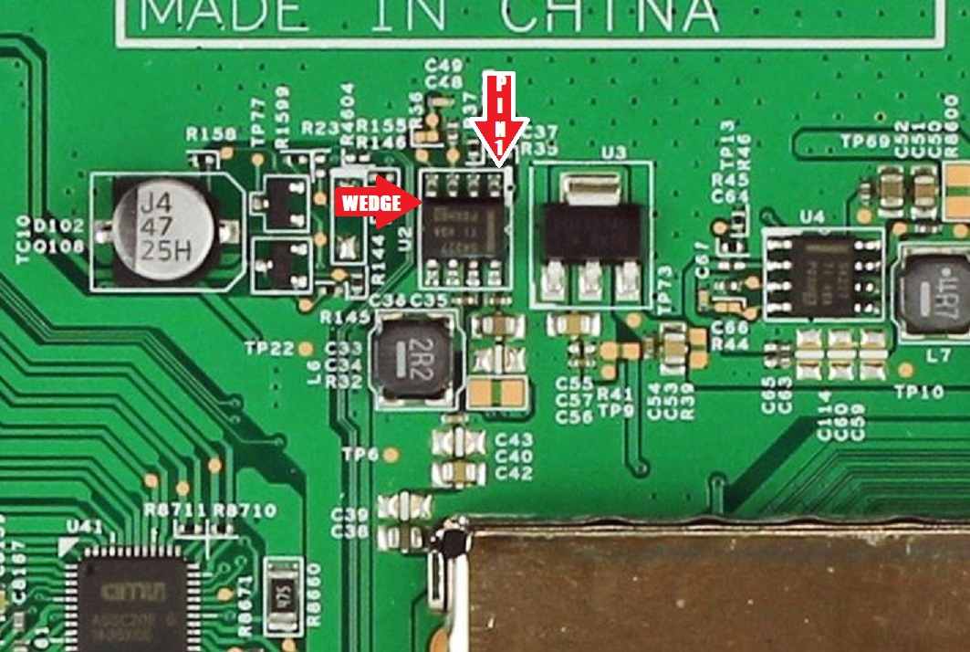

    I'm having a hard time seeing the board, it is pin 8 its in circuit with. Its callout is VIN, input voltage supply pin.
    I think that it may be Pin 4 (Soft Start) and not Pin 8. The data sheet shows pin 1 on the slanted side of the IC which unfortunately I cannot tell from the photo, however Pin 5 is ground so that would confirm whether it's pin 4 or Pin 8.
    Looking again at the photo it does look as though it's Pin 5 and the data sheet does show 2 x 10uF caps connected to it.

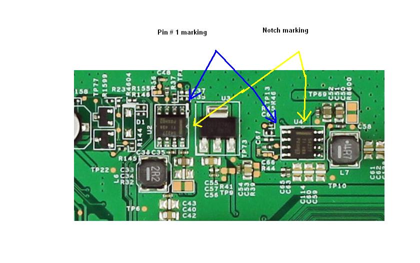

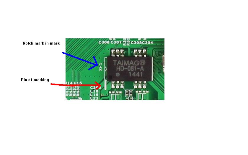

      Re: Vizio E55-C2, appears dead, no 20V, main cap always 385V, no PSon
      If you look at the white outline you will see a small notch mark at one end, also there is a larger white mark marking pin one. It is more noticeable on other ic's on the board like XP1
          I see a "wedge" on one side of U2. On that same side there's a thick white line on the board. I took that as the number one pin right next to the thick white line.
            notched side same as line on ic . what is this wedge you talk of ? p.s yes that is pin 1 .
            on another note some isc.s have an indentation but not important right now .
              petehall347, by wedge I meant an angle cut in at the top edge of the U2 eeprom.
              If I read the datasheet right the pins are
              1 2 3 4
              8 7 6 5
                pin one top left notch at top is how it is on rj.s post
                  lol I did get them backwards. Should have been:
                  4 3 2 1
                  5 6 7 8
                  Making pin 8 in-circuit with the defect.

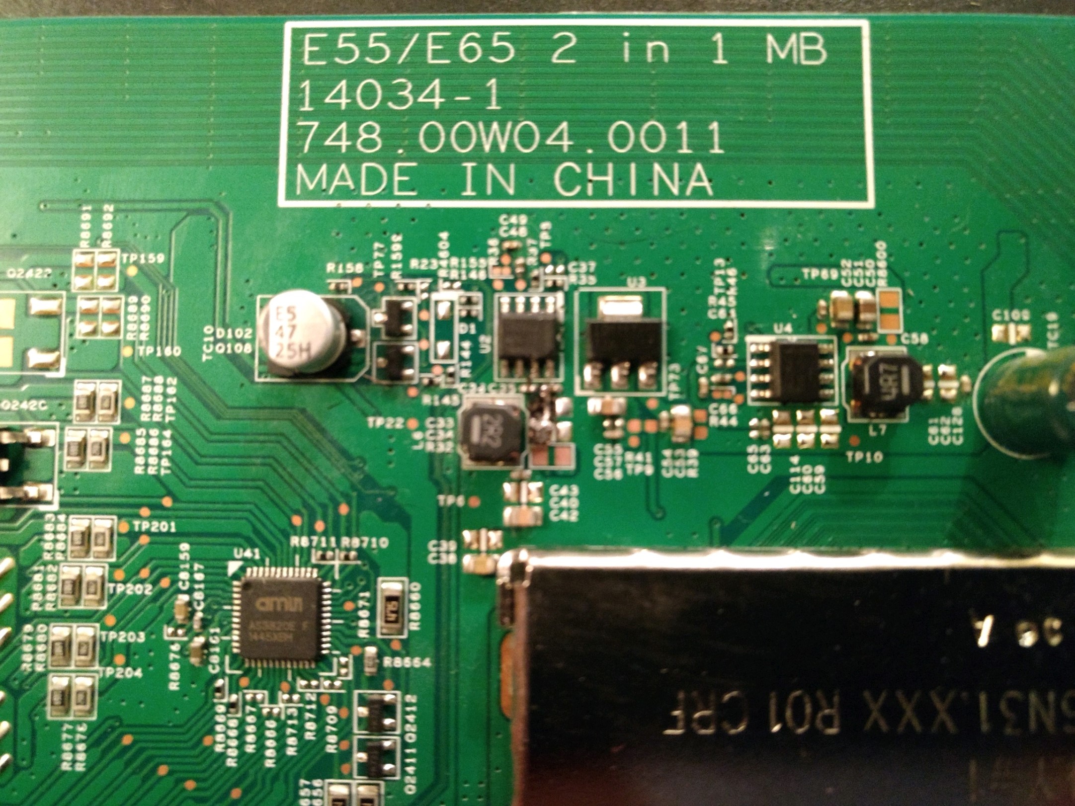

                    #29
                    Wire bypass installed, end result.....
                    I installed a strand of copper wire from what is left of the trace to the small cap off leg 8. End result:
                    They call me......."threadkiller"
                      So after taking time to test the TV and its functions it looks like it's going to be a winner! Everything works fine on it.
                      This was a great learning experience....and my first "repair" of a main board. I probably won't fix this one all the way since I don't have a microscope to see with. My eyes aren't what they used to be and I don't want to accidentally do a half duff job and not see it.
