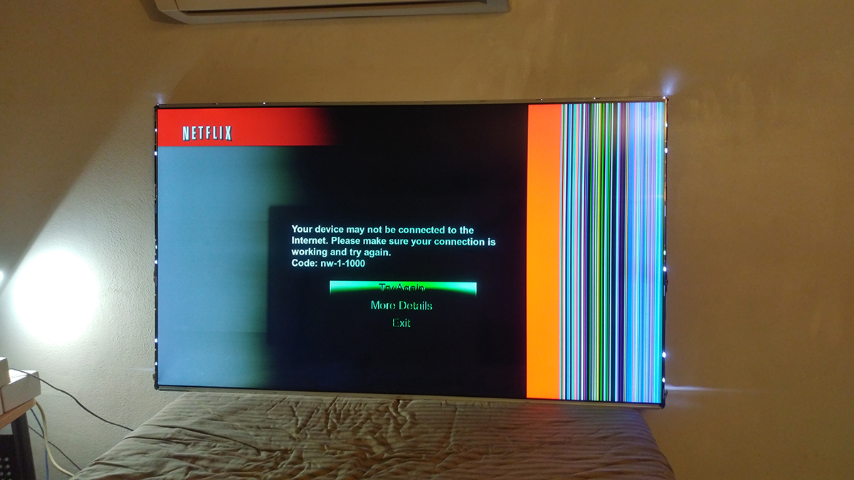

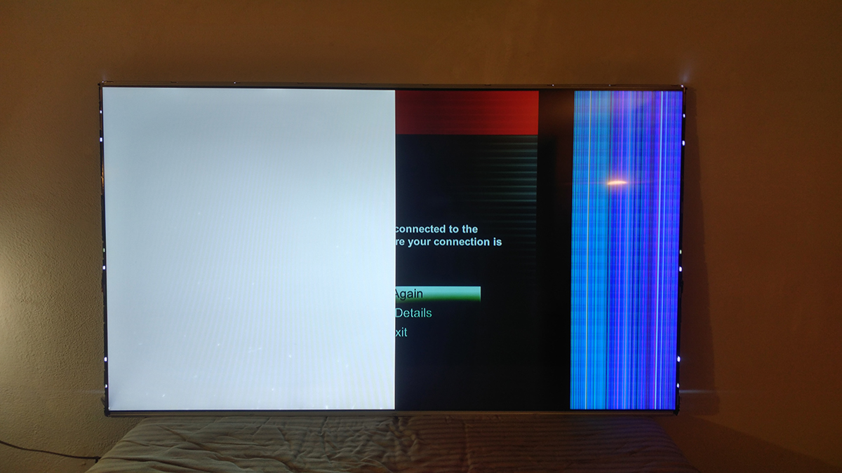

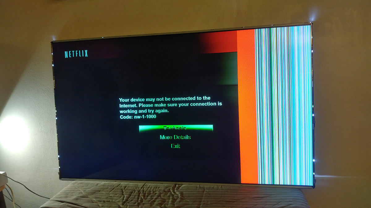

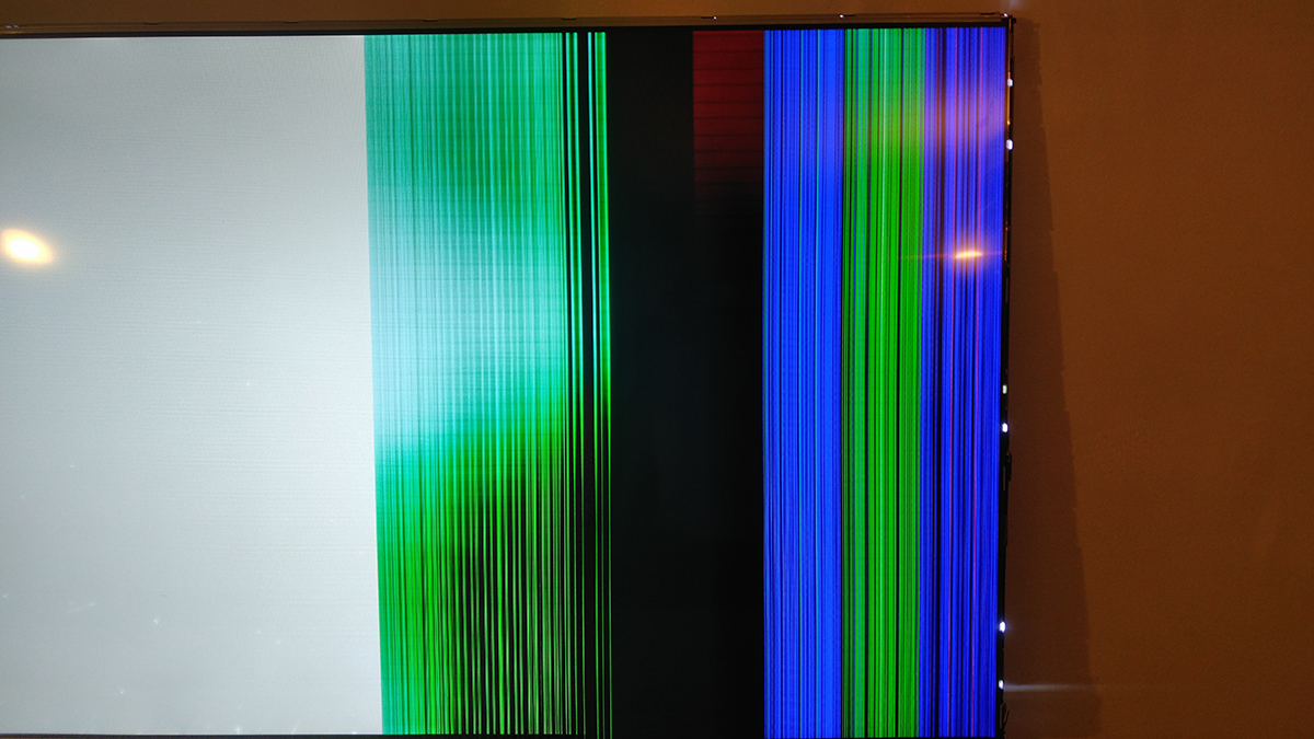

    I've read previous posts on this forum about pulling the tabs as a last resort, but I have a few questions before I do that. I've attached some pictures of where I'm at with the TV. Left and right are from looking at the front of the TV.
    sec_left_disc_facing_netflix - This is with the second T-con, both cables connected and the left corner ribbon cable disconnected. Vertical lines and dark spot in center of screen.
    sec_right_disc_facing_netflix - This is with the second T-con, both cables connected and the right corner ribbon cable disconnected. More vertical lines and white spot in center of screen.
    org_left_disc_facing_netflix - This is with the original T-con, both cables connected and the left corner ribbon cable disconnected.
    org_right_disc_facing_netflix - This is with the original T-con, both cables connected and the right corner ribbon cable disconnected.

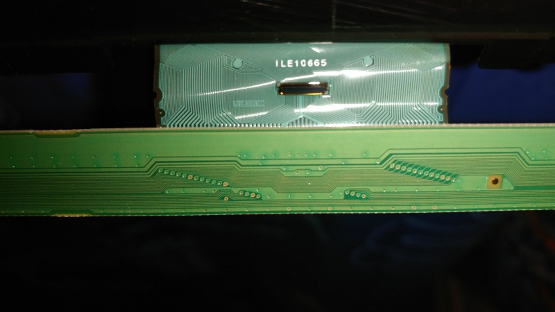

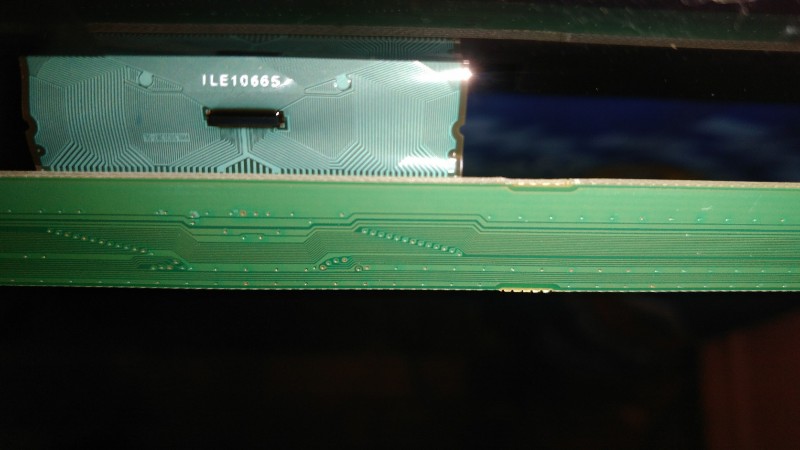

    I'm not sure what direction to go. I've inspected all tab drivers, left and right. None appear to be burnt. I've tapped them by hand and with a spudger - no change. I've tapped the T-con cables - no change. It doesn't appear to be temperature related because I can fire the TV up the next day and the results are the same. I've tapped around the bottom of the TV and there's still no change. The only way I can induce a change is to switch the T-con.

    Your second tcon has an issue.
    Your horizontal driver issue appears alleviated in the last pic so it's on the side of the disconnected corner cable - so right side uppermost driver.
    It's also possible you have a failed vertical driver or tab bond issue. Try touching that tab lightly to see if the lines change at all.
    You may have to remove the drivers on the right side and see how the vertical lines are affected.

      its doesn't look good. You should probably check the lower right corner edge board to see if there is any physical damage. It could be that, as mmartell suggests, that one of the side tabs is "pulling down" the vertical source driver on that side. There have been instances of the "tab removal" clearing up both horizontal and vertical issues... I guess it depends on the position and tracks within the panel as to how things are routed / designed.

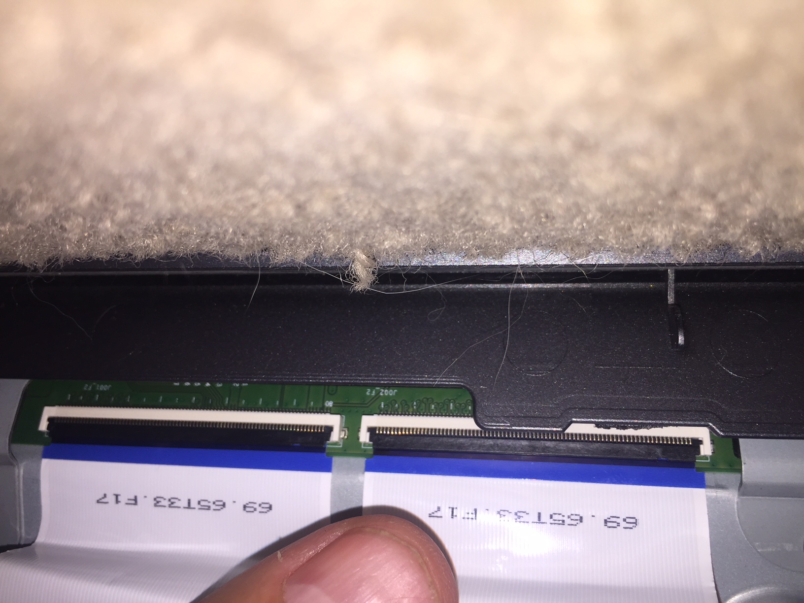

            you might want to put on your glasses when you are positioning the cables in the clamps... I almost get the feeling that the cables are misaligned.
            anyways, check the fuses on the tcon board along with the voltages going there just in case something happened on the way to the "dance".
            still further. the bottom edge boards have interconnection ribbons going between them. If you disconnect them (they are unclampable), especially on the side that has the verticals, you might see some thing different (but most likely still bad).

              Re: Sharp LC-70LE650U - Progression of Problems

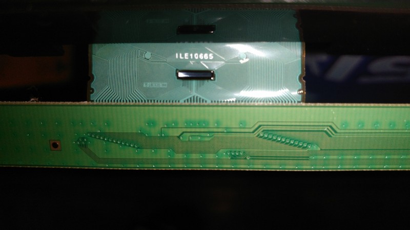

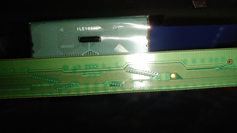

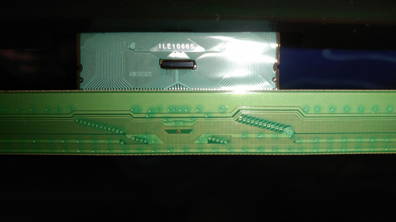

              Here's some pictures of the tabs on the right side and the left ones look similar. Do they look suspect?
              The cables along the bottom that don't use a clamp, will they just pull straight out without damaging things?
              I still haven't put the 3rd tcon in. I'm not sure where I would check voltages on the tcons and I don't see an obvious fuse like on the power board. If I know where to probe, I do remember freak said to only supply power, but don't connect it to the panel.

                The "cabling" at the bottom of the set that I refer to are ribbons interconnecting the edge boards and NOT the panel. They are set in clampable connector... at least in all the ones that I have seen. Post a picture if you are unsure.
                As for the tcon ribbons, there are "tangs" (cut outs) on the side that properly position the cable in the clamp in terms of "inset" (how deep the cable goes in). They are on both sides. The position of the "tang" on each side will tell if the cable is aligned based on space / lack there of.
