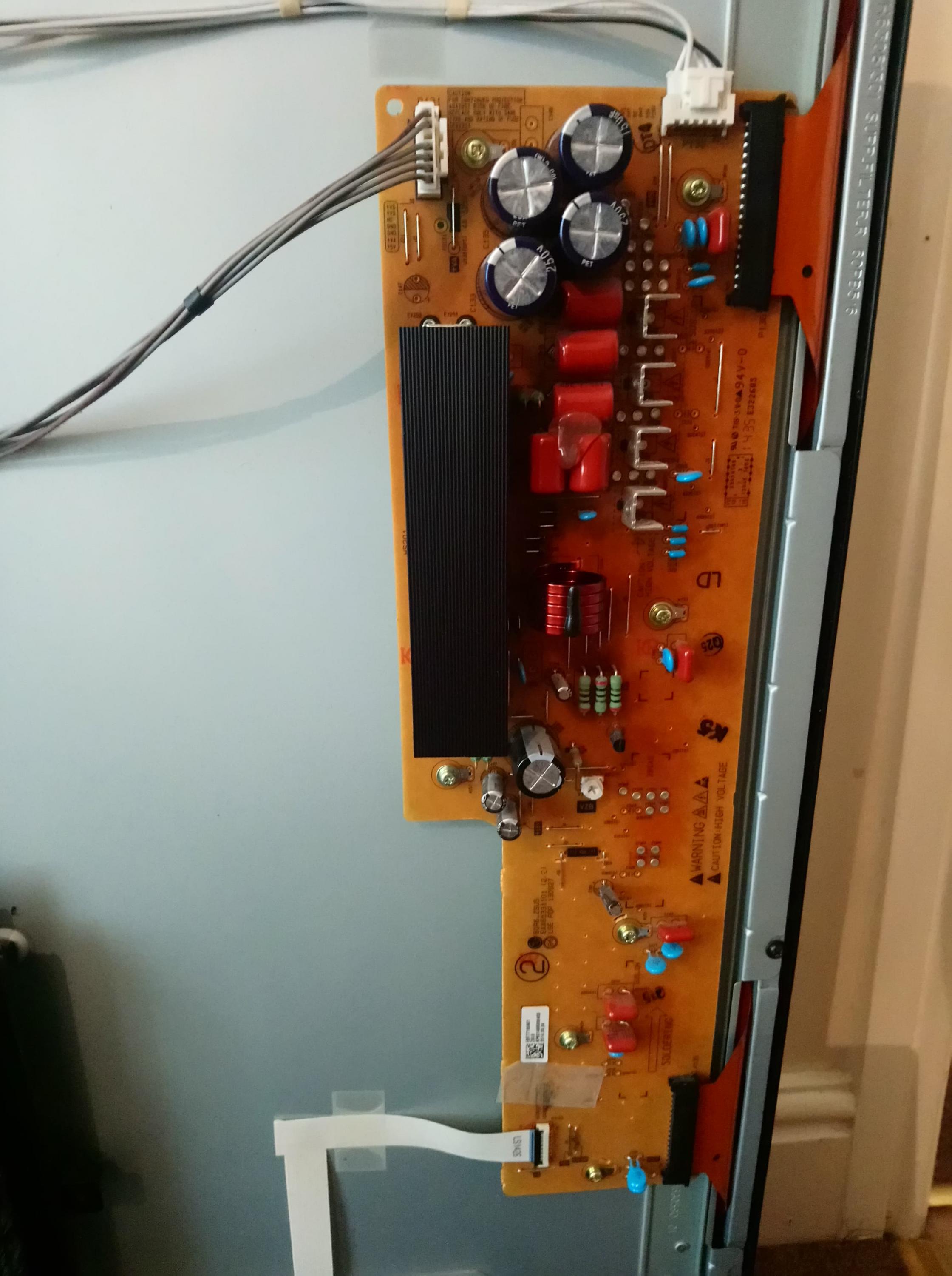

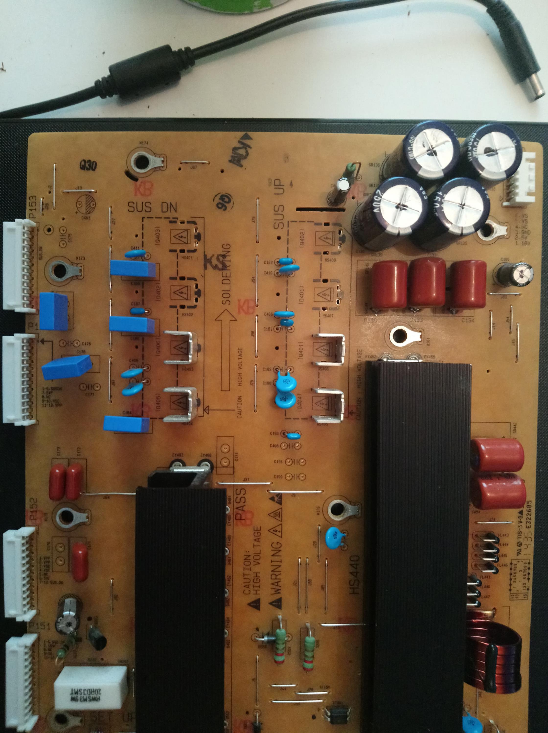

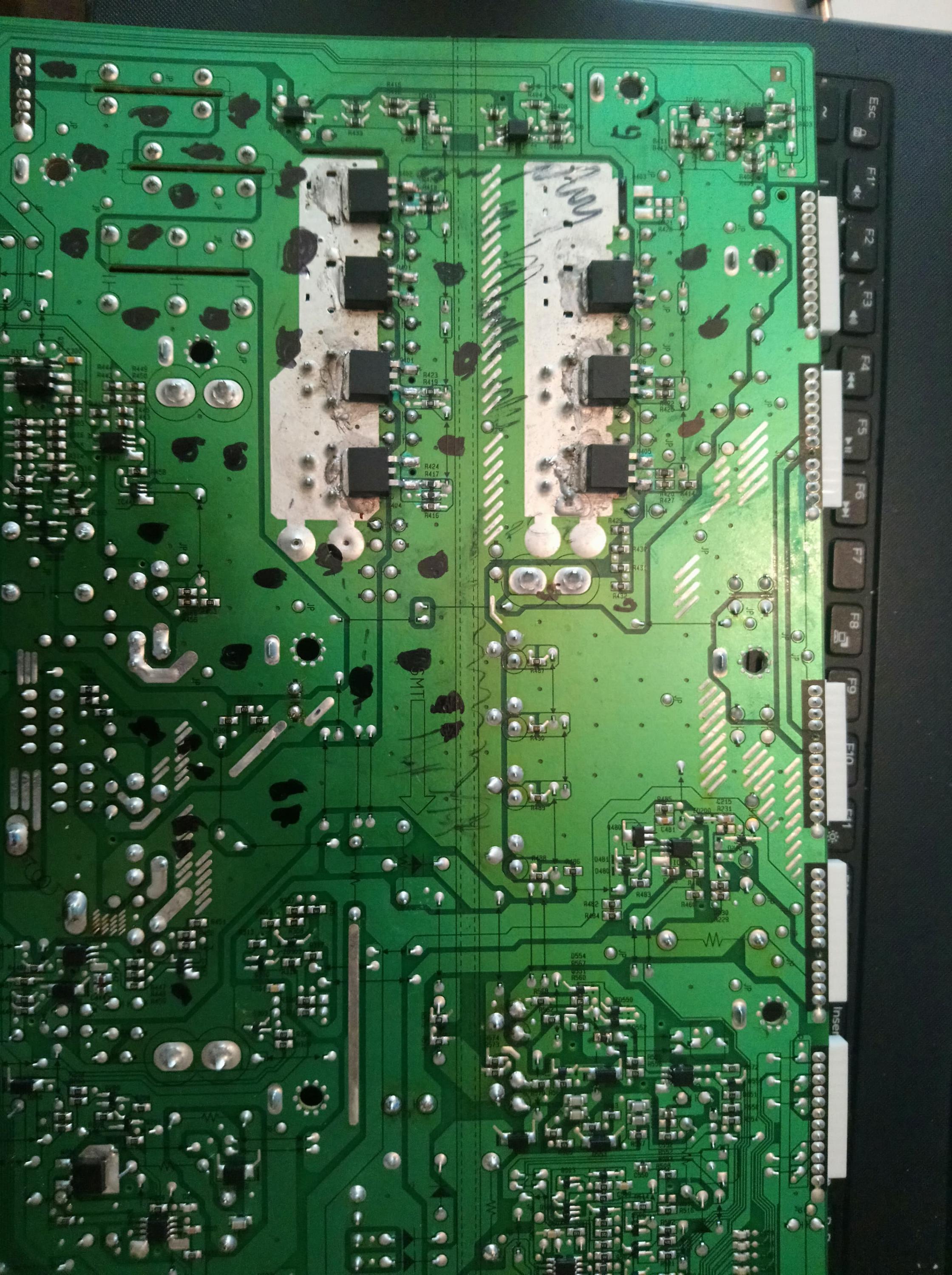

    * Recently, I bought this Lg with this fault. sound without picture.

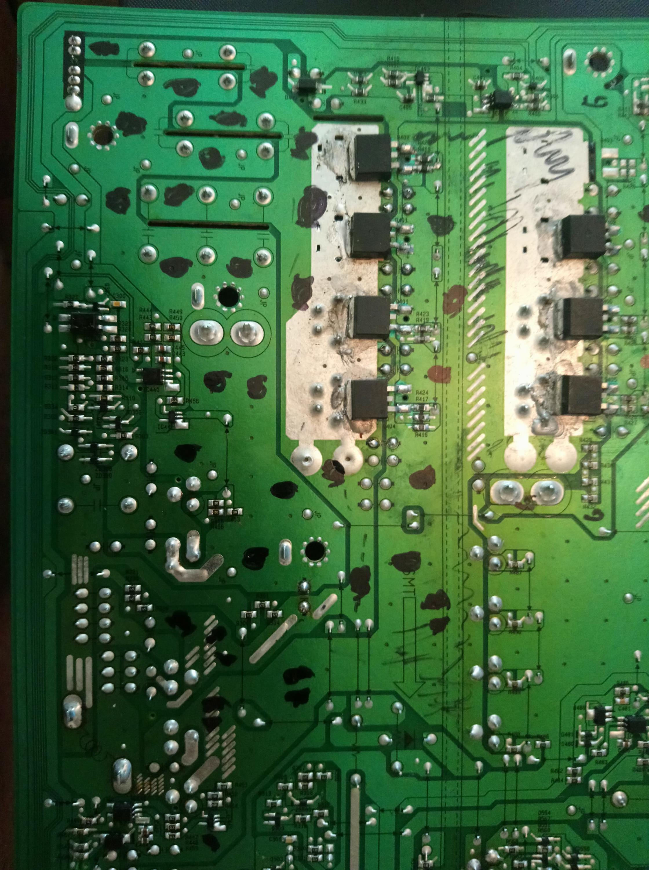

    I found all 5 igbt smd burned, without reading information about the TV I changed all 5 mosfets. when I connected the tv, the smd capacitor on the buffer exploded and again all 5 of the mosfets died. I had all the screws fitted.
    I tested buffer boards after changing the capacitor and everything is ok.
    The voltages given by zsus are correct.

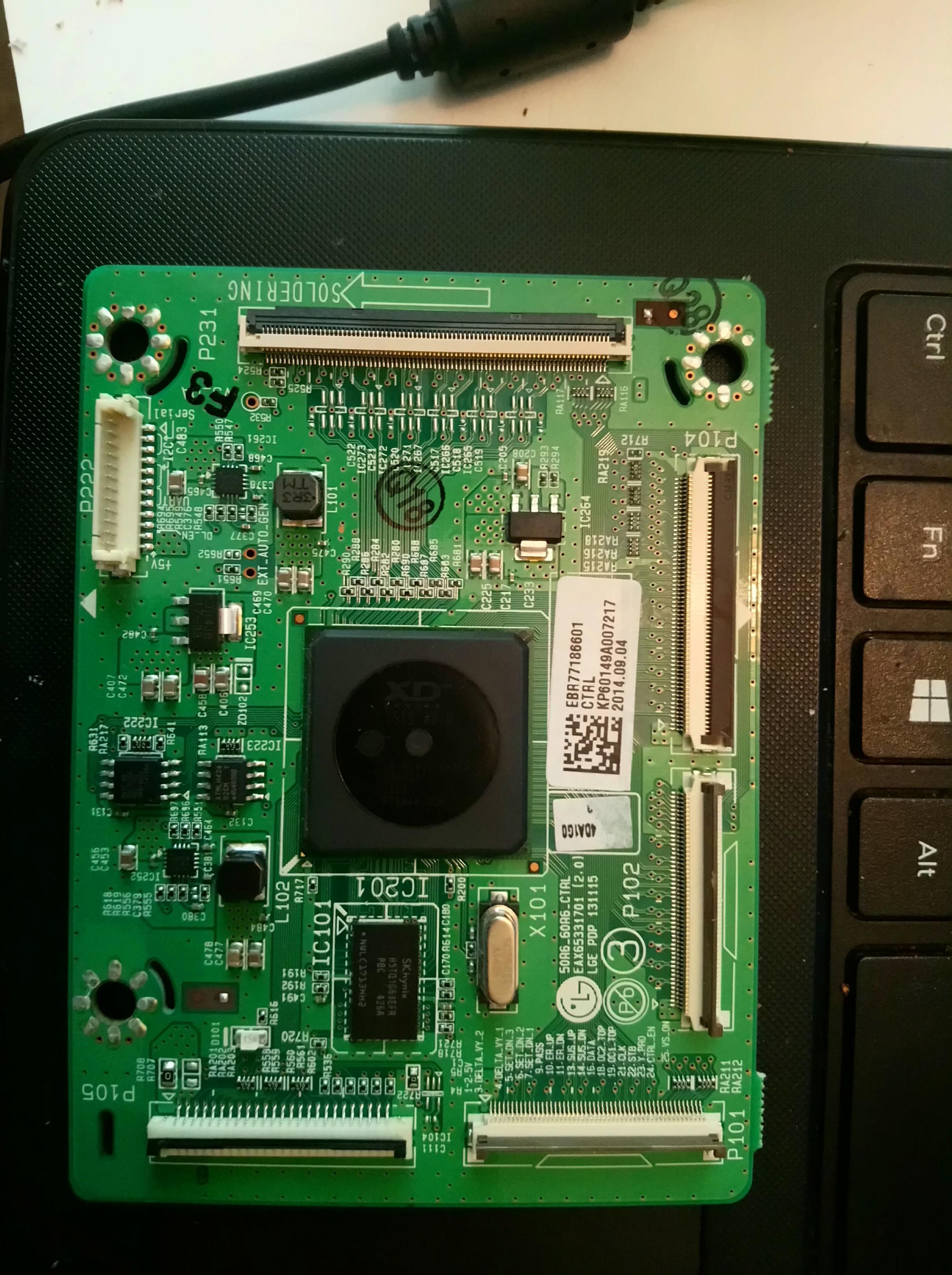

    t-con does not have the led on.

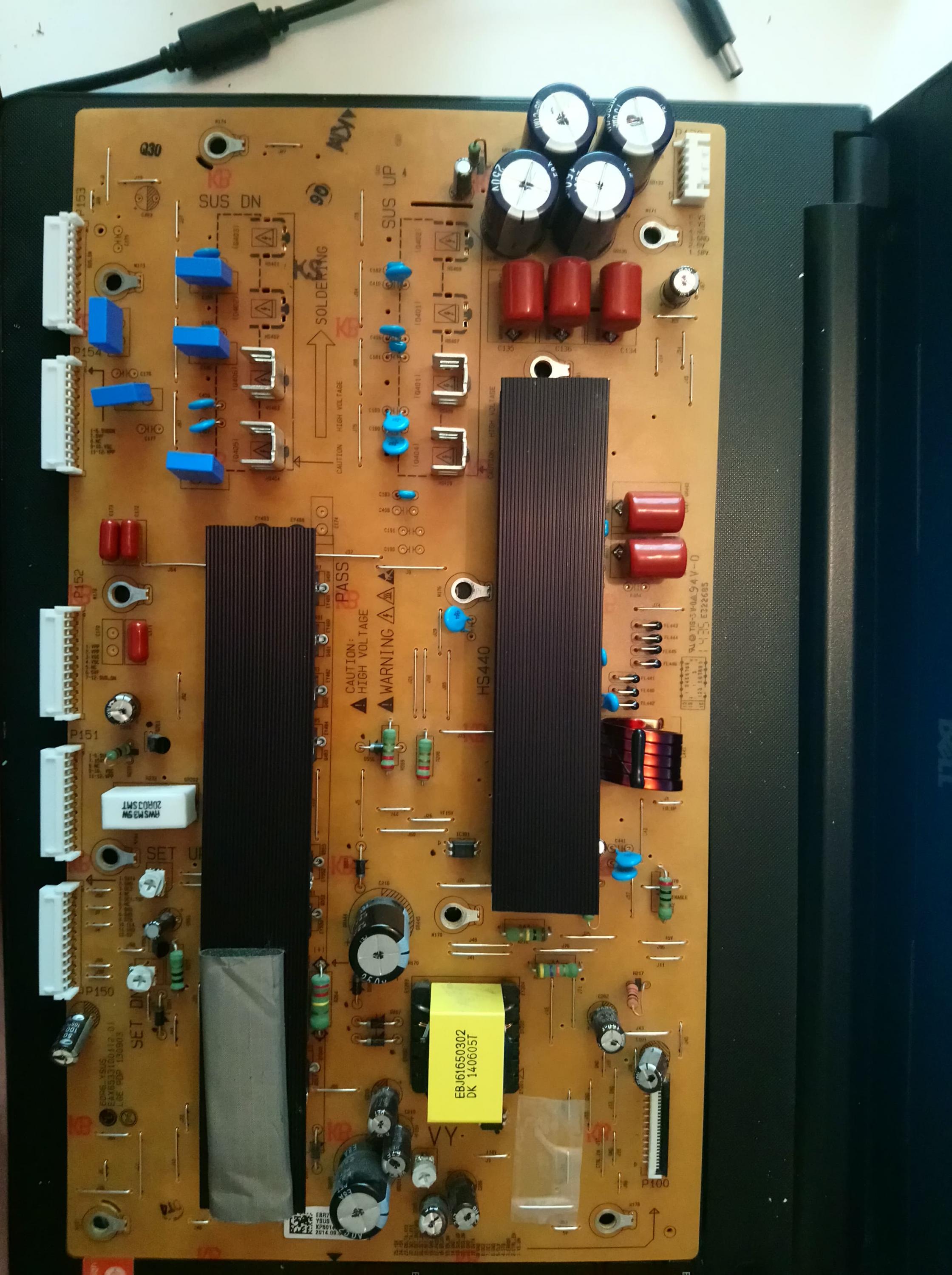

    I replaced all the 5 mosfets (q401,402,404,405,406) tested resistors groups and are ok, I replaced ic402, ic401, q552, q553 and ic100, verified no bad solder joints.
    I plugged in again and the flame is visible behind the board next to q401, q406.
    * When ysus is connected to the buffer, all the capacitors and diodes on the buffer seem short, when disconnected they are no longer shorted.
    I have removed buffer boards, ysus has the same result.
    I need some advice.

      Are you tightening the Floating GND lugs firmly? Are there shorts on the Upper and Lower Buffers? Is Vs what it is supposed to be according to the Panel sticker? Were the IGBTs the correct spec replacements from a trustworthy source? Did you verify that there weren't any other surrounding components connected to the IGBTs shorting or open?
        Re: 60pb690v ysus repeatedly burn igbt
        Yes, very tight.
        Upper buffer looks short at diodes an capacitors when I connect ysus.
        I checked all the components on the upper buffer and all are in the parameters.
        Lower buffer checked and all the diodes and capacitors to be shorted, removed from pcb indicates correctly.
        Va and Vs from xsus are ok.
        i only used new igbts with same spec.
        I measured everything I can measure with a multimeter and a capacitmeter

          when you say you used new igbts where did you buy them from have you got a link as there are a lot of fake parts around.
            https://www.ebay.co.uk/itm/30F132-GT...item2f198b9e89
              Va and Vs is produced in the PSU and NOT in the X-Sus Bd. Either the replacement IGBTs were the fake type, we know this from experience, and the Upper and Lower Y-buffers seem OK. Can your source a replacement board from e-bay or amazon or whatever site is available to you?
