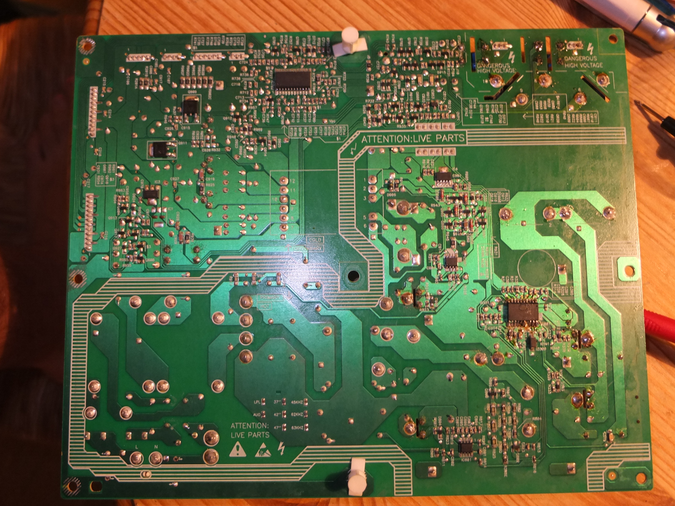

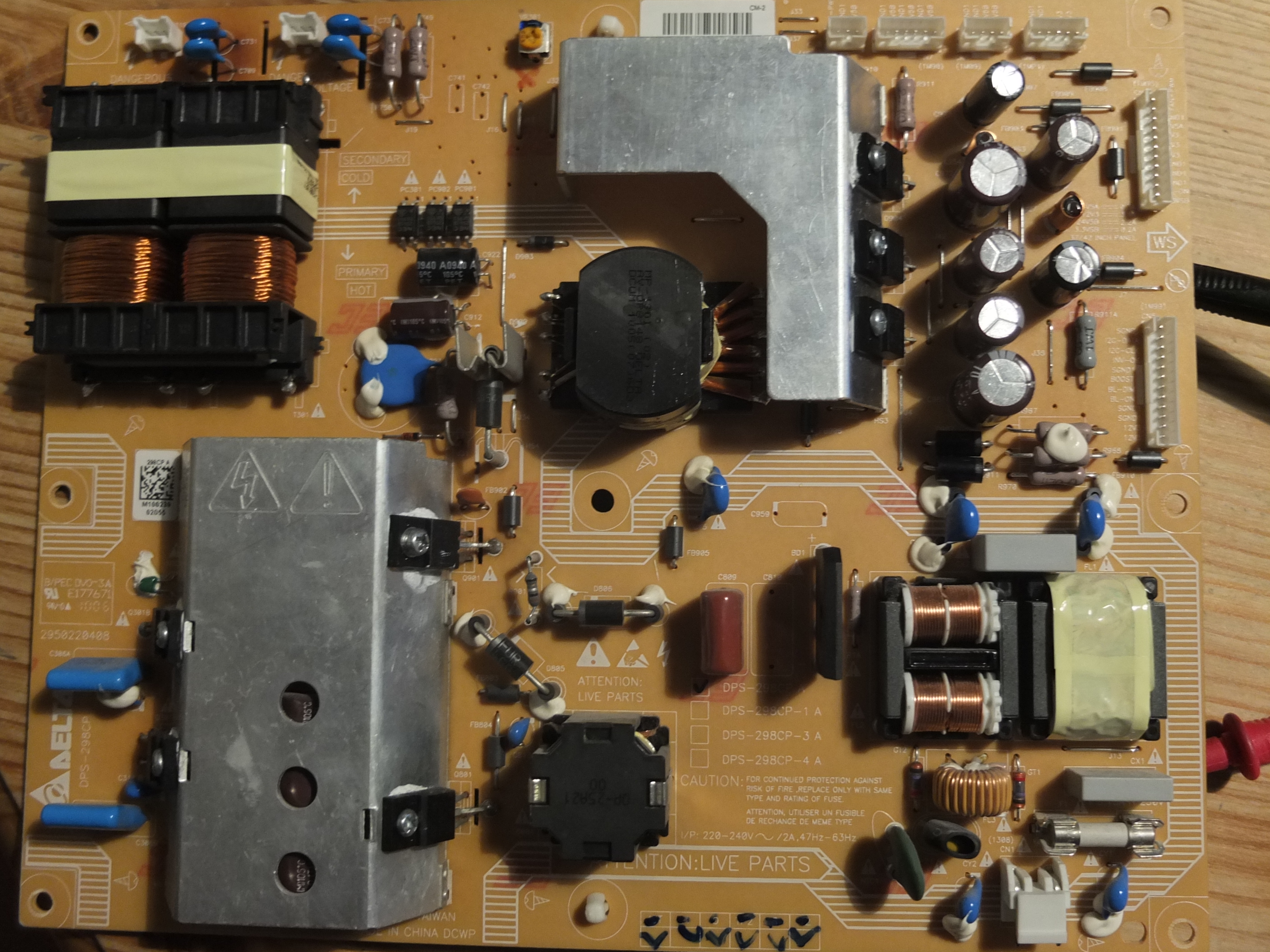

            I have attached several picture of the visible side of the PSU.
            As for testing the HT transformer, I'm not sure about how I should proceed, What would be my reference point : one winding with another ?

              The HV transformer is on the second picture. Basically it is 2 transformers side by side. The output windings are the ones where the blue caps are on top. With the TV unplugged, put your DMM into Ohm mode. On the top of that HV transformer where the blue caps are there should be 4 legs. 2 legs for each transformer. Measure the outside leg to the inside leg on each side. Note down the resistance measured. If the resistance of these transformers are further apart then 3%, then it is bad.
              Since you say if you reduce the back light brightness, everything is fine, my bet is either the CCFL's or the HV transformer. Not the caps. On the LCD, is white still white, or does it start to have a pinkish color?

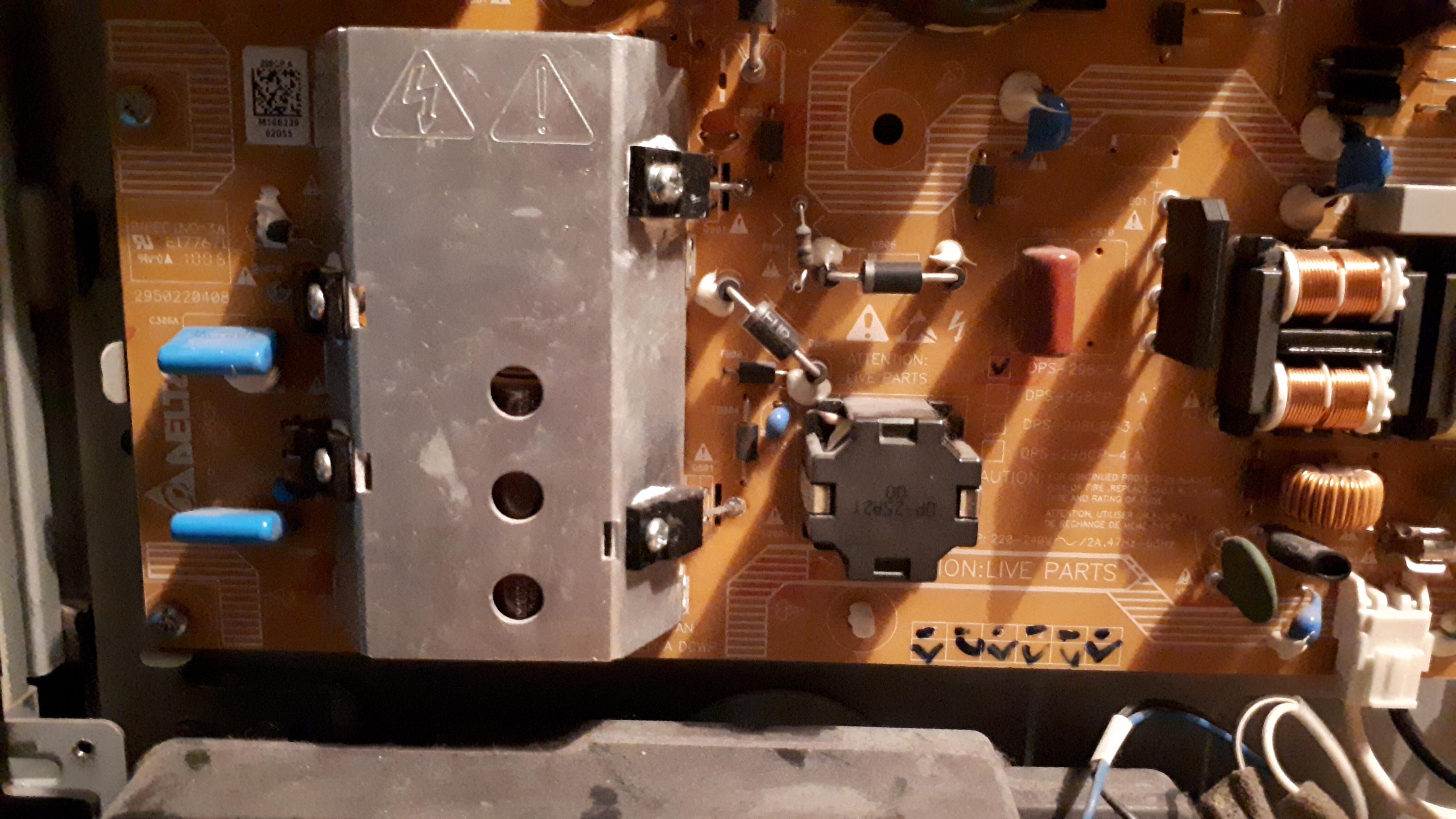

                      in post #6, first picture, there is a metal shield with 3 holes in it. It looks like there is a cap in there. Caps don't like getting backed like that. measure the ESR of that capacitor or change it. As far as your picture in post 8, I can't see enough I want. Make a high resolution, straight shot picture of the front and back of the whole board. It has to be high res, so we can zoom in. What kind of DMM do you have? At what scale is it set at? 16 Ohms is like way off with your reading its like a short. A low ohms reading is o.k. on the input of the transformer, but the output should be more like 1.3k Ohms. The backlights wouldn't come on at all with readings like you gave on the output side.

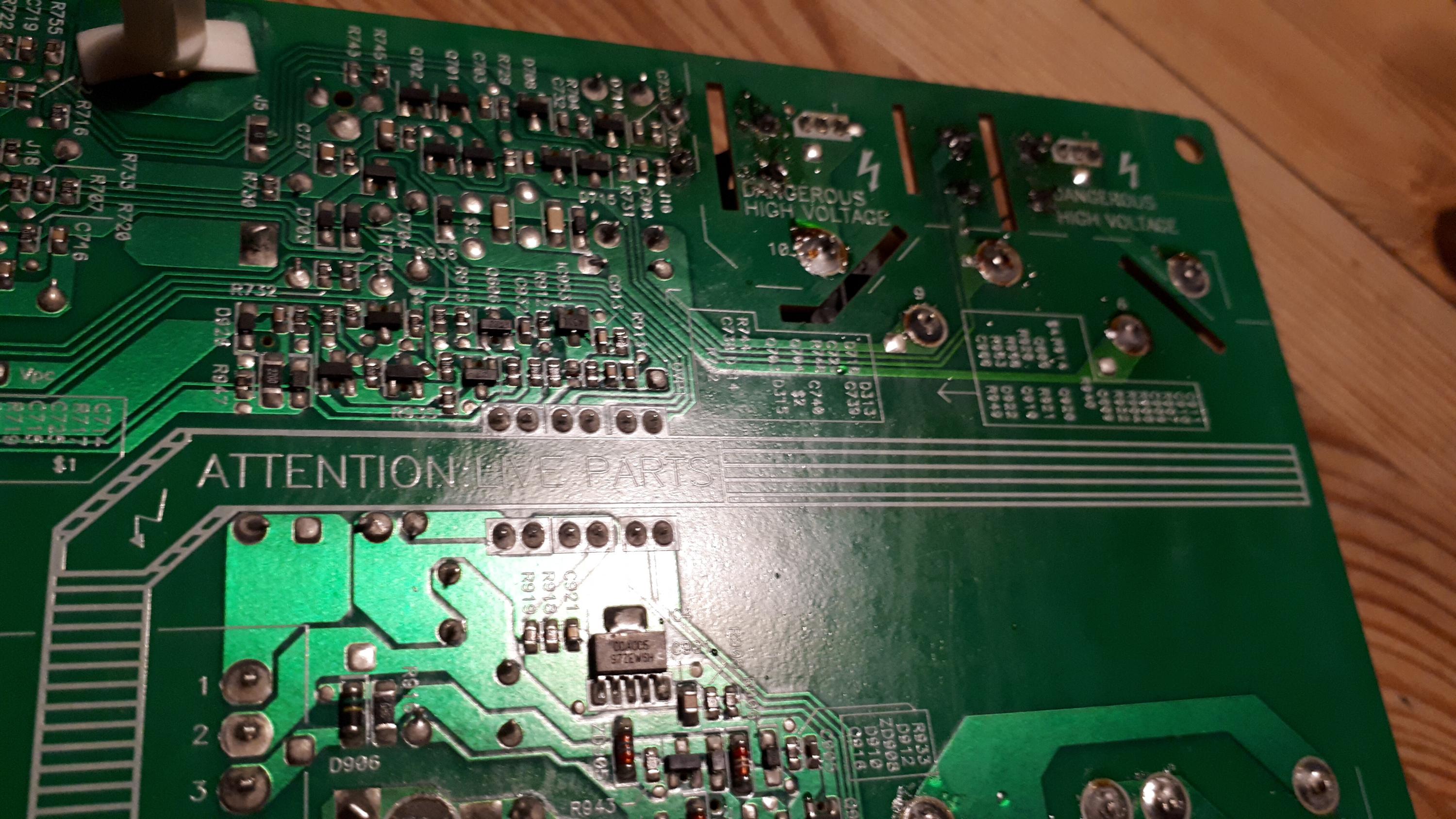

                        on the picture, you will see that:
                        - I changed the HV ceramic caps,
                        - I changed the mosfets
                        - I changed the IC601 (not a great job)
