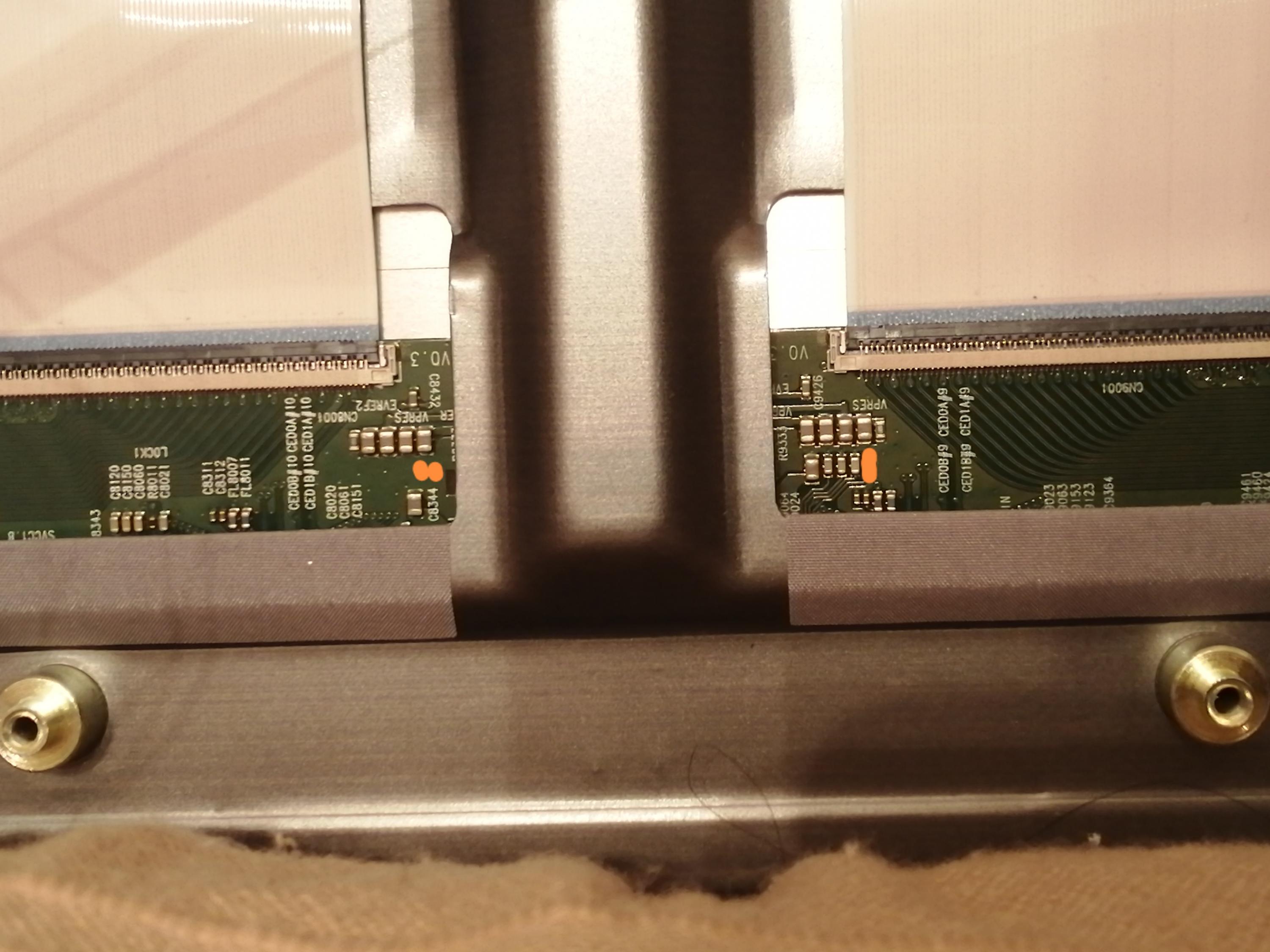

        Lg oled 55b6v
        Hello friend thank you for register to this forum.
        I have this problem.
        1- 24v go to 0v If have connected 4 flat cable panel and TV have only audio. And result D18 shorted.
        If disconnect 24v cable to tcon have this: TV on only audio. And result d18shorted.
        Vpres have short circuits, if disconnect 4 flat cable the diode D18 result good.
        Vpres is shorted and connected to tcon lock the 24v in protection. Have solution for investigate this little board?
        Thank s
