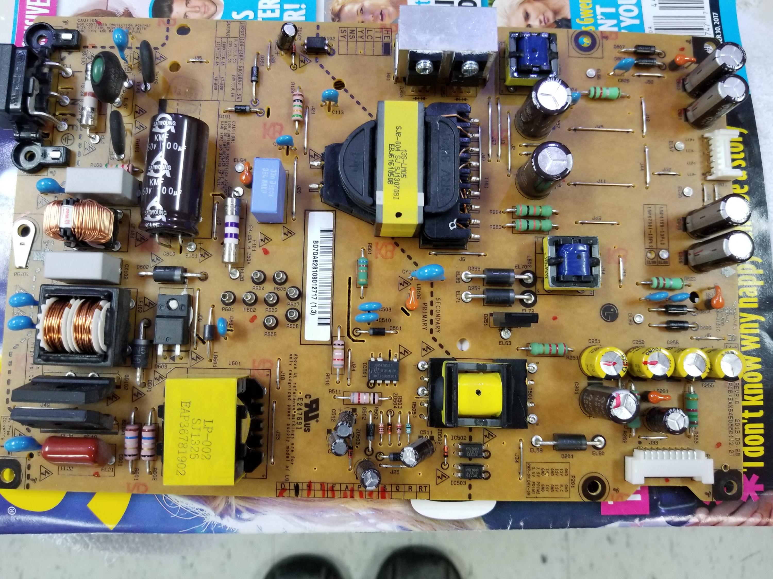

    any people or Budm help me please !!
    bought tv from people it does not work ,
    detail problems is :

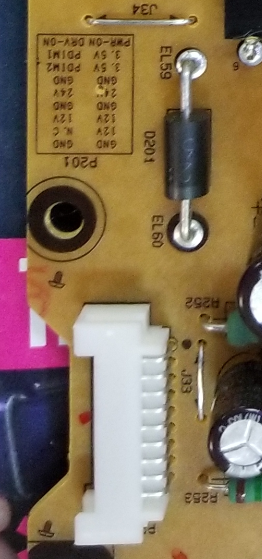

    tv stadnd by : at P201 ---PDIM1 --3.5V OK,PDIM2--3.5V IS OK
    TV ON: AT P201---N.C--12V-OK, 12V 12V-OK---24V--24V-OK
    TV TURN ON see back light flash and logo half second then screen is black
    used flash light to screen see manual setting......so I know main board and t-con working good,,, voltage checked at EL67 to LED+ and EL68 to LED+
    it should be from 80v to 100v but no voltage when tv On,,
    please help me where to check why tv turn on but no led driver voltage
    Re: Lg tv 47ln5750 led driver is problem ..
    The LED driver Voltage at the LED connector needs to be tesetd with ref to chassis GND, each pin Voltage reading must be done when TV is turned on which mean you need to leave the meter probes in place so you can see what Voltage goes up to when TV is turned on and how low it goes down to after 5 ~ 10 seconds. You have to do that procedure for each pin of the LED connector and connector is in place.
    There is also Voltage chart printed on the board.
    What is DRV-ON Voltage? How many Volt do you get?

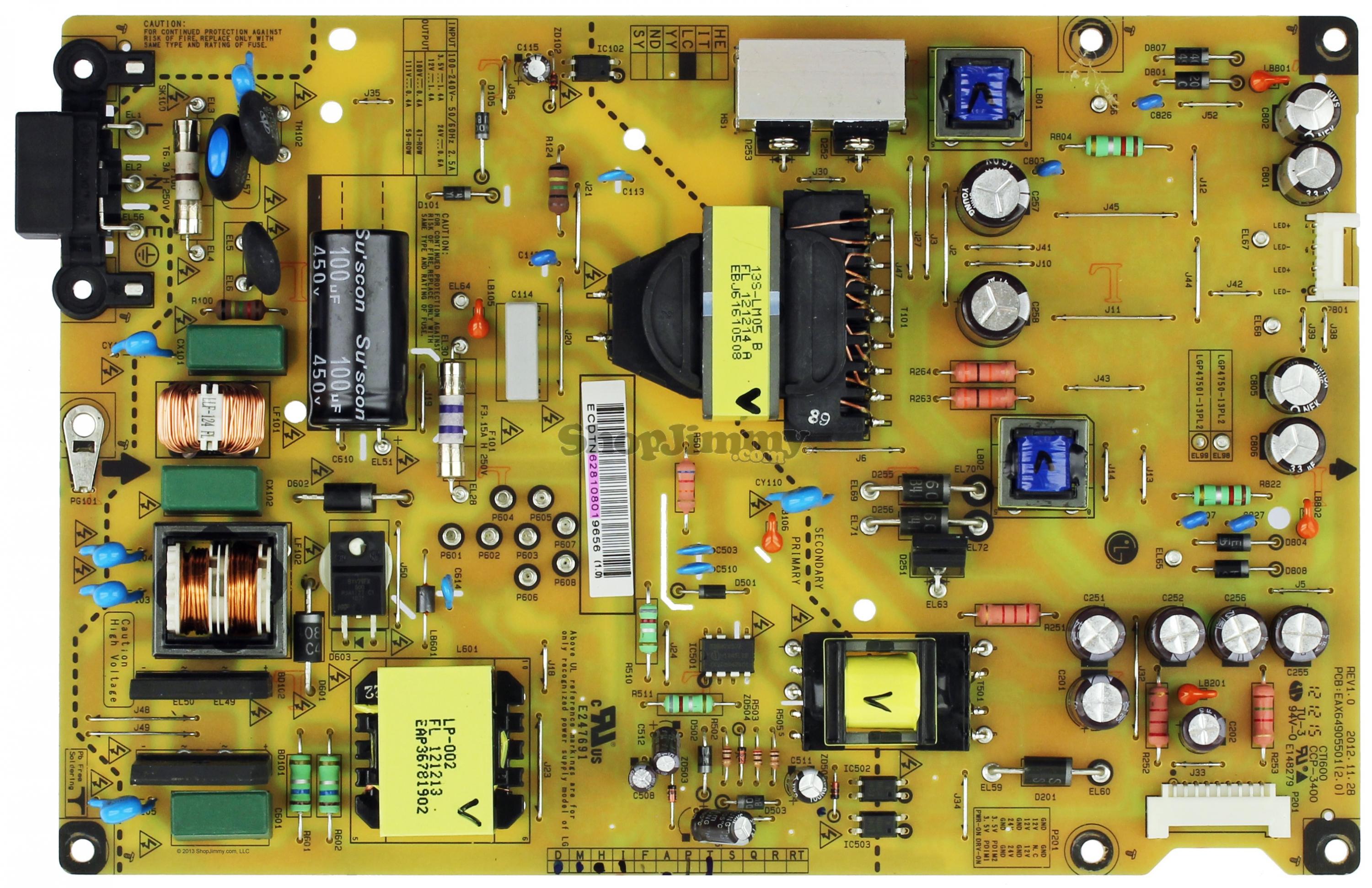

          http://www.shopjimmy.com/lg-eay62810...pply-unit.htm#
          LG EAY62810801 (EAX64905501(2.0)) Power Supply / LED Board
          If you trace out the board, you will see that test points EL67, 68 are the CATHODE return of the two LED strings, they will be around 20 ~30V range. The Voltages you need to test are the two LED +, two LED - with LED connector in place.
          I will not be surprised if the TV has bad LED's.

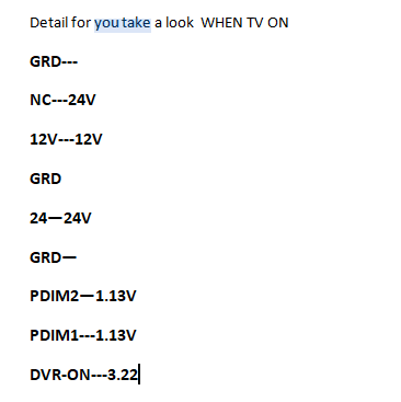

                HERE for you and people please take a look and help
                Detail for you take a look WHEN TV ON
                left and right led driver is 78V stable
                GRD---
                NC---24V
                12V---12V
                GRD
                24—24V
                GRD—
                PDIM2—1.13V
                PDIM1---1.13V
                DVR-ON---3.22

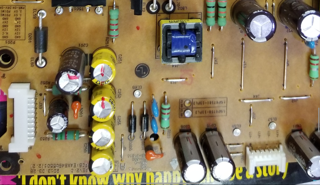

                    yes 4 pins at led connector 2 - and 2 +
                    --TV on
                    negative test lead to chassis , positive to pin + voltage is 78V for both
                    --stand by no voltage led pin at the connector
                    thx budm
                        one thing i do not know why ..
                        tv on
                        negative test lead to pin- ,, positive test lead to + when tv turn on i see 54v appear then disappear not even haft second
                        -TV Standby no volt at pin+ and -
                        Thx
                          It should jump up over 100V, you did leave the probes in place before turning on the TV and keep an eye on the meter when turn on the TV? The Voltage will jump up higher than 100V real fast before going back down to 78V.
                          You have two boost converter circuits, one for each string so it is unlikely that BOTH of them are not working at the same time.
                          Then another test will be without LED connector in place and then same procedures on the two LED+ pins.
