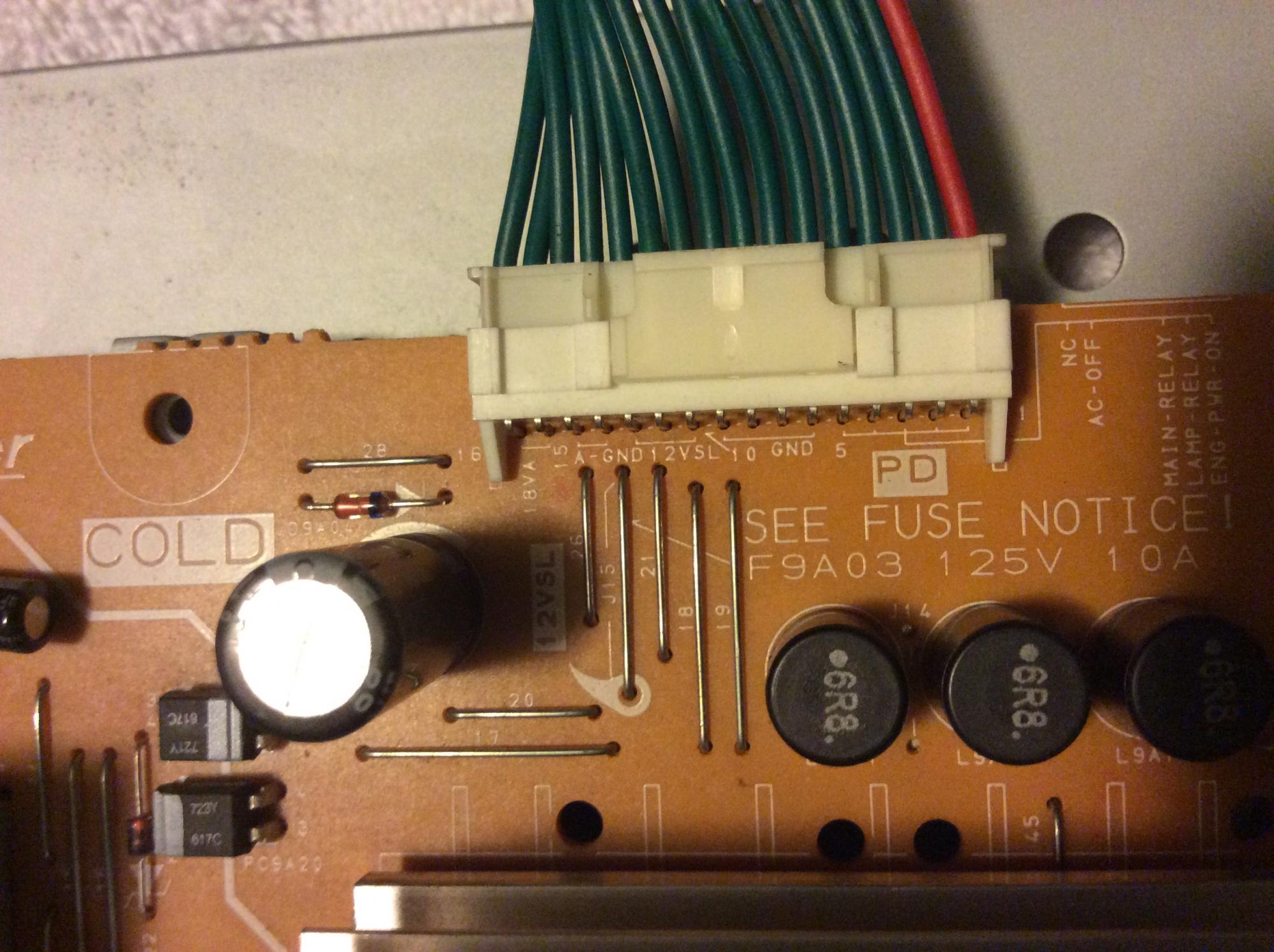

      • GAStuntman
        • Dec 2017
        • 65
        Re: Mitsubishi DLP wd65733
        The connector in the picture below has the right voltage on the power supply cable as well as the mainboard side. As stated above the fuses all have the correct voltage as well. If you like at the picture it shows where the pins should test at a certain voltage. That's what I'm talking about when I say I'm getting the proper voltage.

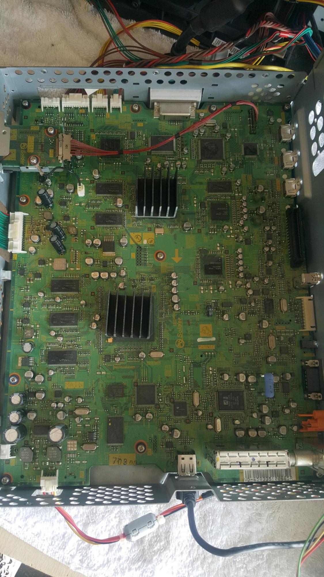

                          You may want to check around IC7A01, that is the main micro, Check that you have 3.3VSL on L7A01, that is the VCC for the micro.
                          KCS0 is the power button input, check voltage on R7AA9 and see if it changes when power button is pressed (one side connects to 3.3v other side goes to micro KCS0)
                          (page 82)
