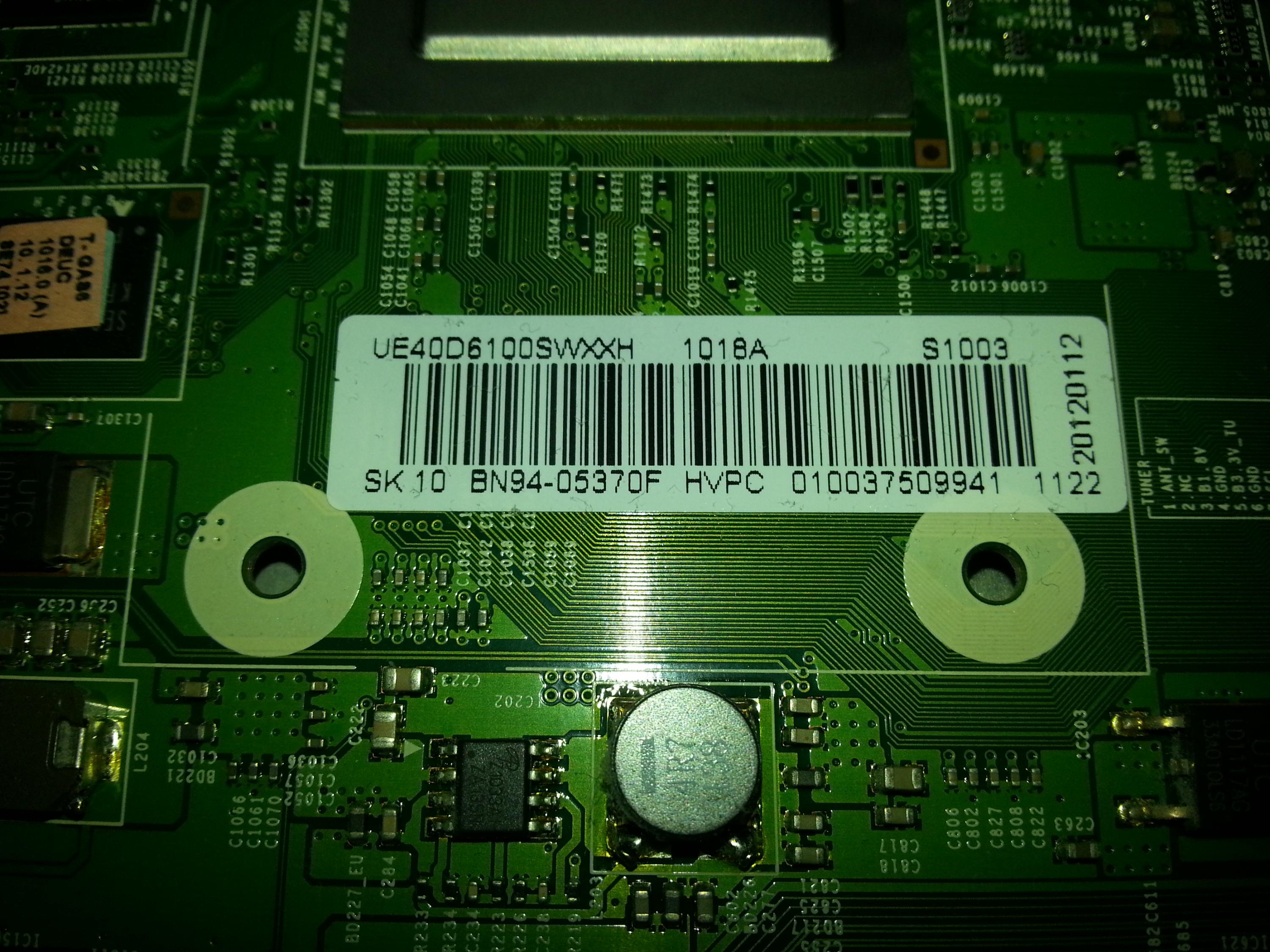

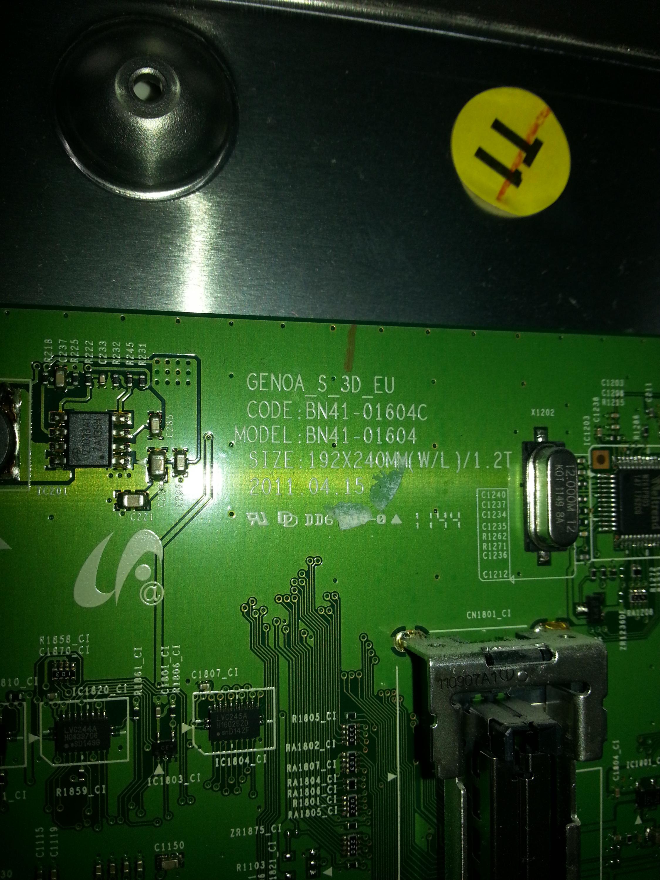

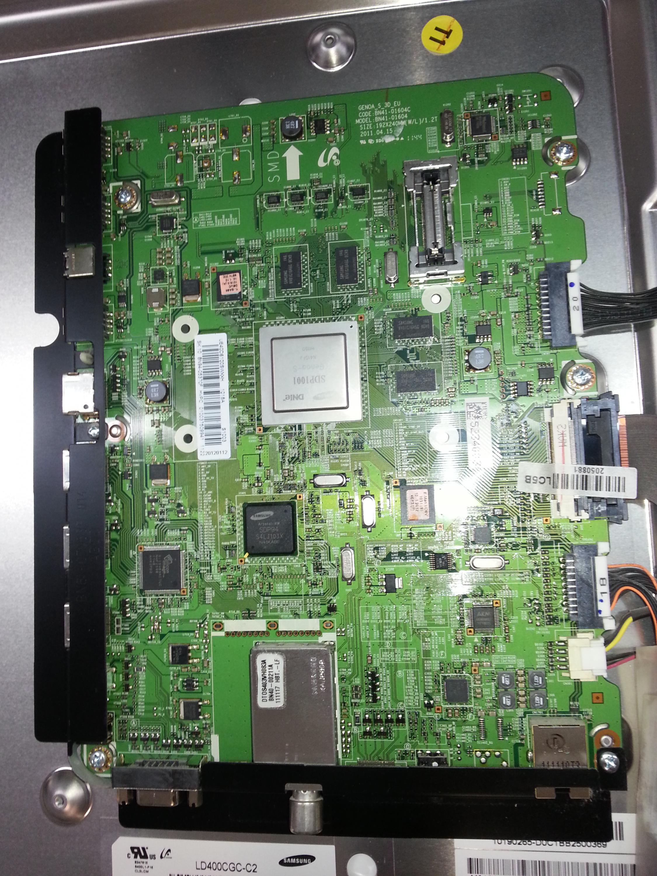

    Good day folks. Trouble in TVLand again This Sammy TV turns on the backlight but doesn't display anything. Moreover, it seems to be stuck in some sort of loop, because after a while it power-cycles. The guy said it quit on him when watching a movie from an HDD, so either the main board is a POS and died under load due to heat, or the firmware got corrupted. The main board is in the pictures...any ideas ? Should I hit that CPU with some hot air ? Is it even worth the trouble ? Cheers.

    LOL.....sorted: blasted the board with some hot air, focusing primarily on the silver CPU and it's working now. It's not going to last - that's a no-brainer, but at least I know I was right in my initial diagnosis
