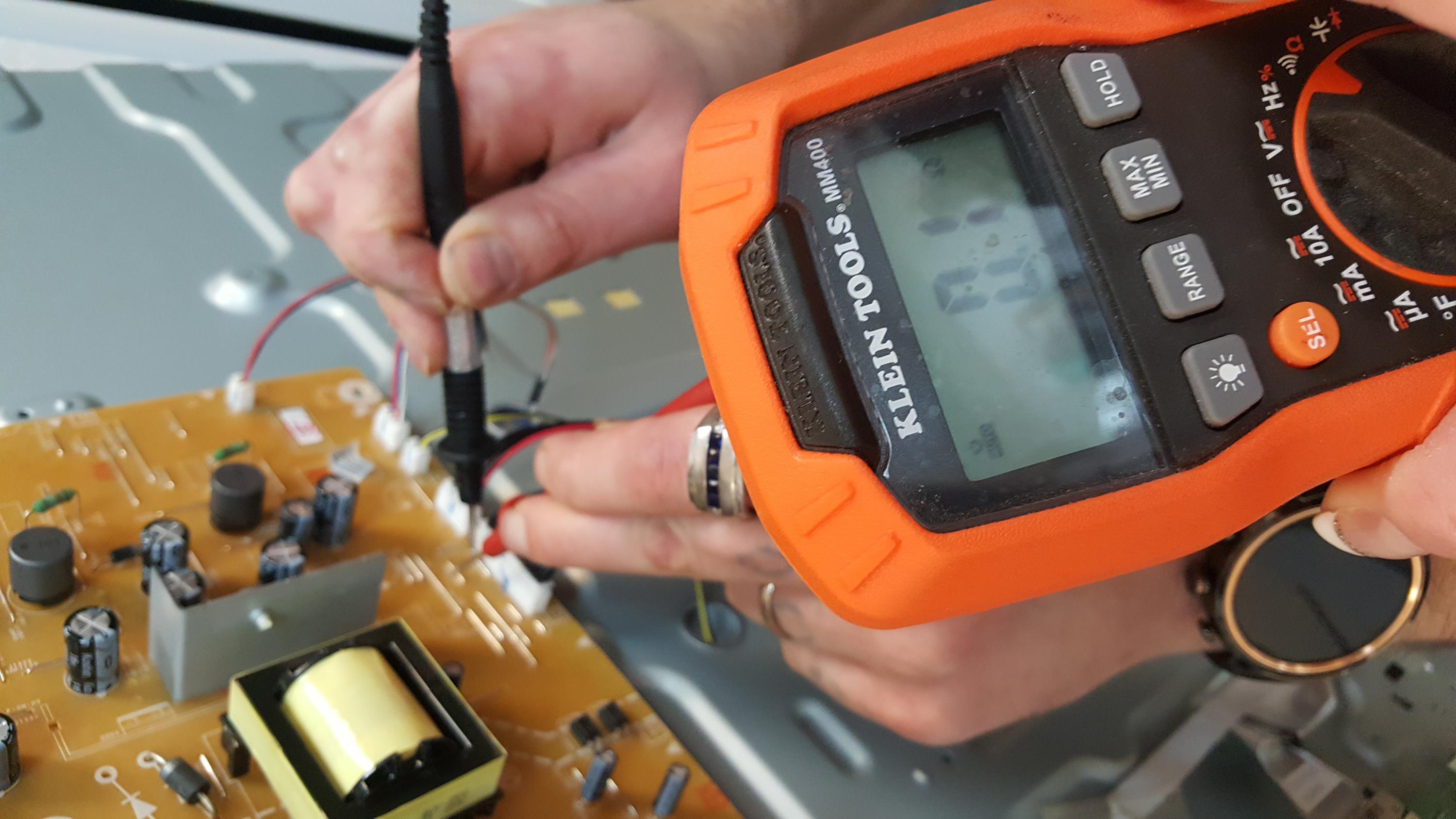

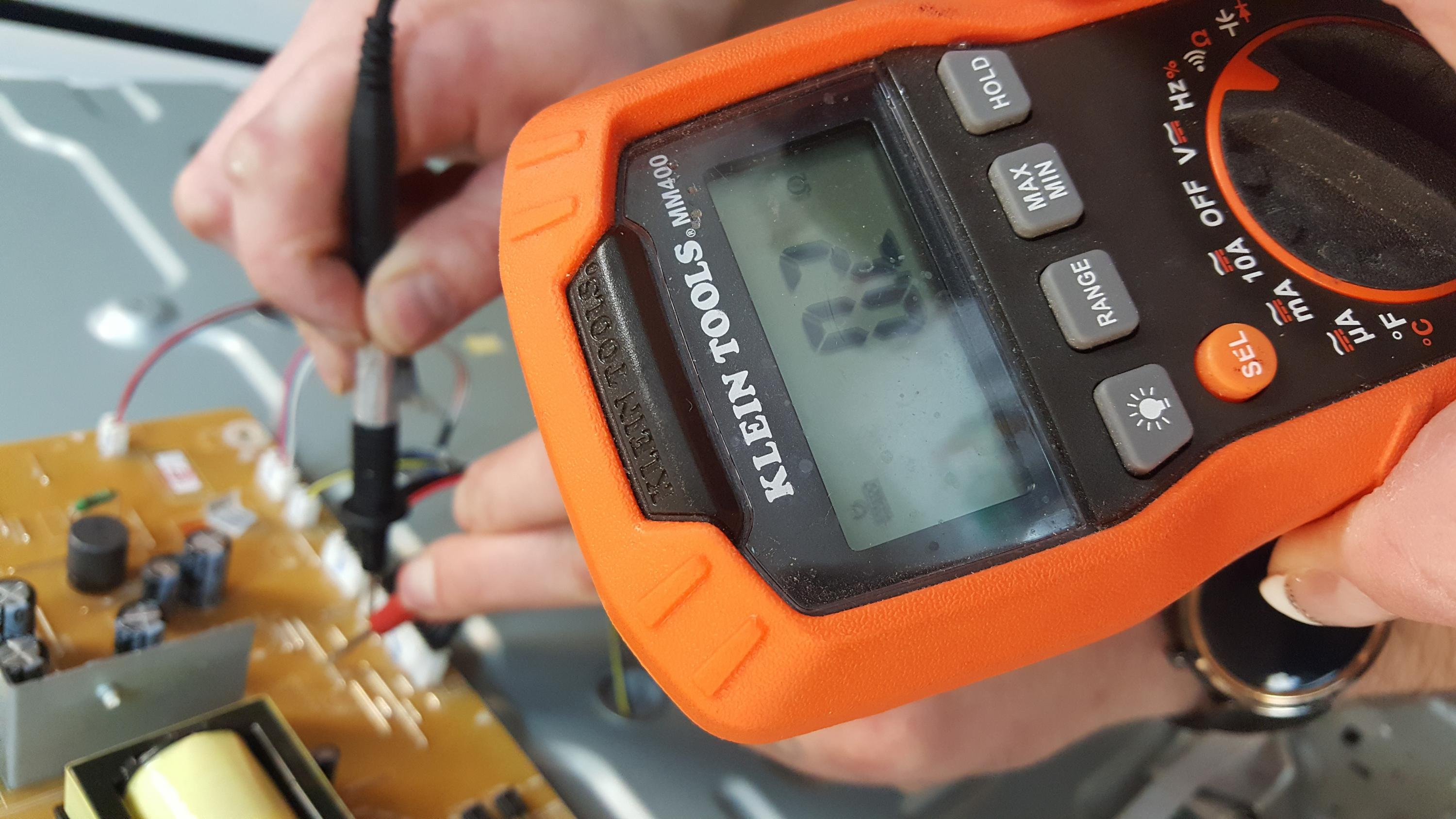

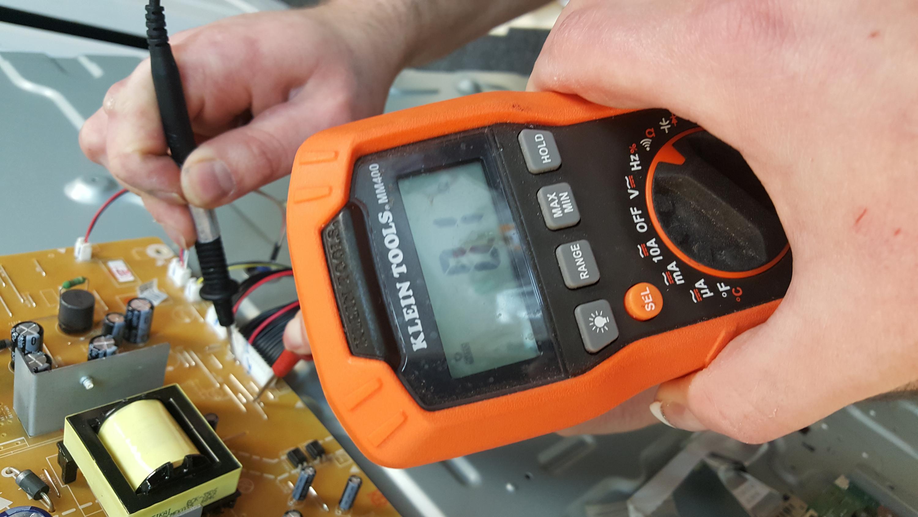

      Alright. Took new readings and had my wife take some pictures. Unfortunately, it's not much different than what I got last time.
      I apologize for the blur, but it shows what it was intended to. Black probe on J622 GND, red probe on J620, J621, J623 respectively. These are the readings I get.

        At this point I think there is something going on with your meter.
        Try taking the resistance reading on one of the 3 diodes (they are sitting in parallel with each other right next to the big yellow transformer.
