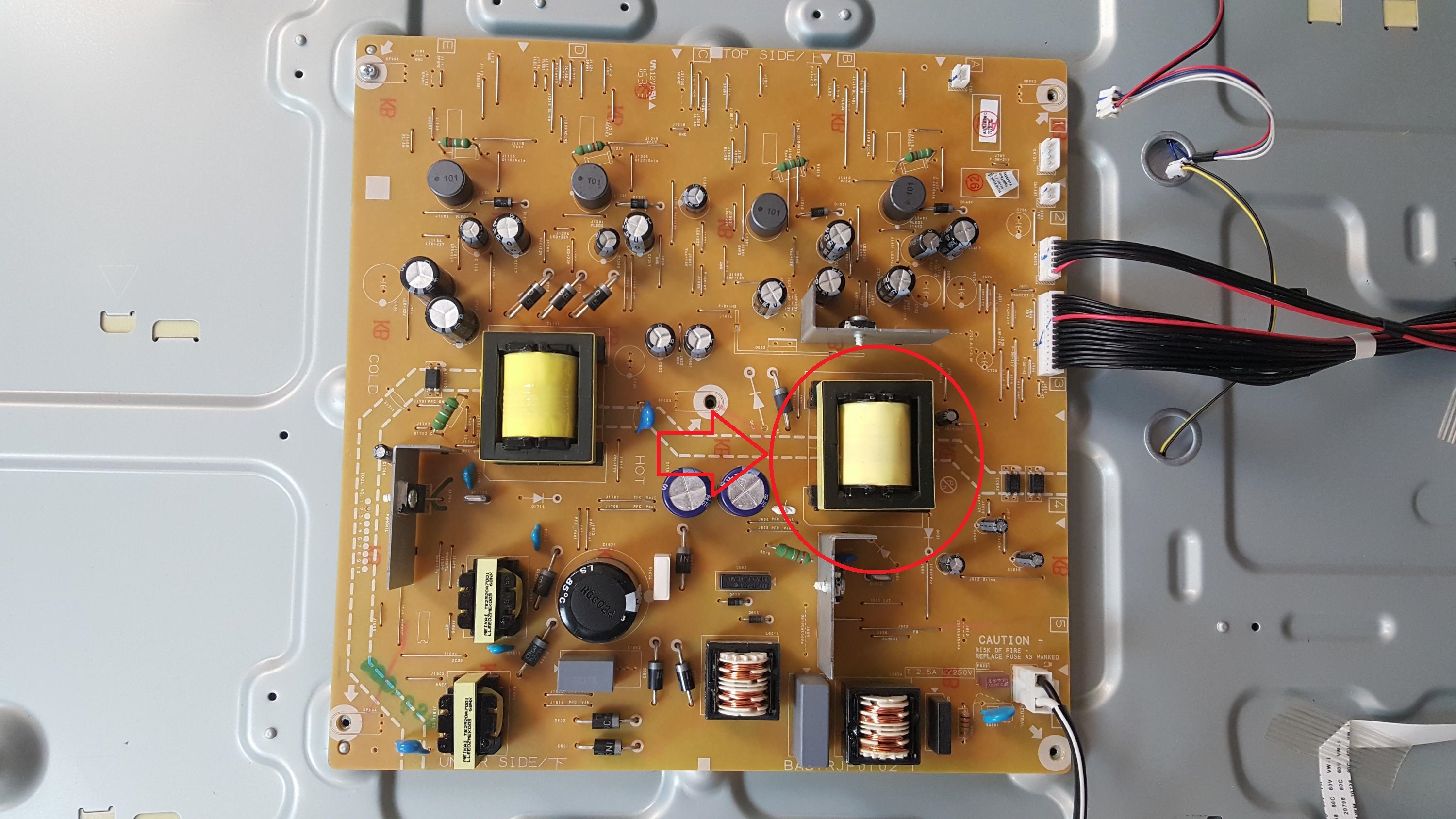

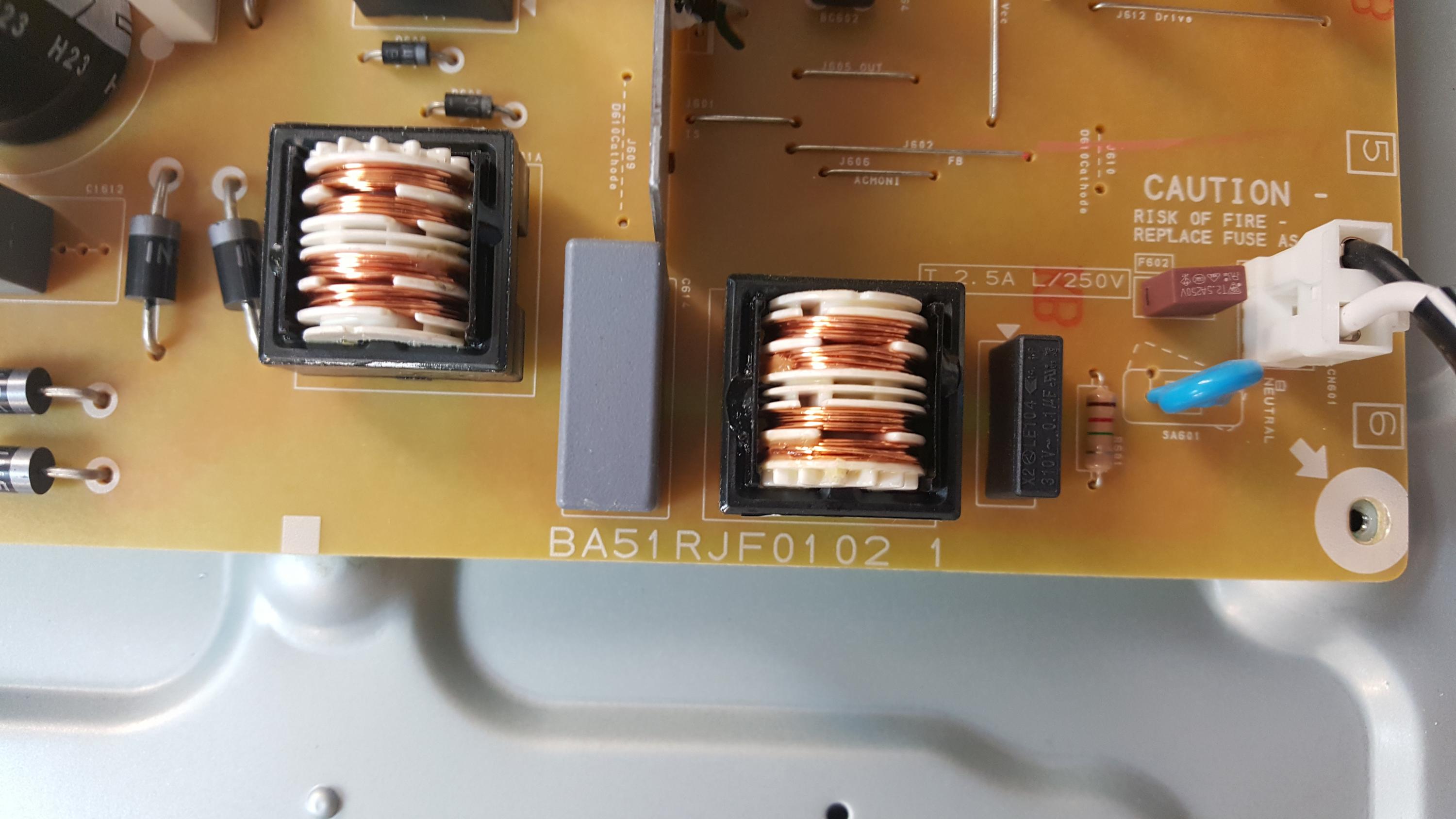

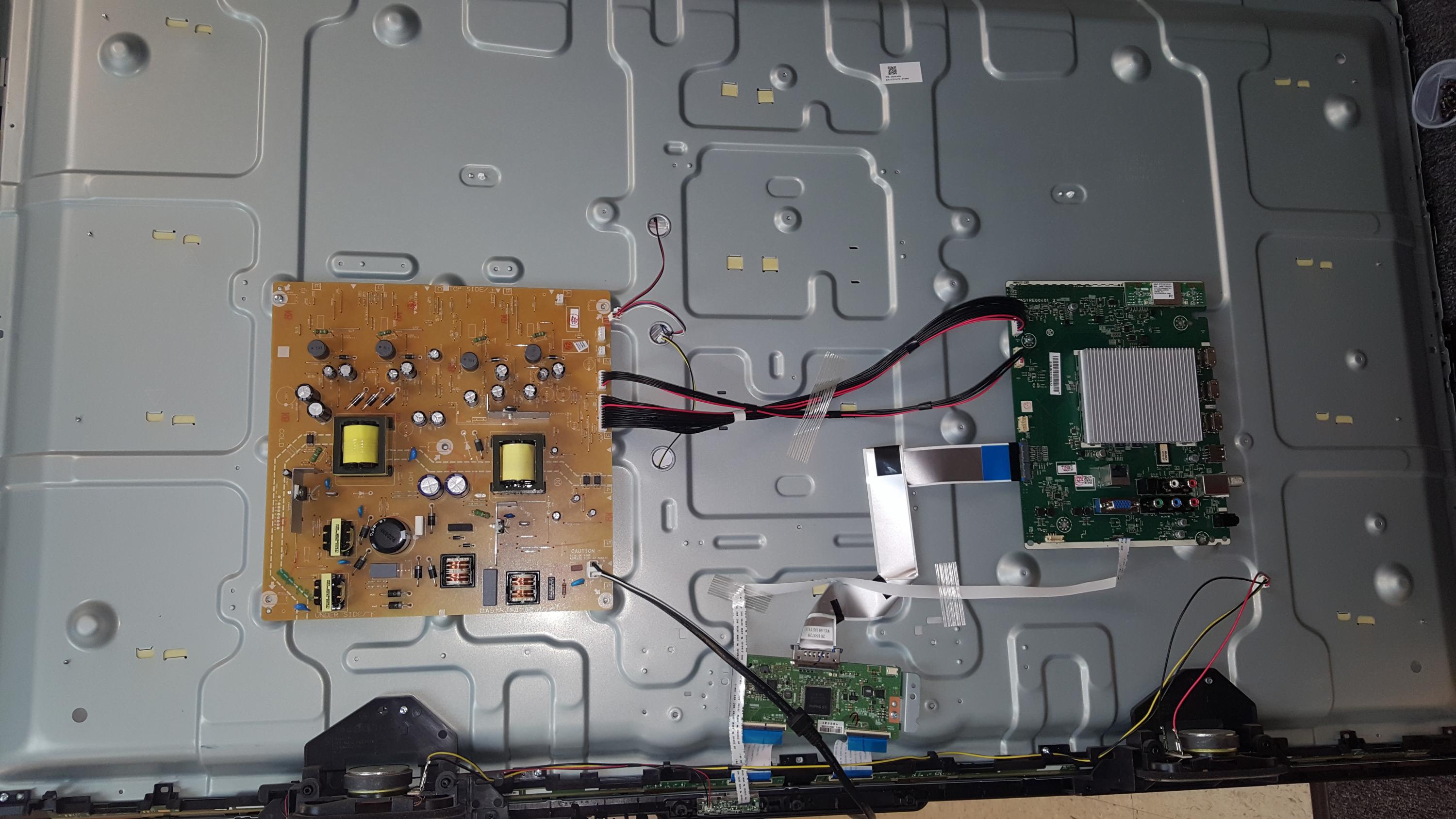

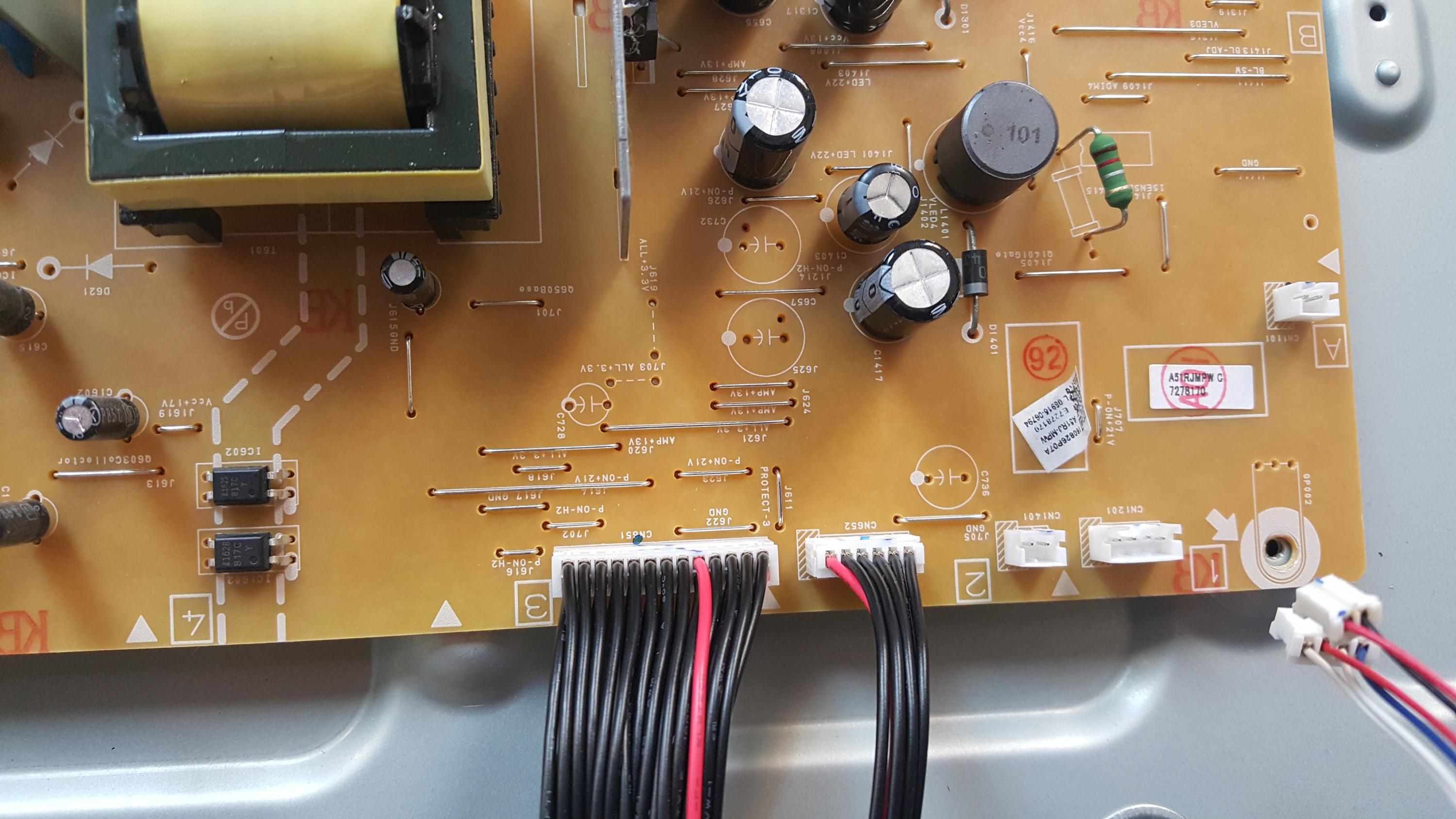

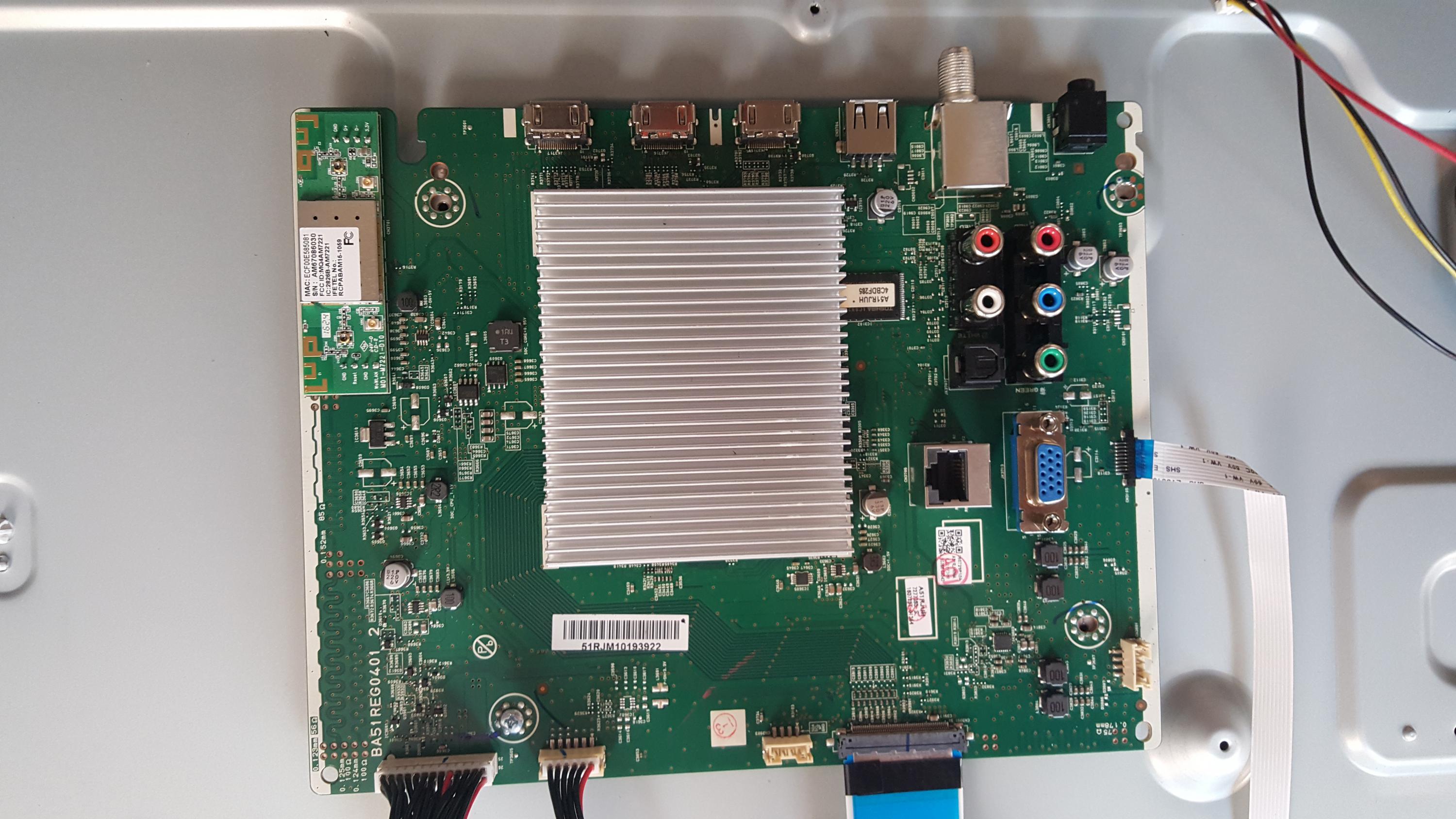

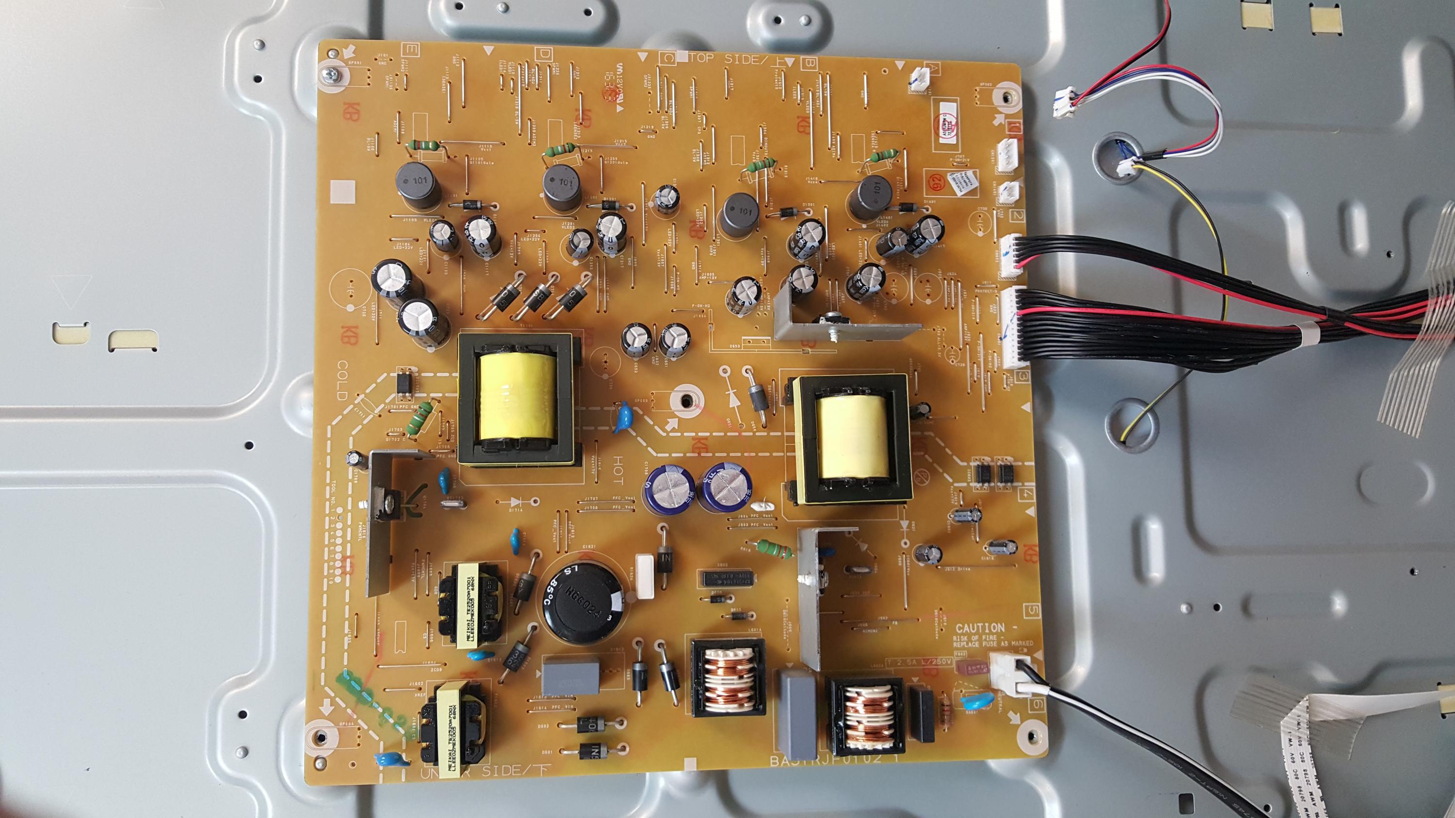

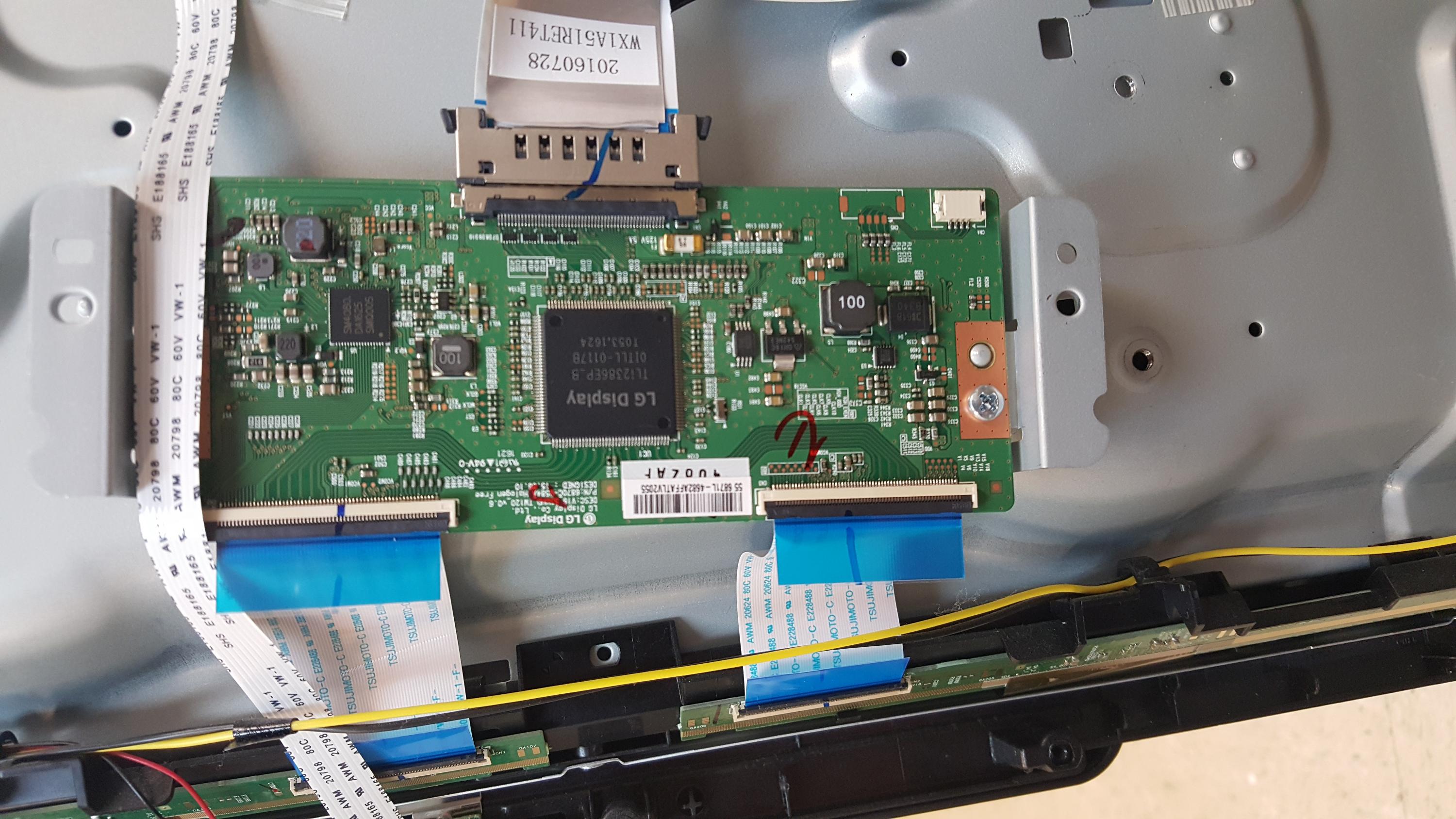

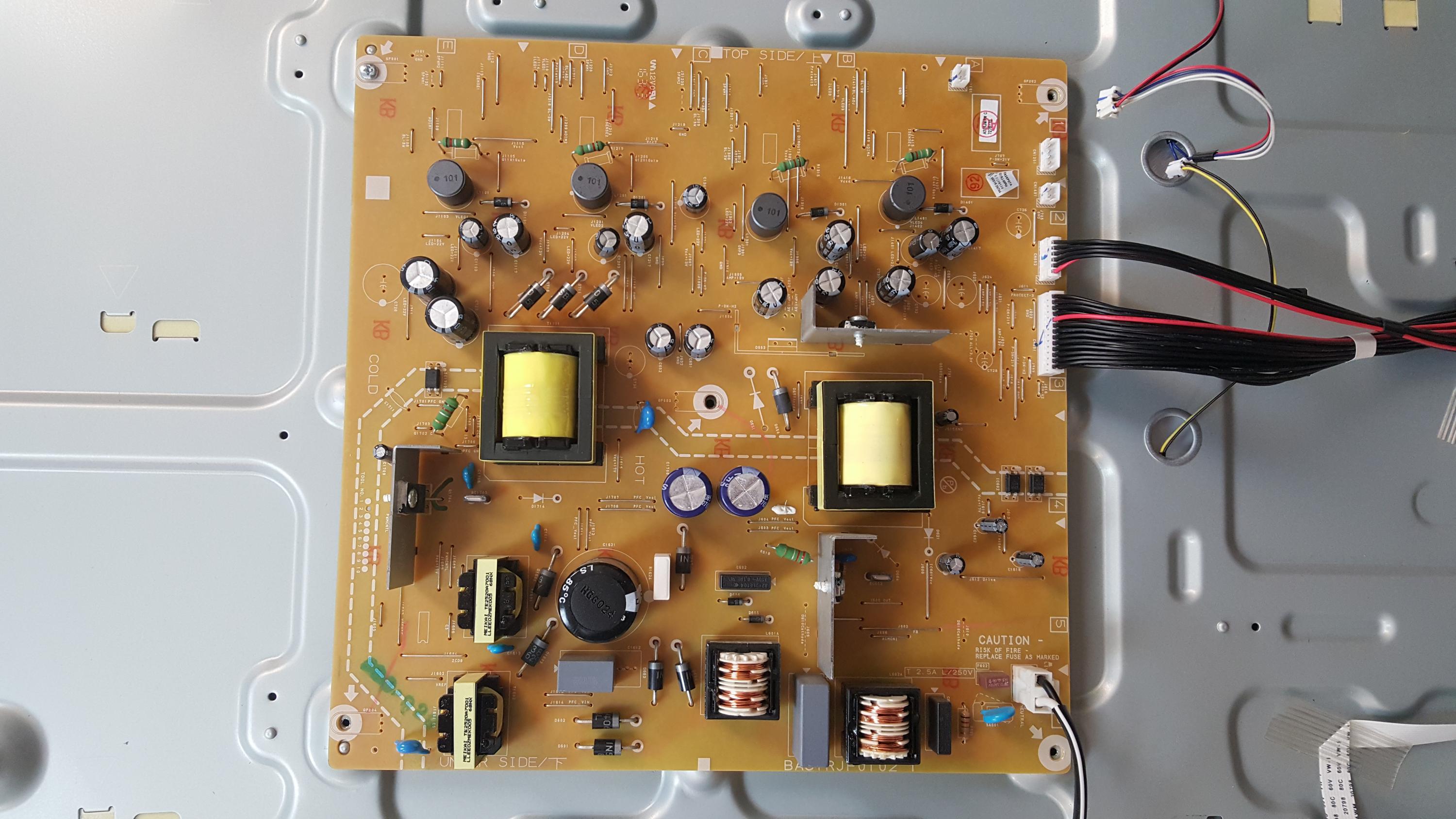

    Hi. I have a Phillips 55PFL5601/F7 here with some problems that I can't pin-point the cause of.
    Some history on the TV, it was brought in to me after it suffered a power surge/lightning strike. I was able to find both the power and the main board pretty cheap and for the sake of time, I went ahead and bought both. Replaced both the main board and the power supply board and the TV exhibits the same symptoms as it did with it's original boards:
    1. No standby LED.
    2. No display.
    3. Voltages on the power supply side fluctuate wildly, not stable.
    4. One of the transformers is making a buzzing sound every 1/2 second or so. "Buzz, buzz, buzz, buzz, buzz, buzz" - as soon as it's plugged into power.
    I have done some minor troubleshooting steps already, like checking the fuses and trying to get some voltage readings on the pins, but as I said, they vary wildly so I can't get anything stable.
    I have tried disconnecting (one at a time and testing after each one) everything except for the power and main board and of course the AC power cable. I did check and saw 121VAC from the wall outlet, just to make certain.
    So being that both boards are exhibiting the same symptoms, what is going on? Could the two main cables between the two boards somehow cause this? What are the chances of receiving two ("new") boards that show the exact same symptoms?
    Here are some photos for ya.

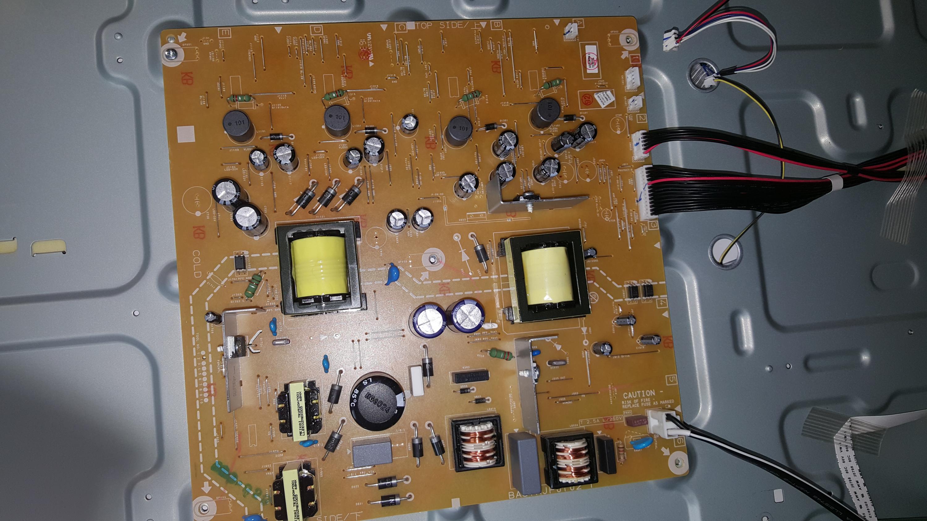

    EDIT: I added a pic and circled the transformer that is making the "buzzing" sound every half second or so.

    1) Is the power supply board still buzzing if you run the power supply board on by itself?
    2) Have all the board connected together and then check the resistance between
    GND and J623 (P-ON+21V)
    GND and J620 (AMP+3.3V)
    GND and J621 (ALL+3.3V)

      1) No, the power supply is quiet when only it is plugged in and powered on.
      2) Resistance between the jumpers you listed and GND is as follows:
      J623-13.9 and dropping
      J620-0.L
      J621- 58.0

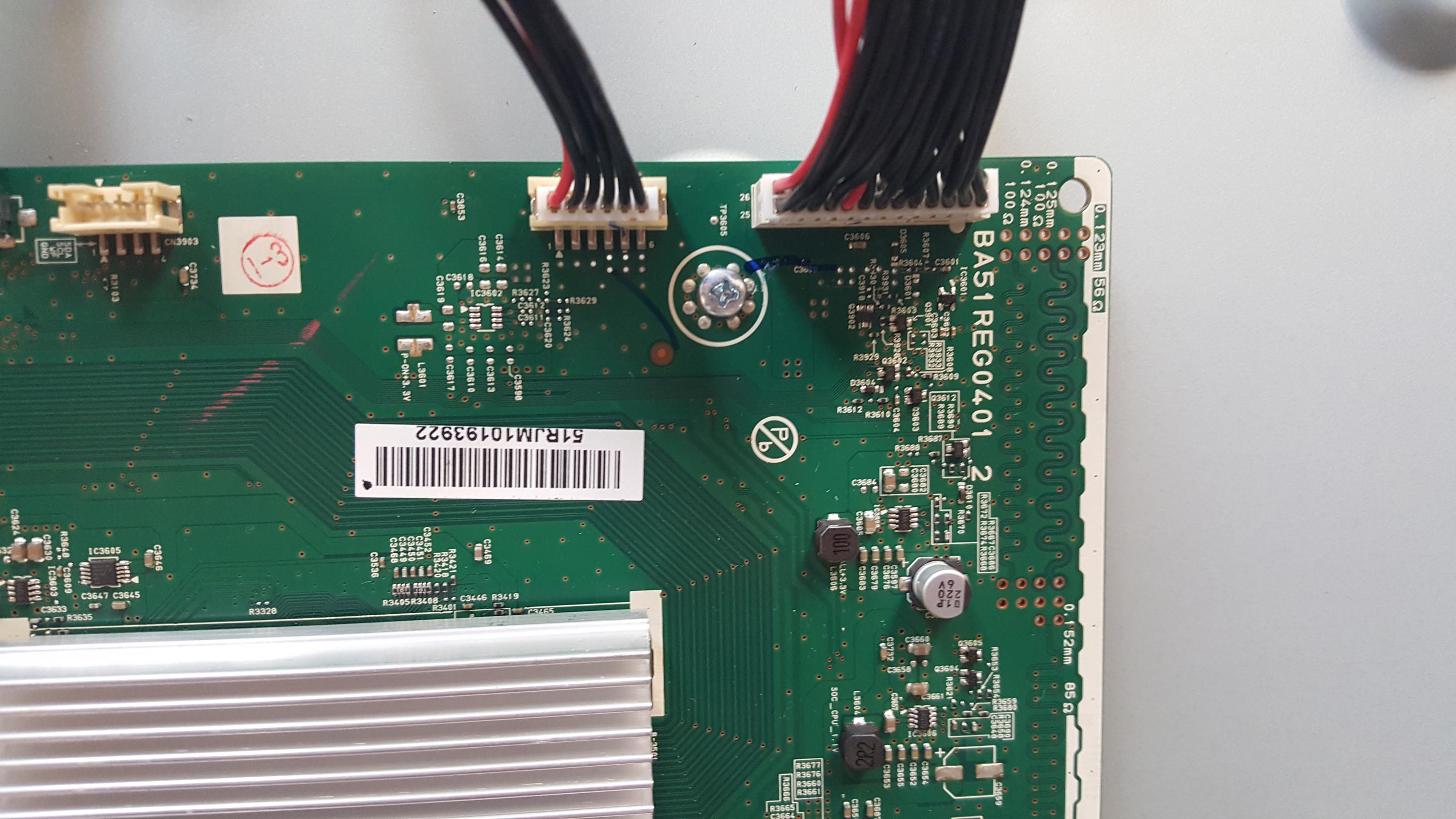

          I'm having trouble locating a capacitor labeled as C3214 on my main board. I've looked over it several times. In fact, I cannot find capacitors in the C32xx range at all. They go from C30xx, C31xx, C33xx, etc.
          I cannot find a single C2xx labeled capacitor anywhere. Maybe I'm just blind though.
          BA51REG0401 2 is the main board number.

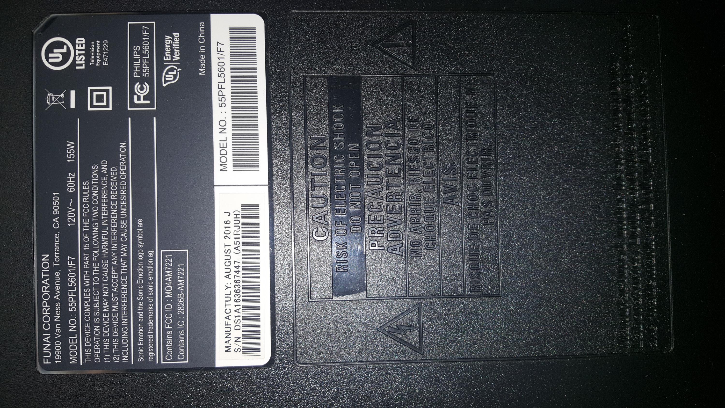

            In this case we need to find the service manual for the main board or you will have to trace the P ON+21V to see where it goes to on the main board, there will be many places.
            Please look at the back of the TV where the model number sticker is, see what the Chassis number is.
            Is it PL 11.8?

              I don't see anything about Chassis number.

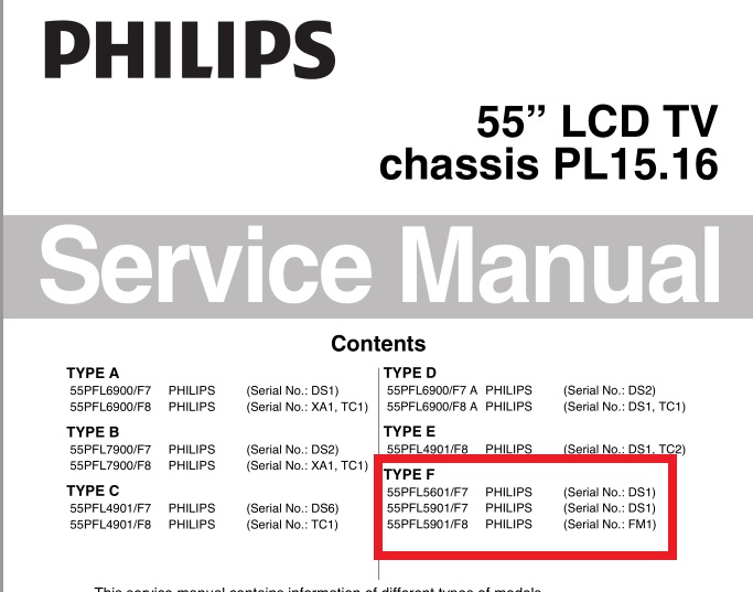

                  I found a service manual that lists my model on the cover page of it.
                  I attached it to this post. Is that what you need?
                    Re: Phillips 55PFL5601/F7 - No Standby, No Power, Fluctuating Voltages...
                    Yep!

                          It looks like you have type F main board, so look at all the caps connected to the P-ON+21V to find out which one is bad.
                              Alright. So I tested C3606, C3641, C3639, C3731, C3624, C3630, C3734, C3735, C3631. I also tested D3602, D3604, R3610, and R3612. Everything seems to be in working order. The ones that are marked "OPEN" on the schematic are not present on the board.
                                None of the resistance reading on those caps show 13.9 Ohms that you indicated in post #3 when reading the resistance between GND and the P-ON +21V?
