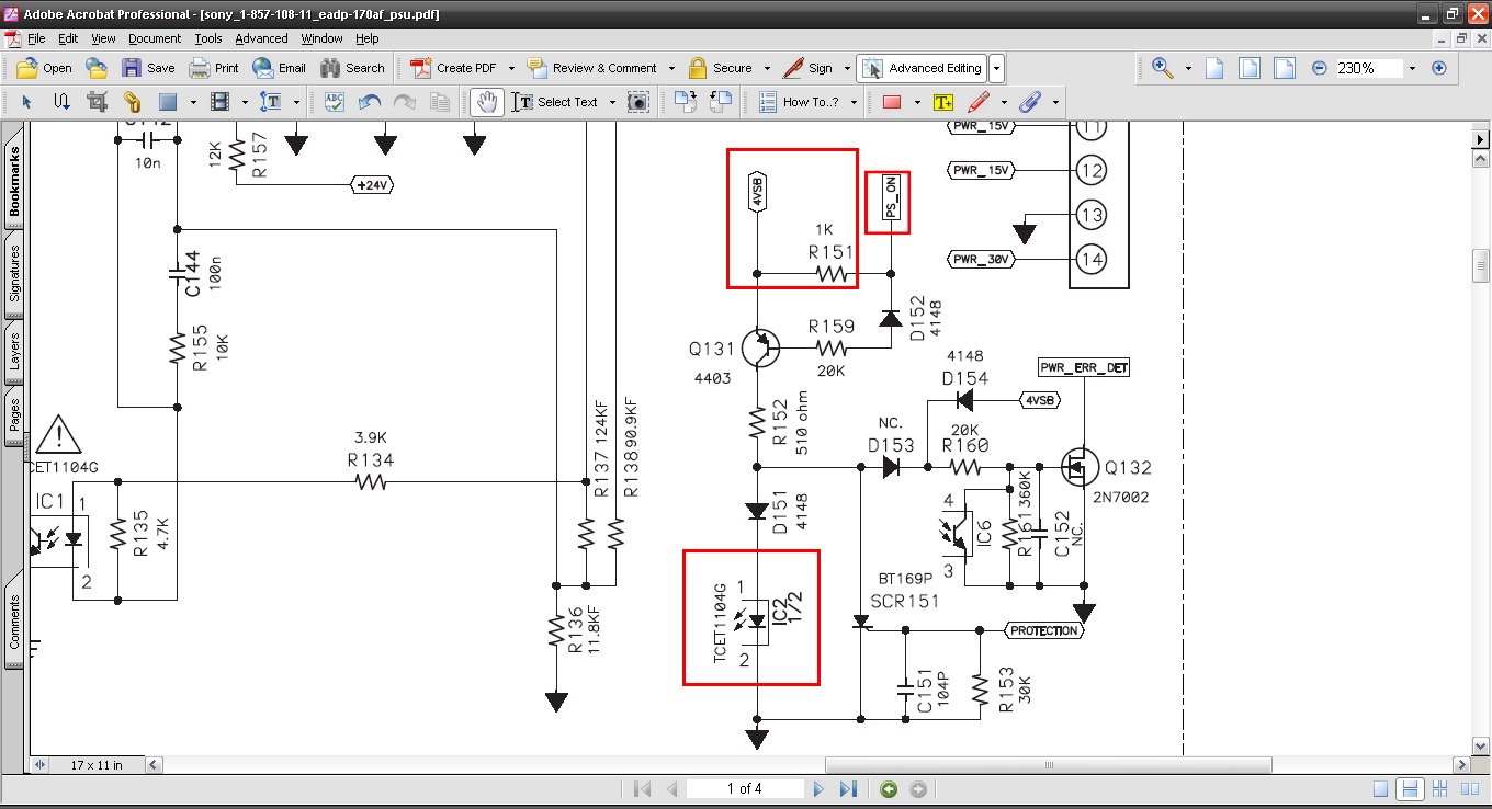

        The power supply converts the 120/230vac 50/60Hz into DC, then the high frequency (50~100kHz) switching circuits convert it back to AC but at high frequency ... then this high frequency AC voltage is fed to the rectifier Diodes to get the DC output and filtered by DC filter capacitors
        So we know that the board powers on and produces 4 VDC, but not the other voltages. What does this tell us about where the fault on the board might lie?

          Since we have the schematic this will allow us to trace out the circuit to find out if the SMPS IC's and various circuits are getting the switched VCC for the circuit to run or not.

              You will have to learn to read the schematics and able to trace the connections based on the schematic. You will need to plug the TV into at least the GFCI outlet in case you accidentally touch the connections on hot side of the boards which is where you will be checking. The board will have to be flipped over for you to access the test points of the power supply board.
              The black probe of the meter will be connected to the negative leg of the main filter cap in the hot side of the board, then you will use red probe of the meter to check and see what DCV you have on the Emitter pin and on the Collector pin of the transistor Q202.

                            So the transistor is providing 11.86VDC for running VCC of many IC's and also for relay RL1.
                            the PFC IC ic31 (L6562: https://cdn.badcaps-static.com/pdfs/...1fdeef964c.pdf) has turn-on Voltage range of 11 ~ 13V. So that should be enough for it to run.

                              It needs logic low for it to come on so you have either GND the PS-ON or just have everything connected up and see if the TV will function or not.

                                    Since you have working board right now then you should record the Voltage readings of all the pins on the power supply to have it as future reference.
                                    See attached pdf. PS ON is 4.16 in standby and 0 once powered on. Same if board only is powered and the connectors are not plugged in. So it seems that you don't need it tied to ground in order for the board to work, only to power on the board.

                                      So your new board is:
                                      "PS ON is 4.16 in standby and 0 once powered on. Same if board only is powered and the connectors are not plugged in. " This does not make sense to me, if you run the power supply board by itself without having it connected to the main board so when you plug in the AC power cord it will be in standby mode which means the Voltage on the PS-ON pin should be at around 4V, it cannot be at 0V because it has pull-up resistor R151 to keep the power supply off BY PULLING PS-ON PIN HIGH when it is not connected to the main board, you can tell if the power supply is really off or not by checking the DCV on the main filter cap, it will be only around 160V.
                                      The 15V, 24V, and the 30V should not be present when you run the power supply board by itself.
                                      If you look at he schematic you will understand why the power supply board will not be on when it is not connected to the main board, the only power supply section that will be running is the 4VSTBY power supply.

                                          "So it seems that you don't need it tied to ground in order for the board to work, only to power on the board.":
                                          Based on your last reply, it is not true then that if the PS-ON is not tied to ground the power supply board WILL come on, so lest forget about it for now. We know you have bad power supply at this point.
                                          So back to the bad power supply board:
                                          1) if you run the power supply board by itself without having it connected to any thing, when you power it up the Relay RL1 will be clicking on and off, correct? If this is true this problem will have to be fix first because some how is able to come on without having the PS-ON grounded, RL1 should never come on without grounding the PS-ON pin.
                                          2) if you run the power supply board by itself without having it connected to any thing and you GND PS-ON pin you do not have > 360VDC on the main cap, correct?
