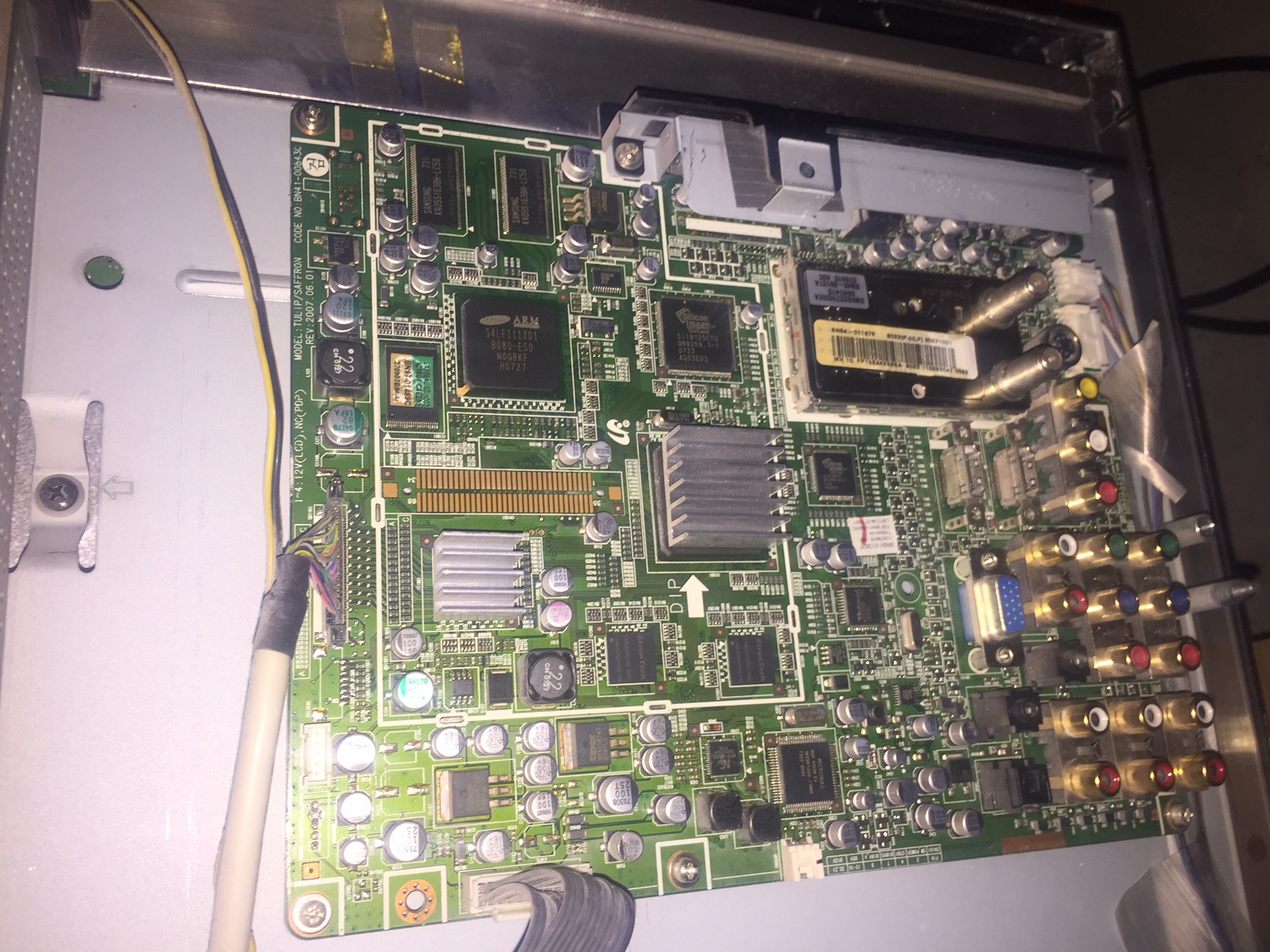

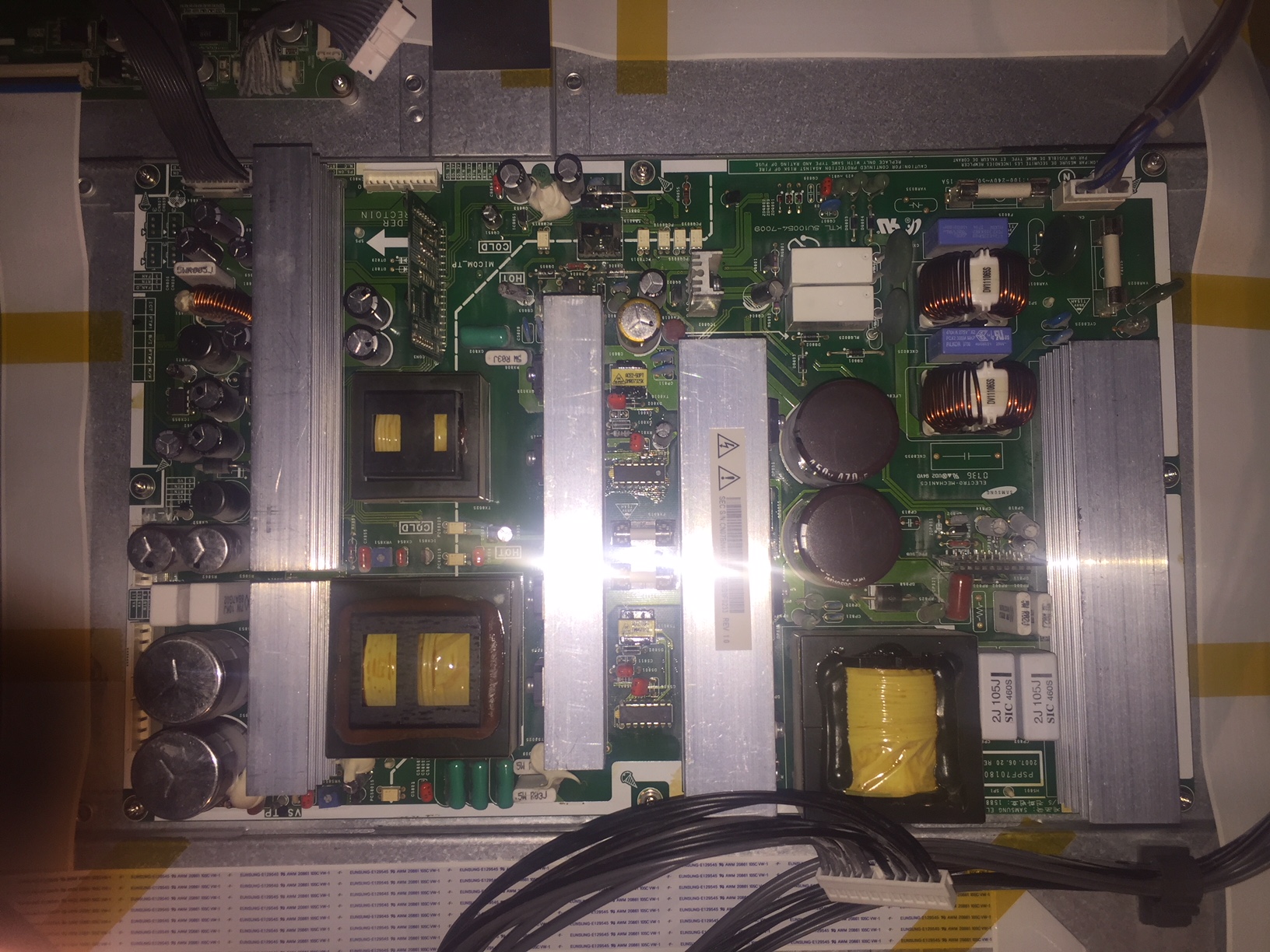

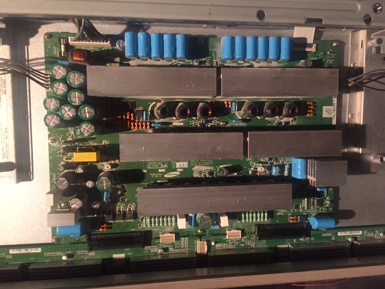

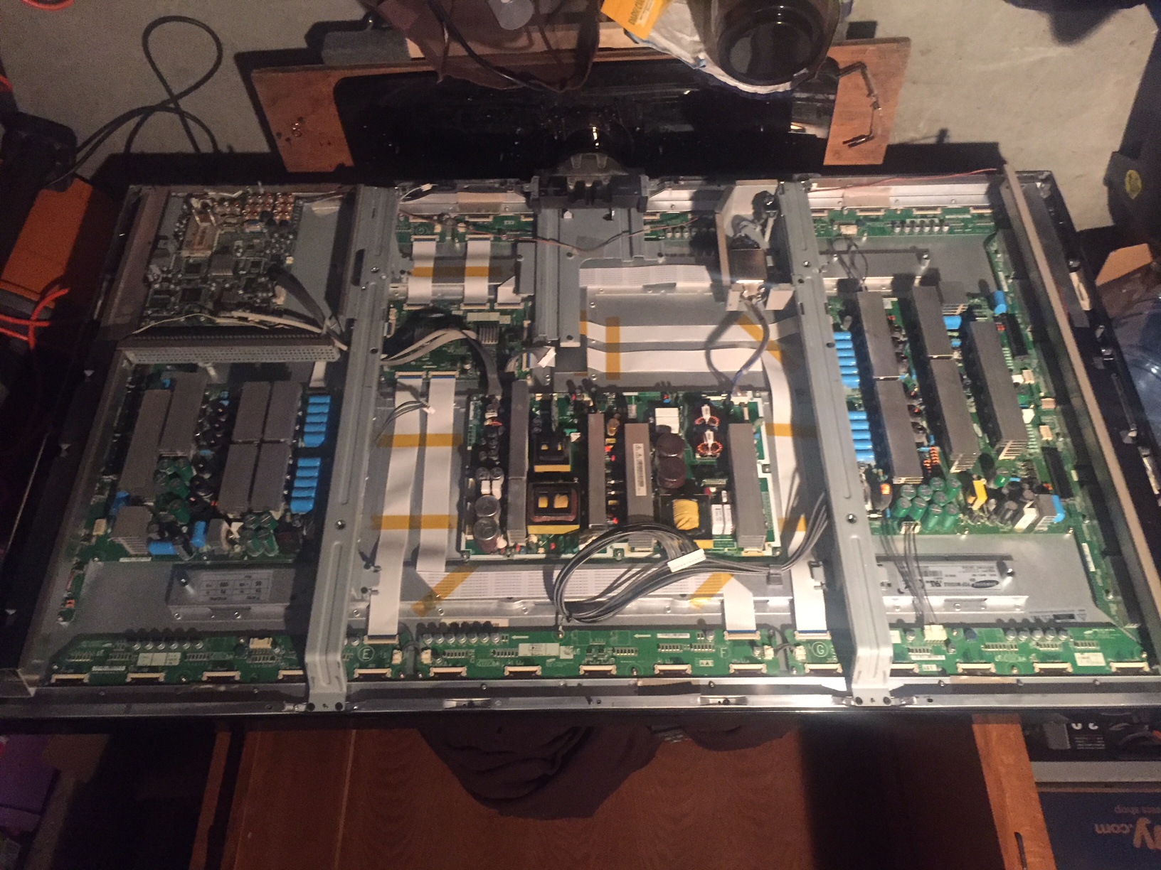

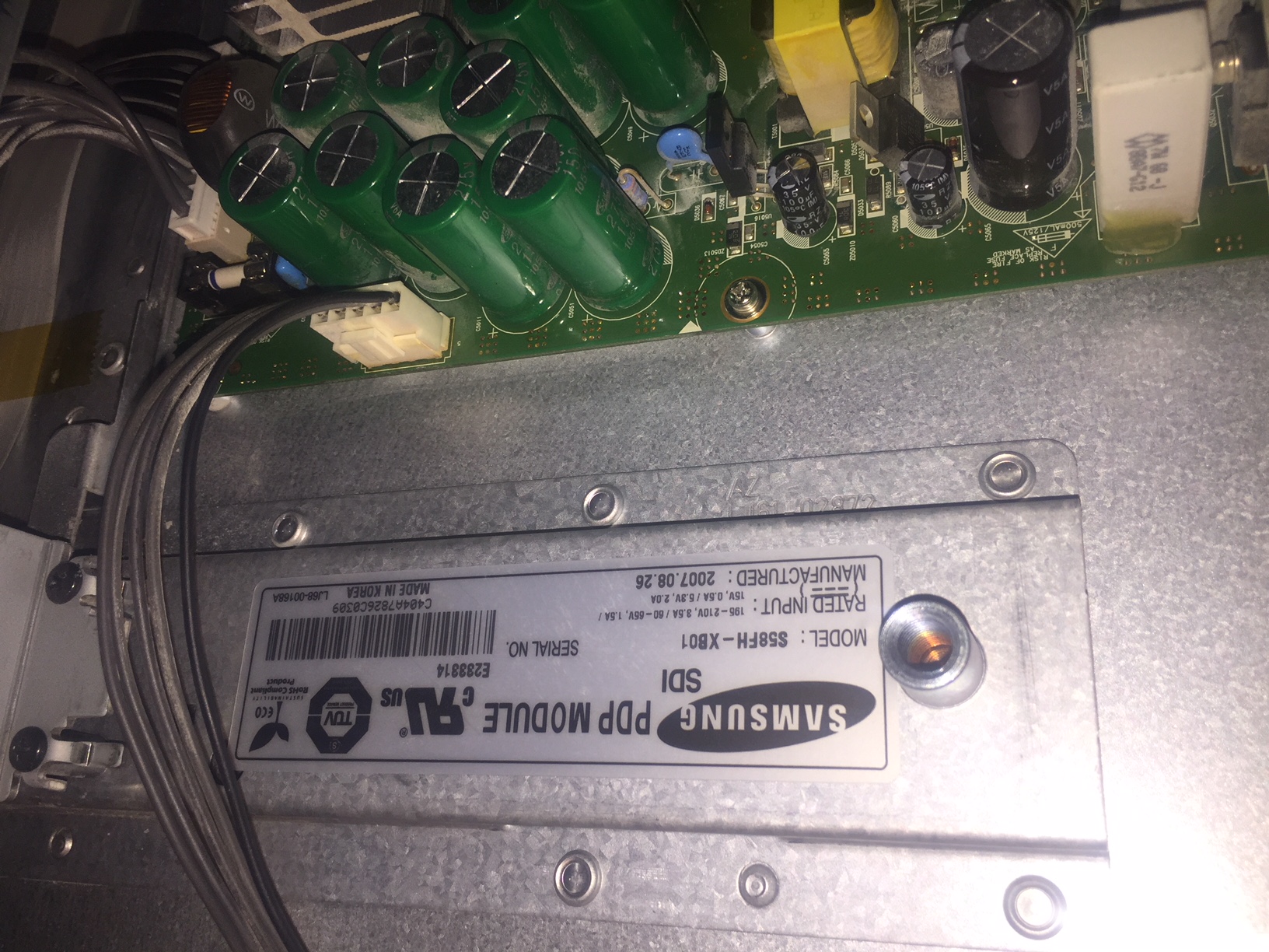

    I picked up this large, 58" plasma set and it has two problems that I need to fix.
    1) POWER SUPPLY ~ TV KEEPS SHUTTING DOWN + REPEATED CLICKING
    I can turn it on and it will operate normally and display channels (with the DirecTV signal hooked up through one of the HDMI ports) but it turns itself off after about a minute.
    Sometimes it will stay on for two minutes or even three, but it always shuts itself down and then the relays on the Power Supply Board begin to click while the screen is entirely black. It's obviously attempting to turn itself back on, as evidenced by the fact that every once in a while during my testing it will indeed come back and display a picture .... but for only a few seconds before shutting down and the repeated clicking begins again.
    I took the back off and visually inspected all of the capacitors and there is no obvious bulging or leaking on any of them. Hopefully, the pictures I posted will convey that. Please let me know if they are clear enough.
    I then unhooked all of the connectors coming off of the Power Supply Board to try to isolate the problem. When they are all unhooked, the tv does not turn on at all when plugged in. Then, I hooked up the connector from the Power Supply Board to the Main Board ONLY. This single connection / combination produced the same sequential turn on / shut down after a minute or two / clicking that plagues it just the same when all of the connectors coming off the power supply are active and in play.
    So, does this tell me that the problem lies in the Main Board? Or, perhaps the problem is actually on the Power Supply Board itself but that only reveals itself when the connection to the Main Board is made? I think alot of these Samsung sets will not operate at all unless at least the connection to the Main Board or Logic Board is made.
    I'm hoping that this is a relatively common problem that others on the forum can help me isolate down to one particular board. And then go from there.

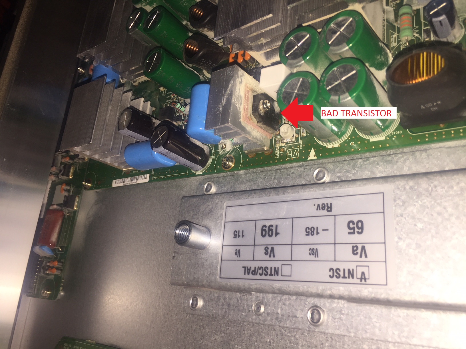

    I'm currently working on a similar issue with my own Samsung 60" plasma. What I will tell you is that your clicking sounds are not coming from relays, as there are no relays on the power supply boards. That clicking sound is the sound of capacitors charging and discharging rapidly due to a fault. Occasionally the clicking will also be associated with a transistor beginning to short out and arch.
    I've replaced my power board on my TV twice now...the first time it failed it had similar symptoms to what you're describing, but eventually that final "click" was actually a "pop" and I saw a blue arch light emit from the TV when it popped. Basically if you have bad capacitors, eventually they will short out and cause a transistor to short, causing a bad arch. Sounds like you haven't reached that point yet, but if you keep using your TV eventually this will happen.

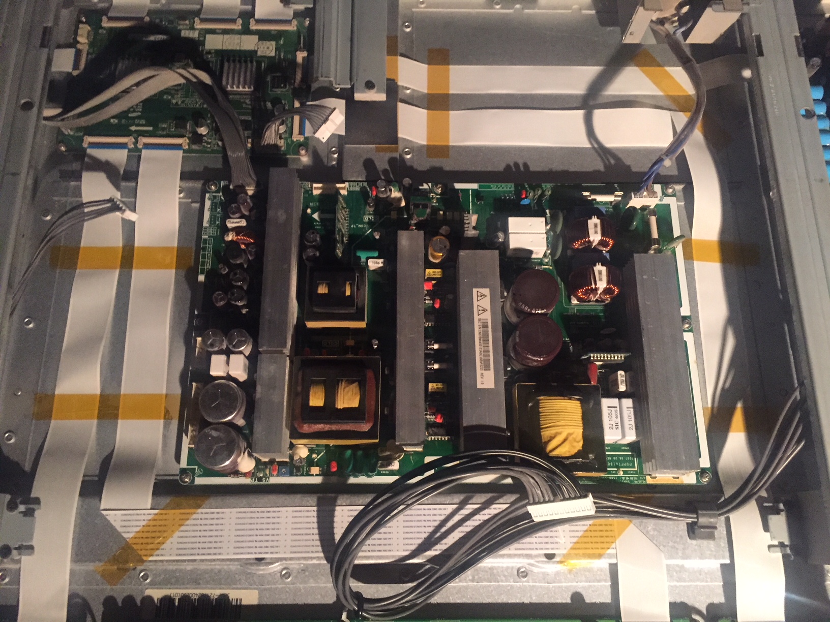

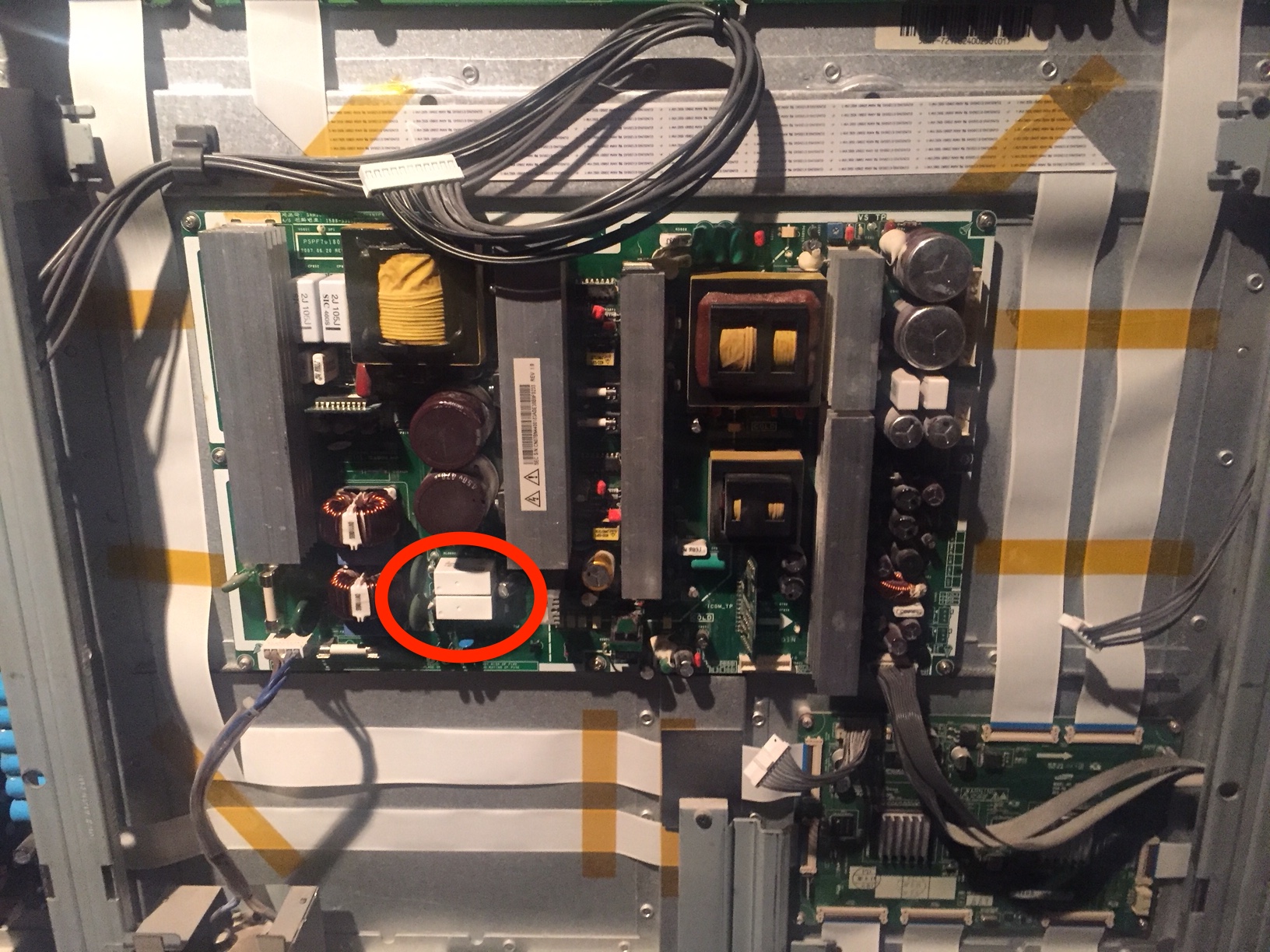

      I am including a picture of the PSU here, with the source of the clicking noise circled in red. Not only am I sure that these two components are making the sound auditorily, but when I place my finger on them they are definitely creating a tactile response.
      Are these two, rectangular components not the relay switches? Thought they were, but maybe they are actually capacitors also? Please let me know what you think. Thanks.

        Re: Samsung 58" Plasma TV (FPT5884X/XXA) keeps turning itself off + clicking
        yes, they are your p/s relays.
        first thing to do is remove the p/s and check all of the solder joints. especially on any fets, transformers and riveted components.

                it could be many things. i'm not the best with plasma's, but i can get you started.

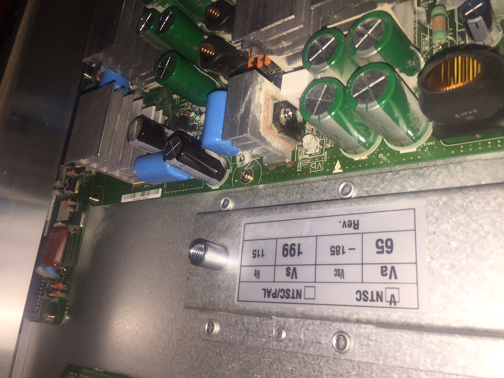

                after you have gone over the p/s, check to see if vs and va are matching the panel sticker.
                    Those are not relays. These are Kemmet film capacitors. TRUST ME. Please see below:
                    • znavy264
                      • Jul 2018
                      • 13

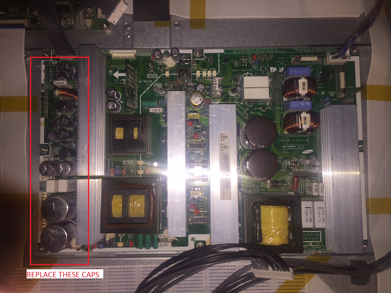

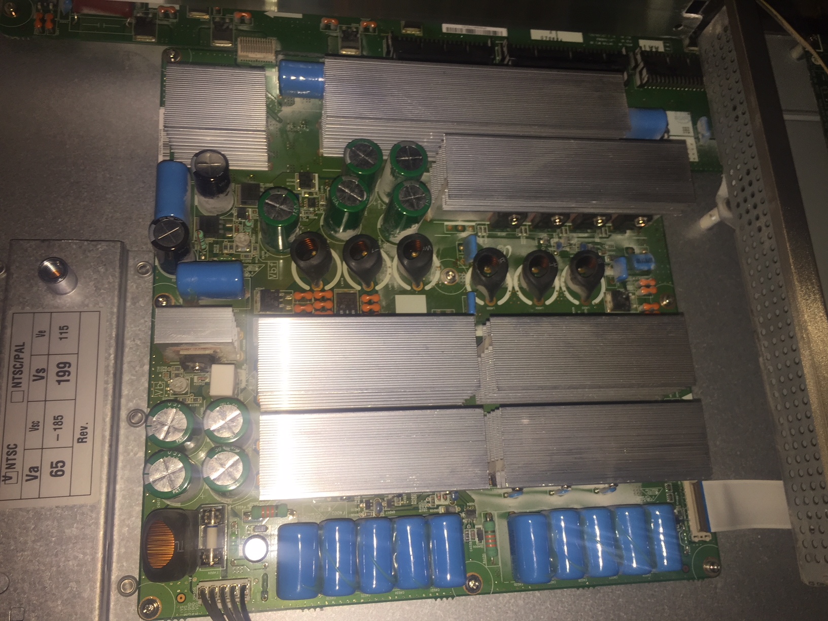

                      Please check out the attachments. Based on your pics I see a component that looks like it should be replaced. But the problem with bad transistors is that the capacitors, diods and resistors surrounding that transistor could also be bad.
                      Also, the other attachment is of your PS card, which you should replace those capacitors for good measure.

                        If you have the PSPF701801A/BN44-00183A power supply, then a common failure on this board are the two green thermistors to the left of the relays you marked in photo #3. They are marked either RLQ/RTQ 801S and 802S. They should measure around 10 ohms. Also, looks underneath the board and look for bad solder joints/ overheating around these thermistors.
                        • R_J
                          • Jun 2012
                          • 9588
                          Check your standby voltage, it should be +5.2 volts, then check the voltage out of ICQ802, it is the +15 volt regulator that drives the relays, I believe it is located near the 2 relays, to measure the +15 volts you must use HOT ground for your negative probe, you can use the tab of the regulator ic itself for ground, then check the voltage at RQ802 (resistor directly behind the relay)
