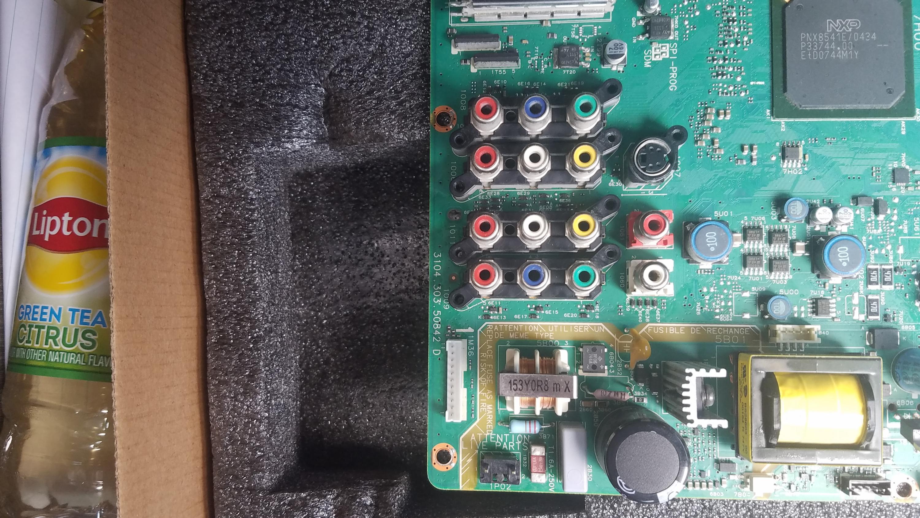

    I'm trying to repair the SSB board on my Phillip's 52" Tv that all the HDMI ports don't work. I discovered what looks like a voltage regulator with capacitors surrounding it blown off and discolored. The Ceramic capacitors and what appears to be voltage regulator have no part numbers on it so I can repair. I part number for the SSB is 3104.303.50842-D. I'll add a photo of the spot in question but more need the schematic so I can get the correct components to replace. All help greatly appreciated

            7B06 = PHD38N02LT

              Look I've been on the phone an online for hours looking for the schematic only to have TV repair professionals tell me that "no one does component level repair anymore" and "robots put those small components on there so I can't help you". I've read through the Q523.1U_L manual not seeing anything about 52pfl722d/37 or 3104.303.50842 mentioned anywhere. I exhausted every legit way to find it without posting here. I'm tired, I'm frustrated, I'm confused, and I'm doing this all at work on my cellphone when I get a break. I just needed to see the schematic to make sure that those components tie in with the hdmi and what rating the capacitors I removed were, so I can replace. It's a simple question that has taken me much longer to answer than most problems I run into so forgive me for being short. I didn't want to bore everyone in the forum with my personal problem so I omitted what I had done already.

                      Re: Phillip's model 52pfl7422d/37 chassis Q523.1U_L service manual needed
                      That device in question 7B06 is the power MOSFET for +5V-STANDBY @Source pin.
                      See block diagram on PDF page 57.
                      See schematic on PDF page 75.
                      There is a fuse feeding that MOSFET.
                      The 3104.303.50842-D is the blank PCB P/N
                      The service manual for that section of the power supply is more than close enough to check that standby power supply section to see if you have +5V-STBY or not.
