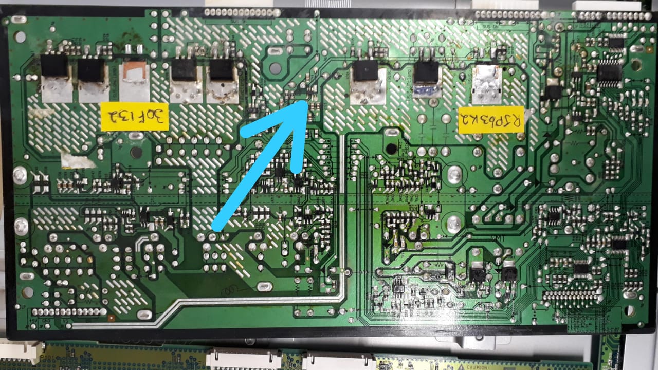

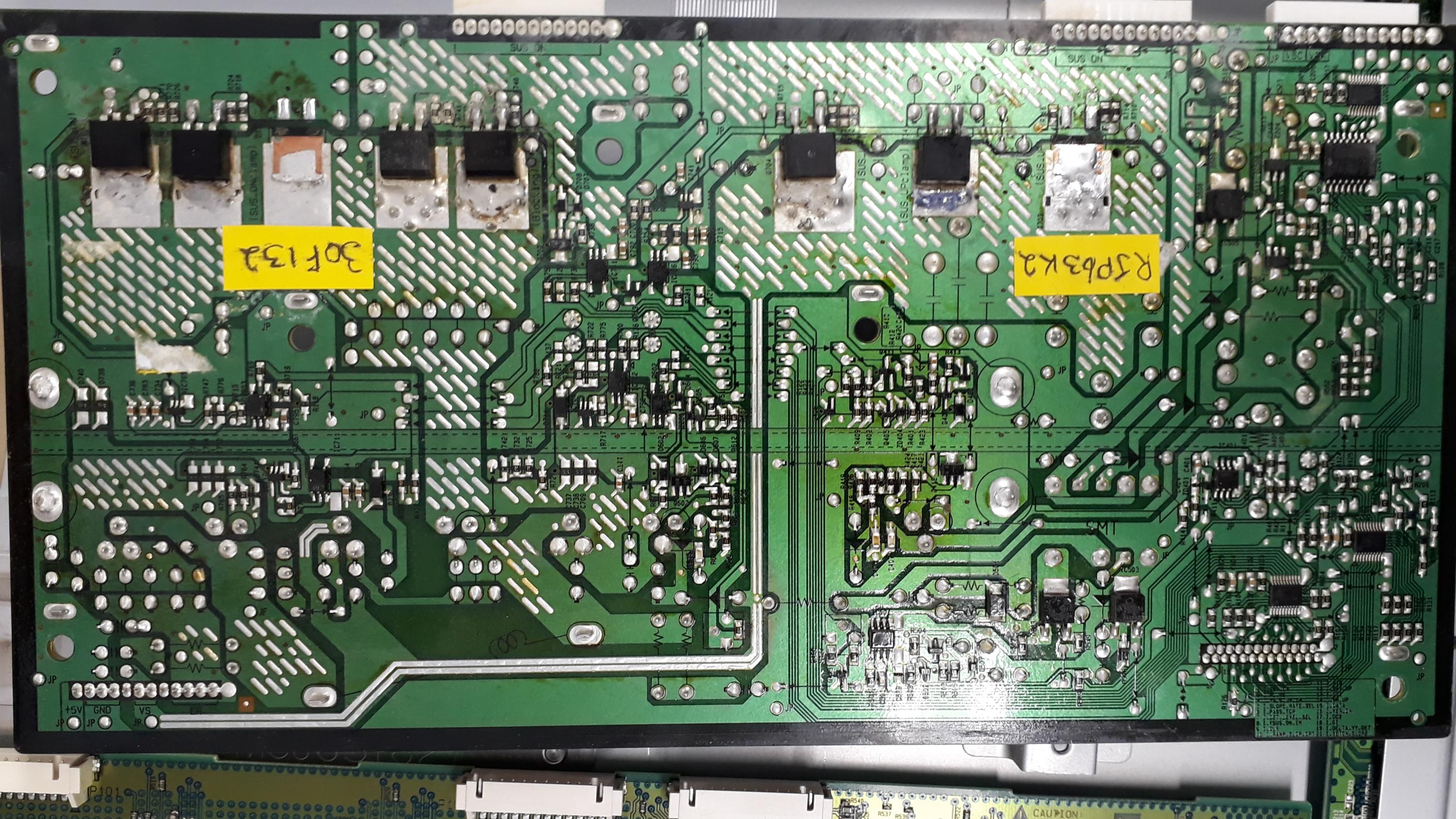

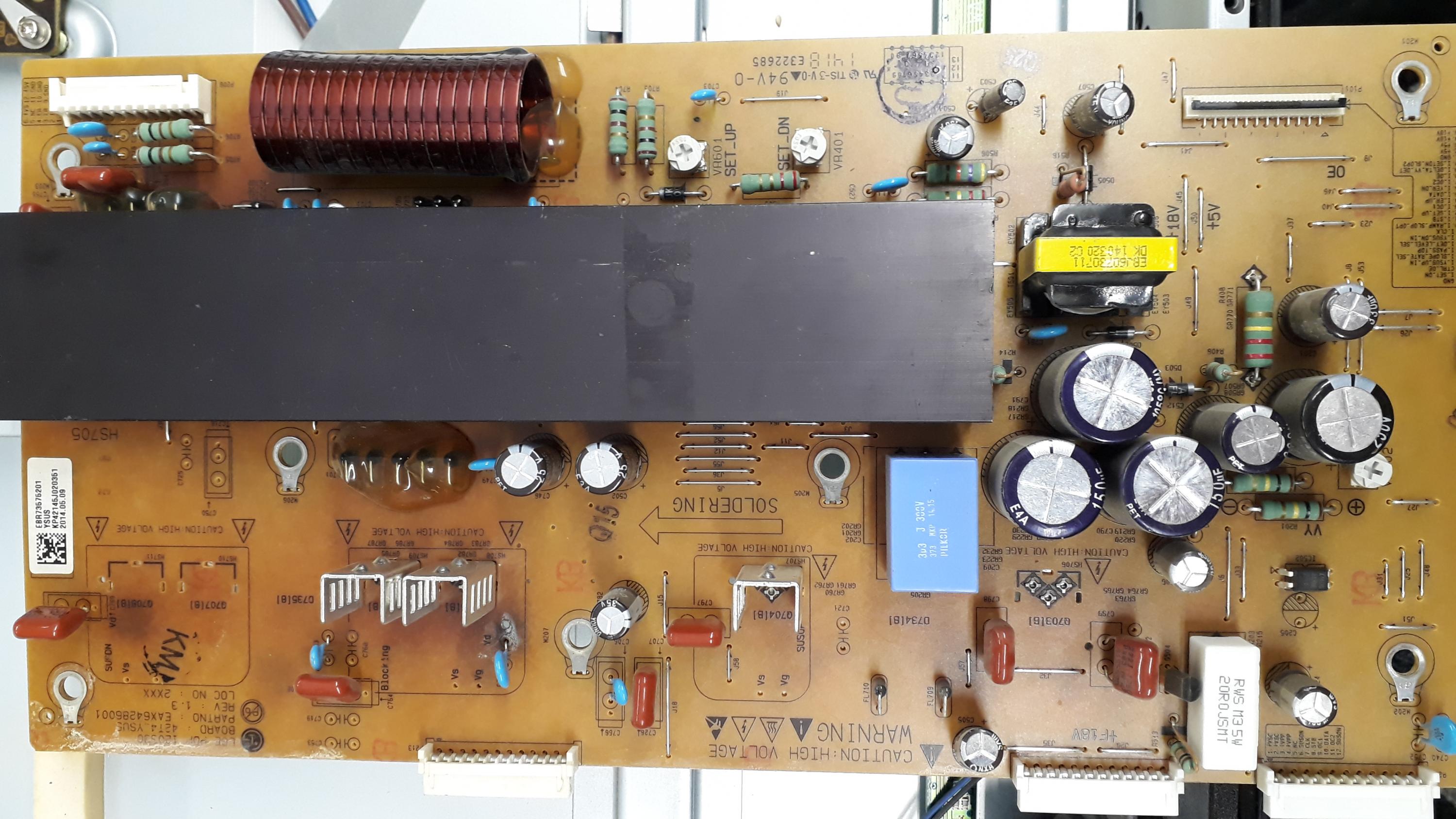

    Hi guys,
    I got in this plasma tv with that was tampered and i dont trust all those mosfets and diodes that are soldered in by someone. Is there somebody with a schematic on this board?
    I also noticed the KF7N60F is short circuited that is mounted on the heatsink on the top side. I am afraid to buy these parts from China. They charge $2.75 for 10. Sounds too cheap to be original spares but rather fake parts. Shop Jimmy has also blocked all incoming internet connections from our country because they have fraud issues so thy block every body. If you want to buy its thru ebay.

        Re: LG YSUS EBR73575201 - need schematic and repair kit.
        Normal parts used for repair on these boards ( EAX 64286001 )are Q703/4/7/8+9 = RJP63K2 ,RJP30H2A and 20N60. details taken from my repair log book sorry no schematic hope this is of help Flocko
            Q709 is mounted on the heatsink others are SMD on the bottom of board,also check gate resistors to the above
                        30F131 are not orig. IGBTs for this board.
                        RJP63K2 2pcs. and RJP30H2 2pcs.
