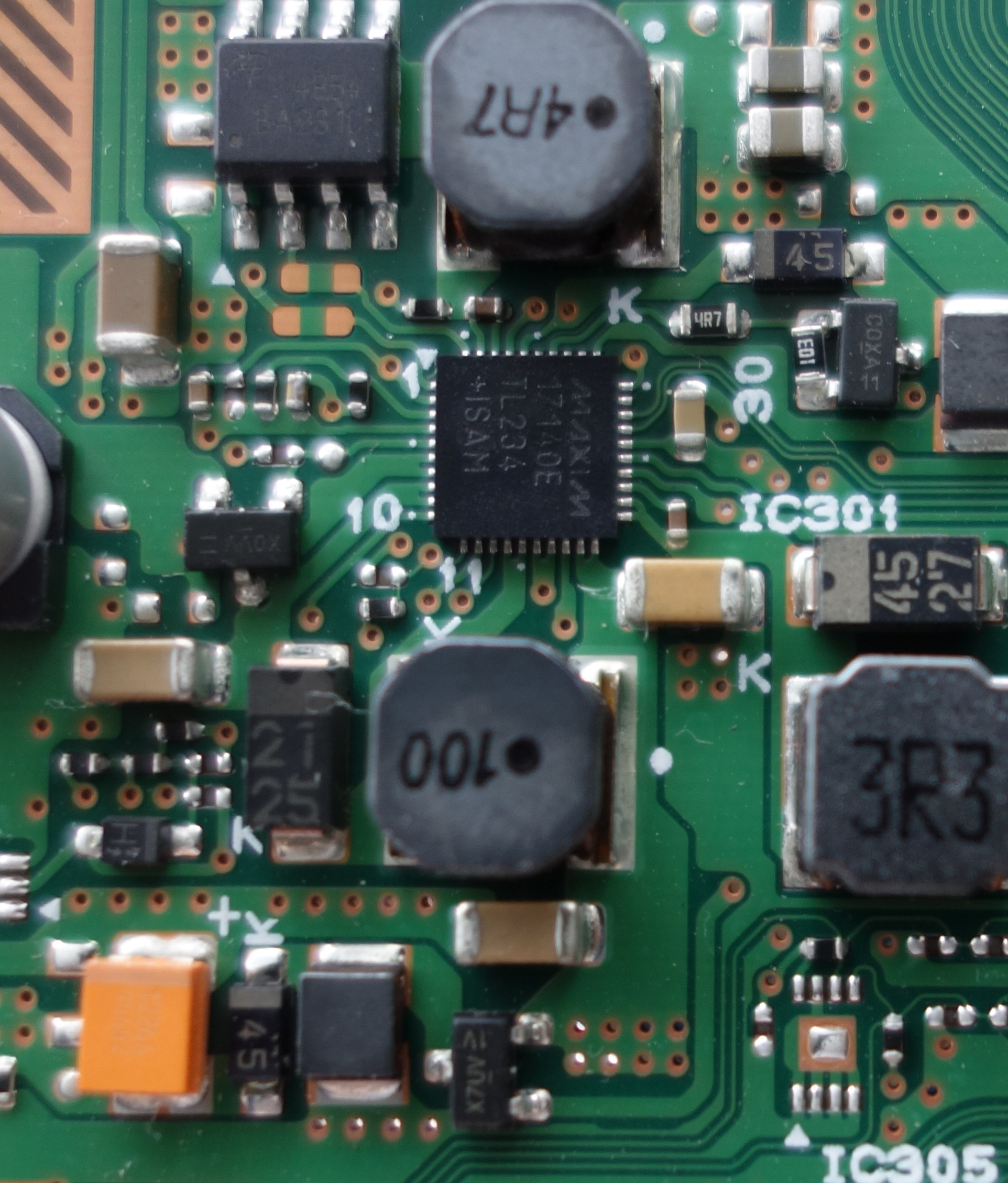

Was given this repair kit to install but the customer lost the instructions. We both messaged the ebay seller and they haven't responded. Actual board is slightly different rev ZH but looks very similar.

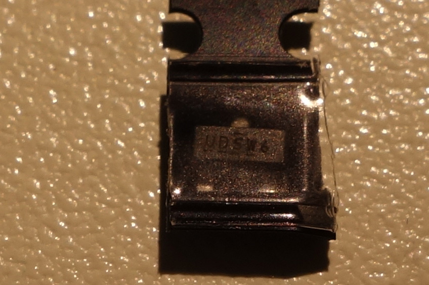

Kit contains a driver IC, fuse and three SOT23 parts.
On the board, there are 3 SOT 23's marked XOVV, COXA, and X7UV.
The kit contains a UDSW6, X7HV and K72 (2N7002, NCH, 60V, 0.21A)
Assuming the X7's are the same. COXA is identified in another thread as likely bad and cross-referenced to A03460 (NCH, 60V, 0.65A) so shoudn't be replaced by a 0.21A FET. By elimination, UDSW6 should replace COXA but can't be sure without identifiying either XOVV or UDSW6.
