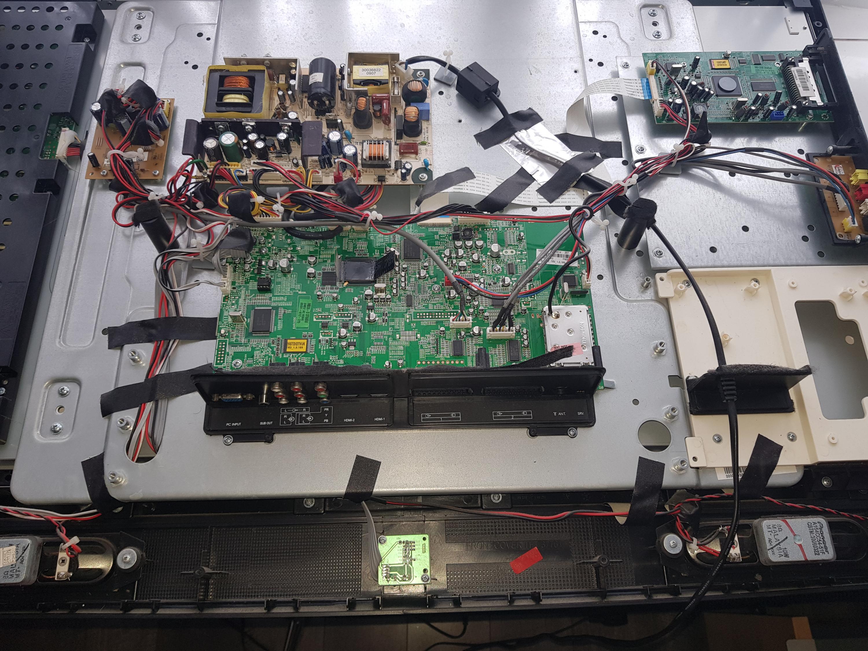

    tv has just a flashing blue led

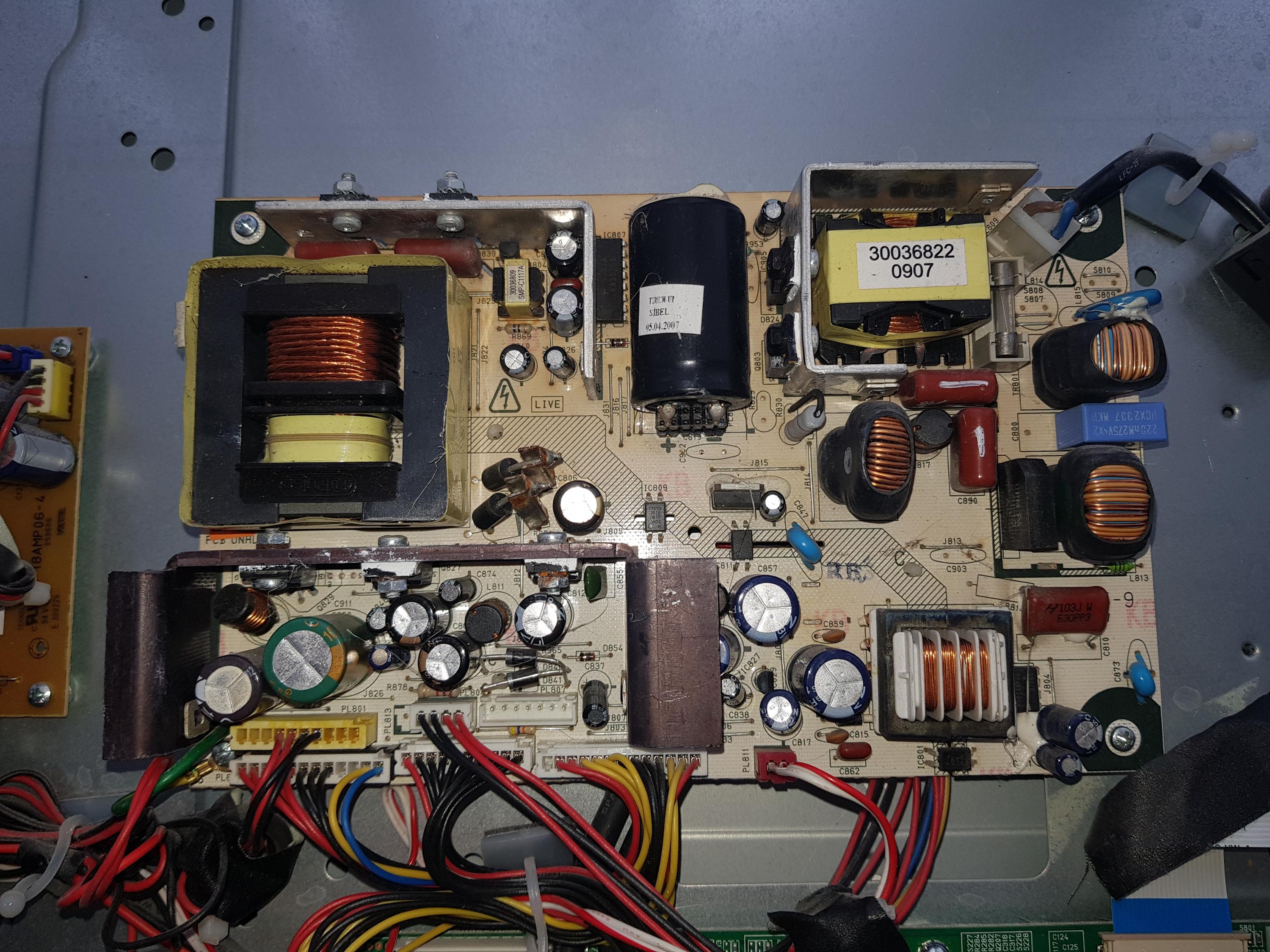

    Psu 17pw15-9

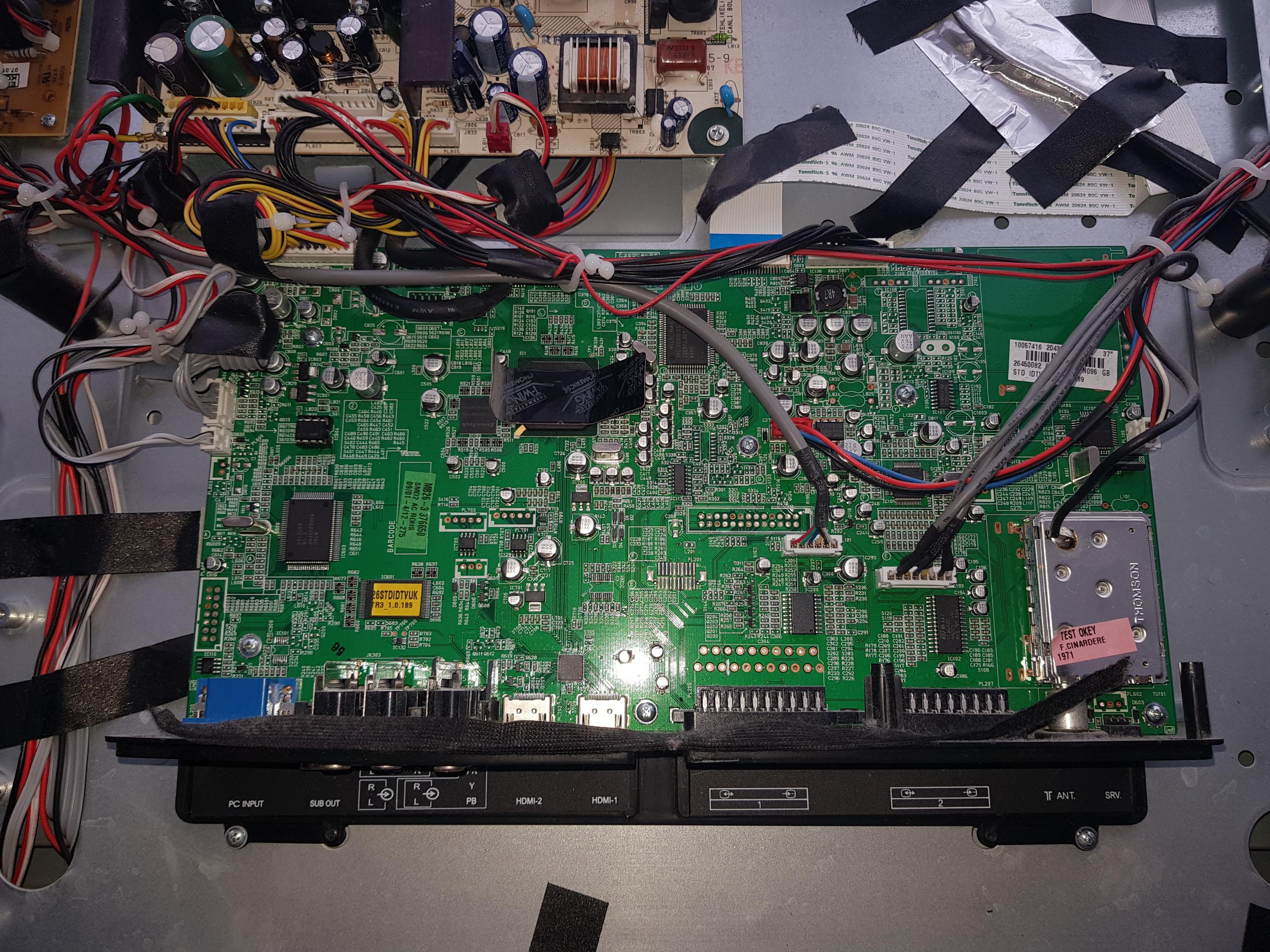

    Main board 17mb26-3
    Main cap 380v but fluctuating in fact all voltages are fluctuating and a slight ticking noise coming from the psu
    Anyone had this issue before

    Does it still tick if you run up the power supply on it's own. ?
    What is the bottom of the power supply like. The serrated washers look very rusty and I wonder if there is water damage. I believe these power supplies had problems with diodes next to C806 and I also seem to recall ReecyBurger123 having a problem with the main capacitor (the very large one)
