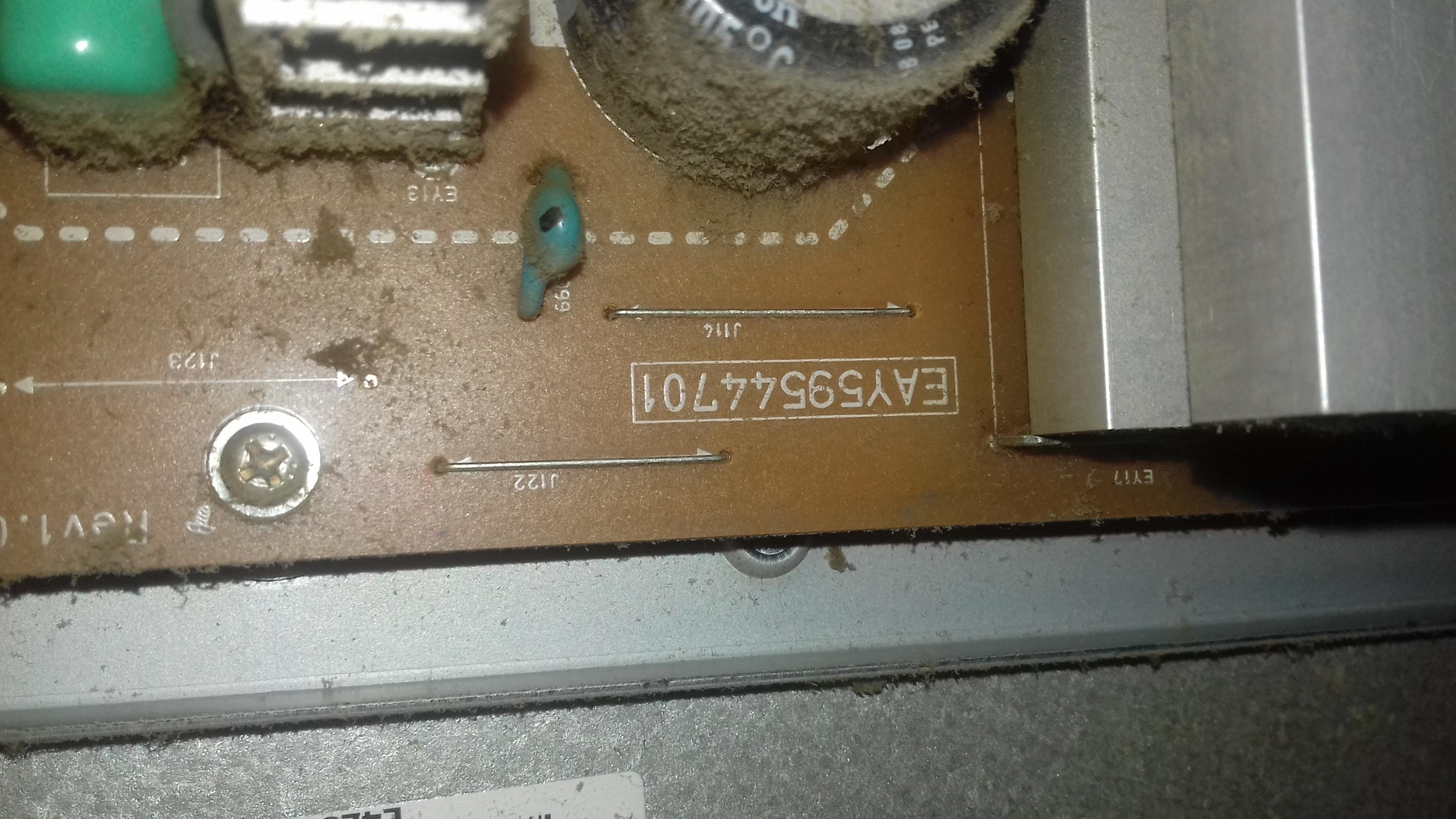

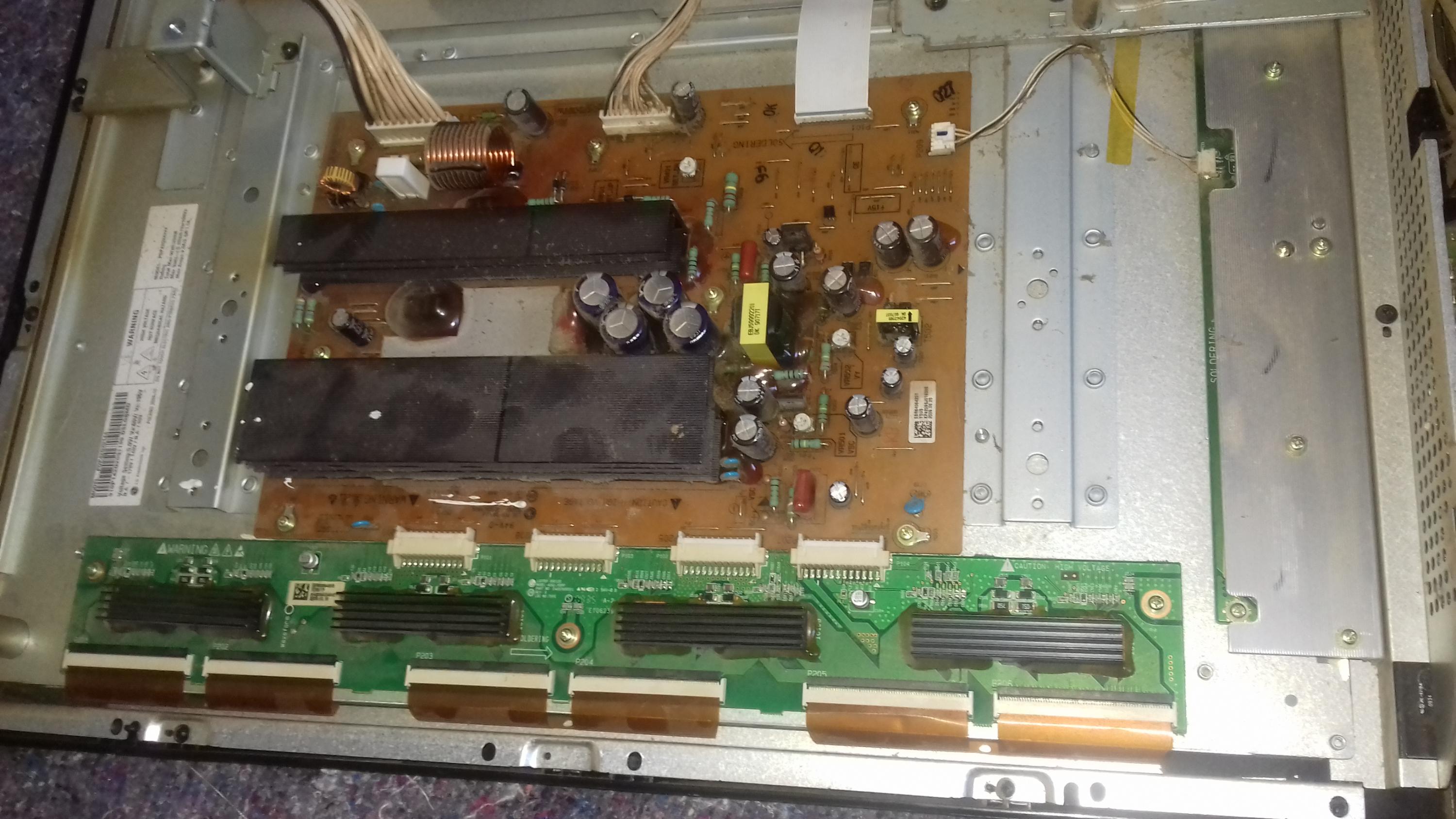

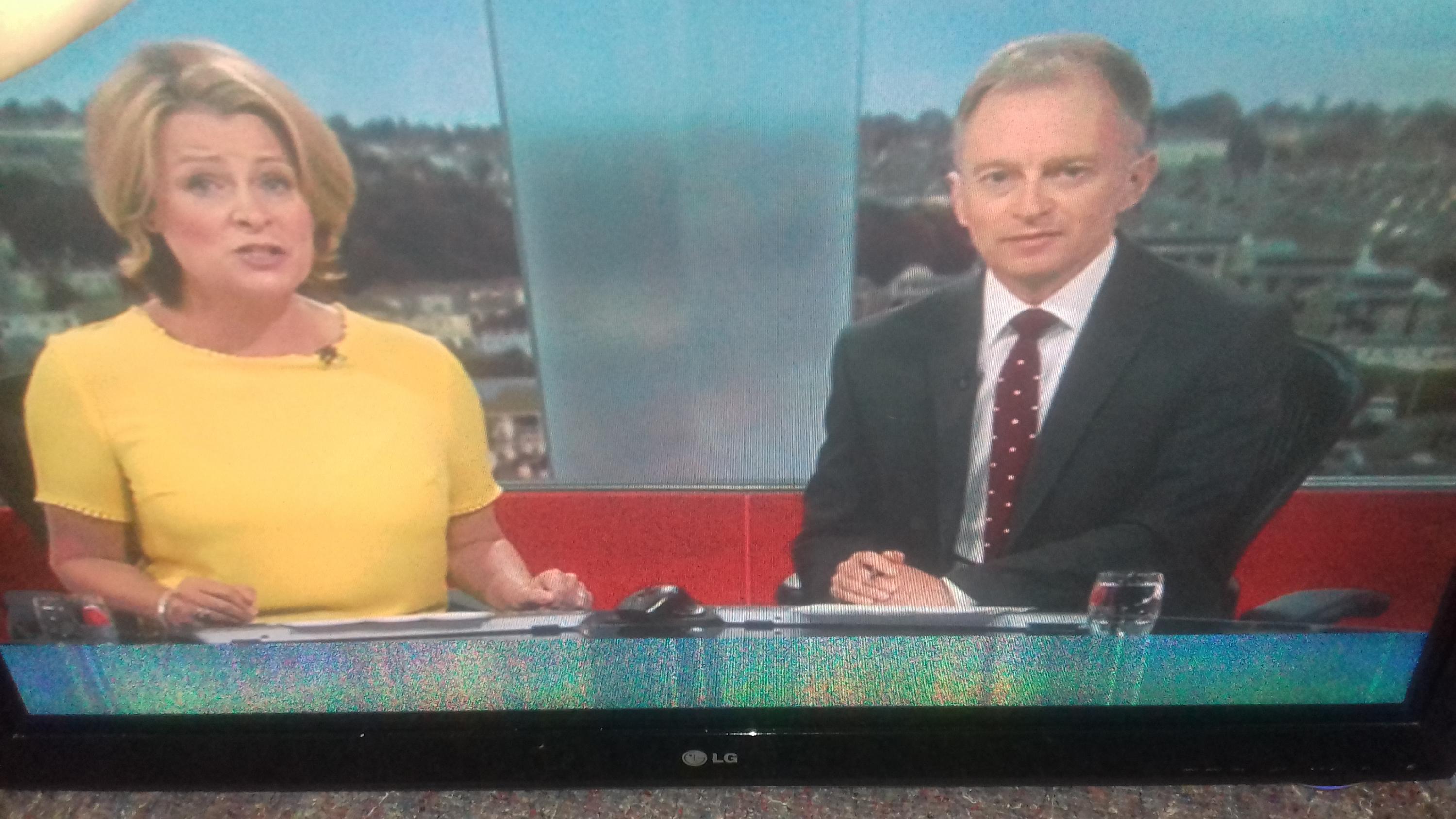

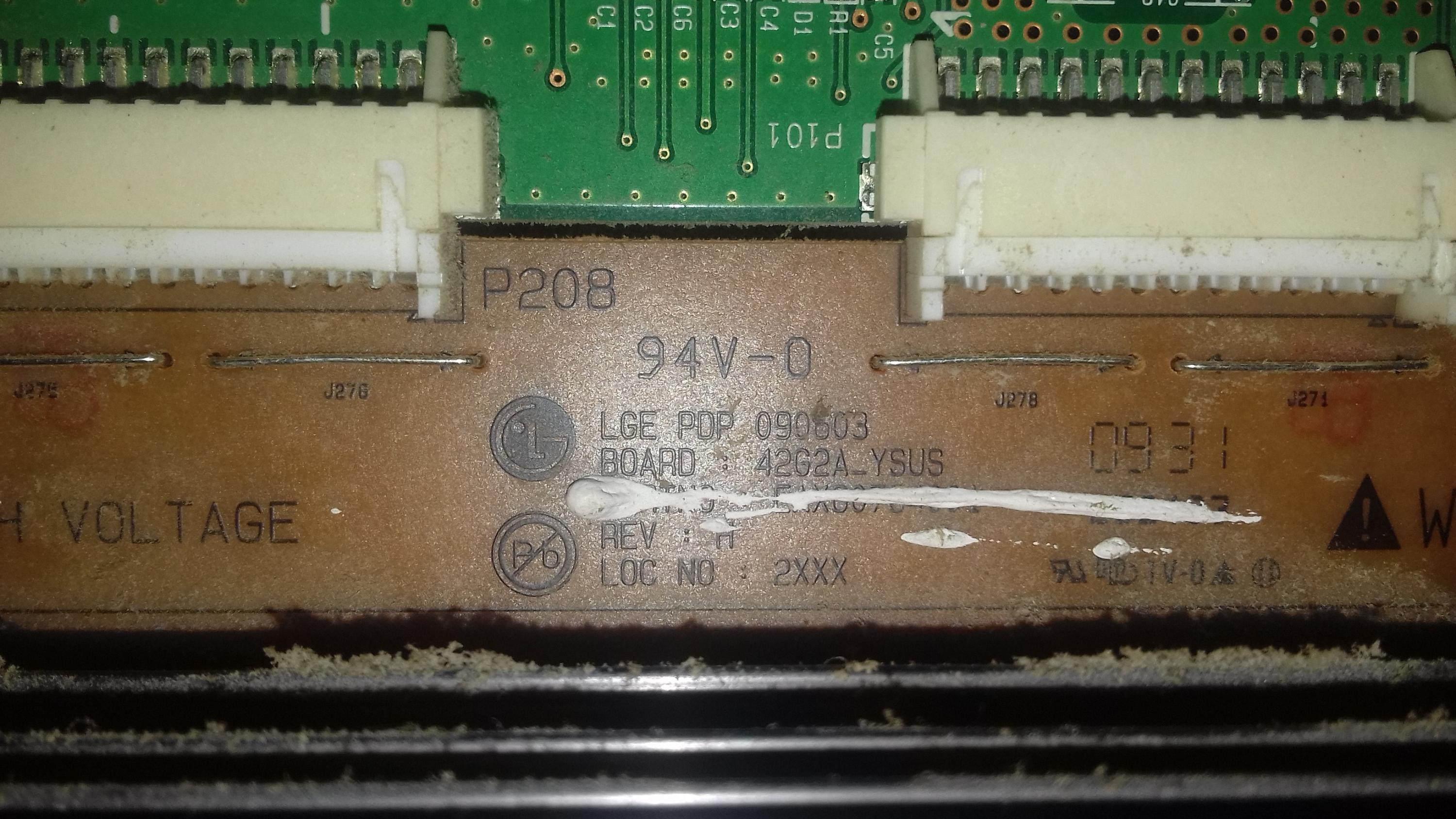

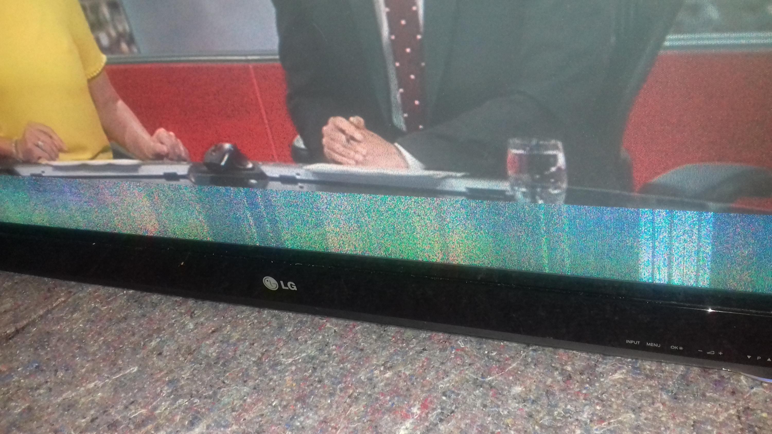

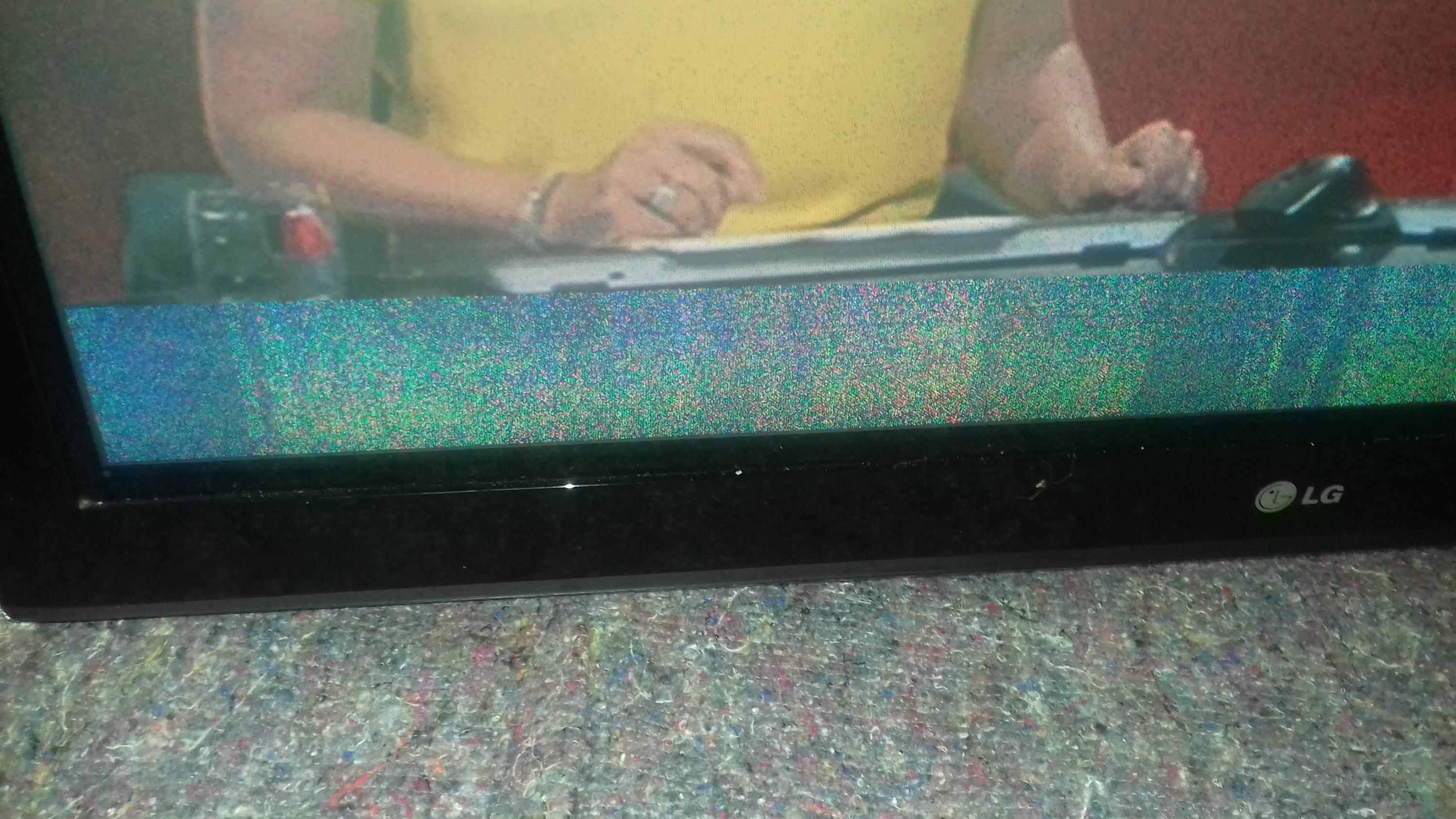

    Hi have a lg 42pq3000 with a weird bar at the bottom of the picture,any ideas?.Thanks for any input!
    Re: lg 42pq3000 weird bar on picture

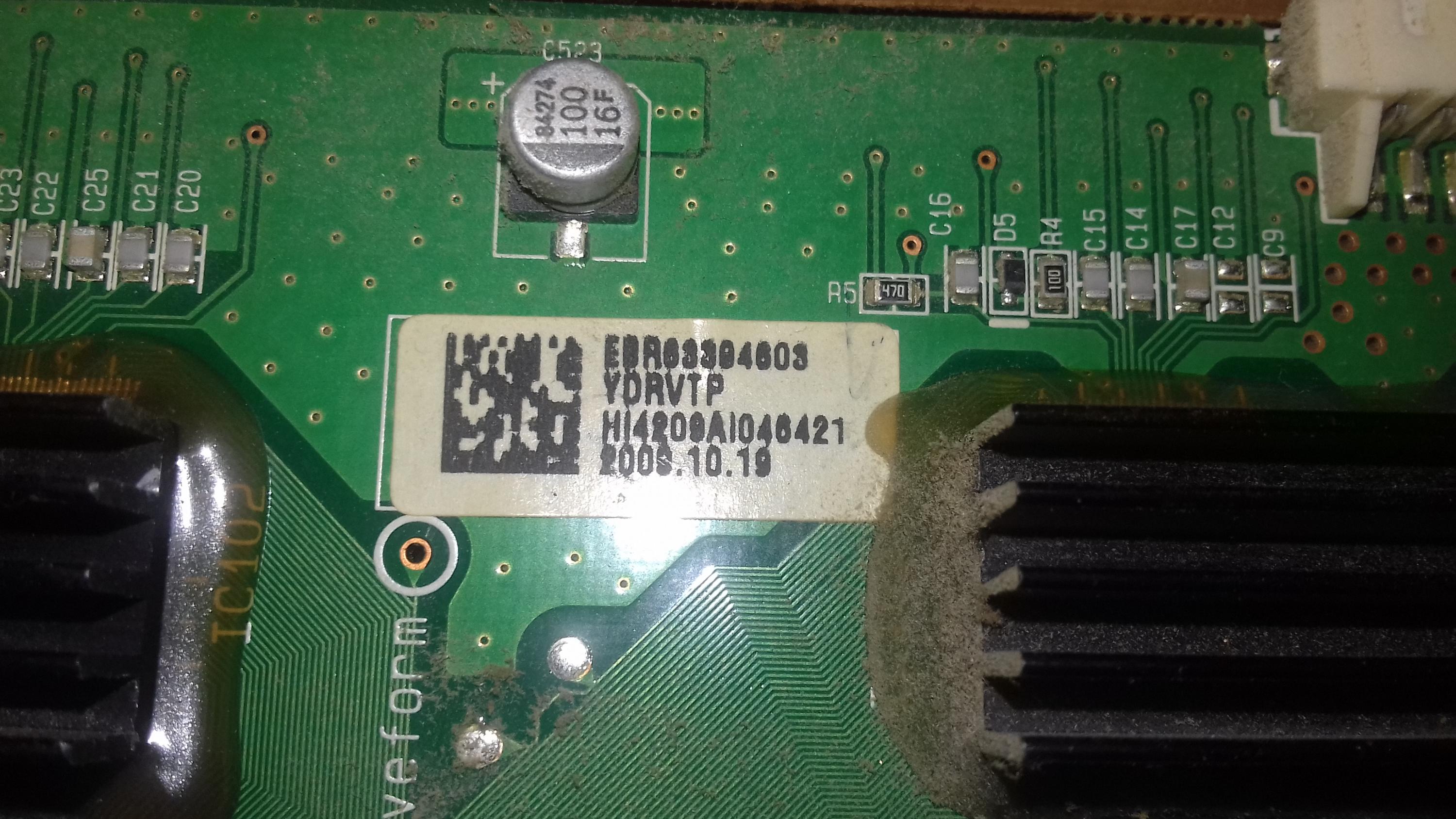

    Bottom IC or 2nd IC from bottom on buffer board is bad
    • Newbie123
      • Oct 2015
      • 58
      • uk
      Thanks a lot Tom.Nice one,im not sure if i will fix the tv i might just sell all the parts except the buffer board as the parts are worth more then the tv as a whole probs!
