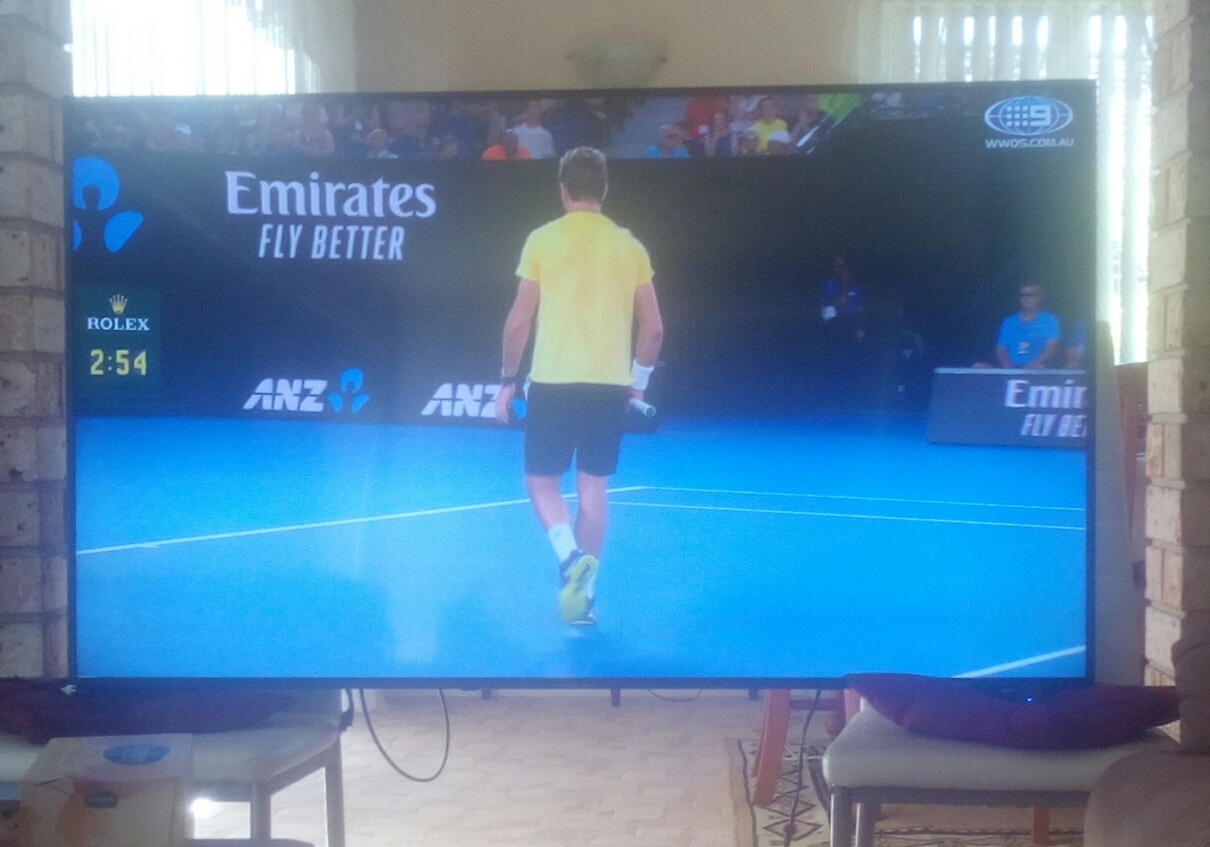

Each year in my area the local authority has a collection of household junk. Last year I scored 20 TVs but this year they are not taking e-waste but no matter people are putting them out on the verge. I'm getting tough now have driven past, yes past, at least 12 sets including 3 plasmas within 30feet of each other. Yes I now have WILLPOWER, WILLpower, willpower, wilpwr, wi... Oh well I did pick up 4 including this Bauhn 58" 4k UHD which when turned on and connected to DVD went perfectly until it warmed up properly then lost picture - sound and backlights still OK. So it will be off with back, cleanup, voltage checks, then heat gun if looks like it needs it. This makes number on hand now 26 with 4 to sell, 4 awaiting parts, and 2 still to pickup from donors. Why do we get ourselves into these situations ? Mad as hatters. Will report on the Bauhn progress in due course.

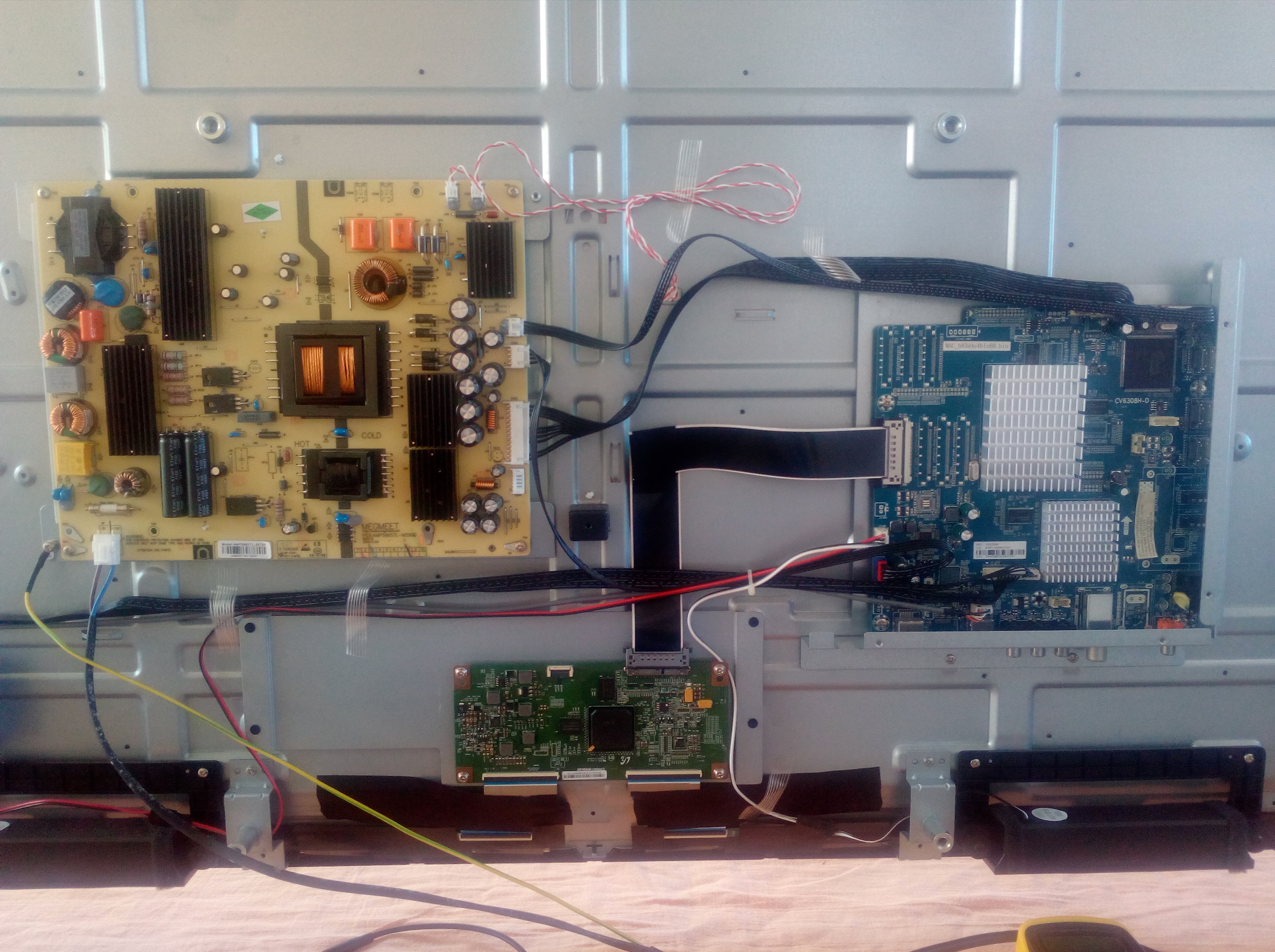

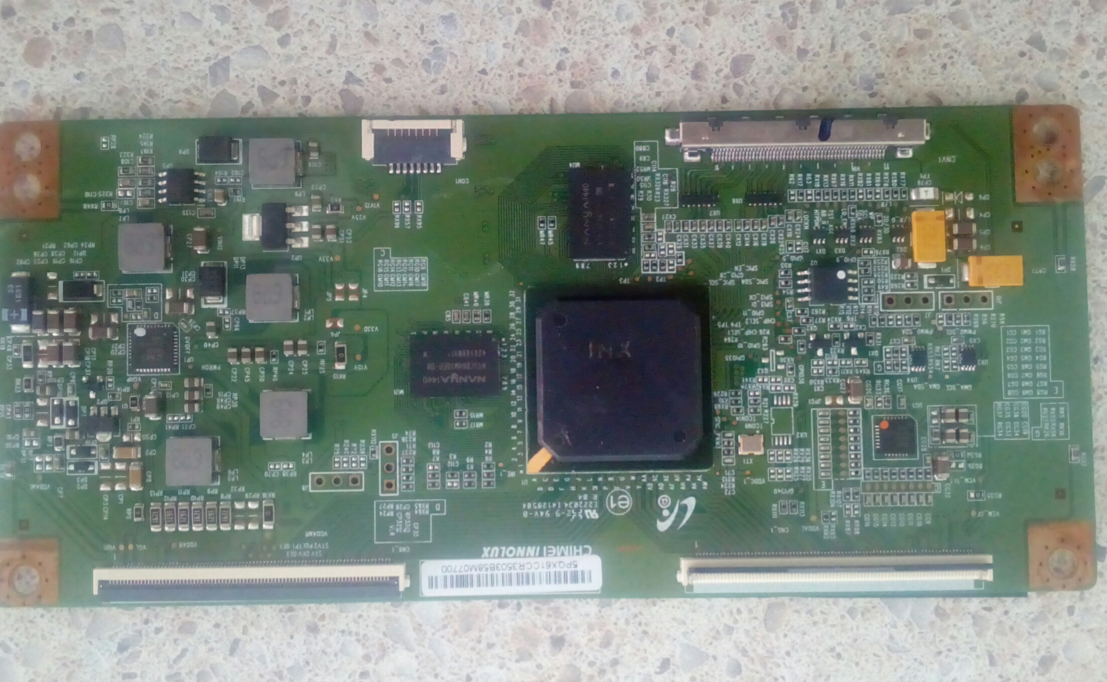

Yes its a scavengers paradise really. Now to the Bauhn ATVS58-1115 which I cleaned then with back off found tcon had plastic covering adhered back and front so took front piece off tearing it in a few places (so it can stay off now) and then removed tcon for a look over and clean etc. Reinstalled but no picture this time. Took one feed off and white half screen then same on other side. The gamma points are 1 - 8 going down and 9 - 16 going right to left. These are the voltages from 1 to 16......
15.67 13.79 13.01 0.02 11.17 10.76 9.46 9.10 7.57 7.25 5.92 5.38 0.02 3.55 2.66 0.55 and that's not good. Took a few other voltages VDDA L&R both 17.58 VCU.CF 6.55 VCL -7.9 VGH 0.0 Have had a quick look on net for another tcon without result and the number on board (not sticker) gives no results so searched by using Bauhn name. I know the tcon should be fixable with a new chip if that's all that's wrong. Normally tcons I just replace as they are usually cost effective. Please contribute your knowledge as mine is limited here.Attached Filesif you find these attachements useful please consider making a small donation to the site

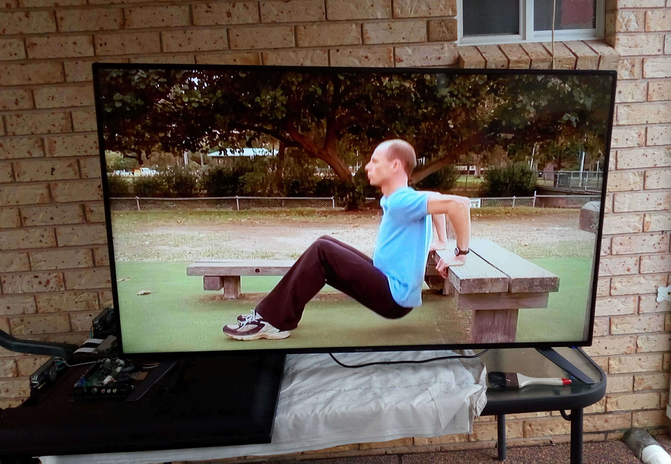

After a few attempts to get a tcon from China outlets (all no good) I found one by same maker which came out of a Toshiba set and on eBay from US seller. This board had different numbers but close exam of pic to the one I had showed them to be exactly the same in components so I took the risk and yes it works!!. Persistence paid off.Attached Filesif you find these attachements useful please consider making a small donation to the site
