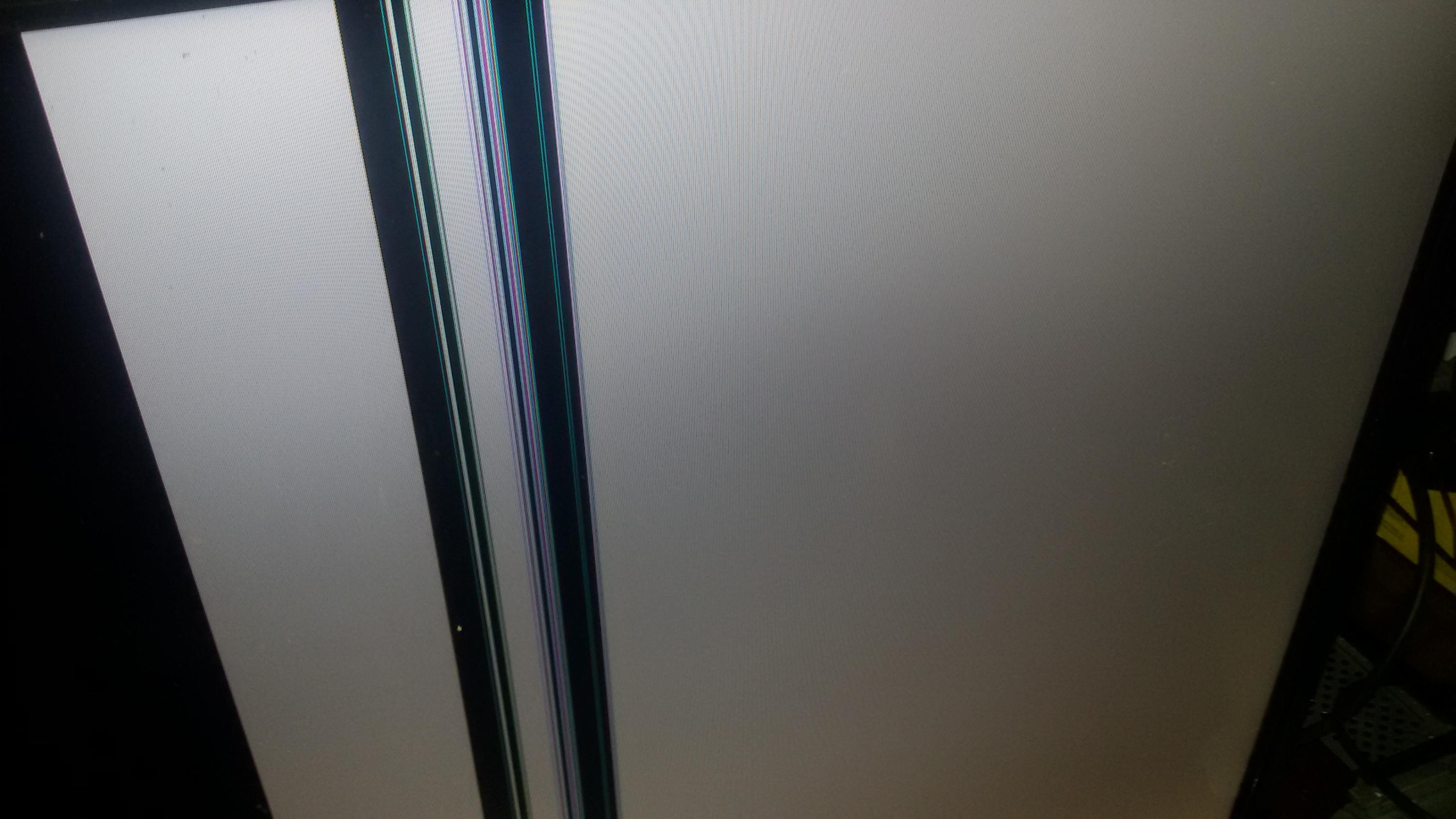

    When I remove the right ribbon cable and leave the left ribbon cable connected, the picture comes up on half the screen and white with some black thin lines on the other side.

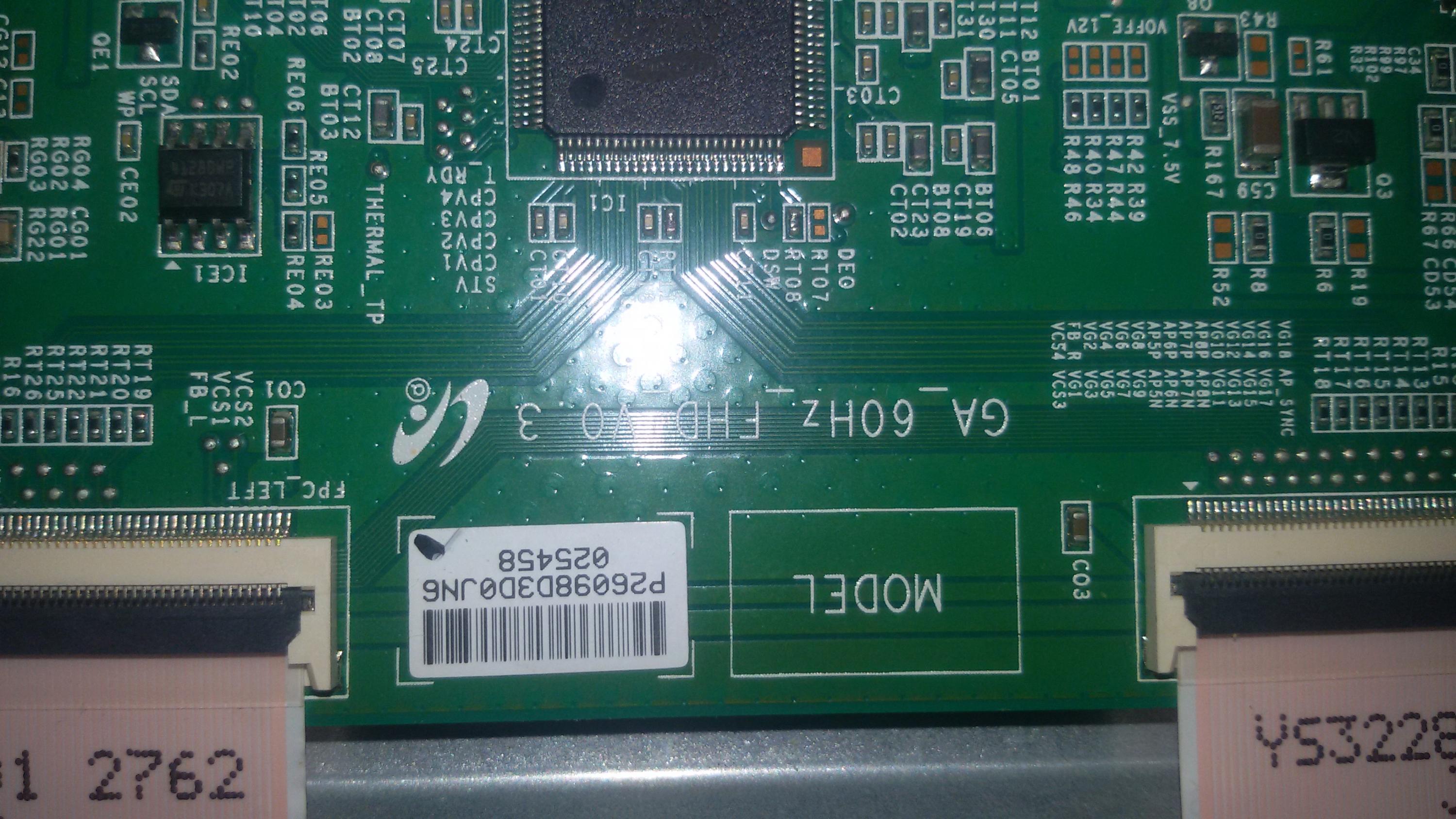

    Post pictures of your Tcon to start off.

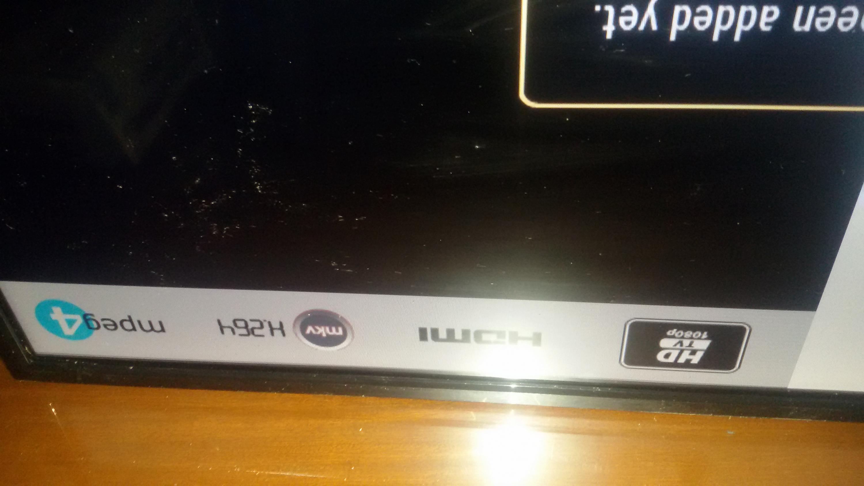

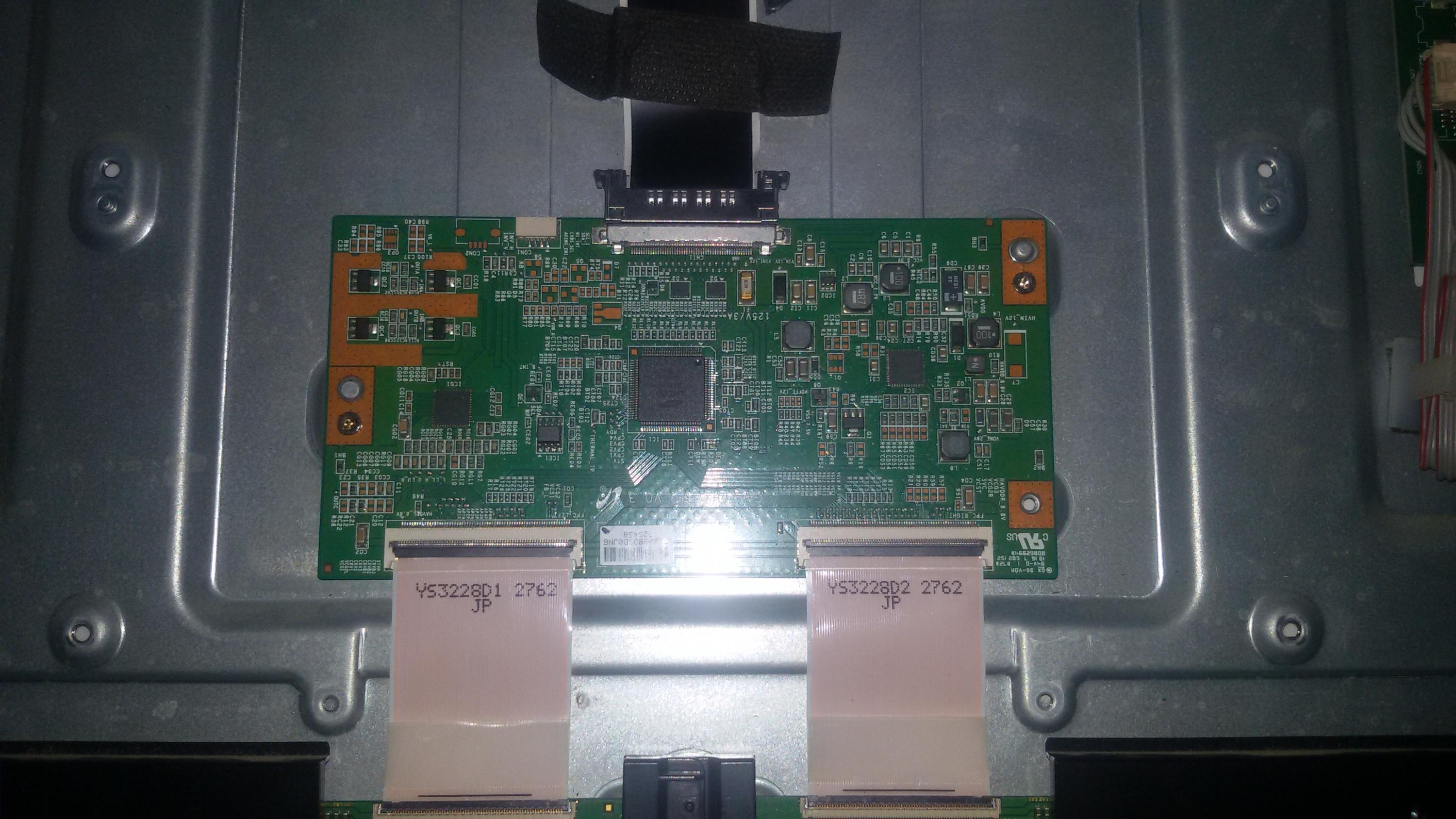

      Ok I am going to post some pictures which might help show the issue. Below you will find the pictures of the t-con board and the symptoms with the two cables (blank screen only backlight), with one cable on the left (image on the left is good and white with lines on the right). If you need more information please do not hesitate to contact me. Thanks.
      Photo 1

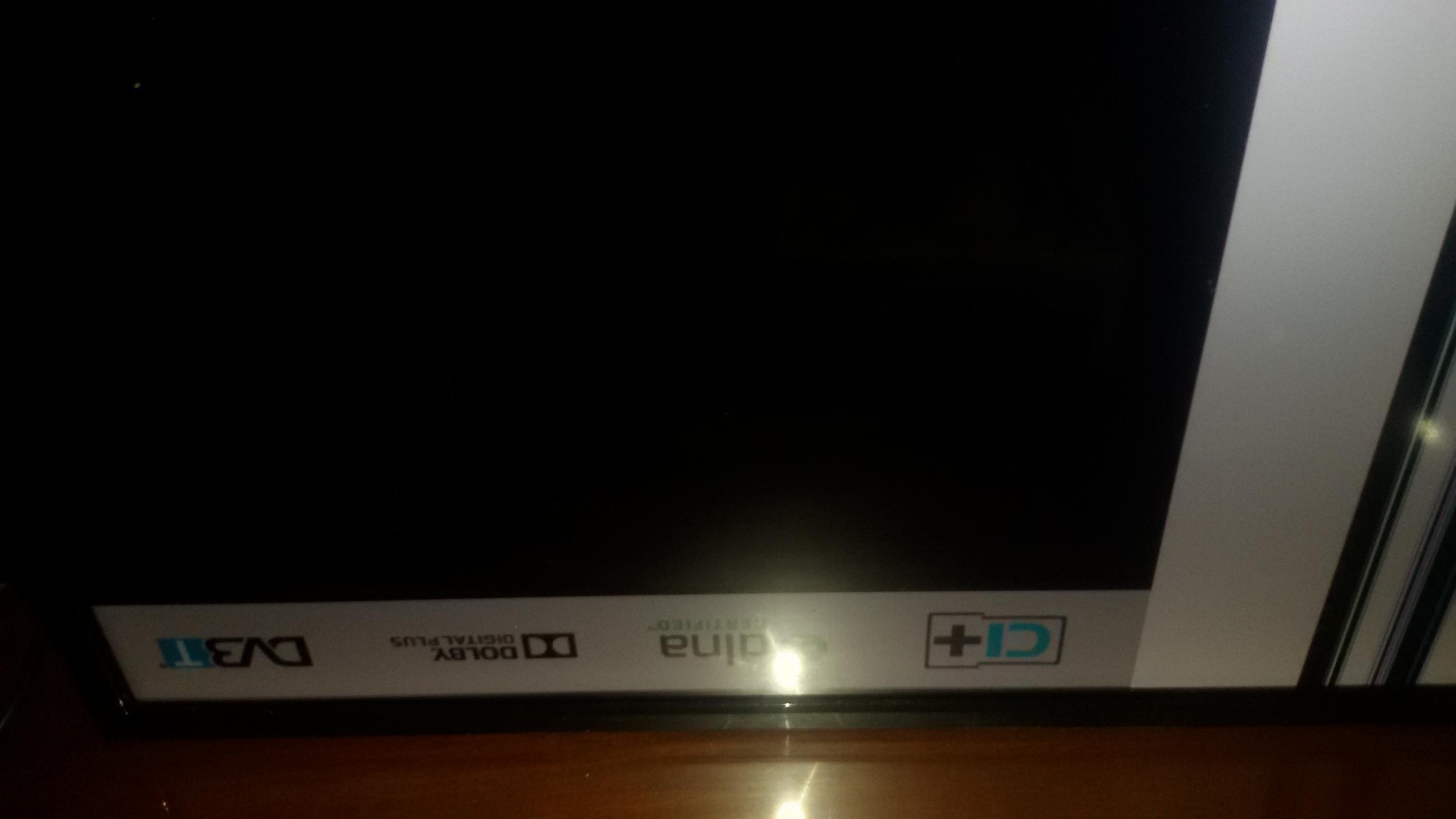

        Photos 1 and 2 are of the T-con with all the cables connected. Only the backlight will show as on photo 4.

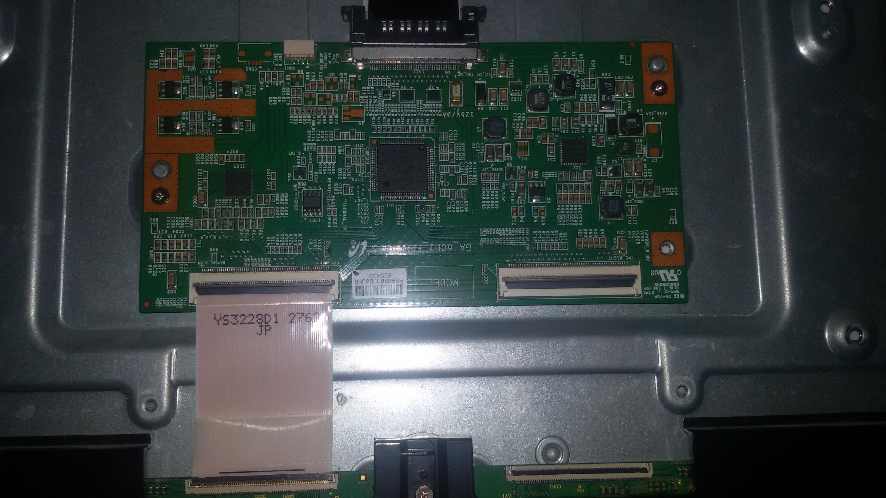

        Photo 3 is the main board.

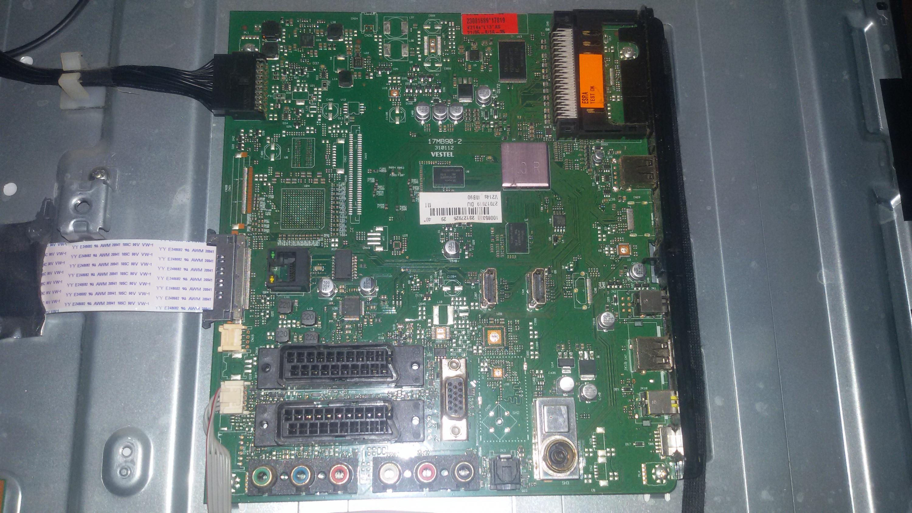

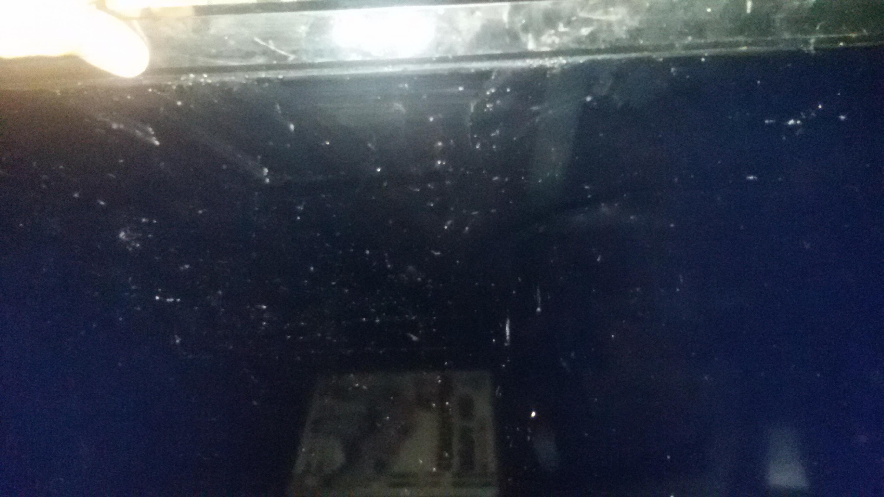

        Photo 5 is a photo of the t-con without the right ribbon cable and produces a picture like the photos 6 and 8
        Photo 7 is the picture from where the ribbon cable on the t-con is removed.
        Thanks and hope that you find them useful in helping me resolve my issue.
        If you need more info, please do not hesitate to contact me. Thanks

          It does look like a panel fault. When one ribbon is removed and you have a good picture on half of the panel but does not repeat when you replace that ribbon and remove the other ribbon.
          When the ribbon that does not produce the half picture is connected, is that when your voltages on the Tcon start to drop.
          There is a possibility that a ceramic capacitor on the small panel board that the ribbon connector connects to (which is joined to the panel) may be short circuit.
