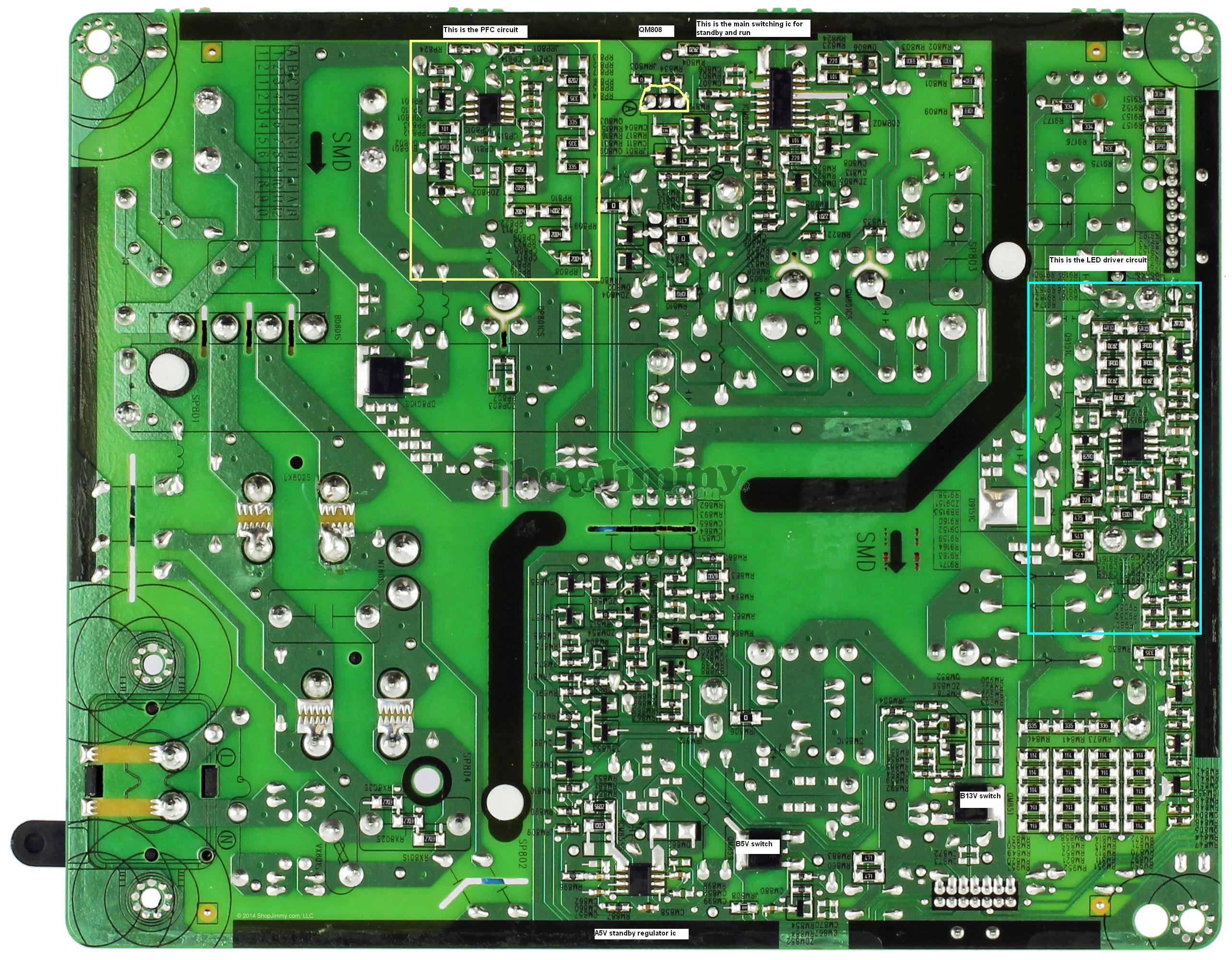

          You can run the board out of the tv without a problem. Like I said before, the board will try to turn all the supplies on unless you ground the PS_ON pin.
          So ground PS_ON again and see if you have A5V
          This power board has 3 seperate power supplies. The standby/run supply for the A5V. It also supplies the B5V and B12V when turned on.
          Then there is the PFC power supply. and the LED driver power supply

                LP802CS is a COIL it is NOT a transformer. It is one single piece of wire, It comes direct from the bridge rectifier so 160 volts is correct, on all leads.
                The ic I was refering to was ICP801S, It is the PFC circuit, this is the circuit that boosts the voltage coming from the bridge rectifier from 160 volts to 400 volts on the main filter cap CP806S
                The LED controler/driver ic is the ic near the led plug.

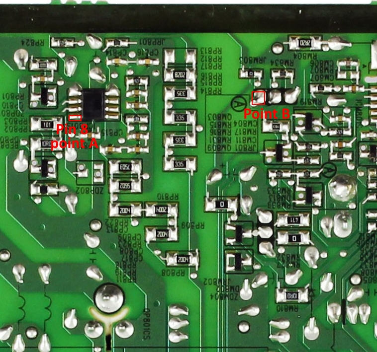

                  Please check the resistance between point A and point B for me to see if it shows < 1 Ohm.

                    Thanks R_J. I think budm is referring to this in his last post too.
                    Resistance is not less than 1 ohm. It is 22.5ohms. I'm guesing we just checked that leg of the IC for short?

                      No, I am looking for the switched Transistor that supplies the Voltage to VCC pin 8 of the PFC IC, I could not see QM808 that RJ is referring to.

                        Check the JRM803 0Ω resistor next to point B. QM808 is the transistor at point B, it is marked on the other side of the board
                        I am guessing DM809 diode and CM809 cap. are the supply for the that transistor?
                        QM807 is likely another switch.

                          Hi Rj, so that is QM808 then, I was tracing the bottom side of the board to find out how that Transistor is connected to pin 8 of the PFC IC.
                          I also expect one of the leg will show 15 ~ 20 vdc when PS-ON pin is grounded.

                            it looks like CP812 is the filter cap for the PFC IC pin 8.
                            I also wonder if these Lytics caps are OK: CM809, CM814, and that CP812.
                            I also cannot clearly see the RP824 value, it has one end connected to the + leg of cap CP812, the + leg of the CP812 should also show <1 Ohm to point B the leg of QM808.
                            BTW QM808 P/N? Is it NPN?
                              JRM803 is straight through, zero resistance.

                                RP824 is marked 022, there is also a line above the 2, thinking this is 220? I have not checked CP812 for capacitance but can do.
                                QM808 is MPS751Y, datasheet says it is PNP
                                Positive leg of CP812 to point B as marked on the previous picture is .4ohms. From the + of CP812 to leg 8 of the PFC IC is 22.5ohms

                                          The Voltage on the Emitter is generated by the AUX winding of the transformer which is fed to the switched Transistor QM808 Emitter (because it is PNP transistor), there will be no output on the Collector until PS-ON is present. The PFC IC running Voltage is around 12V.
