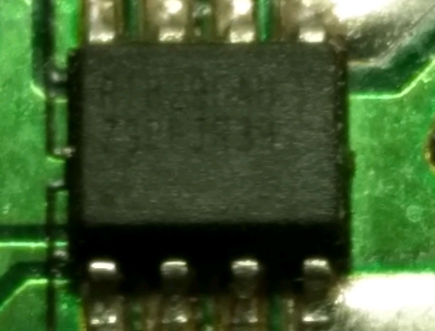

                                    Main cap voltage constant at about 161v and makes no attempt to rise. I checked all the components in the PFC circuit around ICP801/QP801 and found nothing that appears amiss. I checked the readings against the same numbered components on another Samsung PSU (BN44-00775A) in the area of ICP801/QP801 and found similar readings between the components.
                                    ICP801 is SPC7011F and is described as a power-factor correction converter IC operating in critical conduction mode.
                                    I am unable to read the number on ICM855 so I posted a pic below to see if anyone can make it out by chance? Pic file names for this end in 962 and 566.

                                      I suspect the pfc ic is not getting its VCC, (pin8) this is usually switched by a transistor (Qm808) maybe? The transistor should have a voltage on its collector and the emitter supplies the voltage to the pfc ic, The base is likely controled by a optocoupler and is turned on when PS_ON is high
                                      CM814 might be the VCC source for QM808
                                      ICM855s is a RT8296AH which is a stepdown converter. it is likely for the A5V. You would need to trace its output pin to see where it goes.

                                        ICM855s is a RT8296AH which might be the stepdown converter for the +5V standby
