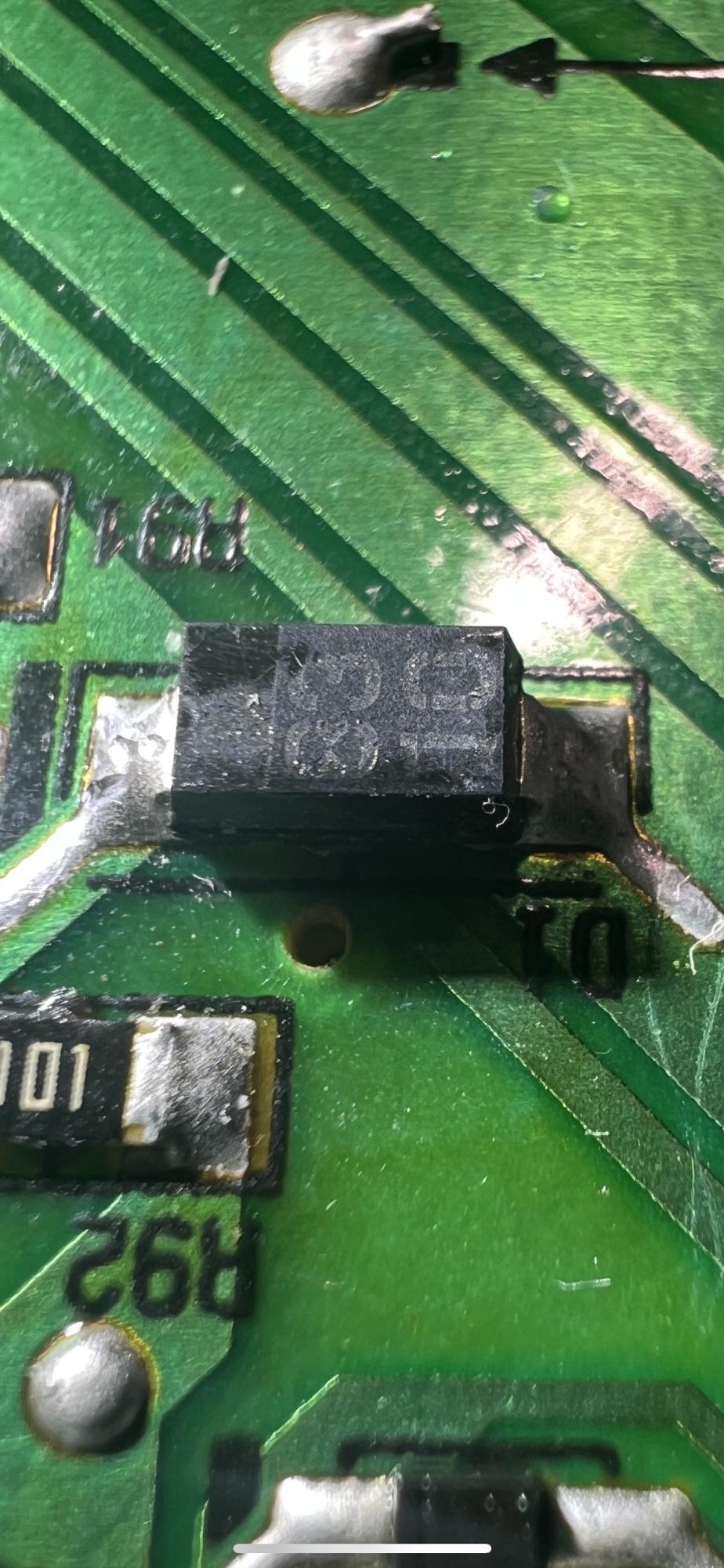

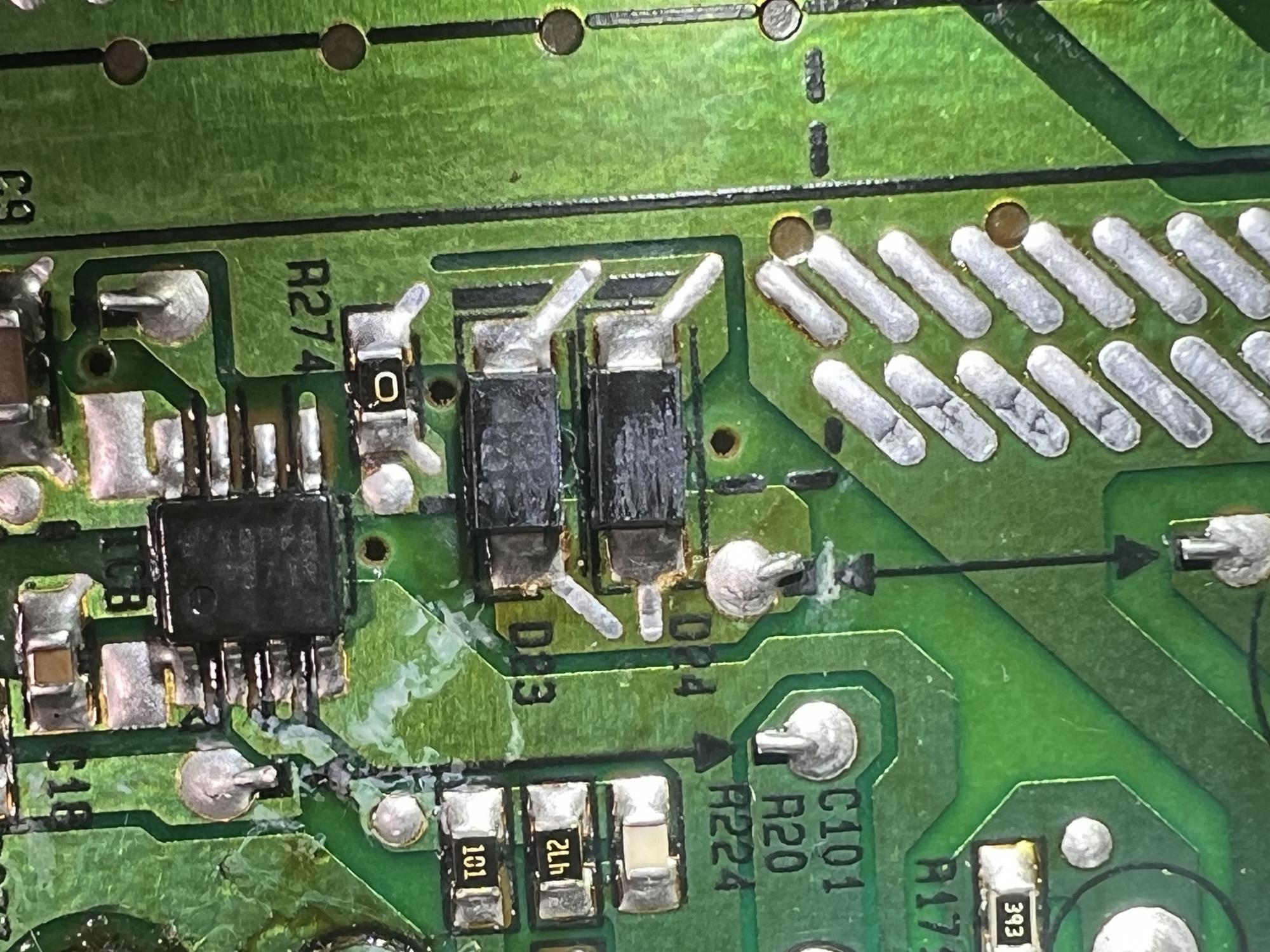

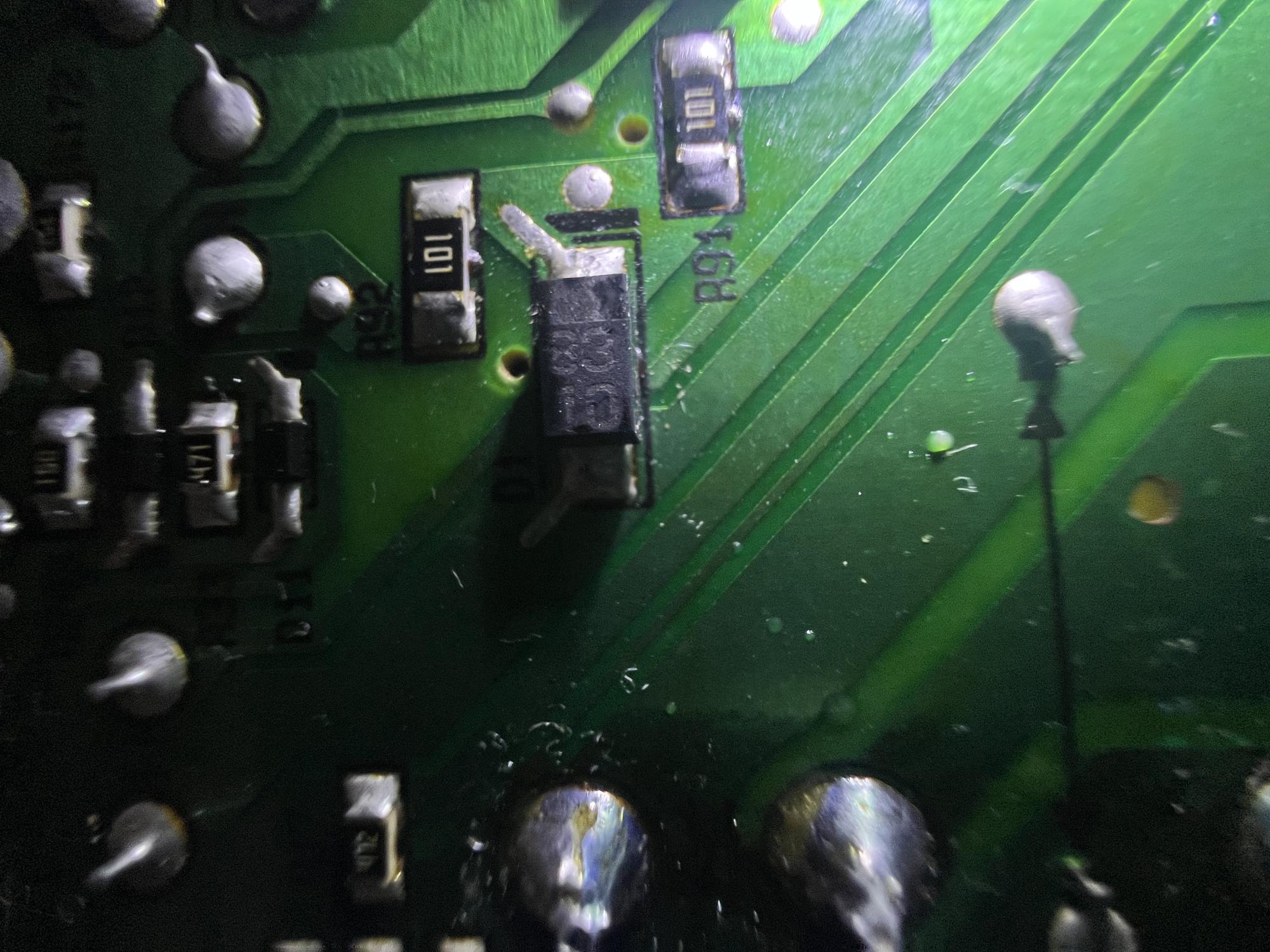

    Hello everybody,
    I am new to this forum or at least a new member because I used to read a lot of useful informations since several months.
    I am trying to repair on of my TV which the relay is clicking while I try to turn in on.
    Thanks to the useful advices I have located the issue on the Z-SUS board and maybe on the Y-SUS on as well (I need to check it later).
    The issues I have found on the Z-SUS board were two shorted IGBT 30F124 that I will replace with two 30J124 and also change the IC7 and IC8 on the board. I also noticed a short Zener Diode noted ZD2 attached to one of the 30F124 IGBT.
    I have removed this diode but I cannot identify which replacement part I should use.
    Could someone help me?
    I have read somewhere that using a 20V SOD323 diode should be ok.
    Thanks a million for your help.

      Re: LG 42PW451ZD - Z-SUS Zener Diode 2 Missing
      In order to test the zener diode I removed the 30F124 that was linked to it and then I check for continuity.
      Regarding the IC, I did not check it and I am not sure that there is an easy way to check it. But it is recommended to replace the driver IC when replacing an IGBT. If you do not do that, I think that there is a high chance that you will have to replace again the IGBT.
              Did you finally solve your problem?
              I received some parts to fix my TV today but not yet the missing zener diode.
              I took a chance in replacing the 30F124 on the ZSUS with some 30J124 leaving the space empty where the zener diode should be (because I think that they have a protection diode inside).
              I replaced the YSUS shorted IGBT as well.
              I first tested the ZSUS w/o plugging the YSUS and the TV turned ON without picture but I had some sound and the voltages were fine. I then plugged the YSUS to the ZSUS and the TV started to click again without turning ON.
              I checked the YSUS and no IGBT were short but the ZSUS is again damaged. I think I will wait until I get the zener diode and I will then also replace the FAN73711 IC drivers.
              Hopefully it is not the YSUS than is damaging the ZSUS.

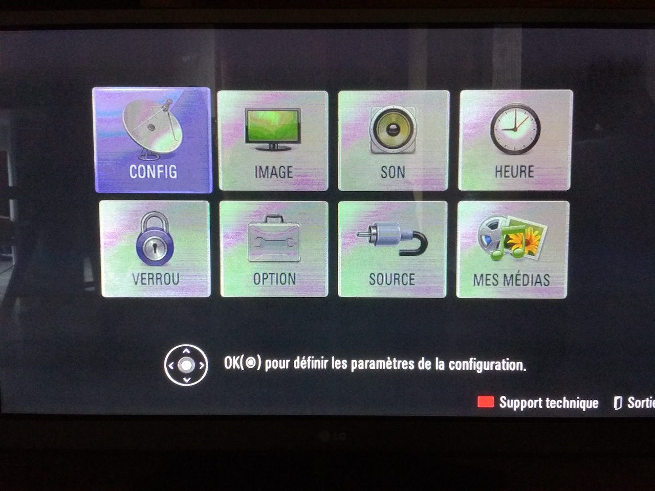

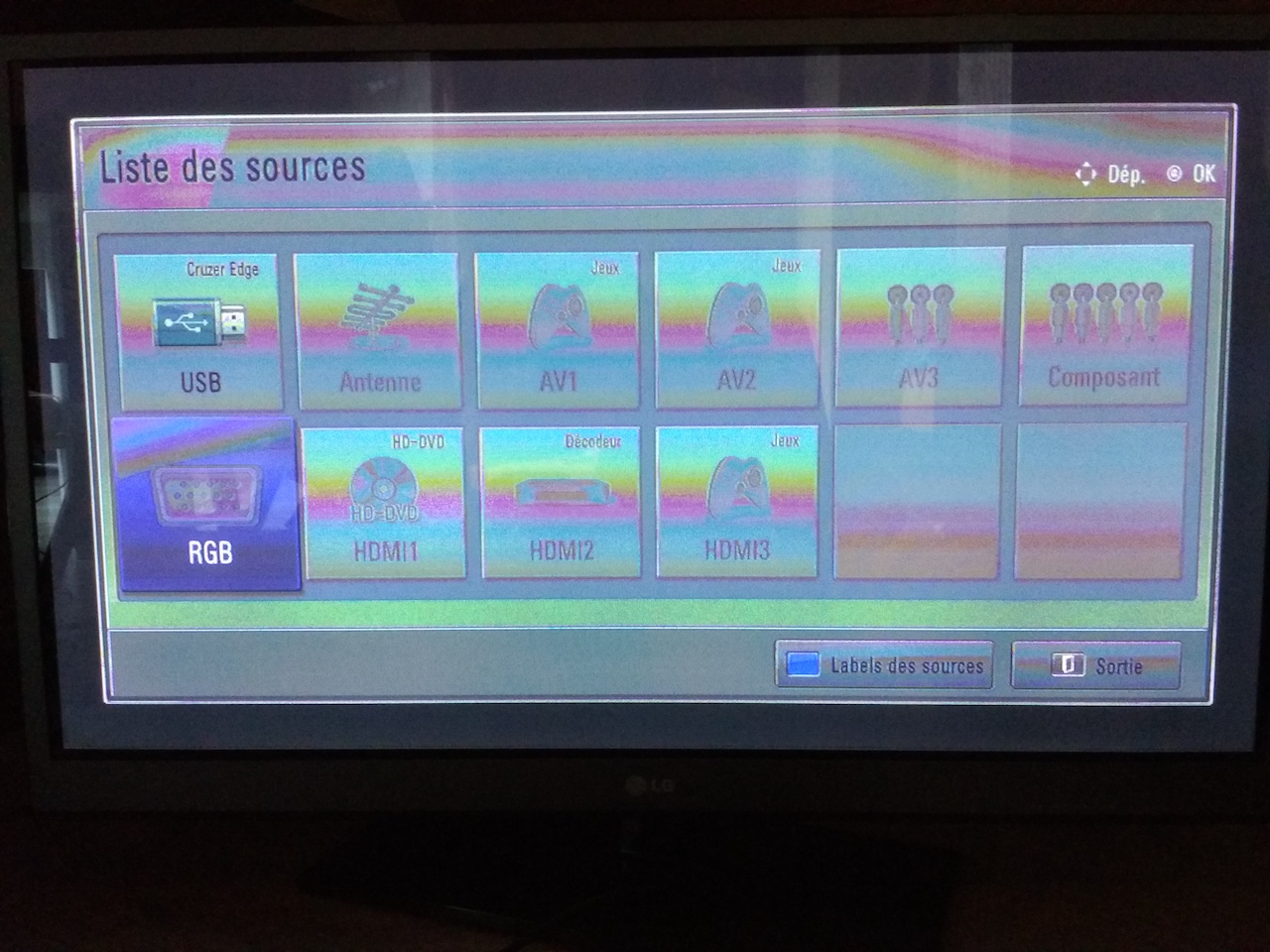

                    Here are some updates on my issue.
                    I finally managed to get a picture on my TV with both ZSUS and YSUS plugged but the picture is blurred and purple (see pictures attached).
                    What I did is to replace Q708, Q709, Q703,Q713 and the IC702 on the YSUS and install the 20V Schottky diode that was missing on the ZSUS.
                    Do someone know why the picture looks like that?
                    Is it the ZSUS that is still faulty like described by tom66 in his troubleshooting guide?
                    https://www.badcaps.net/forum/showpo...39&postcount=2
                      My problem is now solved, I replaced the ZSUS board and the colours are back to normal.
                      I ordered more parts and will still try to fix my old ZSUS board.
