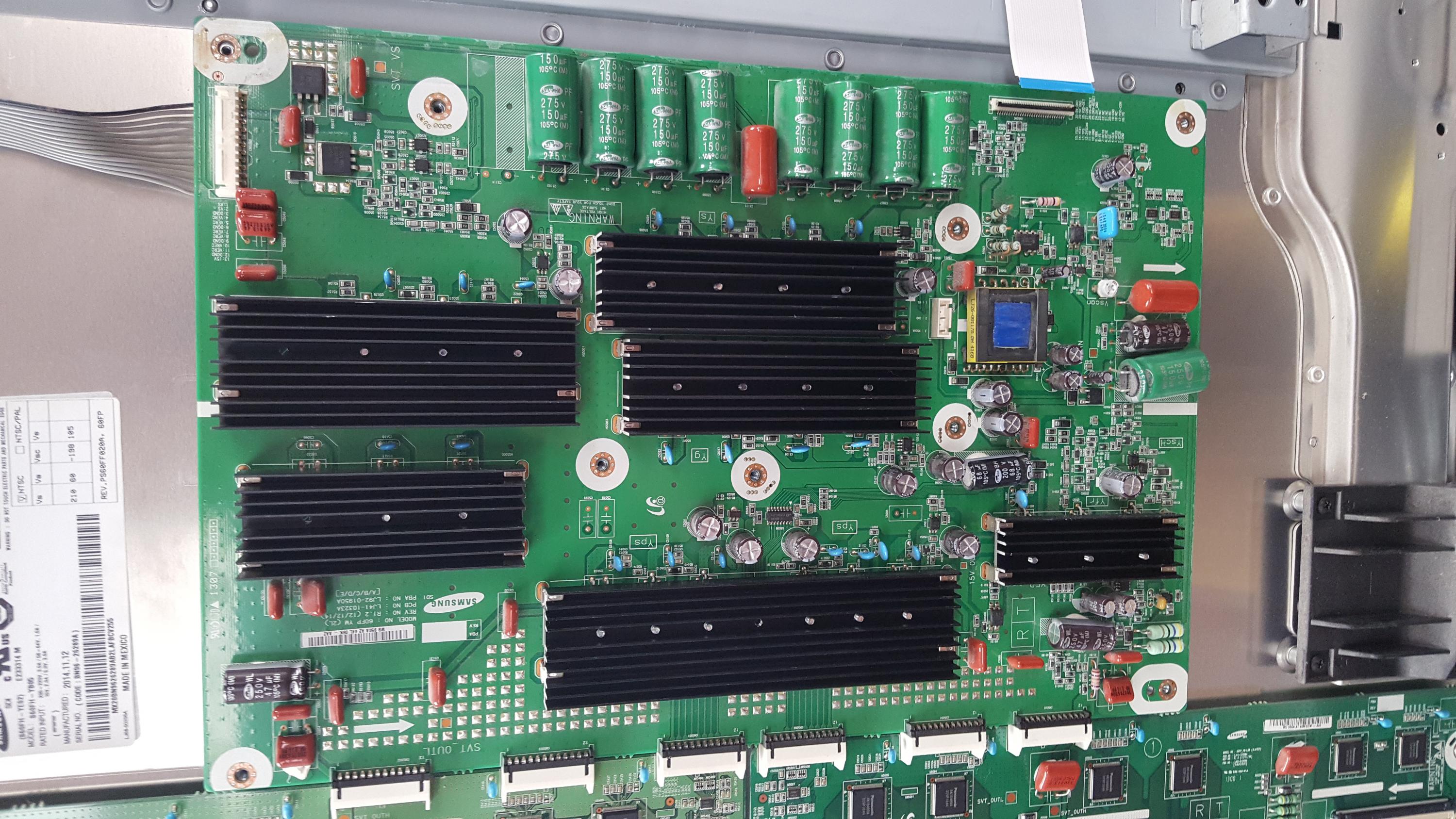

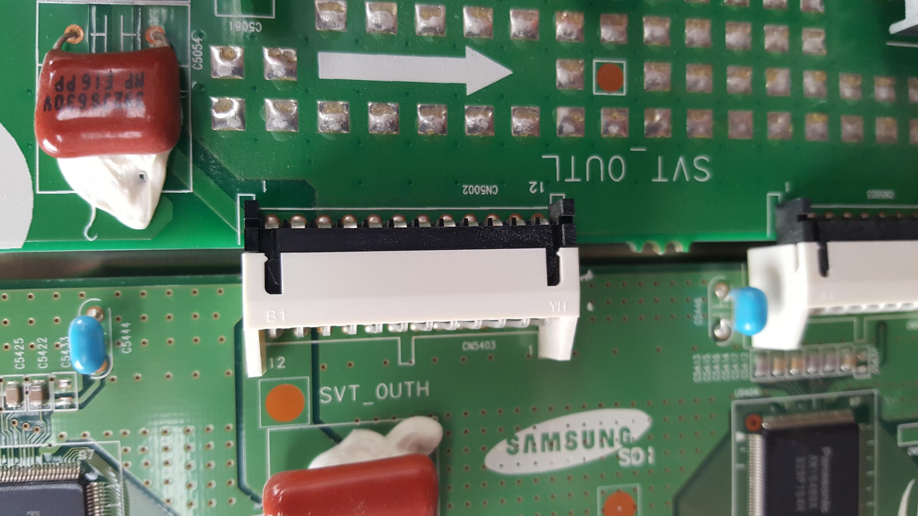

    Suspect Y main (LJ92-01950A) is bad on this. As the title says, I can't figure out how to disconnect the boards from each other. Don't want to damage the connectors (the black/white ones, 6 total). Pics attached.
    Thanks for any advice.

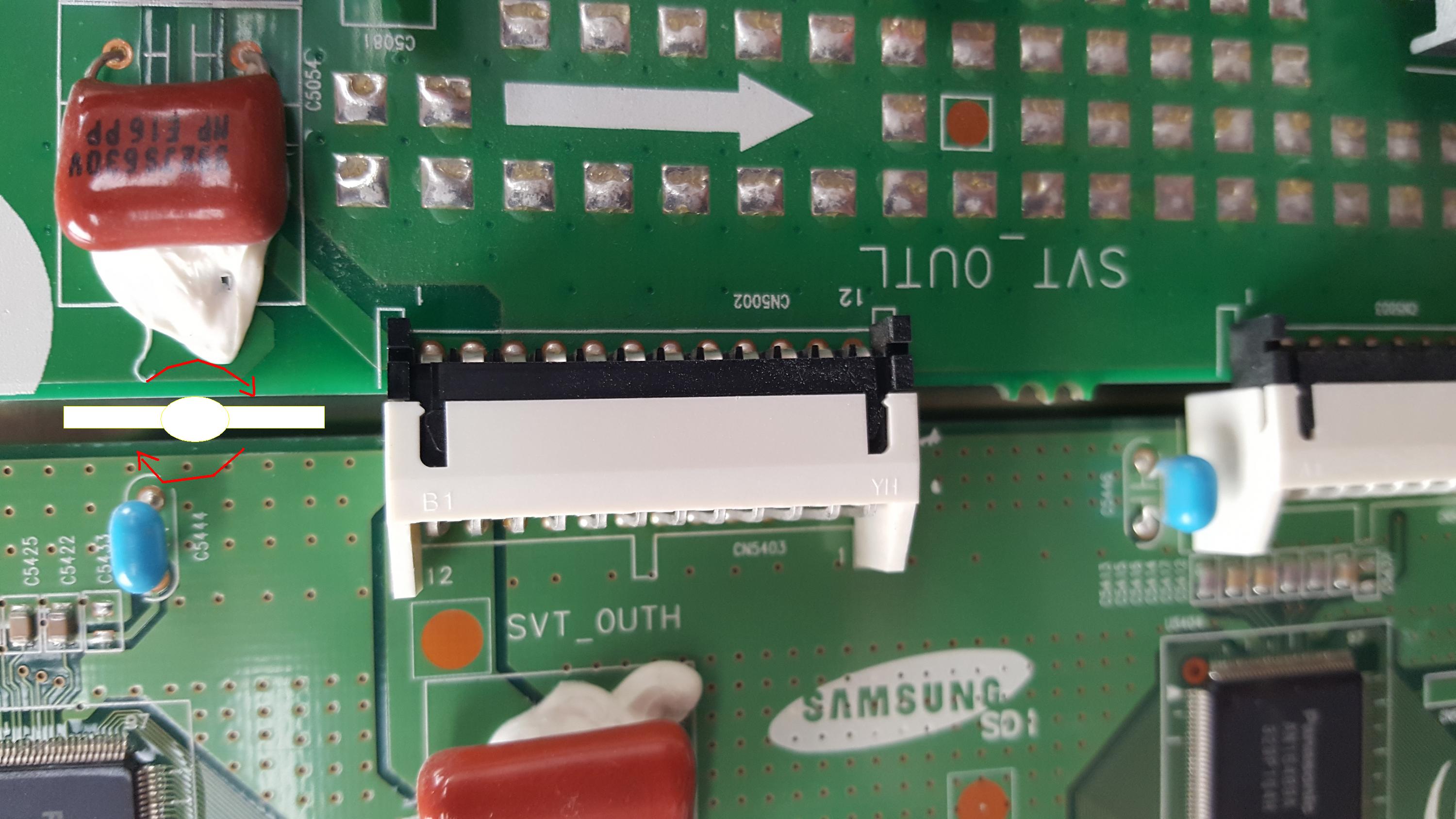

    The black unplugs from the white, If they are in tight, I use a flat blade screwdriver inserted between the y and buffer and twist the screwdriver, the plugs will seperate.

      Aha, worked like a charm! Thank you, sir. Much appreciated.
