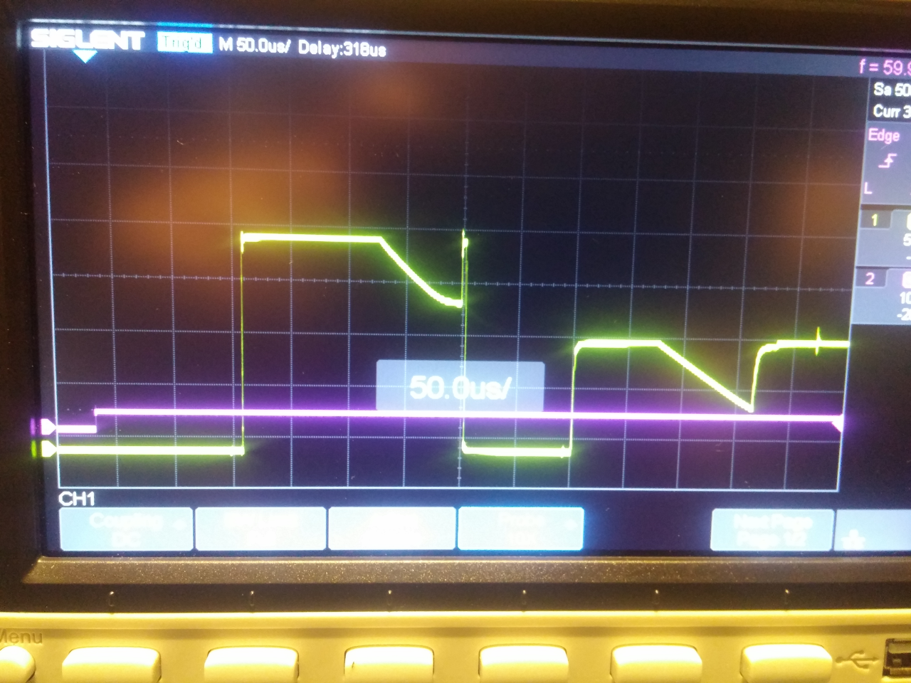

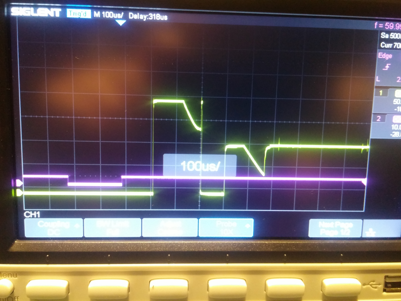

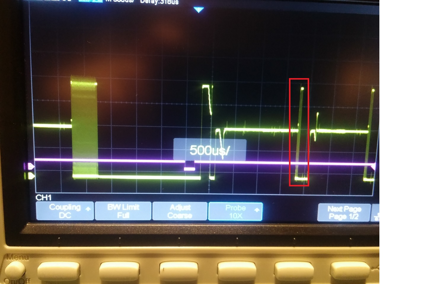

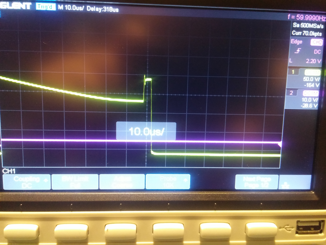

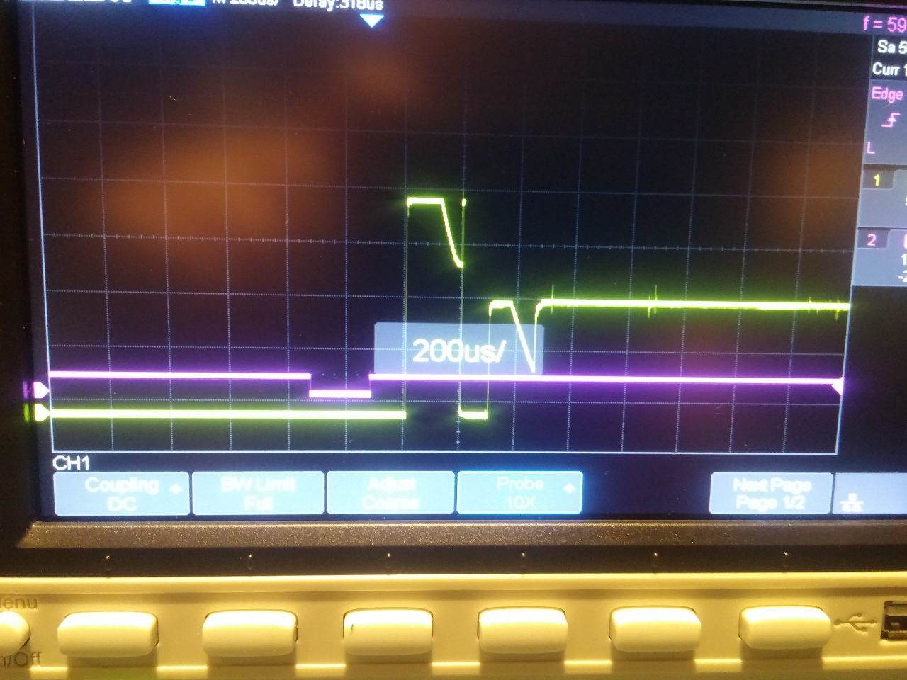

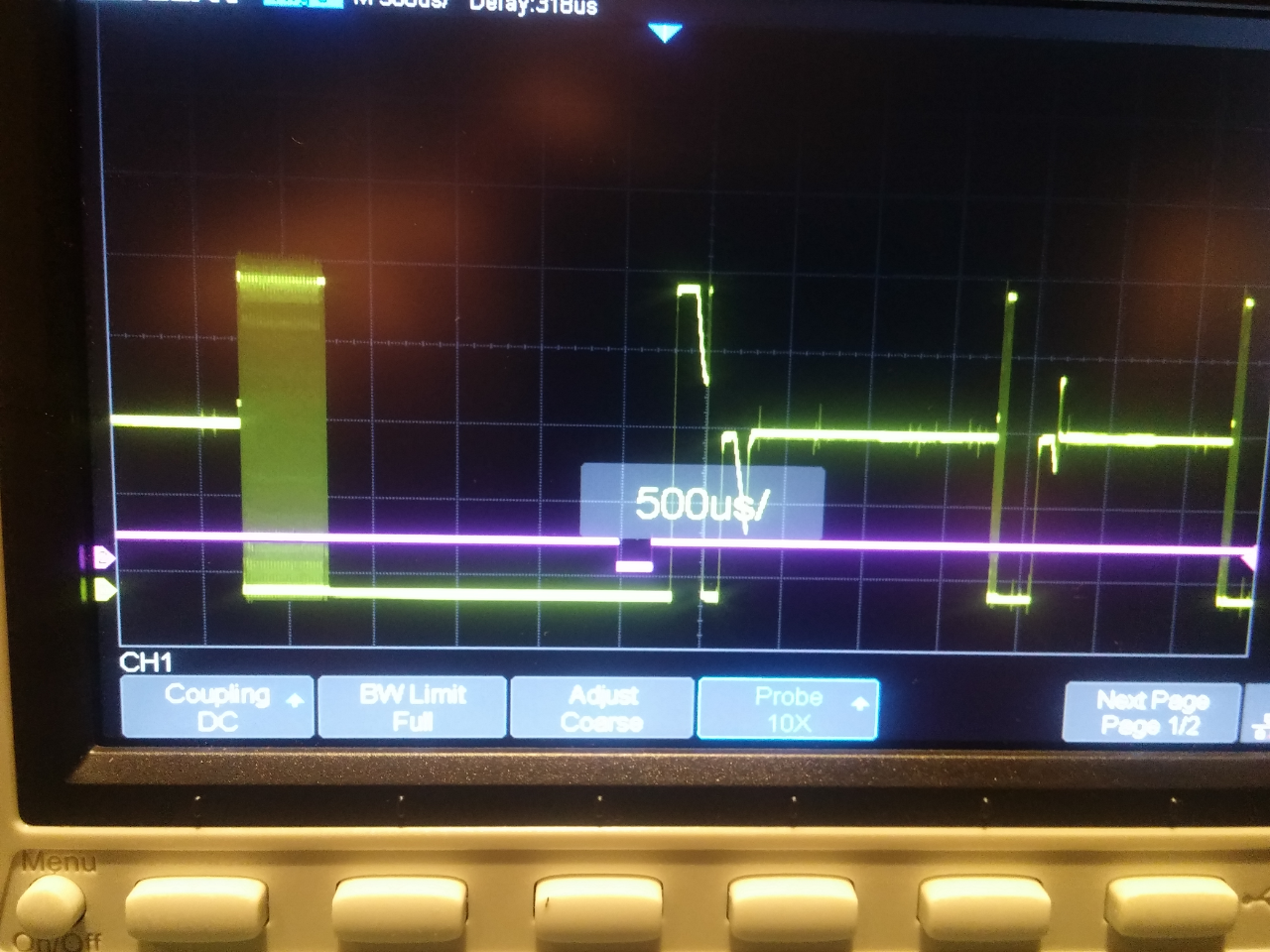

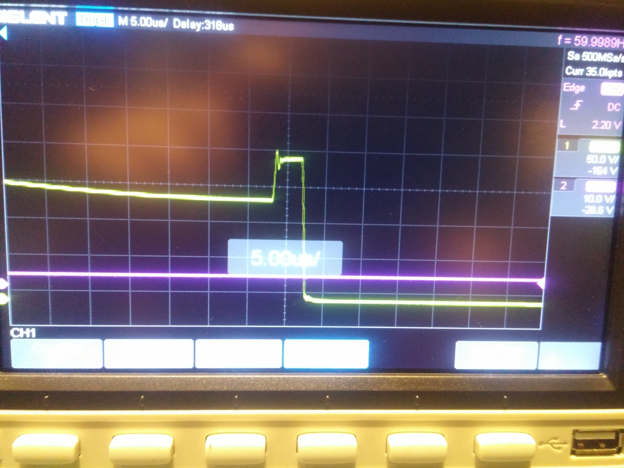

        Re: LG 60PZ750 running hot and maldischarged
        I don't have an experienced eye but what does seem to change is the thickness of the vertical wave, seemed to get thinner ?? Below are a couple of links.
        https://www.youtube.com/watch?v=P4kxFZIaTSU
        https://www.youtube.com/watch?v=mHM3ycuSHHc
        Originally posted by tom66
        Yeah - looks odd
        Can you try setting the panel on a fixed colour pattern so that the waveform doesn't change - you could use something like MS Paint
        Then observe the waveform and see if anything happens to it as the fault develops - a video of the waveform may help me here

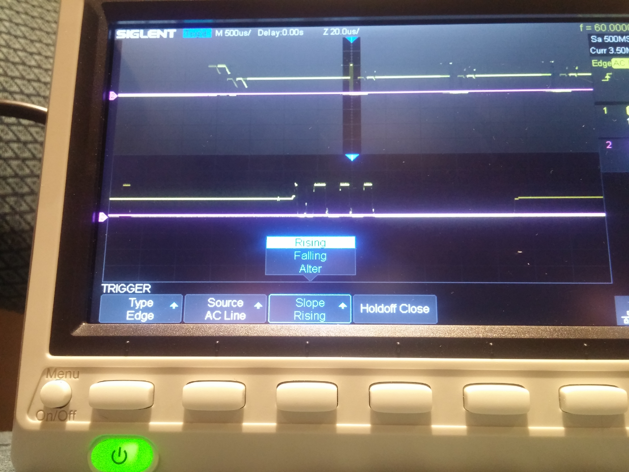

                      #30
                      Could you step me through that, scopes are still very new to me. Thanks
                      Those heatsinks sound quite hot...
                      I would use your scope to further investigate the waveform thickness issue, as you mentioned above, using the NORMAL trigger and pan/zoom controls...
                        #31
                        Set your scope to NORMAL under trigger settings, all other settings as before.
                        Zoom into one of those sections that has a "burst" in it - the bit moving rapidly between voltage. I'll highlight it if you need, but no software atm. Zooming in the horizontal axis is accomplished using the timebase dial and the horizontal position. Hard to describe exactly what you're doing, but it comes naturally pretty quick. You'll want to be able to see the individual up and down parts of the waveform - a "square wave" http://recordingology.com/wp-content...quare-Wave.gif although it'll look a bit more rounded than this)
                        We'll want the screen to be showing a static white / shade of grey / picture on it until the fault shows (be aware of image retention - 20 minutes static image should be ok, but no longer without having something else on screen first)
                        Then just watch to see if anything happens, see if you can correlate changes on the screen with changes in the waveform, if you don't know what you're specifically looking at feel free to take a video of it.

                          #32
                          When I put the scope trigger to normal the readings on the scope disappear, also I can't seem to get a square wave when on auto.
                            #33
                            OK that's odd, are you triggering off CH2 with CH2 connected to VS_DA? If it has a stable waveform in AUTO mode, then NORMAL mode should work just the same. All AUTO mode does differently is if the waveform appears less frequently than the oscilloscope expects it automatically fires a trigger anyway, so you always see a waveform there (useful for initially setting up the scope or doing quick tests). So NORMAL should work fine if the waveform is stable...I guess, just check your connections and setup again. Post a picture of the trigger settings menu on your scope if you're unsure of what you're doing.

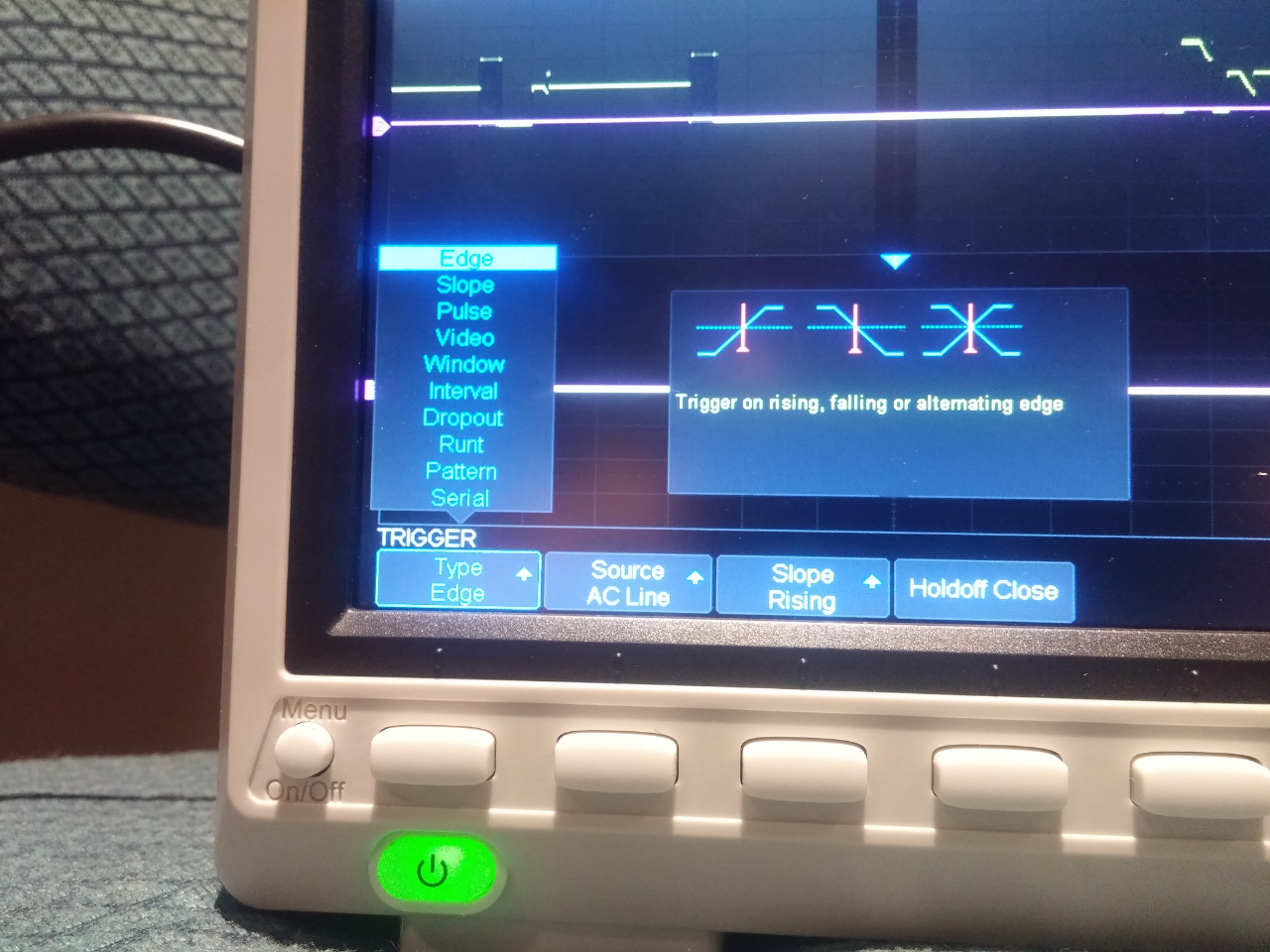

                                #35

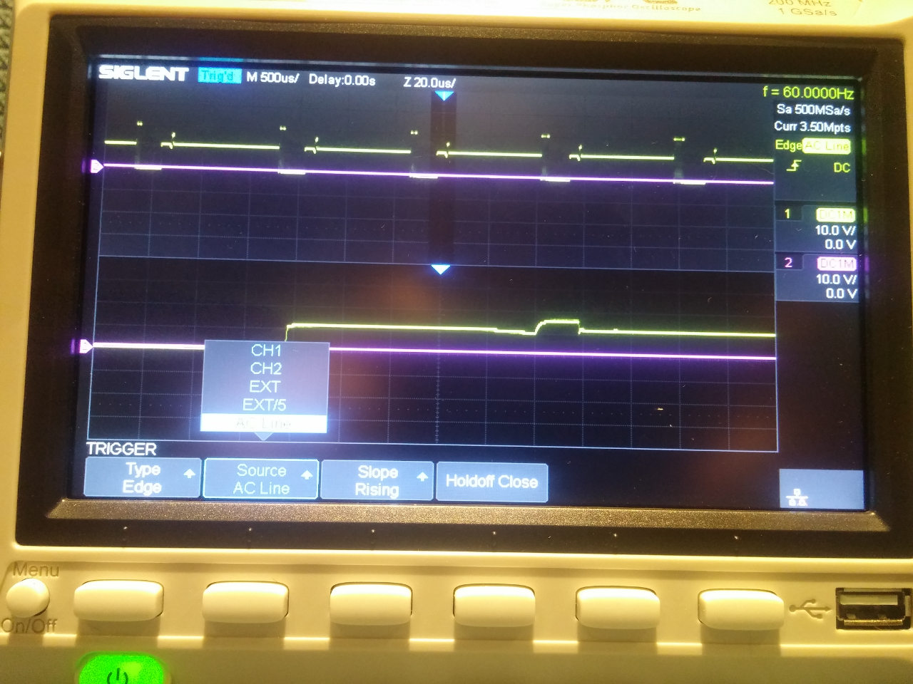

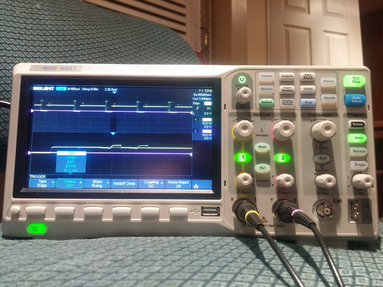

                                Also the only way I can get the trigger to work in normal mode is when the source is set to "AC Line"
                                • goldbird78
                                  • Feb 2018
                                  • 188
                                  • canada
                                  #36

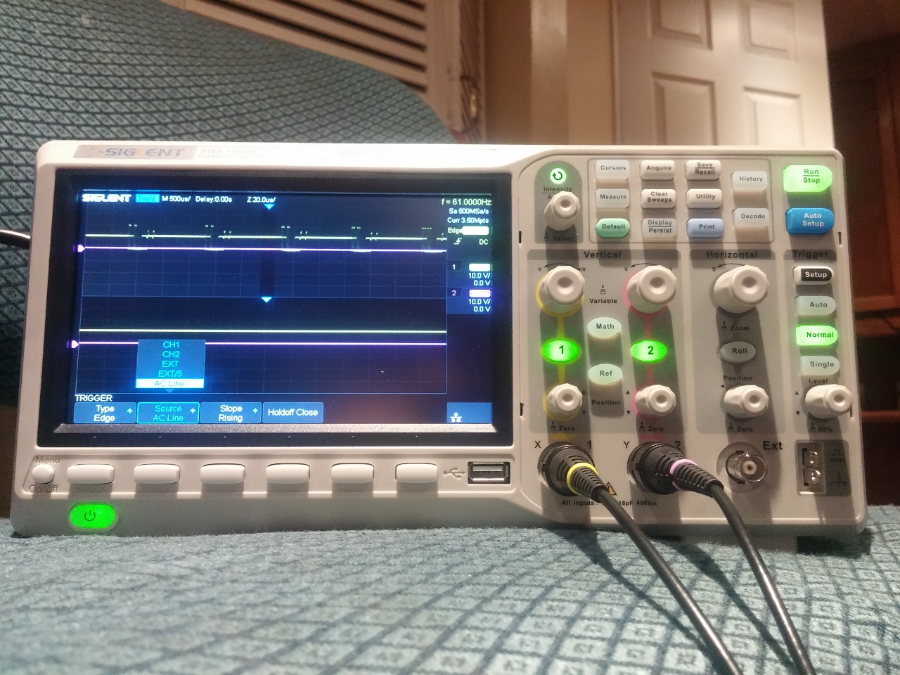

                                  My scope setup :
                                  Ch1 turned on, probe set on 10x, v/div set to 10v and probe on output of zsus board
                                  Ch2 turned on, probe set on 10x, v/div 10v and probe on control board vs_da
                                  Both probes ground clips on grounded screws
                                  Trigger source set to channel 2
                                  Trigger type is Edge
                                  Trigger on auto (I can't put it on normal with this setup, screen goes blank)
                                  Slope is Rising
                                  Horizontal time 500us
                                  Turn on TV with blank white screen
                                    #37

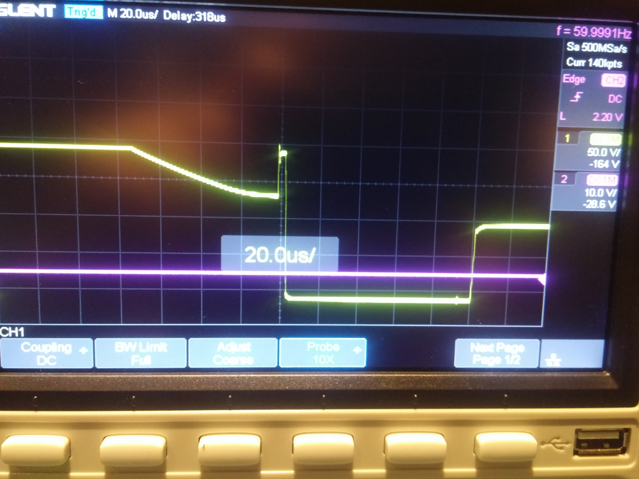

                                    CH2 needs to be 1V/div and trigger level at about 2V. Rising edge. 10X is fine as long as scope is also on 10X. You should check CH1's 10X mode is set correctly. Recall previous instructions where both probe and scope need to be on 10X to get correct readings (so oscilloscope scales them correctly)
                                    AC line trigger uses 50 / 60Hz mains voltage as a reference, it is not useful for this application but has uses in power supply repair etc
                                    • goldbird78
                                      • Feb 2018
                                      • 188
                                      • canada

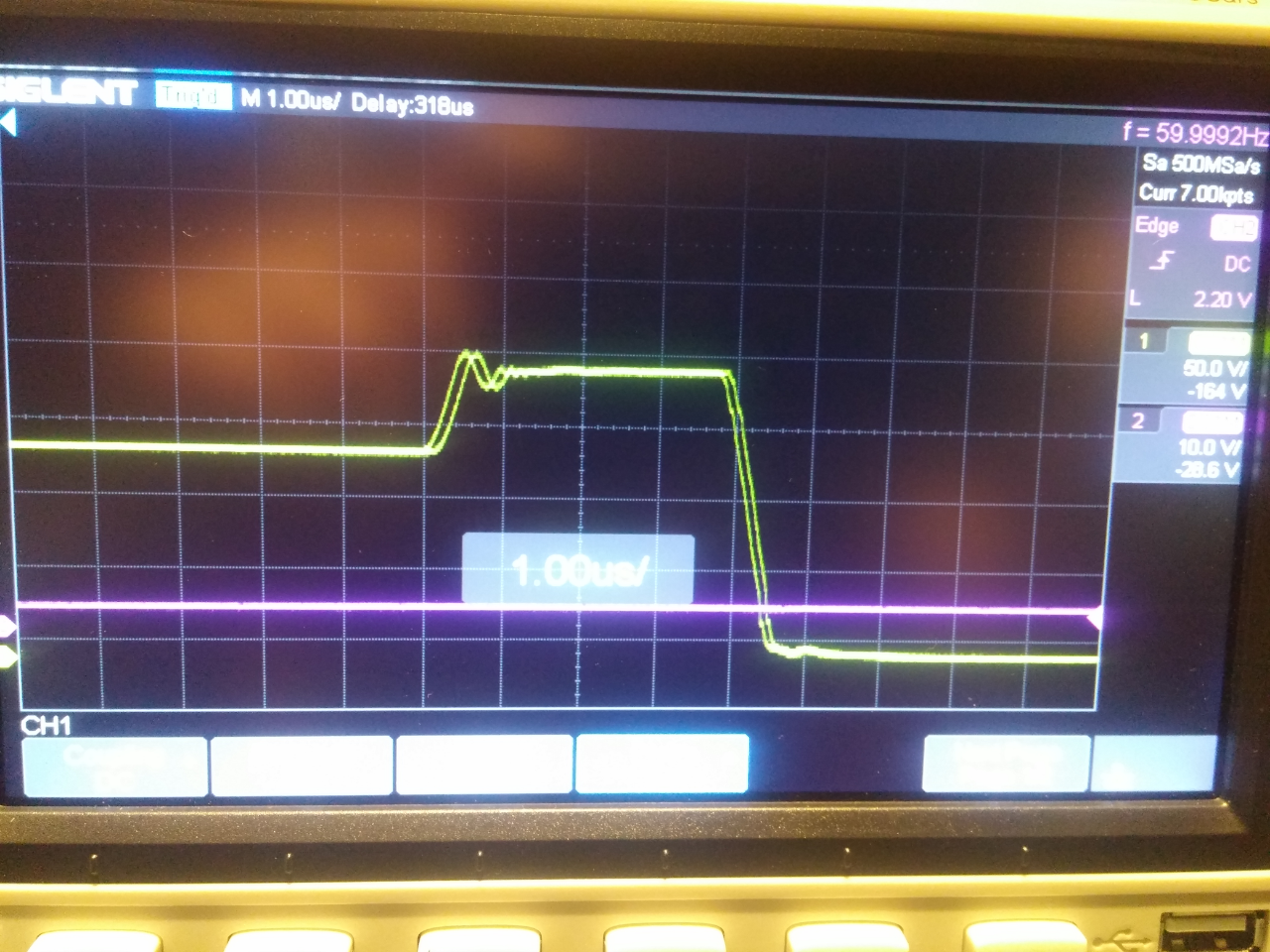

                                      #38

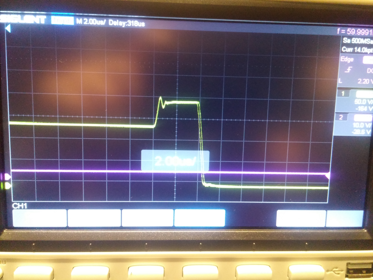

                                      Ok, How do these look ?
                                        #39
                                        Great.
                                        Zoom a little in on this area...we need to be able to see the cycles more clearly
                                        Then wait for a fault...what do you see? Any obvious change? Could be very minor change.
                                        If it's not so obvious on this one, we may need to look at a larger burst (like the one on the left of the image), as fault may only be present on those ones.
