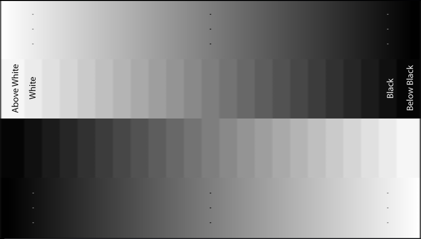

    Hi all. So i have the forementioned tv. I plug it in, click the power button. I hear a startup chime from it. Backlights come on immediately, Then I kind of see the box that says no signal but it's very faint and kind of discolored. There's also a bit of a static overlay. I tried to capture it with my phone but my camera on my phone has seen better days. My immediate thought is either a problem with the screen or more than likely something wrong with the T-con board. However, it's been a while since i've messed with tv's like this. Any insight would be helpful. There are also what i would call vertical bars similliar to when you see a brightness adjustment test shown in the picture below. It's not quite that but the bars look kind of like it.
