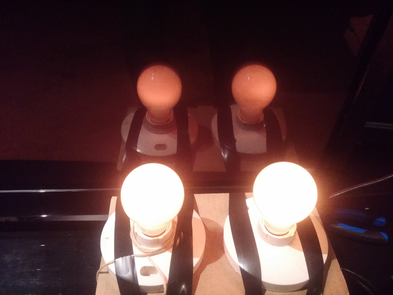

Hi All, I am attempting to repair 60pz750 zsus board and I am one 270 smd (27 ohm) gate resistor short for a FGPF4633 transistor, could I put a 150 (15 ohm) & 100 (10 ohm) in series to equal 25 ohms just for test purposes ? There are normally two 270 gate resistors in parallel per transistor so I would be putting this setup in parallel with one 270. Again just for a quick test until I get some 270's. Thx
repairing a EBR73561701 EAX64232101 Zsus board

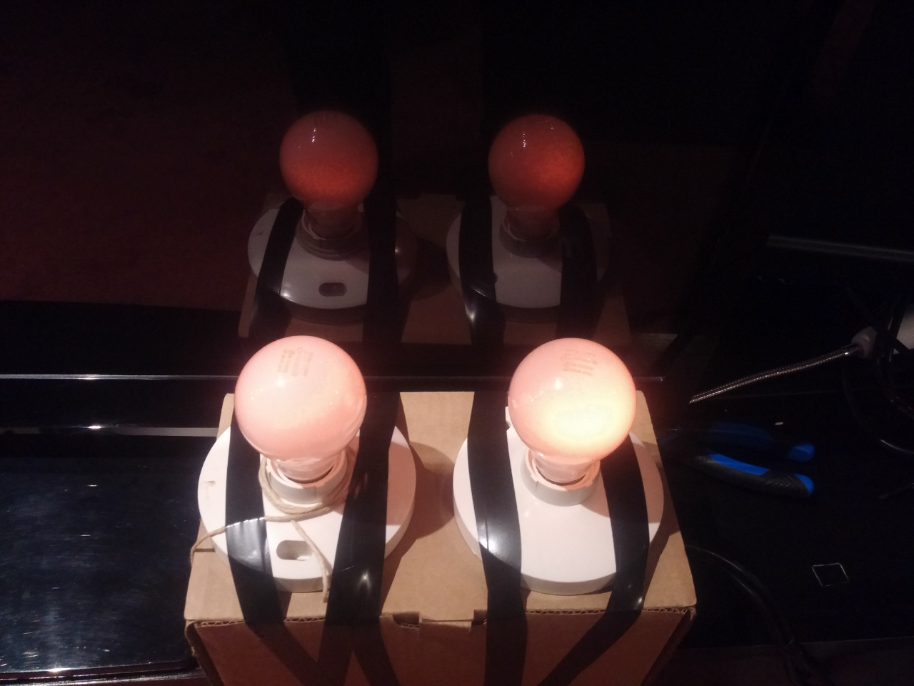

I think I may have successfully repaired this Zsus board. I am doing the bulb test right now and the TV has been on for 30 min with no issues, the bulbs are going from dim to approx 60% brightness at times. Is this normal or could there be another issue with the board. I replaced all 6 IGBT transistors, all gate resistors and the fuse. Attached are a couple pictures. ThxAttached Filesif you find these attachements useful please consider making a small donation to the site

I took the bulbs out and wired direct and the TV ran great for about 1 hour and then the pictures started to look maldischarged and the TV started running very hot. I took a reading with my infared thermometer and the top of heatsink was well over 200F, when I shot it to where the transistors are it was over 300F. Anyone have any ideas ? ThxLast edited by goldbird78; 03-22-2018, 06:44 PM.Comment

Check the big inductors on both sustain boards for cracked solder joints. Not sure if that would be the problem, but it is a common problem on these boards.------------signature starts here------------
