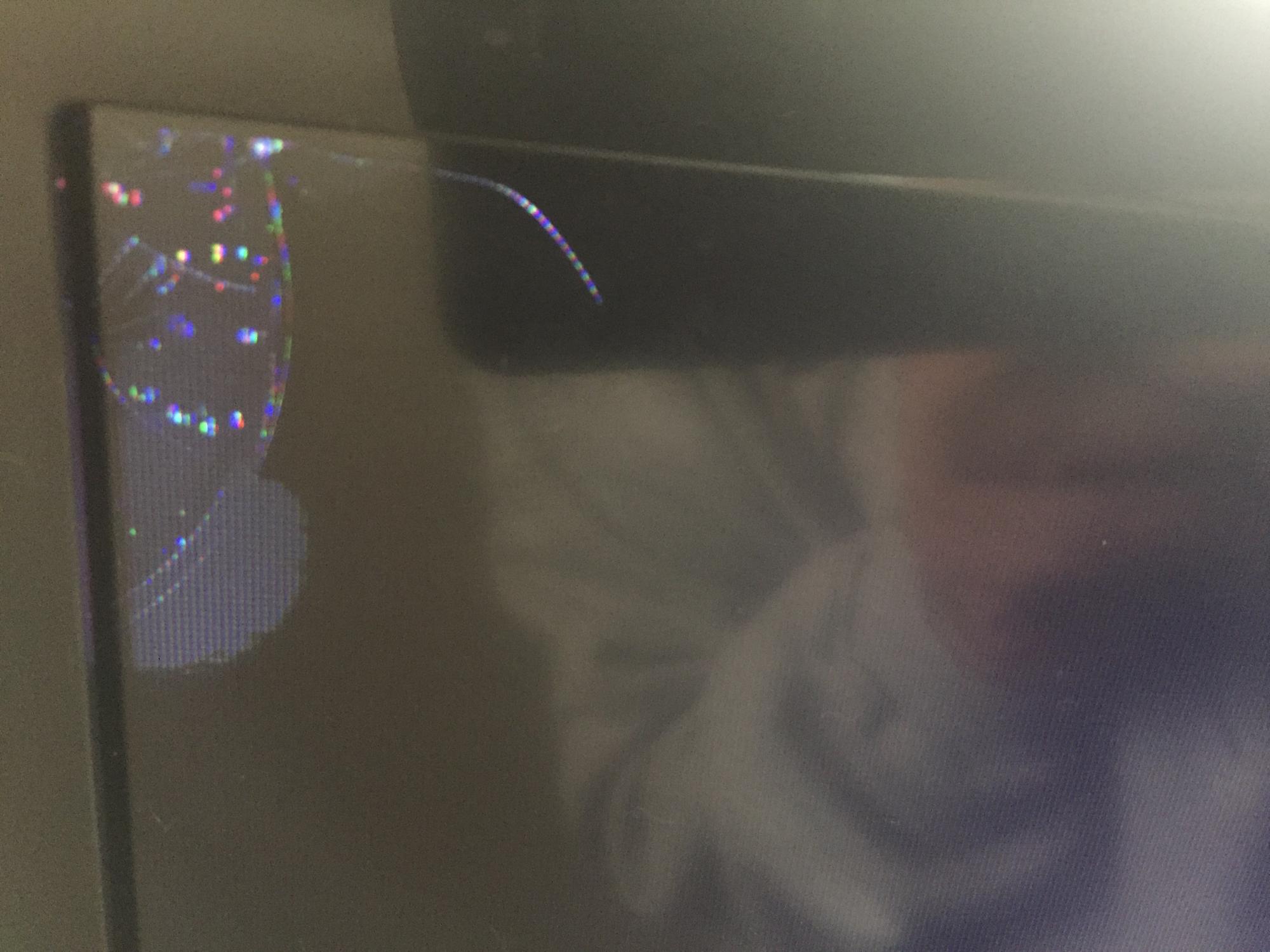

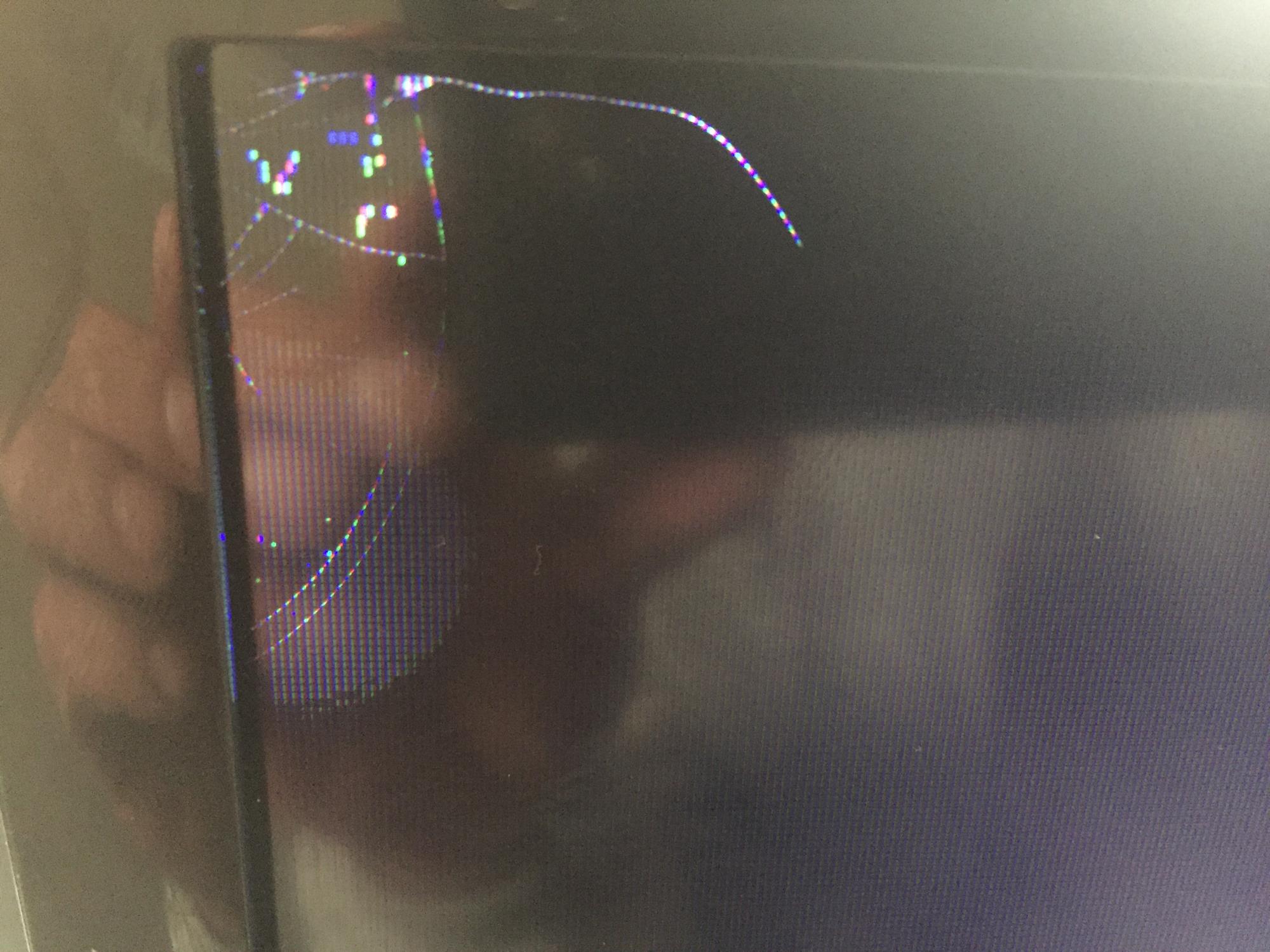

                      Re: What causes dead pixels?
                      Stuck pixels or small crack on top left of Samsung 50 inch led tv?
                        That's a crack. No question about it.
                          Looks like a cracked LCD.
                              Damn was a nice Sammy 50 inch led with no power no standby light paid $25.00
                              Ordered a new ps for 12 bucks, this morning disconnected mb from pb, Backlights worked saw what looked like stuck pixels on 1.5 inches top right screen. The rest of the screen looked good. You live you learn
