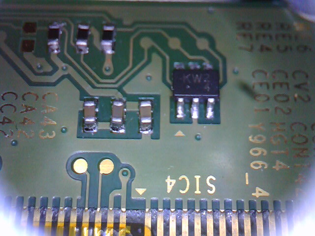

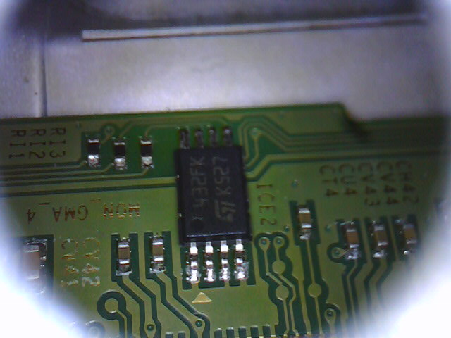

    From the looks of it both driver boards have the same components except the right one. The pictures are of two ics that are only on the right driver board. I couldn't find any datasheets.

          I know it's unlikely for both panel driver boards to go bad so im thinking components that is not common with the other. The pictures are of two ic I found on the right driver that's not on the left. I am unable to find datasheet for these ics.
            Re: Has anyone ever repaired a bad panel driver?
            I'm thinking the one is the edid eeprom. You wouldn't need a problem with both boards to have no picture on either side.

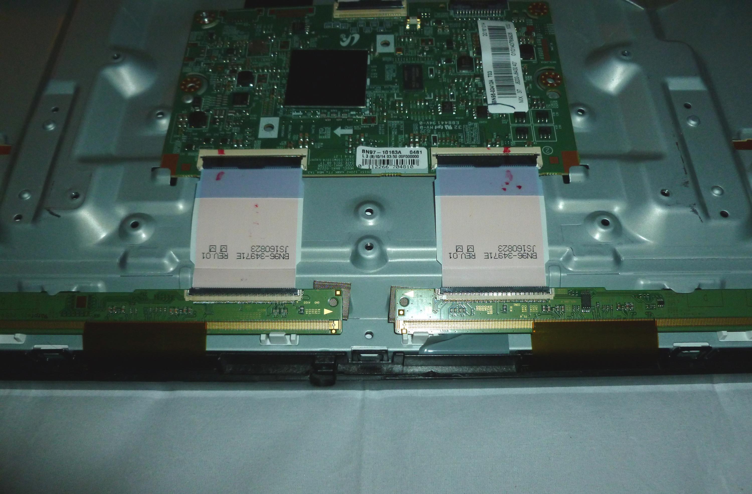

                      Yes I did that and I just checked for shorts I can't seem to find any. Not sure about those two ics though. I think I'm about to throw in the towel on this one. I really appreciate everyone's help and suggestions.
                        #31
                        You could always try applying 12 V to AVDD Before you give up to see if there is some kind of a picture there
                          #32
                          Also, it's possible the main board isn't sending any signal.

                            It's not the right way to test a panel. 1st=test supply tensions on the tcon (attached and detached), 2nd=test those voltages on the panel's boards. If there are no tensions on tcon it's unuseful to do pass 2.

                              I've had a couple occasions where I had another tv with the same LVDS pinout and put them back to back and plugged the LVDS cable from one to the other. Picture wasn't right, but it told me if I had a main board problem (no T-Con) or a panel problem.
