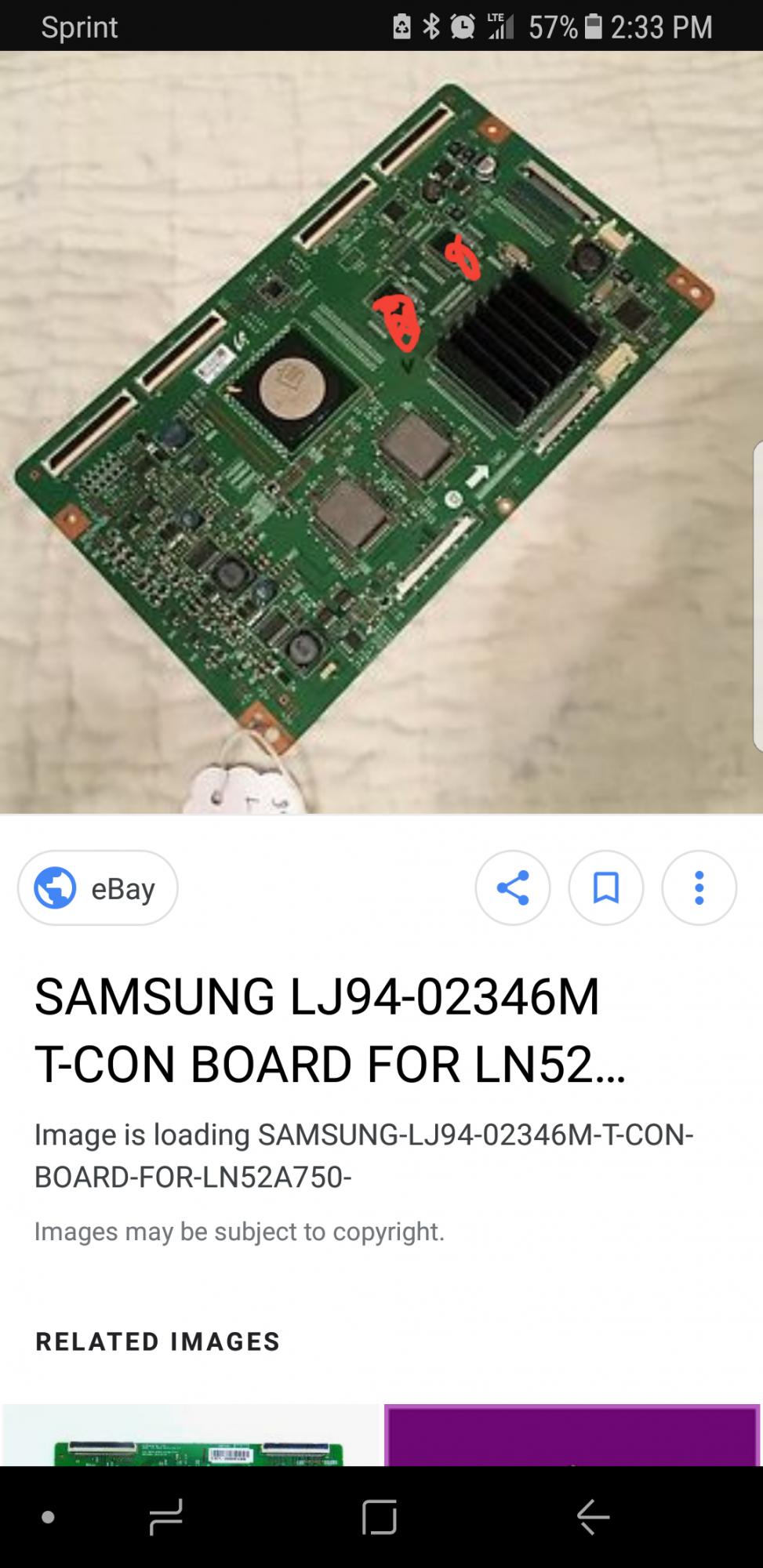

                      Re: Samsung LN52A750R1FXZA Turning on and off
                      Ok. Sense we have the heat gun out try heating up the two ICs above the main processor on the tcon board.

                                  What I found is that disconnecting the single cable to the tcon board allowed the tv to remain on with backlight on. The picture was obviously no connected. Initially, I unplugged the cable and placed it back on. The TV signal on the display remained stable for about 4 minutes before cycling again. Since the cost of a board is around $25, I have purchased the TCon board which is removed from a TV that had a broken screen and is verified and returns provided. Shipping is free for 1-5 day service.
                                  My Samsung LCD TV is a LN52A750RLFXZA and the TCON board is LJ94-02346D FRCM_TCON_V0.1 the white label at the top just below the LCD screen connection contains the first numbers just after the initial letter. S2346D is the first part of the number on the label. This translate to the board part number above. If there is no zero before the number add a zero. to get the LJ94-02346D. LJ94 references the Samsung part for the LN52A750 or LN52A650 both end RLFXZA if I recall correctly.
                                  If this does not fix the issue of a screen horizontal lines progressing to a washout image and subsequent shutting down and turning back on then I can try the cable and move back to the main board.
                                  I tried heating the TCON board, may have overheated hit, but that did not help fix any potential solder joints as discussed in this thread.

                                    #77
                                    if you don't have the shield, it will prolly be hard to find, you can just add little heatsink/s to the necessary chips on the tcon board, doubt that you need the "conductive adhesive"
