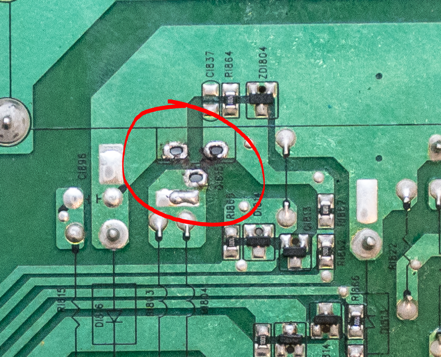

      Any reason why the transistor sparked on me? I don't want to just buy another one to have it also fail.
      I took an air compressor to the board and got every bit of dust and deox-it. I double checked my solder points for the transistors too.
      The spark happened UNDER the board, I could see the light through the PCB. It was directly under the transistor.
      Here's a picture https://i.imgur.com/nqdhWHG.jpg
      This happened AFTER I removed and reinstalled the transistor. I tested the transistor after and it is no longer working.

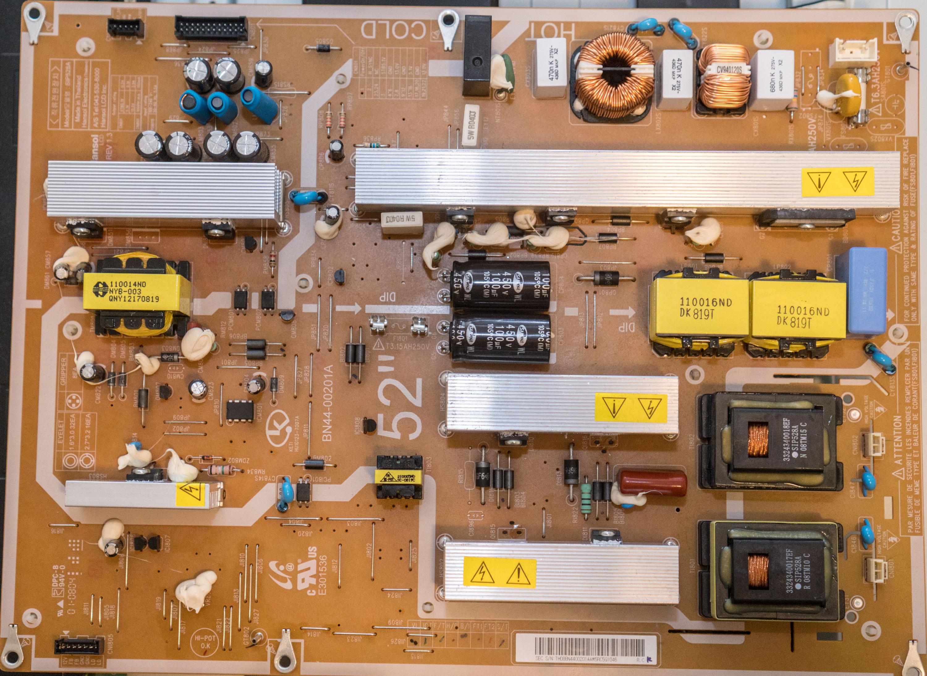

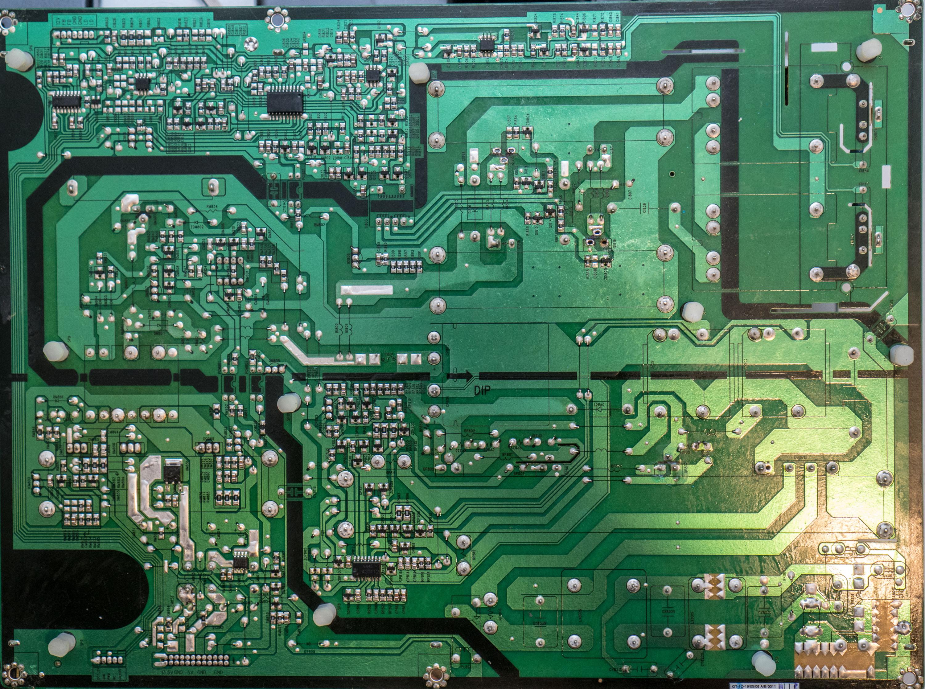

                      To fix power supply board I will need good clear pictures of the whole top and bottom side of the board and closed up of the location where you see the sparks.
                      Power board P/N BN44-???????
                      If you can upload the pictures here will be best.
                          I can't get the screen to display anything, I don't think I'd be able to supply a firmware update through the system.
                          I have attached a back and front and a zoomed in section on the spark area. I removed the transistors already. Now that it's the 4th time I've removed it (after the initial sparking) I've torn a trace off lol.
                          Power board is BN4400201A
                            Re: Samsung LN52A750R1FXZA Turning on and off
                            That section is the Inverter section.
                            http://www.shopjimmy.com/catalogsear...?q=BN44-00201A
                            You can try fixing the power supply board or buy a replacement.
                            I do not know how bad the damages are but here is the schematic:
