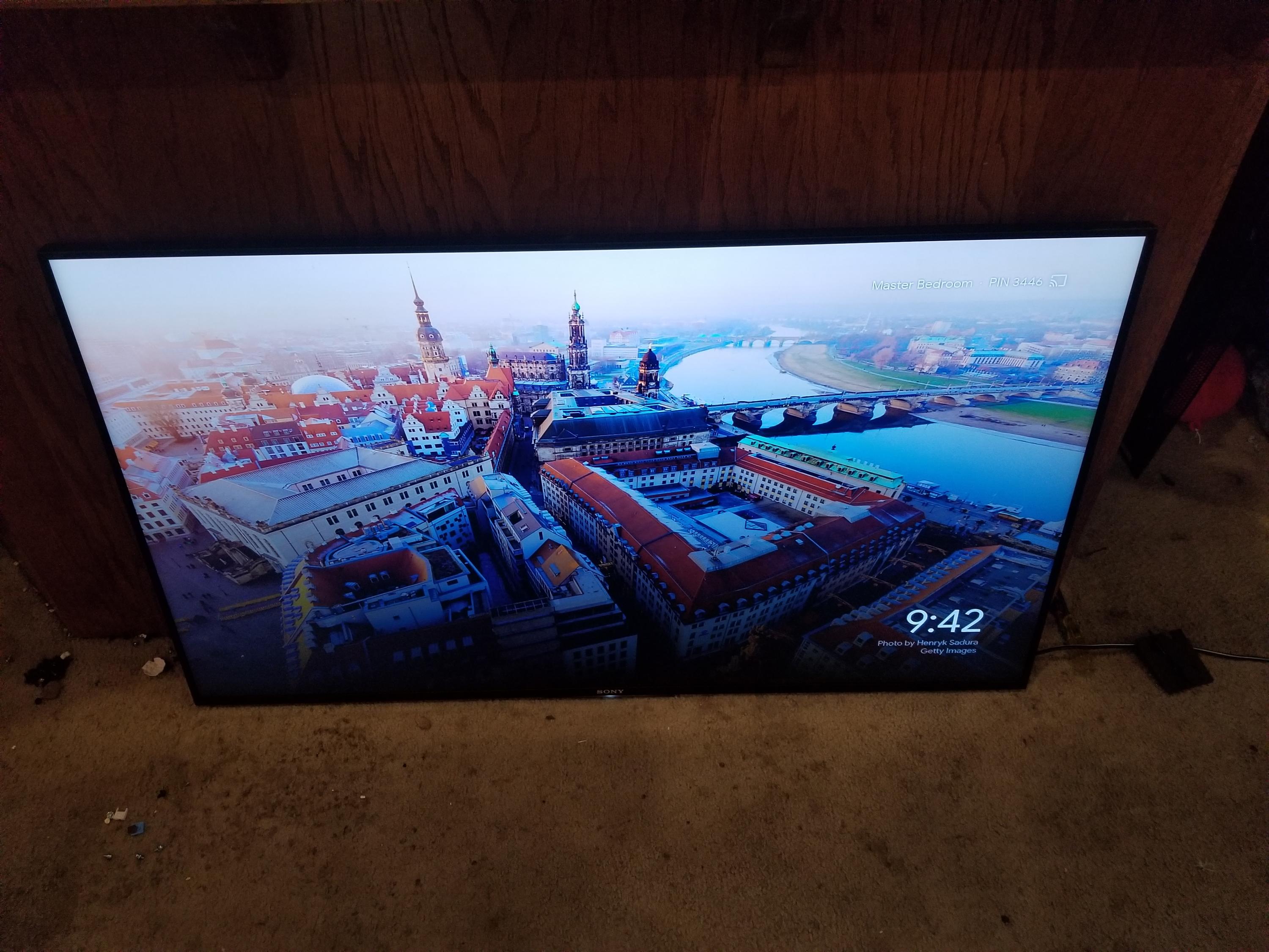

    Picked up this TV yesterday. Original owner said screen went out. Rather vague but OK as long as I didn't see any cracks I said why not. Only 40 bucks. My 65 cost 2300 new! It's a 55" version of the 65" and I've had for 3 years running strong up on the wall.
    When turned on right side black left side white with faint vertical stripes.
    My 1st rule of measure was to pull all covers off to expose LCD source driver boards on the panel itself.
    This is after trying one ribbon at a time trick. Left side would show a faint picture right side remained black.
    Checked MLCC capacitors and found right side shorted. Look for the lowest resistance reading in found one reading .7 Ω where the others are reading 1.8 Ω. So I went ahead and removed it knowing that all these capacitors work in series. The bad capacitor was the 1st one nearest the ribbons that go into the source board from the tcon.
    Powered up and have perfect picture!

      So you got the low reading while in circuit or did you pull a leg?

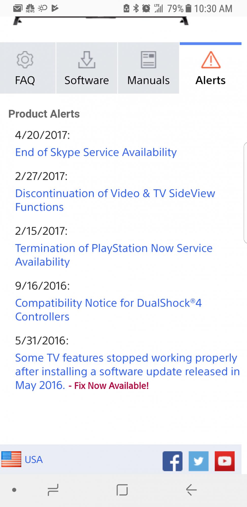

        Dam nice score, 55 3D Smart tv. There's a firmware update warning. https://esupport.sony.com/US/p/model...OC=3#/howtoTab

          Prob. not a big deal, says Some TV features stopped working properly after installing a software update released in May 2016. - Fix Available!

            I got the low resistance reading in circuits. Remember to remove tcon ribbons 1st. I look for the lowest resistance reading on each of the 8 across the right. When you find the lowest resistance reading capacitor pull it cause that is usually the problem. Capacitors along source driver boards on panels should never have a low resistance reading. Not too sure why these things short out but it does happen.

              Nice! Everything after may 2016 is downgrading the tv. Typical...
                Thx for the warning! I probably won't be doing an update lol
