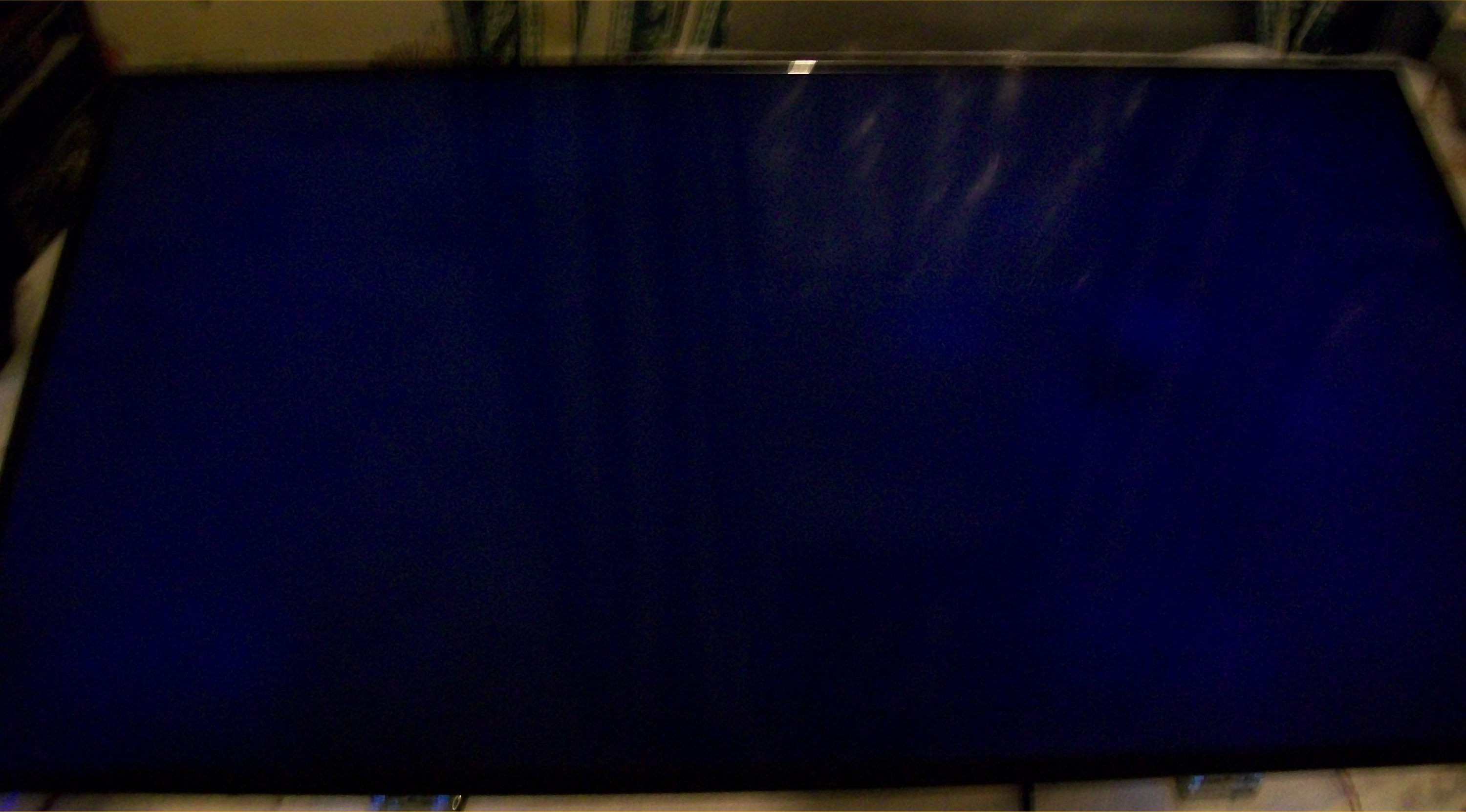

    hello all,
    After repairing the LEDs on a 50" TV (Sharp LC-50LB370U) I managed to crack the LCD in the lower left corner as can be seen in the first pic @ post #67 seen here https://www.badcaps.net/forum/showpo...0&postcount=67.
    I have tried retesting all the voltages which were normal, and reseating the t-con cables, running with only 1 t-con cable connected at a time etc. but I cant get any picture to display at all on the screen.
    My question is could a small crack like that kill the whole panel?
    Is there anything I can try before scrapping the TV?
    thanks

    Re: Can a small crack kill the whole panel?
    There are plenty of cracked screen that display colours/strips/pattern across the screen so I would have thought there would have seen something on the screen.

      That's what I was thinking..I've seen screens with way worse cracks display at least something.
      I went back a double checked my voltages and all were the same except for 1. DIM = 0 standby and 3.2v power on and is now 2.7v after fixing LEDs.
      Also before the LEDs were fixed the black wires at -VLED2 and -VLED1 showed 0v powered on or off and now show 4.5v powered on.
      does this seem normal?
      thanks

          I can confirm that a small crack can kill an entire LCD panel because I've done it before, and all that was visible was a very very faint vertical banding pattern.

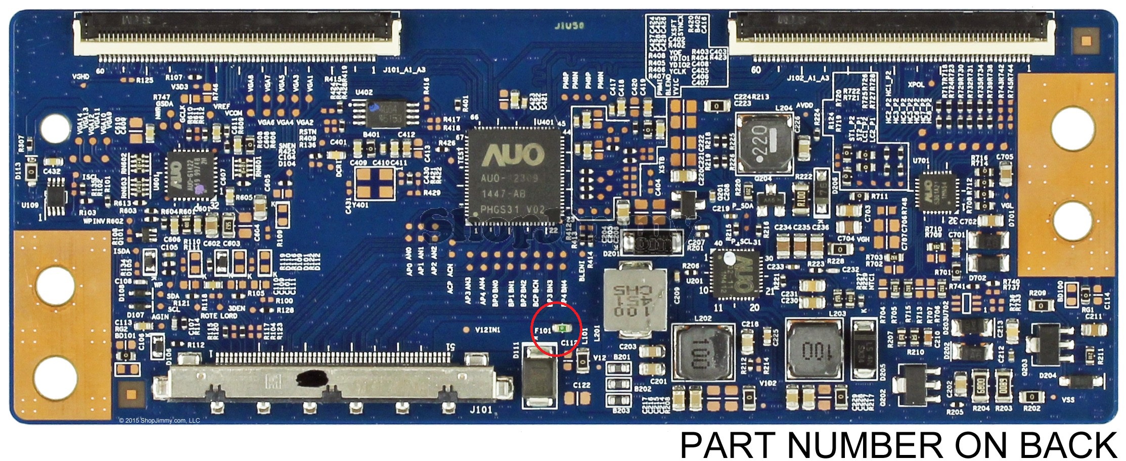

              Sorry about that..to be more specific when the TV is first plugged in it has the red standby light, after pressing the power button the standby light blinks red 7 times then turns blue, the backlights do come on, but there is never any image or change in whats displayed on the screen..just a dark blank screen as seen in the pic below.
              Running with 1 ribbon cable disconnected on the t-con doesn't give a white screen or otherwise change what is being displayed. I've tried each side being disconnected (one side at a time) and nothing changes on the screen.
              Ive retested all the voltages and they all were within spec..the only difference between before and after fixing the LEDs is the connection labeled 1. DIM = 0 standby and 3.2v power on before fixing the LEDs and is now 2.7v powered on after fixing them.
              Also the -vled2 and -vled1 are now showing 4.5v powered on.
              It's probably not really worthwhile to get working, I just hate to give up.
              If I could get it going I thought I would use it in the garage.
              thanks

                I'm assuming you have checked to make sure the you have 12 V going to the tcon board? How about tcon outputs? See anything on the ribbon connections in excess of 20v?

                  done the same thing on a 50 inch led set. when installing the display back into frame I created a very small "chip" on edge of display - messed up set - garbage can. could not believe I did that !
                  When removing and installing display screen - be VERY careful & patient.

                            have you checked any fuses on the tcon?
                            • Gorrillasnot
                              • Dec 2013
                              • 316
                              I checked the fuse F101 on the t-con and it showed .4ohm on 200ohm scale.
                              Is there more then 1 fuse on the t-con?
                              thanks

                                Here's the deal. Yes the crack has hindered the gate driving of the panel, You're area on the bottom crack spot is right where the 1st gate drives the horizontal span of the panel and every other gate consecutively needs to drive with the hand off of the 1st section. Sense that section has been damaged 1st then there is no handshake and no passive information going to the next gate thus for yes this can wipe out the whole panel it is rare but it can happen

                                      if the 15v isn't ever there, then it might be a problem. Based on my limit experience, that gets delivered to the panel.
                                      • Gorrillasnot
                                        • Dec 2013
                                        • 316
                                        i tested both sides of the t-con fuse and get 11.8v so its getting power. I don't know how else to test it.
                                        i havent tested the 15v after fixing the LEDs but before i fixed them and before damaging the LCD it has never showed any voltage.
