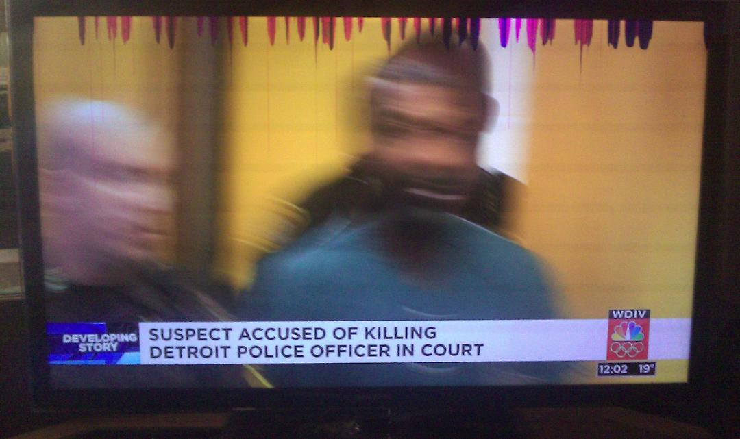

Samsung led lcd tv distorted top screen
  • shelby5041
    • Feb 2009
    • 1504
    • united states of america usa
    Me again
    Is this a lcd panel issue?....ribbon cable to lcd panel issue?
    Fixable or no?

    Re: Samsung led lcd tv distorted top screen
    That tv has spent too much time in Detroit. I should know. I'm from there originally.
    That's a panel issue, there was pressure applied to the panel which caused the interior surface to crack between the liquid and the matrix. I would not pick it up it's definitely not worth it
      Yes too much time in detroit...lol
      I bought it for $10 last night....
      Not fixable.....ok
      But go to ebay and see how much the parts sell for this tv....very worth the $10
      If u look at sold parts for un46d6000 they are in demand and sell at a decent price especially the main board
        this tv is a prety good parts tv.....
          Definitely get your money back in parts! I always hang on to these things because when I get a repair in that needs it and I don't wanna sit there and troubleshoot a board you've got the advantage
