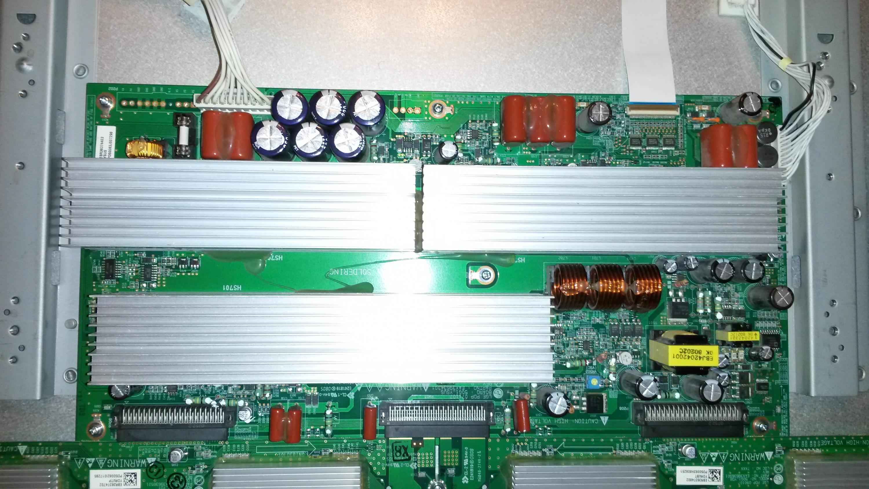

    First off, thanks for all help or advice you can provide me.
    So, I'm having a problem with my LG- TV, to be exact a 50PG100R.
    One day, while watching TV, the display just turned black.
    Sound still works fine and power led does what it's supposed to do (so the TV isn't just turning off).
    Display lights up a little bit, like a the backlight turned on (can't show with a photo, because camera somehow isn't picking the light up) and the pixels look like they are lit up a tiny bit.
    After around two seconds, the display changes to a darker color, but is still lit up (probably the Mainboard dimming the display)

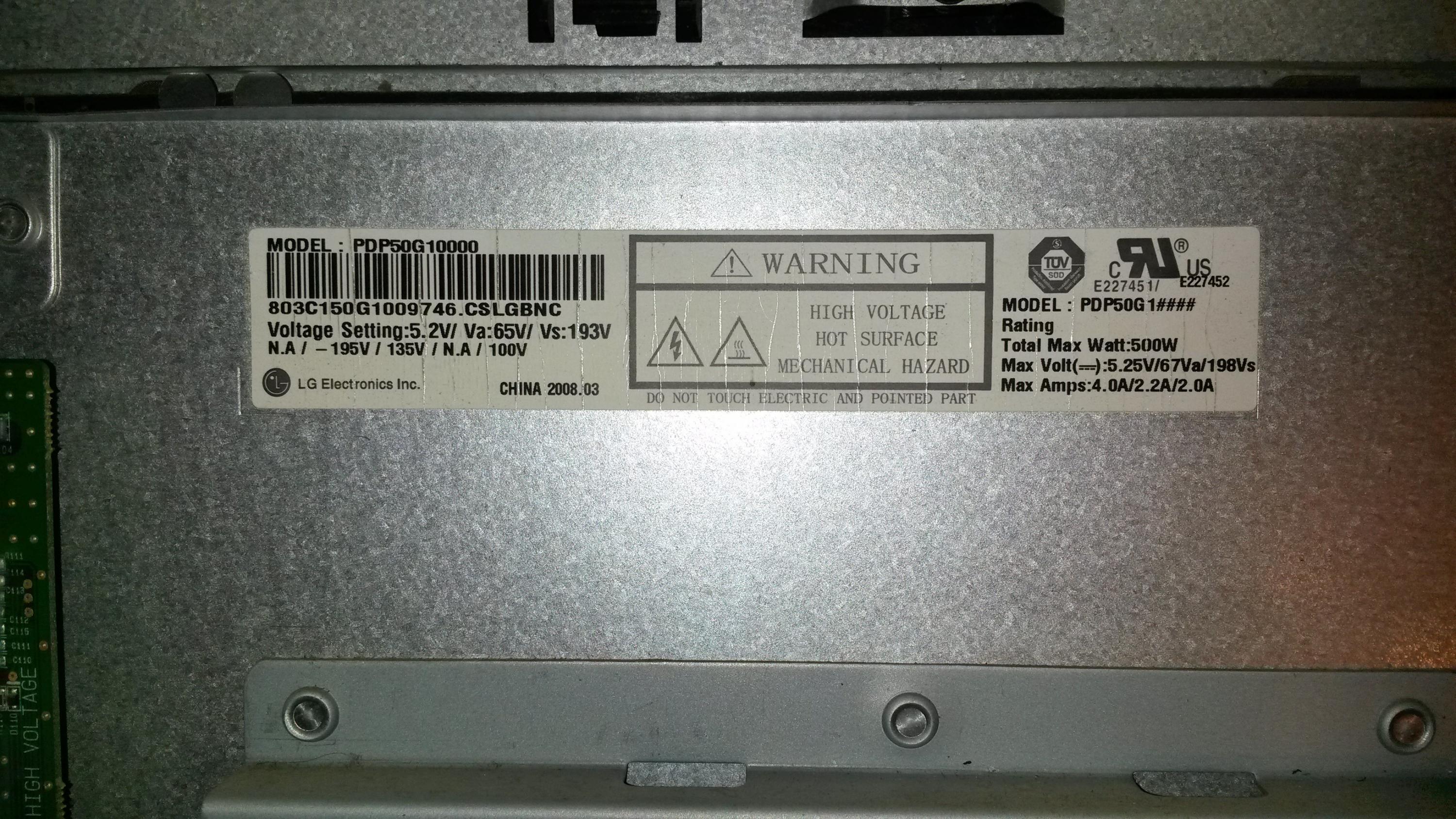

    -Va measures 69V and Vs measures 201V (as far as I understood the panel lable, Va should be 65V and Vs 193V
    -Vzb measures 105V to 112V (should be 100V)
    --Vy measures (interestingly prositive) 167V to 195V (measured over resistor labled -Vy, prositive probe connected to lead labled (+), negative probe connected to the lead labled (-)) (should be -195V)
    -Vsc measures 122V to 138V (measured like -Vy) (should be 135V)

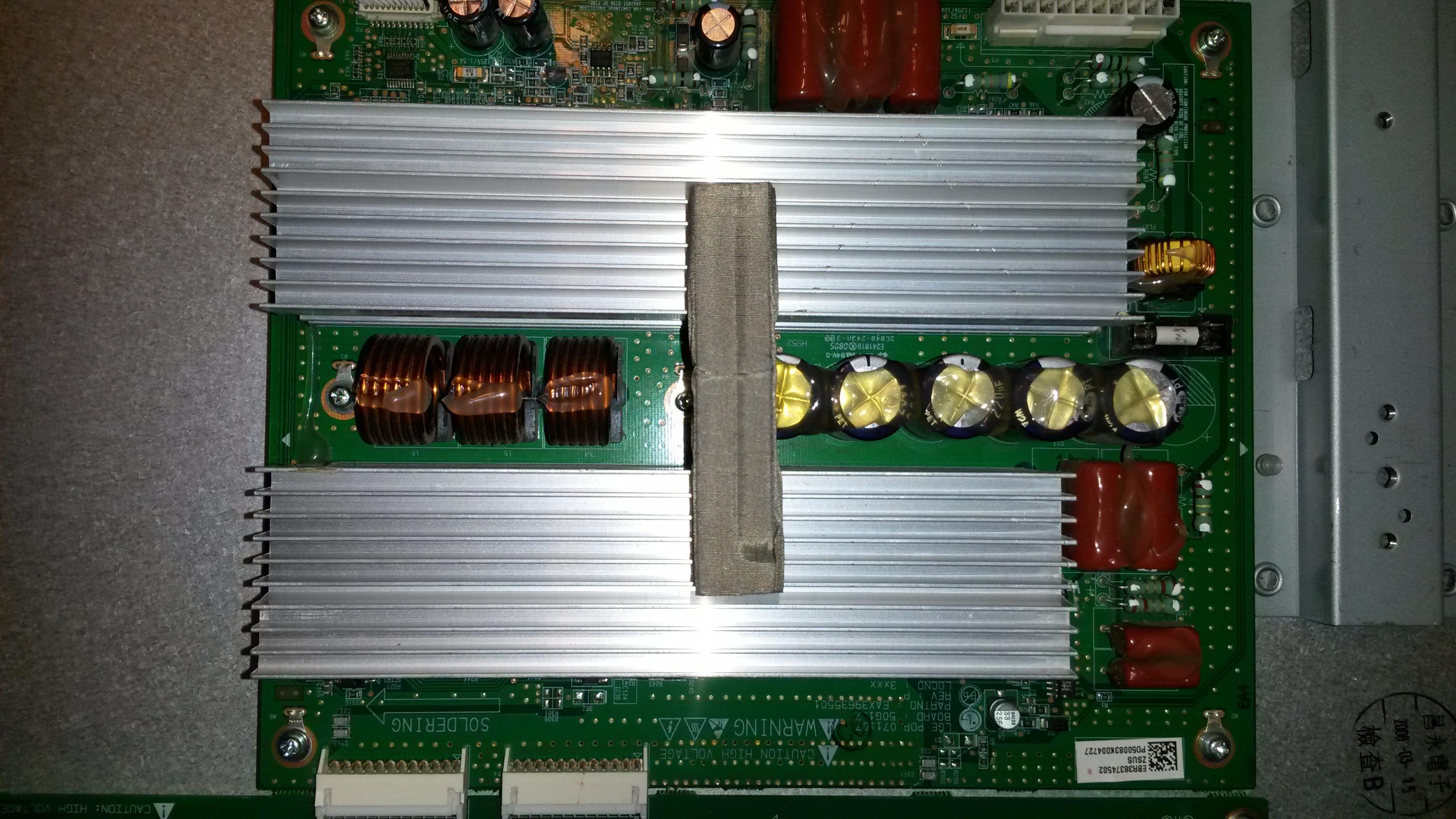

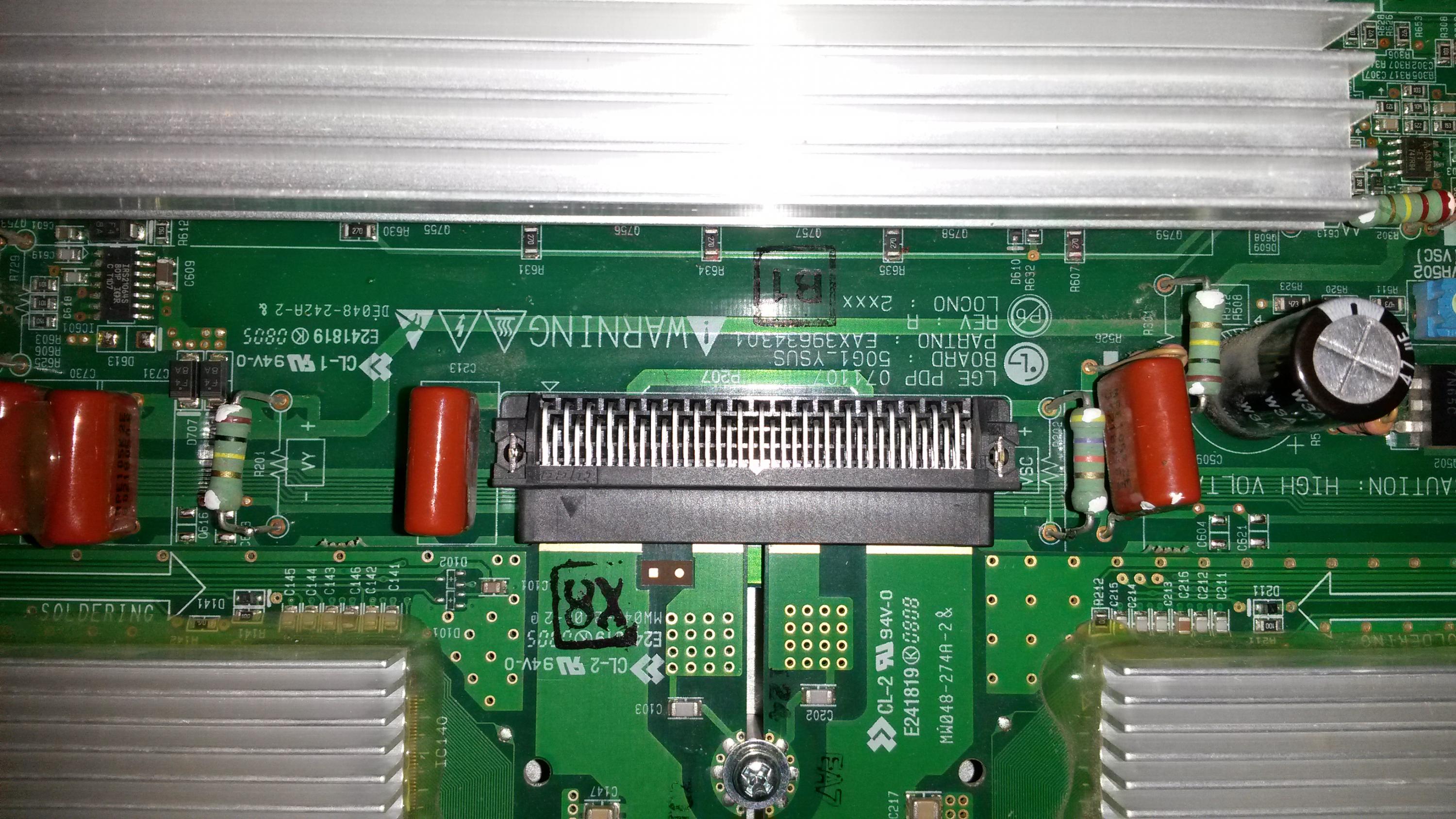

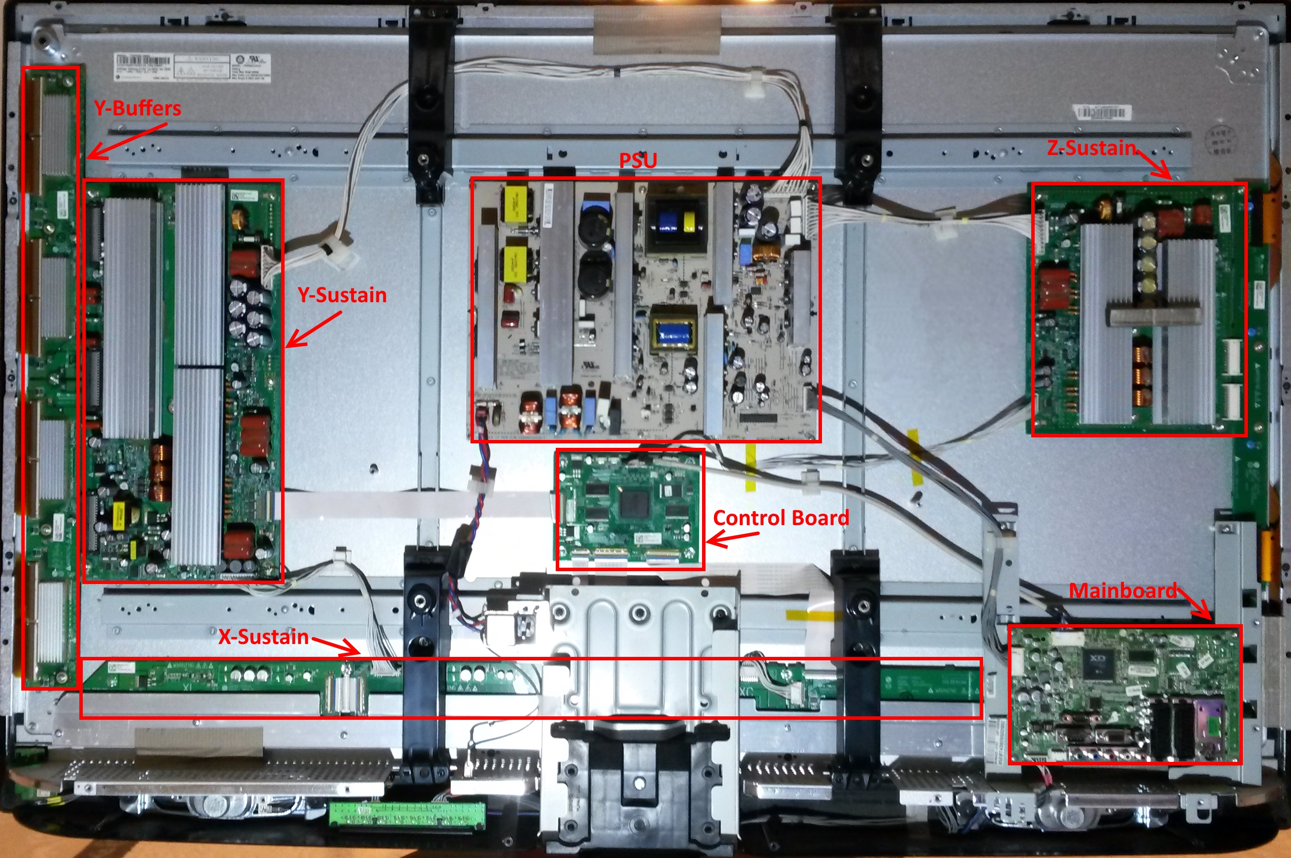

    When disconnecting either the Y-Buffers or the X-Sustain from the Y-Sustain, or the Y-Sustain completely,
    -Va normalizes to 66V
    -Vs normalizes to 193V
    --Vy, Vsc and +15V still measure the same values as before
    So, I guess the Y-Sustain board is defective in some way (although I could be completely wrong with that), but buying a new one isn't really an option because the cheapest one would cost around 55€, without a guarantee that the board actually works.
    So I'd like to try to fix the board myself, but don't have any idea where to start, or if it's actually the Y-Sustain thats faulty.
    Anyway, any advice and assistance will be greatly appreciated.
    PS:If additional or more detailed pictures are needed, I can take them.
    PPS:I don't know much about plasma TVs, so I might have named some board wrong, so I labled them on a picture for better understanding.

    Have you tried connecting one buffer board at a time. I had this symptom on a 60" version and believe it or not even though the panel would prime it had a shorted top buffer board

      when connecting either the top or the bottom Y-Buffer board, the top (respectively bottom) half of the screen stays completely black while the other half stays lit up a little.

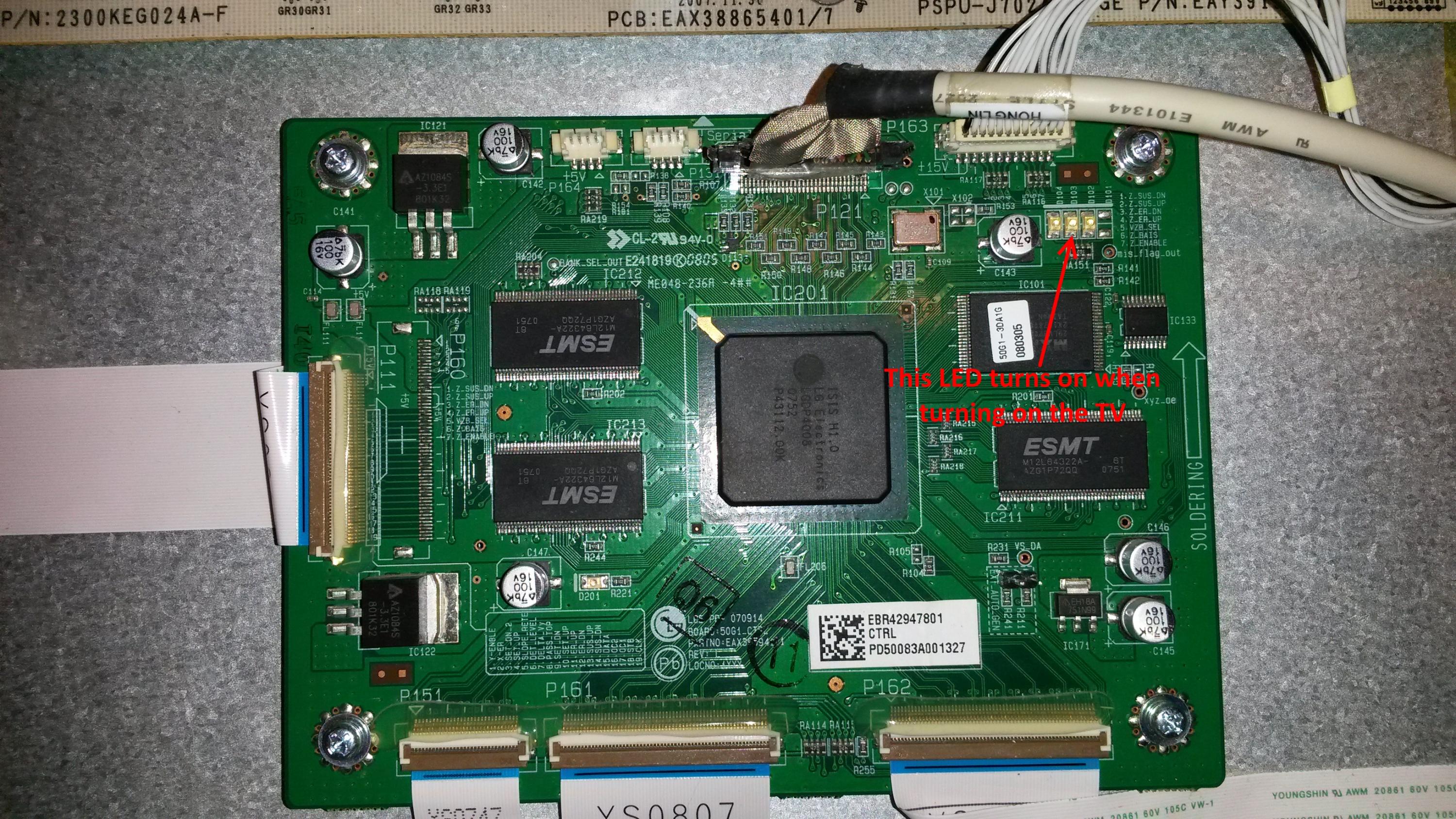

      I don't know if its worth mentioning, but when turning on the TV, only one of the four LEDs on the control board turns on (might be some sort of error code?).
      • R_J
        • Jun 2012
        • 9535
        Re: LG 50PG100R 50" Plasma TV no picture but sound
        The led's indicate panel temperature, having no led's could indicate a problem, having one lit means the board is working. Usually there is a small temp sensor ic on the back of the board coupled to the panel with a rubber pad in that location. See if this training manual is of any help.

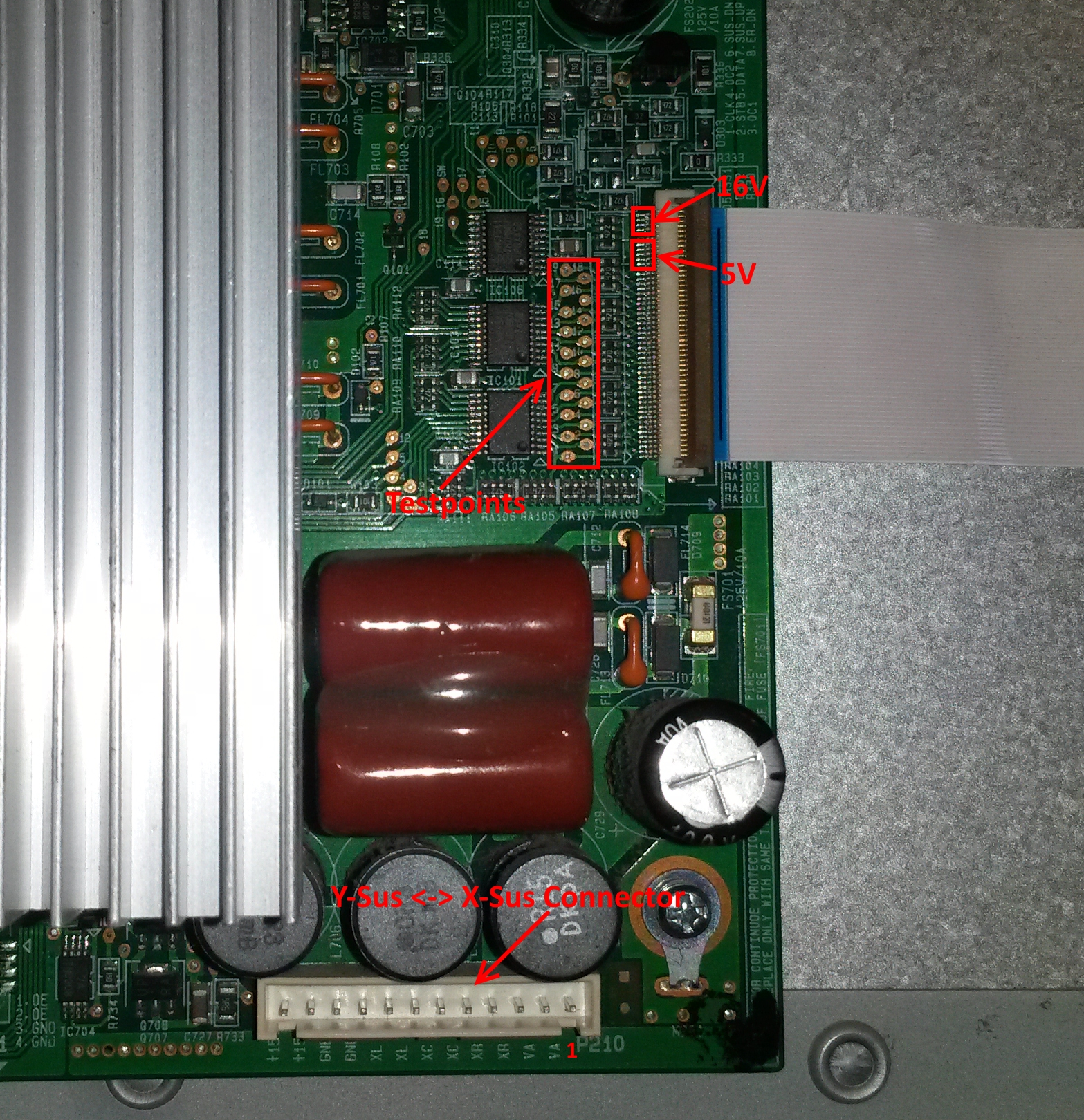

                  I finally found some time to measure the testpoints, and while doing so, i thought i might aswell measure the connector connecting Y-Sus and X-Sus.
                  So, here are all measurements, taken between Chassis to Pin (/Test point):
                  Control board to Y-Sus (flat flex):
                  Pin 1: 0.61V (3.2V)
                  Pin 2: 2.93V (0.76V)
                  Pin 3: 1.43V (0V)
                  Pin 4: 0V (3V)
                  Pin 5: 0V (0.6V)
                  Pin 6: 2.4V - 2.6V (0V)
                  Pin 7: 0V (2V)
                  Pin 8: 0.11V (1.2V)
                  Pin 9: 0.15V (2V)
                  Pin 10: 0.3V (0.26V)
                  Pin 11: 0V (0.2V)
                  Pin 12: 0V (0.2V)
                  Pin 13: 0V (0.16V)
                  Pin 14: 0V (0V)
                  Pin 15: 0.5V - 1.2V (0V)
                  Pin 16: 3.11V (1.9V)
                  Pin 17: 0V (1.4V)
                  Pin 18: 0.77V (2.9V)
                  Pin 19: 3.22V (0.6V)
                  16V directly at connector: 15.92V (16V)
                  5V directly at connector: 4.96V (5V)
                  Y-Sus to X-Sus:
                  Pin 1&2 :66.6V (65V)
                  Pin 3&4 :66.3V - 80V (62.4V)
                  Pin 5&6 :64.5V - 69V (62.3V)
                  Pin 7&8 :60V - 65V (63.3V)
                  Pin 9&10 :5V (GND, so 0V?)
                  Pin 11&12:20.4V (15.9V)
                  (2.4V - 2.6V (etc) means that the voltage is constantly changing, although this could be some sort of switching)
                  BTW: I actually jumpered the auto-gen in both ways, with the TV turned on and with it turned off, to see if it makes any difference.
