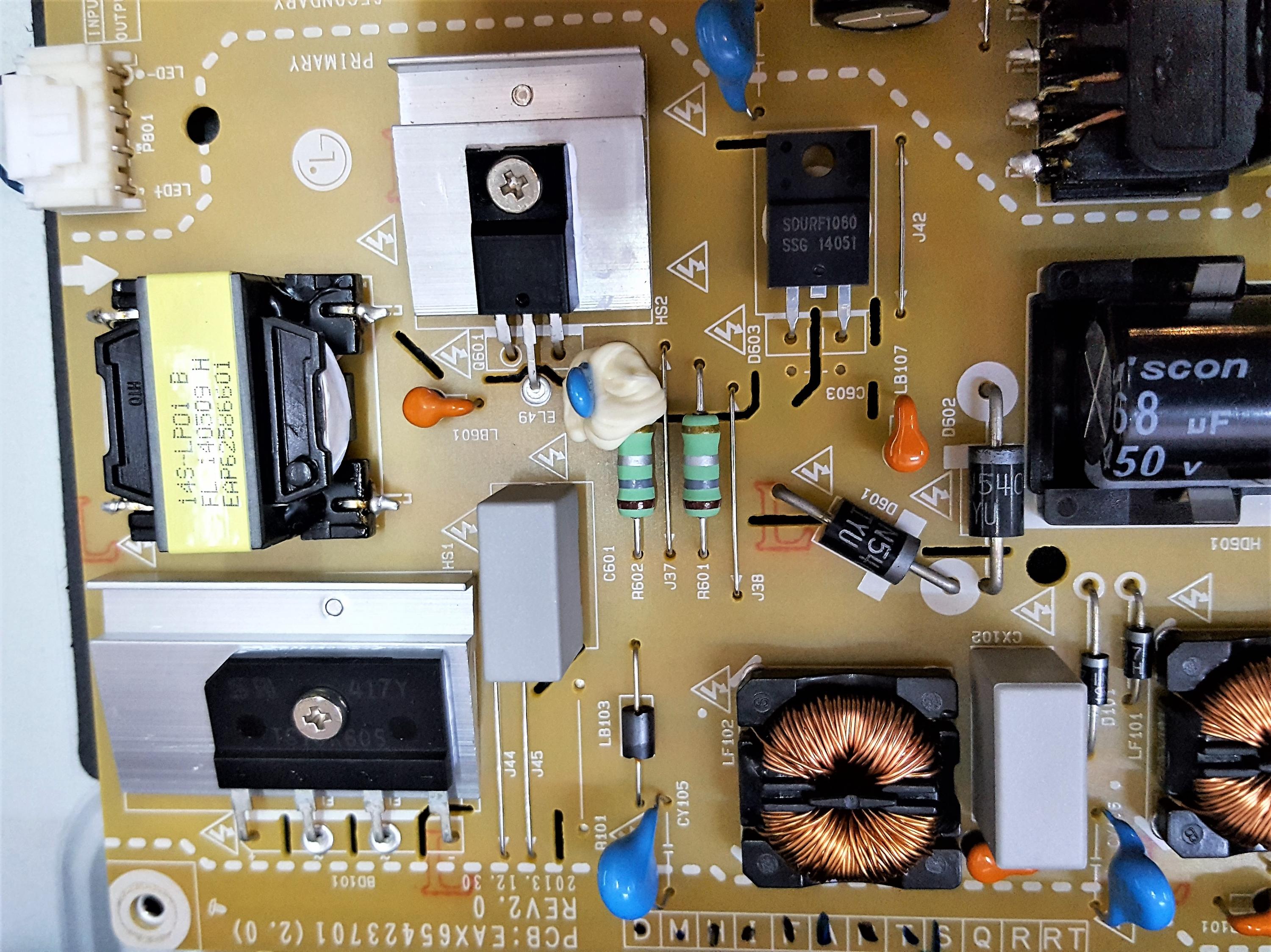

                  Sorry to hijack your thread @HellasTechn1 but I have the same set here with a slightly different problem.
                  It came to me with no backlight at all, turns out every LED was short-circuit. All 32 of them! Assuming one or two had gone thus forcing more current through the others causing catastrophic failure (xmas tree light scenario) I replaced all 32 LED's with 6V ones.
                  But I still have no backlight. I've checked the strips with a cheap LED tester and they all work OK (although my tester toils to get up to the 200 or so volts to run them all the strips together in series).
                  The +ve terminal of the LED output from the PSU is sitting at 101.6V, clearly not enough to fire up the LED's. Tracing this back to the rectifier D201 still shows just 102.4V, the difference being lost in D801. (These voltages are much the same even with the LED's disconnected).
                  The other outputs to the main board all seem OK.
                  Any clues as to why only this rail is low?
                  PSU board is a EAX65423701 (2.0)

                    #29
                    Re: LG 42LB5610 BackLight problem.
                    Perhaps posting pictures of the PSU and especially close up focused shots of the LED Driver section Top and Bottom of the board will help us.

                      We need pictures of your board.
                      The 101.6V is the feeding Voltage to the Voltage boost converter that boosts the Voltage up to higher Voltage fro driving the LED string.
                      You need to leave the Black probe on the chassis, Red probe on the LED+ then turn on the TV while keeping an eye on the meter to see how high the Voltage jumps up to before settling back down to 101V.

                        #31
                        Thanks for the quick replies, and apologies for not posting pic's.
                        I checked the +ve terminal with respect to chassis and even with a reasonably decent meter (Avo with bar-graph below the digital read-out) I could not see any peaking of the voltage, it just rises to the 101V fairly quickly and sits there. It drops to around 74V in standby. But this is where it gets confusing. The voltage on the -ve pin stays low at about 1.6V. BUT if I measure the voltage between the two terminals the meter shows 0V. Which would certainly explain why the LED's don't light up, but I can't get my head around why the voltage shows 0.00V when there appears to be a difference of over 100V when measured separately. (I'll upload a video if you don't believe me!!)
                        Anyway here are the pic's.
