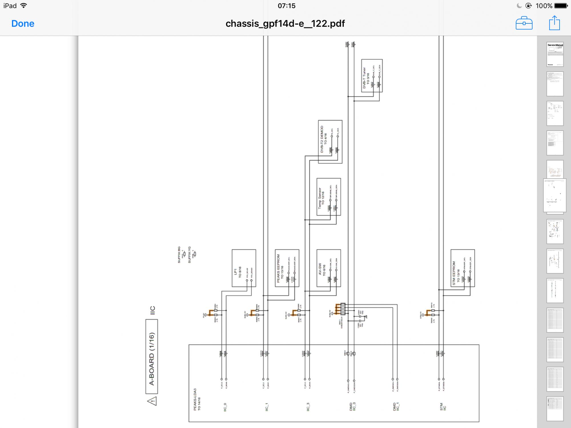

          Why I thought thermal fuse was:-
          Off a PDF I found on this site for that sets service instruction - (hopefully I've attached this image it correctly) it states temperature sensor which I assume is a thermal fuse but may not be on the power board as I can't find the power board drawing.
          • tw2005
            • Oct 2011
            • 6458
            Re: Panasonic TX-P42U30B how to locate thermal fuse
            Off a PDF I found on this site for that sets service instruction - (hopefully I've attached this image it correctly) it states thermal fuse but may not be on the power board as I can't find the power board drawing.
            Solid standby, no response.
            Have you checked if the SN is shorted?

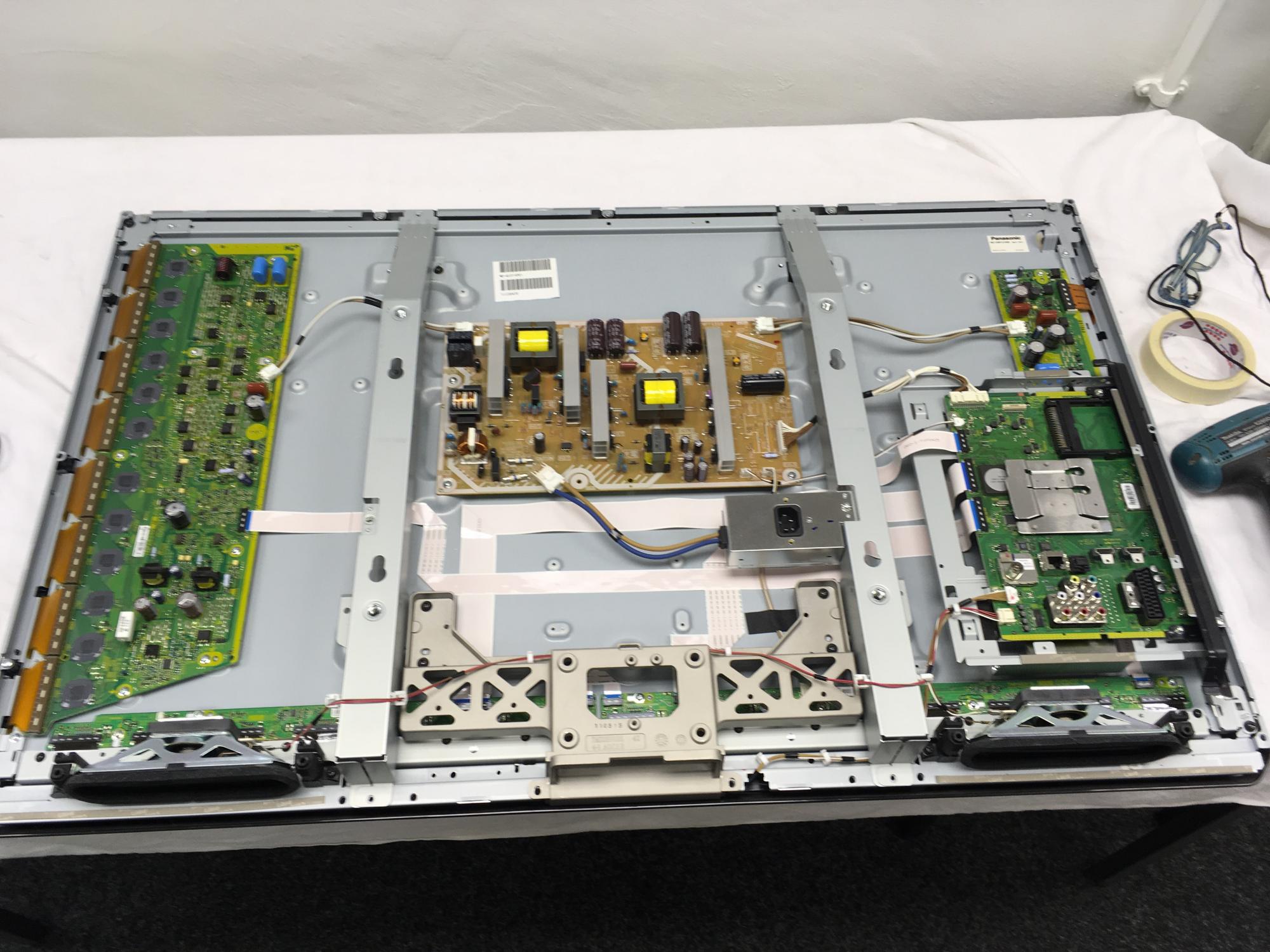

              Thank you for your post. I don't understand the (SN short form) but have attached an image if you mean the PCB on the lefthand side, then yes disconnected and no short.
              • tw2005
                • Oct 2011
                • 6458
                yeah that's it. Sometimes that can cause unusual faults. Not a common one then.

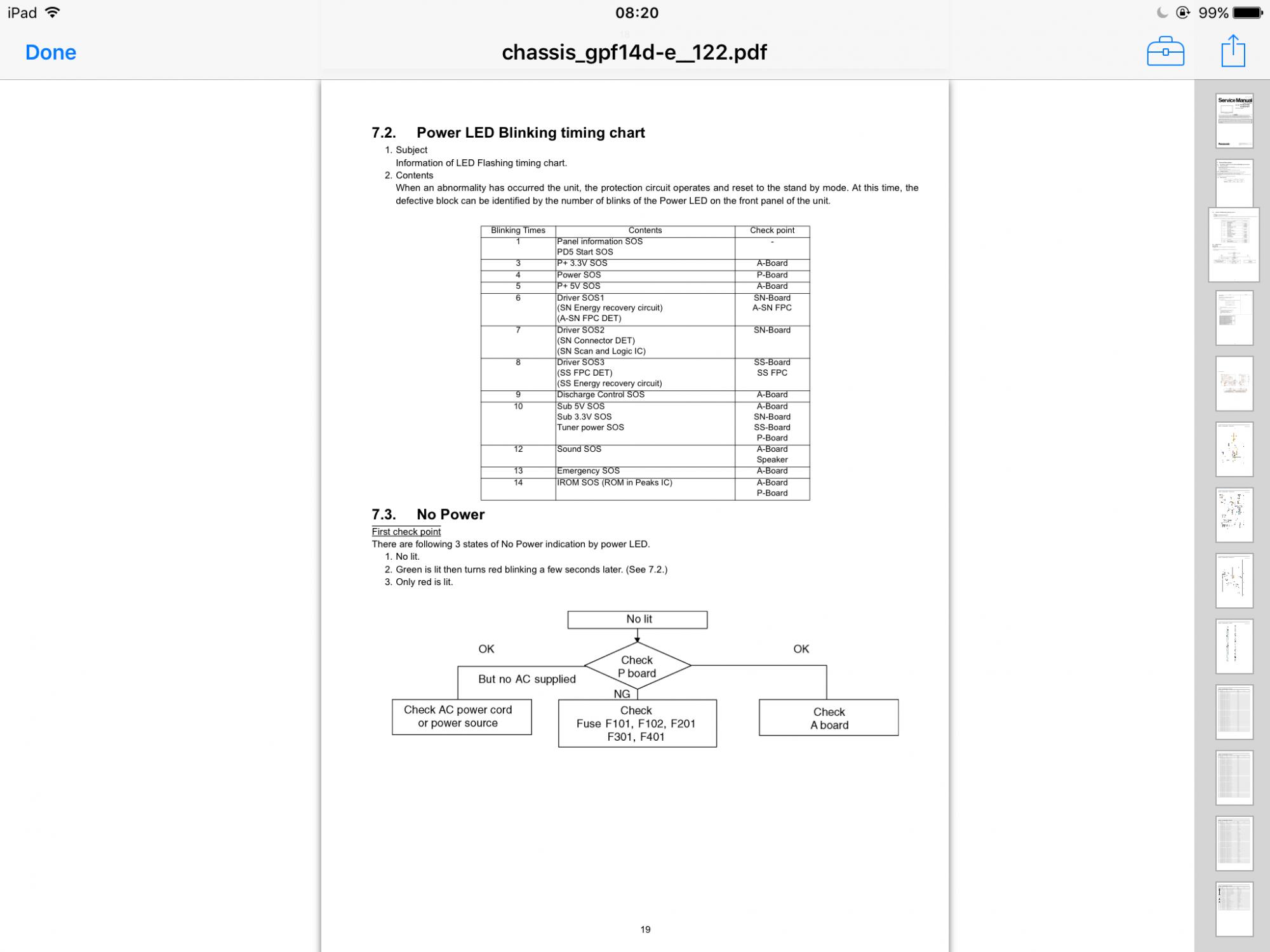

                    Here's the service manuals advice for no power

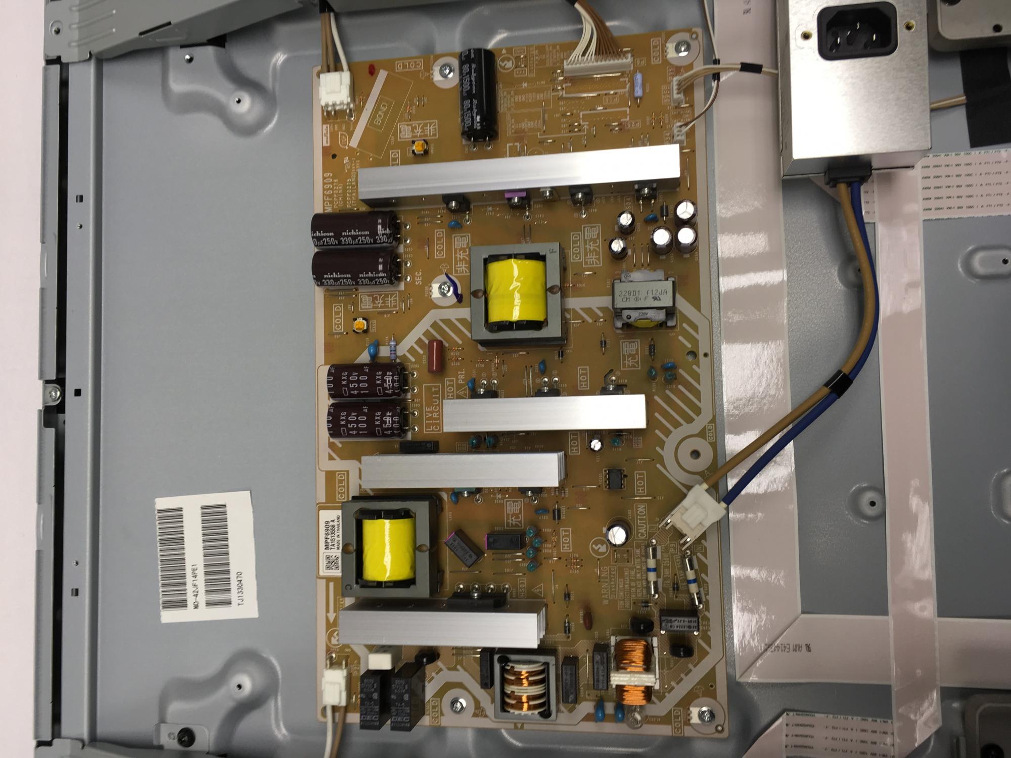

                      Tried a known working power board and still the same fault as above - anyone offer advice on which way to proceed please?
                      • Moreno83
                        • Jun 2014
                        • 2008
                        • The Netherlands
                        The powersupply is not the problem.
                        You disconnected the left board completely right? ( SC20 + power cable ). If you only got a standby led with a clicking powersupply then you got a bad mainboard.
                        These models have problems with the mainboard. The solder under the CPU is bad , i have had a few of these.

                                I think you need to redo some of your testing AND also positively answer questions posed to you so that the forum is not left guessing.
                                First, how are you starting the set? You need to depress and hold the power button for more than 5 seconds and watch the response from the power led for flashing.
                                Next as suggested, disconnect the power cable going from the power board to the SC board ( two wire connector). You can measure the resistance of the sc board across those two pins. With the board disconnected, again depress the power button and hold for 5 seconds and release, what happens with the led?
                                the guide in this thread might help further
                                https://www.badcaps.net/forum/showth...roubleshooting
