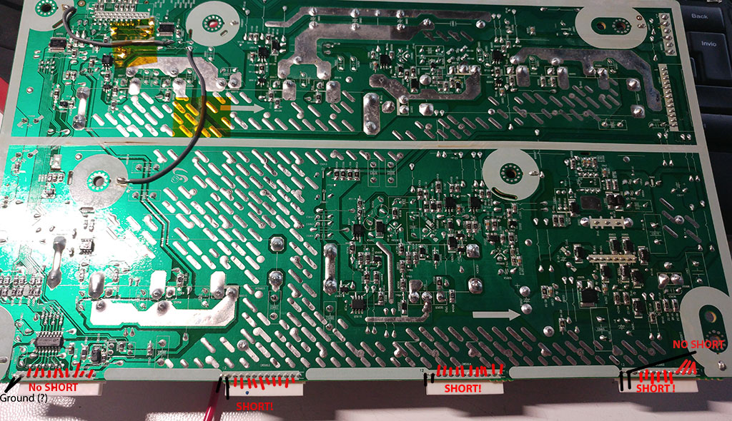

      Also I checked tha Ymain buffer connector and it seems to me that something is wrong there. Only the first one isn't' in short , the second and third is totally in short and the last one only the last 4 pins aren't in short with what I suppose is the ground pin.
      OI also checked some diodes and resistor ,the only problem I fund was some 103 smd resisotr misured of 5.6kohm instead of 10k ohm ( i have very very basic knowledge of elettronics)
      Is this a prove aof a faulty Y board?

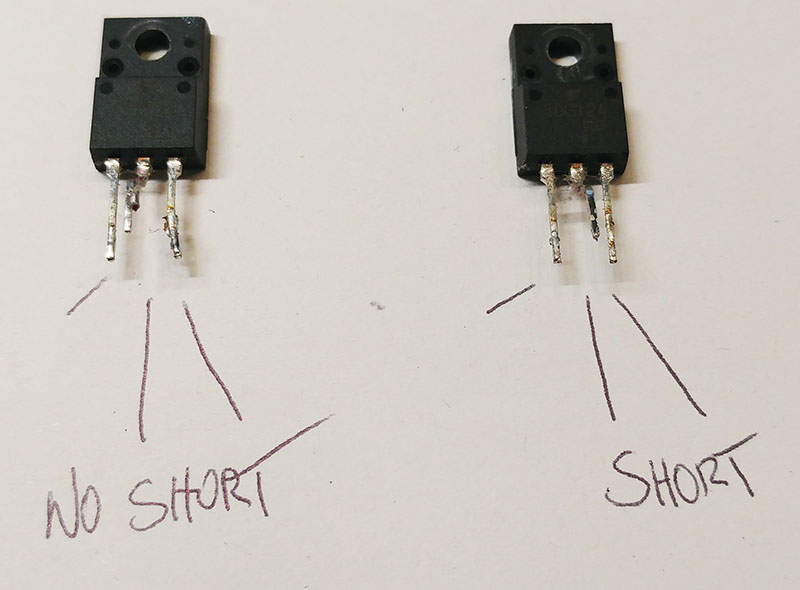

        I also checked transistor
        the model is 30G124 http://www.datasheetcafe.com/30g124-datasheet-pdf/and I checked between collector and emitter ( is it right?) and 4 of 6 transistor in the board are in short

          If you cannot see a crack, it is probably ok.
          I would check both X- and Y- boards for short circuits.
          It may be necessary to replace both if there are shorts on both.

              yes it could possibly damage the Y so check the X thoroughly.
