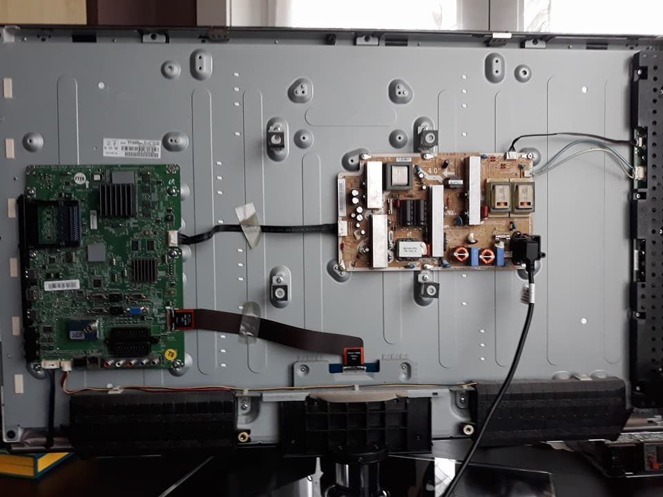

    hi guys i receive a samsung tv model code le40c630k1wxxn who doesn t start and the red light flashing near the button on/off someone has some experience about it

      Flashing LED at bottom is normal power up cycle for Samsung. You'll need to get it opened up for some voltagce checks.

          Do you have sound? If you shine a light at the screen, can you see a picture, or the menu (if you push the menu button) Un plug tv, the disconnect the cable between the main board and power supply, plug in tv to see if the backlights come on

              Open it up and unplug the wires from the power supply to the mainboard. Plug tv back in and if backlights come on, the mainboard is bad. I have a feeling it is because I have seen this many times on c600 series.

                the red light near button on/off bliking 2 times and then a small sound appear "like sound error" and stop blinking again 2 times = small sound error and stop blinking .
                i make a second test i disconnect the cable going to the mainboard and i turn on the tv and now the tv back light turn on i suppose the problem is in the mainboard ? but not sur ...

                  Mainboard is the problem.

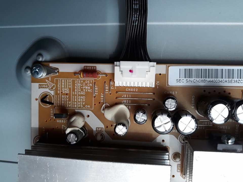

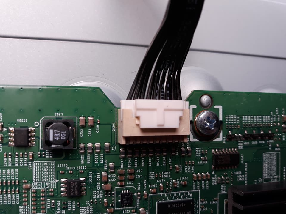

                      Hi guys i come back with news so i disconnect the cable from psu and connect back the cable from mainboard i have too back light come on too the question is it possible that the problem is the mainboard? Second step i begin some measurement on the cn802 connector on psu (1 to 17) and i saw when the red light blicking the voltage is stable but after 2 blinking light a small sound error appear and the voltage drop i will check the pin 2 to 18 if it s same symptom

                        Sounds like main board

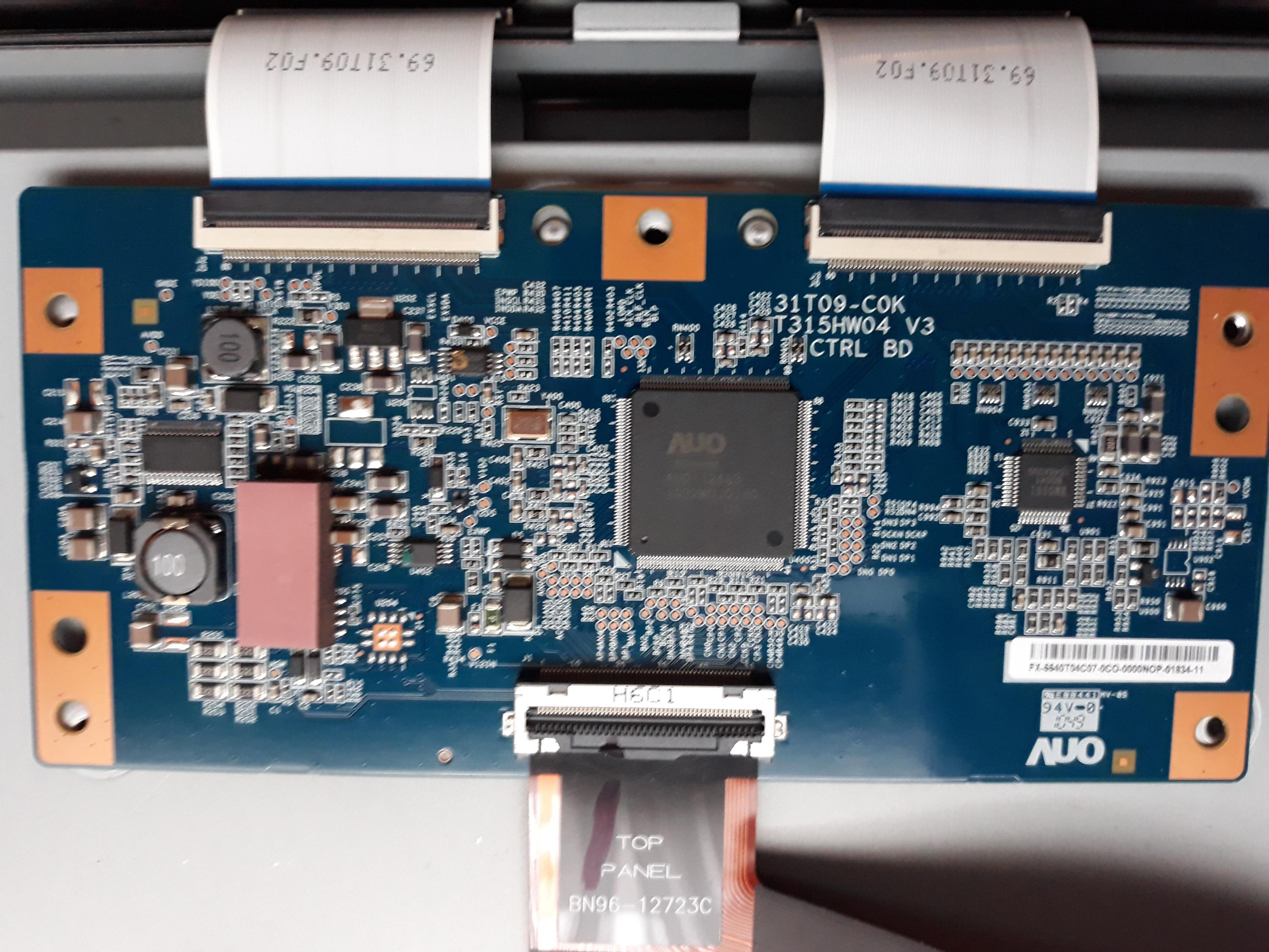

                          hi guys today i make some test i disconnect the cable from t con board and i let the cable between main board and psu board and now i have bl on + now start sound without image ( normal t con disconnect ) someone has some measurement test for the t con AUO T315HW04 V3
