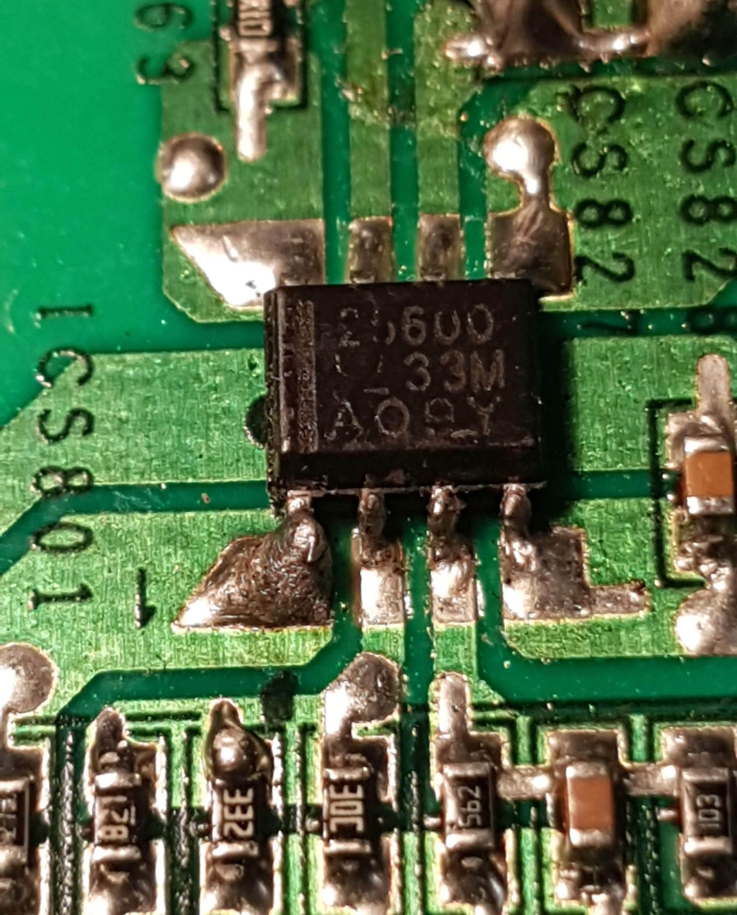

                                    Still cracking away at this... I suspect that ICS801 may have some problem nearby or is faulty itself. Once I traced the problem back to that area of the board, I noticed that it may have a crack through the top (unfortunately right through the the markings). warming the caps even slightly that feed this IC and the TV starts quite normally. Can anyone identify this so I can find a datasheet and investigate further?
                                    The top line is 25600
                                    The bottom line is A09Y
                                    The middle is ??33M. Possibly ?233M. (You may be able to see the fine crack through the "5" in the top line BTW.)
                                    This IC is located "top-Middle" of the board.

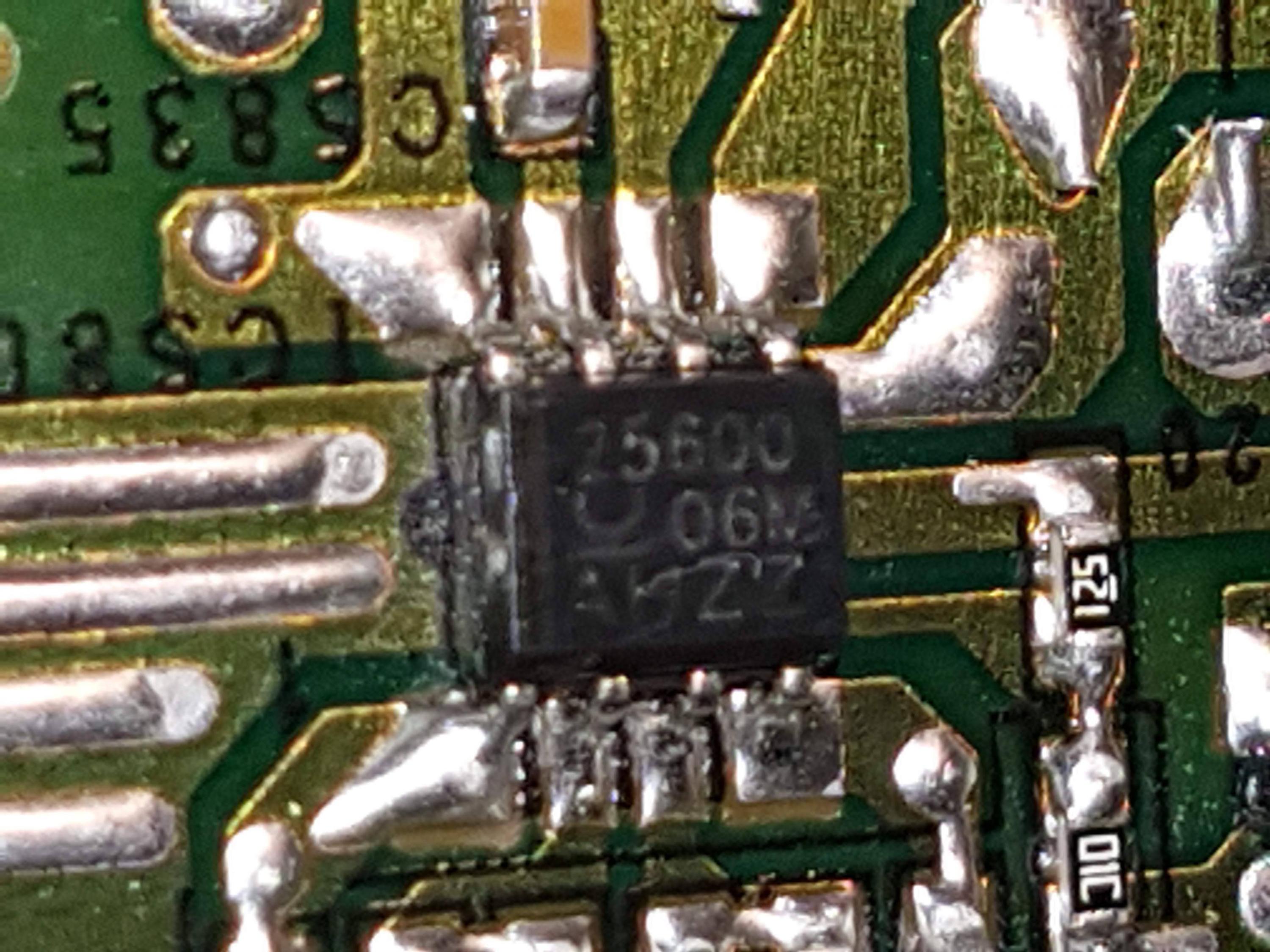

                                      Comparing this IC with the same IC on Samsung plasma PS's of similar years I see that I likely have all the info and this is a 25600 controller IC.
                                      Top line 25600
                                      Second line Logo(obscured) followed by 33M
                                      Third line AO9Y
                                      Picture attached to this post is of the IC on another parts board of a similar year plasma but not the same model.
