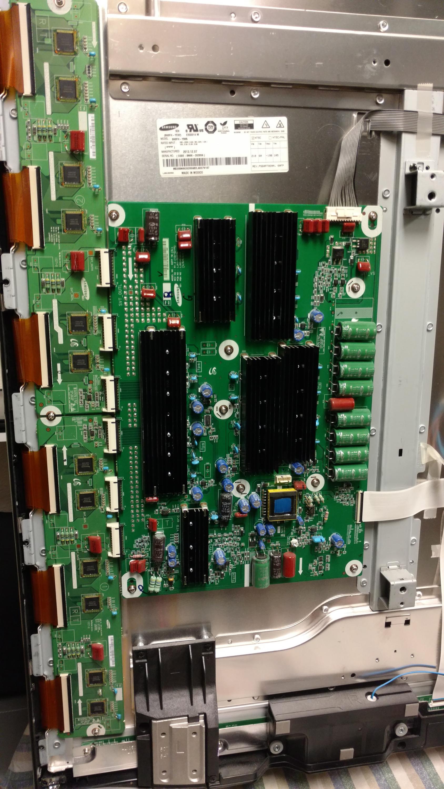

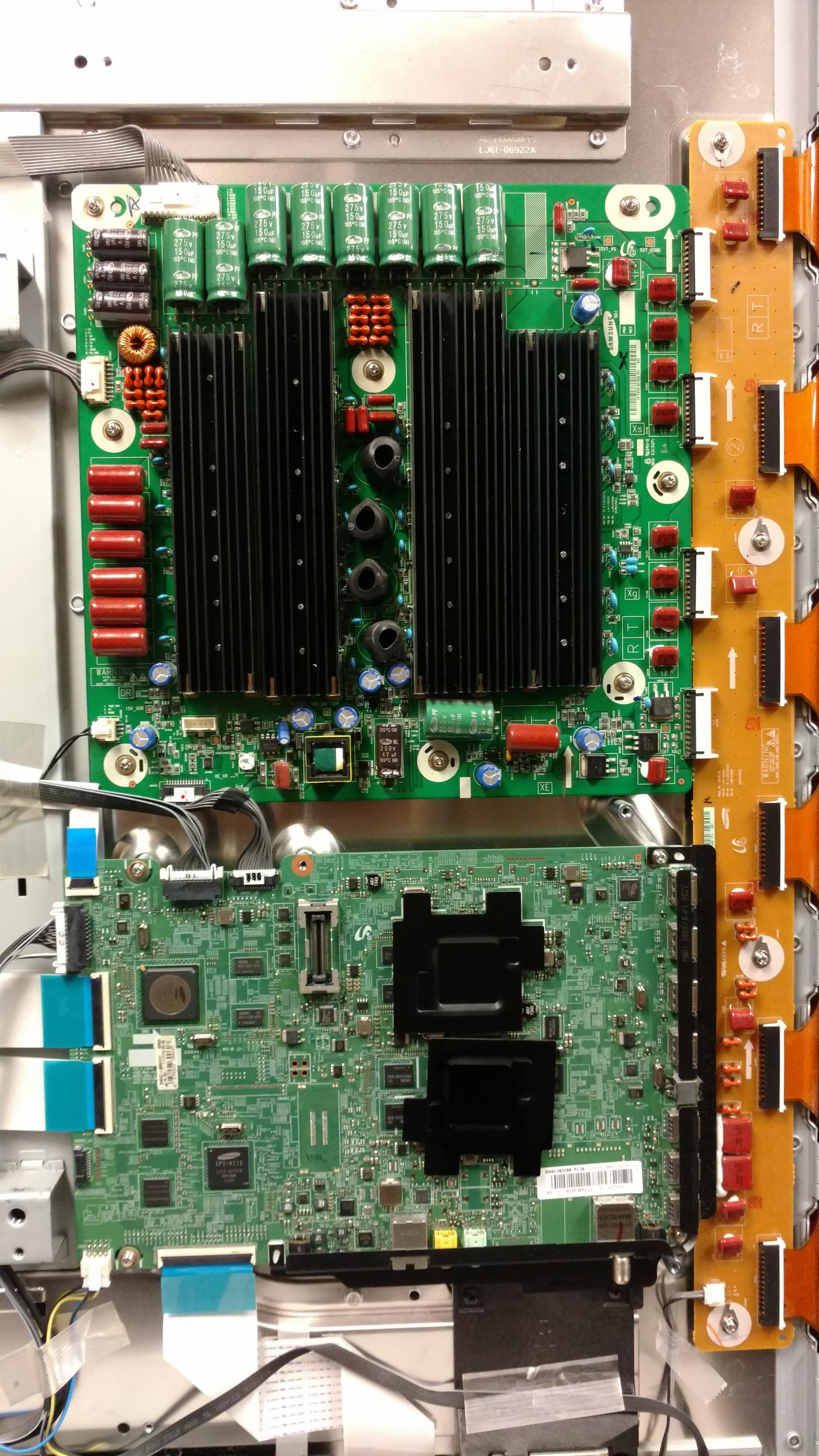

    Hi guys!
    This plasma comes on and has no picture (can't see panel prime, but it may?)
    VS and VA shutdown immediately, but VSC stays up, even though it is -204v instead of -198v.
    When I disconnect the Y and X separately or together, the VA and VS still shut down at turn on. I think it's due to the type of ground detect circuit the power supply has, right? So it's not easy to just unplug a board to see what is causing the shut down.
    The main board has the logic built in and there is an led flashing once every (I think it was 2.5 seconds?) which the service manual says is a "X/Y drive failure".
    The question is: which one is it?
    I've tried unplugging the Y buffers from the panel and the VS and VA DO NOT shut down, but I don't see any panel breaks and I doubt the panel is bad. If I plug those back in and unplug the X side from the panel, I also stop the VS and VA from shutting down, but I think in both cases, it's just because the panel isn't being used that the voltages stop shutting down.
    I haven't tried testing the buffers for shorts, do you think I should? It just doesn't seem like they would be causing the issue if unplugging the Y board doesn't stop shut down.
    The power supply doesn't seem to have any of the usual bad connections.

    Re: Samsung PN60F8500AFXZA, can't determine X or Y failure

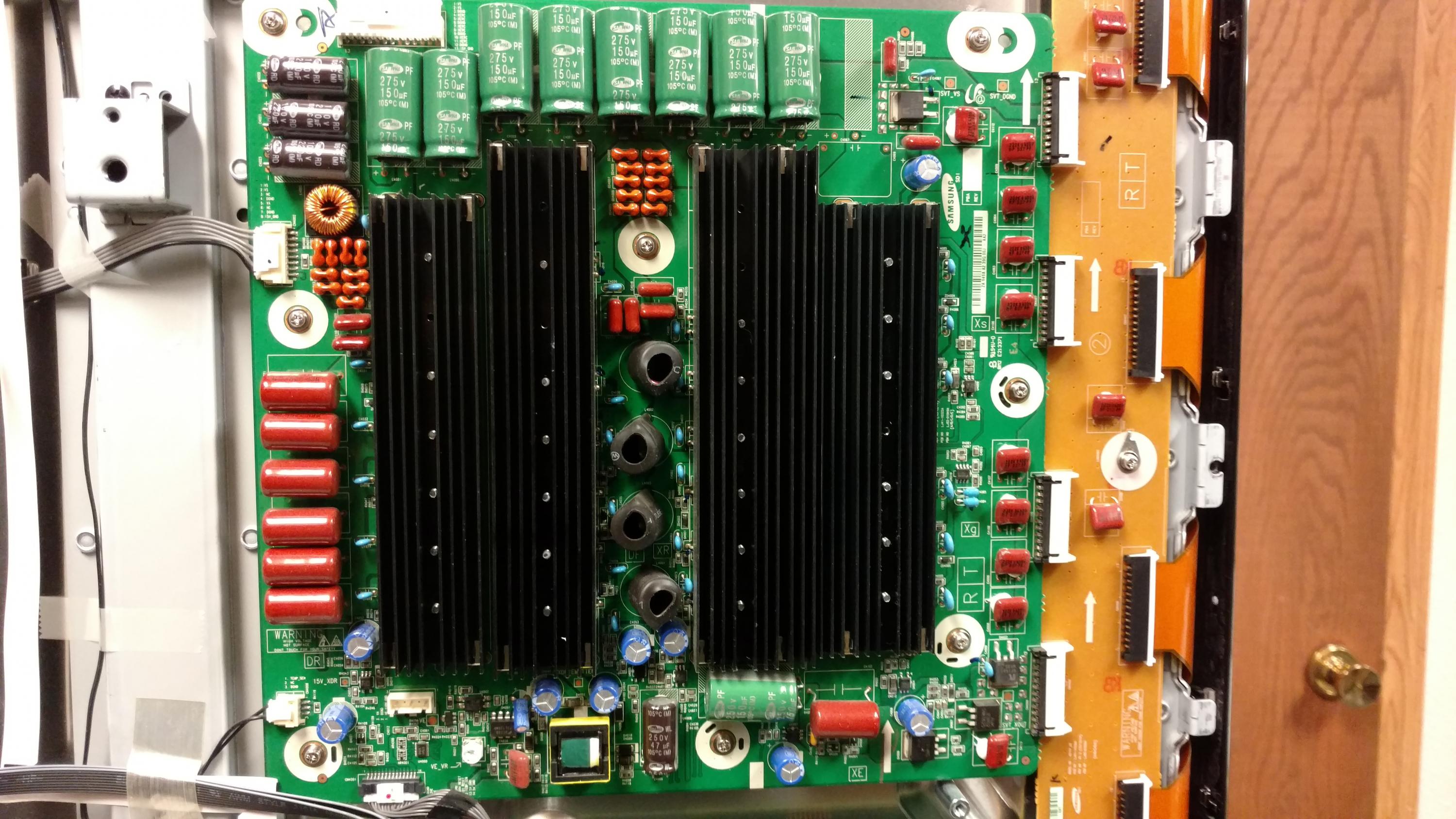

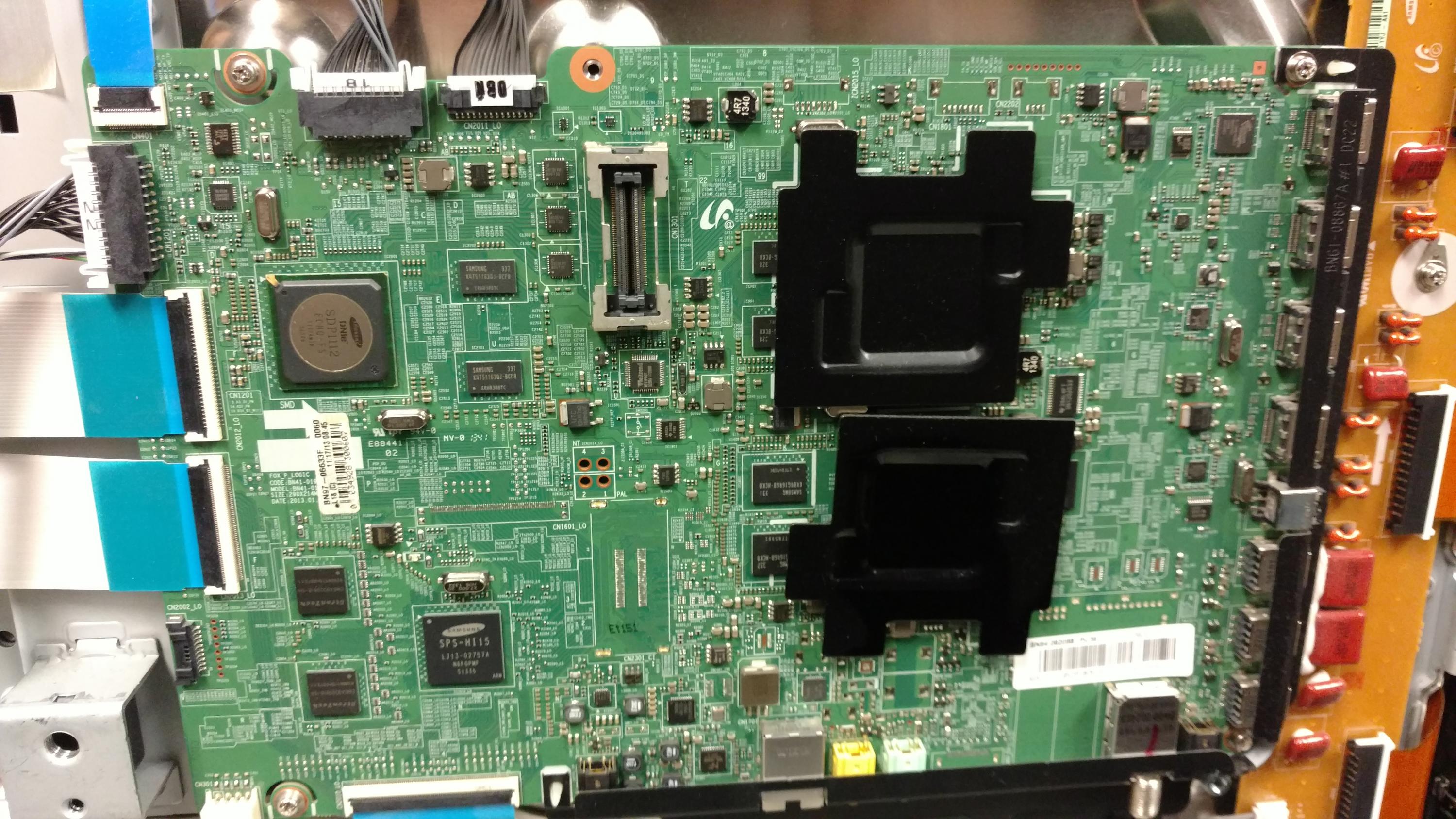

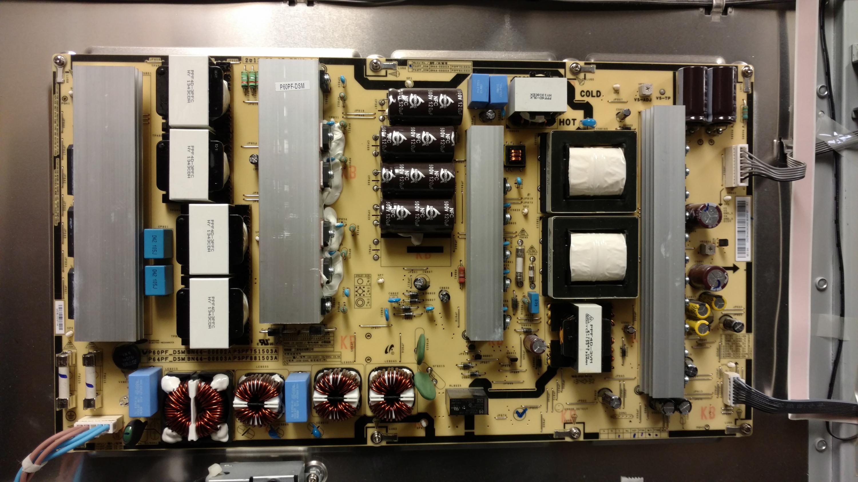

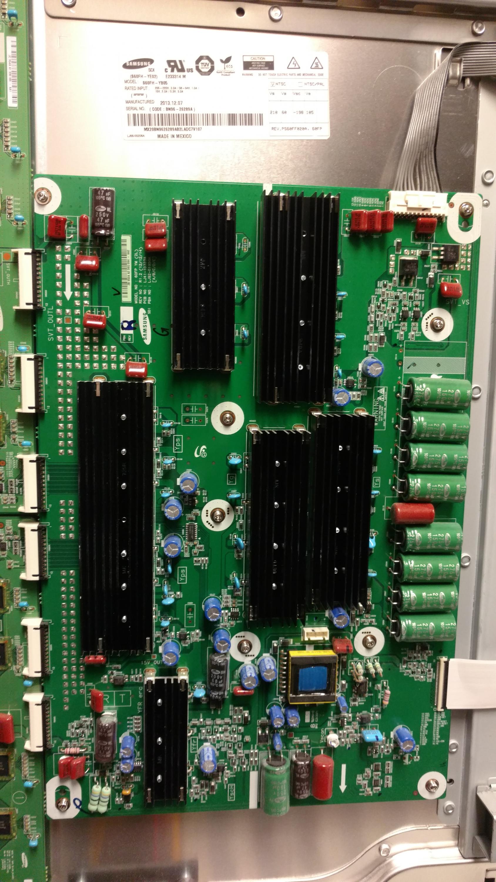

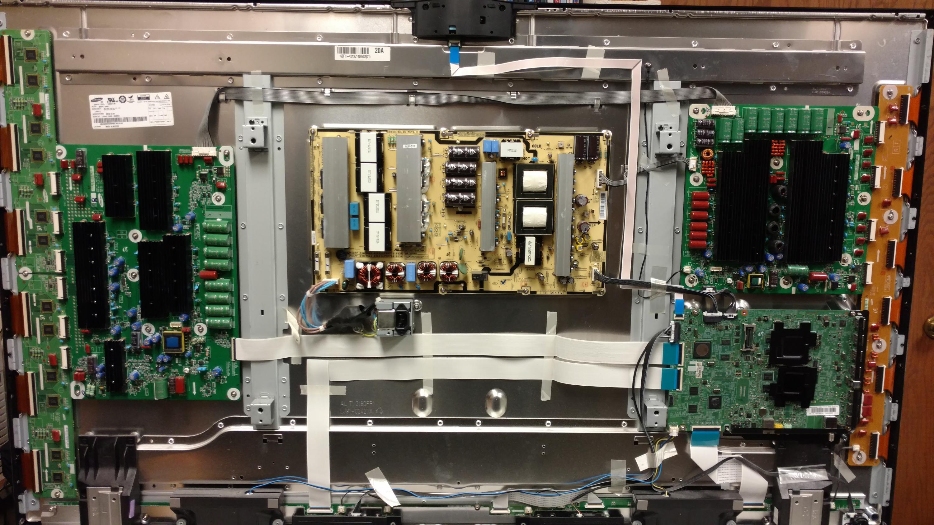

    Here are the pictures.
      Your x is bad. If you are buffer board was bad you would probably not have VSCAN. The main kicker is when your x board is disconnected your VS comes back alive. If you're in question check the X board for any shorted mosfet transistors.
        Thanks! I will check and see if there are any shorted. It's odd that the Y buffers being disconnected also stops the VS and VA from dropping, though, but aren't the X-Main and Y-Main panel connections linked in different ways, so maybe that's why? I will get back you on the tests next week.
          I suppose it could be y buffer only if when you disconnect x, are you also disconnecting the ribbon cable that goes to the logic board?
                              This TV is known for the following failures. Power supply most common, Main board second most common, and Y-sustain as third most common.
                              In order to check the power supply. Disconnect everything from it, Short PS-on to ground and VS on to standby and check all output voltage. If all is correct then you have a good power supply. I would still check all transistors on heat-sinks for cracked solder joints however. That is common for this power supply
                              Now that we got that board out of the way, plug everything back in, and now lets move onto the Y-sus.
                              Disconnect the ribbon going between the Y-sus and the main board. Now turn the TV back on and check your VS voltage. Is it staying steady or is it still dropping down. If its still dropping back down then you have a bad main board. If it stays steady then you have a bad y-sustain.
                              Source:
                              Our company offers a repair service on all three of those boards, and this is how we tell our customers to determine which board is faulty in there set. Although we almost always suggest re-flowing the power supply if a Y-sus or main is found to be faulty, as that board does go out often.
                              Good luck

                                  Thank you for your help. I followed your steps and found that the VS does not drop if the YSUS ribbon is unplugged from the main board. So I guess the YSUS is defective. And I had already checked the power supply for bad connections and found only slightly suspicious connections and resoldering them changed nothing. I will look into a replacement YSUS and/or look into your service.

                                      Ok. As it sounds to me, (and I hope it's just YSUS faulty), sounds like your panel is damaged somehow.
                                        You are getting shut down event if Vs and Va are good then die. Ctrl board switches them off to stop fire/electrocution in case of panel fault (crack, etc.) or failed sustain board.
                                        There are a number of things that can cause this.
                                        Usully the control board LED is blinking 5 seconds on 2 seconds off, which is DRV_RESET state, i.e. something is not right with something on the panel or controller boards and the control board has pulled the plug.
                                        If your LED is blinking once a second and STAYS blinking once a second, disregard this as your control board is running normally, and most likely it is main board that is bad and not sending video. You can try checking this by doing test pattern mode by jumpering pins 3-4 of the block on the control board.
                                        Your set has integrated control board, but the principle is similar, the hardware is copy-pasted onto the main board and behaves as a separate part essentially.
                                        Bad X or Y board - not shorted, but bad in some way.
                                        Bad buffer board shorting Vsch voltage and bringing -Vsc down with it.
                                        Bad panel, crack or lost gas.
                                        Bad control board firmware.
                                        You can rule out bad buffer board by checking for shorts.
                                        Similarly bad panel - check for cracks around the WHOLE panel.
                                        Bad control board firmware is rare. Often LED on control board will blink a pattern distinct from 5-2 bliks.
                                        If you have an oscilloscope, you can check the X/Y waveforms on power up, but if you are not familiar with what the waveforms should look like, you may be stuck here...So you would have to replace one of the two boards and see what happens.
