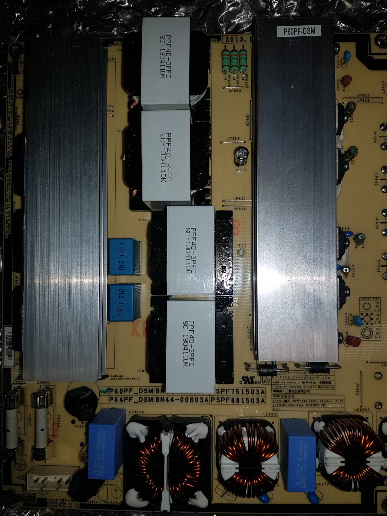

                      Re: Samsung PN60F8500AFXZA, can't determine X or Y failure
                      Hi Nick and anyone else who would like to weigh in:
                      As per your post #15, I've done the following on my PN60F8500
                      "Short PS-on to ground and VS on to standby and check all output voltage."
                      When jumpered, My power supply voltages rise up close to or above spec, but then immediately drop again. they fluctuate like this about three times, then remain off.
                      When not jumpered but connected, powersupply continues to supply mainboard power (so sound but no picture).
                      I assume this means something is wrong with the VA/VS circuits. I have checked and repaired any cold solder joints (didn't find much compared to what I've seen on other TVS in the past, this TV has low hours.)
                      Replacements are rare if able to be found at all, and as I'm in Canada the repair service shipping is prohibitive.
                      Do you or anyone else know which components regularly fail on this PS? Nothing is shorted and the fuses are good, but something looks like it's leaking down or out of spec. Any thoughts?
                        I just want to confirm this but nothing else was connected to the power supply correct?
                        All wires and connectors going to the main board, Y-sustain, and or other boards were all removed when the jump was done correct?
                        If so, then your power supply does seem to be at fault, and per the last post 15 you are referencing, please read the details of the post to fix your board.
                        If not, then please try again with the power supply board isolated from the rest of the TV set.
                          Thanks Nick,
                          I have reflowed everything as per post 15, and the tests are done with the board completely isolated before jumpering. When you repair these boards, do you common reflow them or do you find you need to replace parts too?
                            Most often the damage is obvious such as needing to reflow the board and replace shorted transistors. Often the traces to burn up all the way instead of the more simple cracked solder joints that can be simply reflowed, and so we will need to rewire the trace to the transistors. We almost never see small surface mount component failure with this specific model such as diodes, surface mount transistors, or IC's. Simply go with your meter across the transistors that are mounted on the heatsinks and check them all for shorts. Of course if you have any voltage left in them even if it is half a volt, it will show you a false short, so make sure you don't have any more voltage going through those.
                            Check both of the heatsinks on the cold side of the board, and you should find your problem.
                            We have occasionally seen 1 resistor also fail on these, this would be a small surface mount component on the back side of the board which burns up and actually physically burns the board, so when that occurs its easy to spot as you can usually see it visually on the front side.
                            If you could take a picture of the front side of the board, I can tell you if that resistor burned up or not.
                            I know what I just said doesn't make much sense, but once we have a picture it will make more sense.
                              It makes sense. I'll get a picture in a bit. This power supply is in very nice shape though. When I went over it looking for cold solder joints I couldn't even find any... but given the jumpering tests I'm 100% sure it's the PS. It's a low hour TV too. I'll give it one more try with a magnifiying glass and upload some pictures in an hour or two.

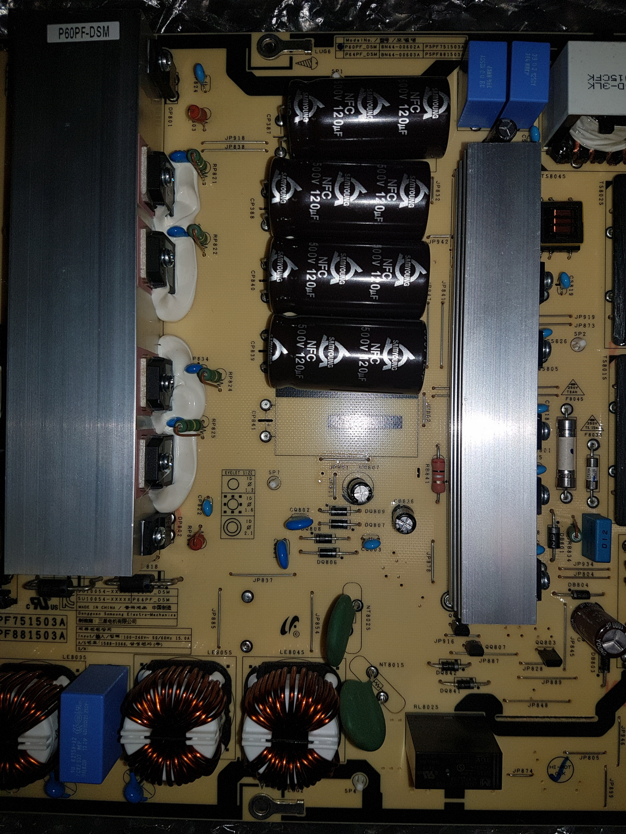

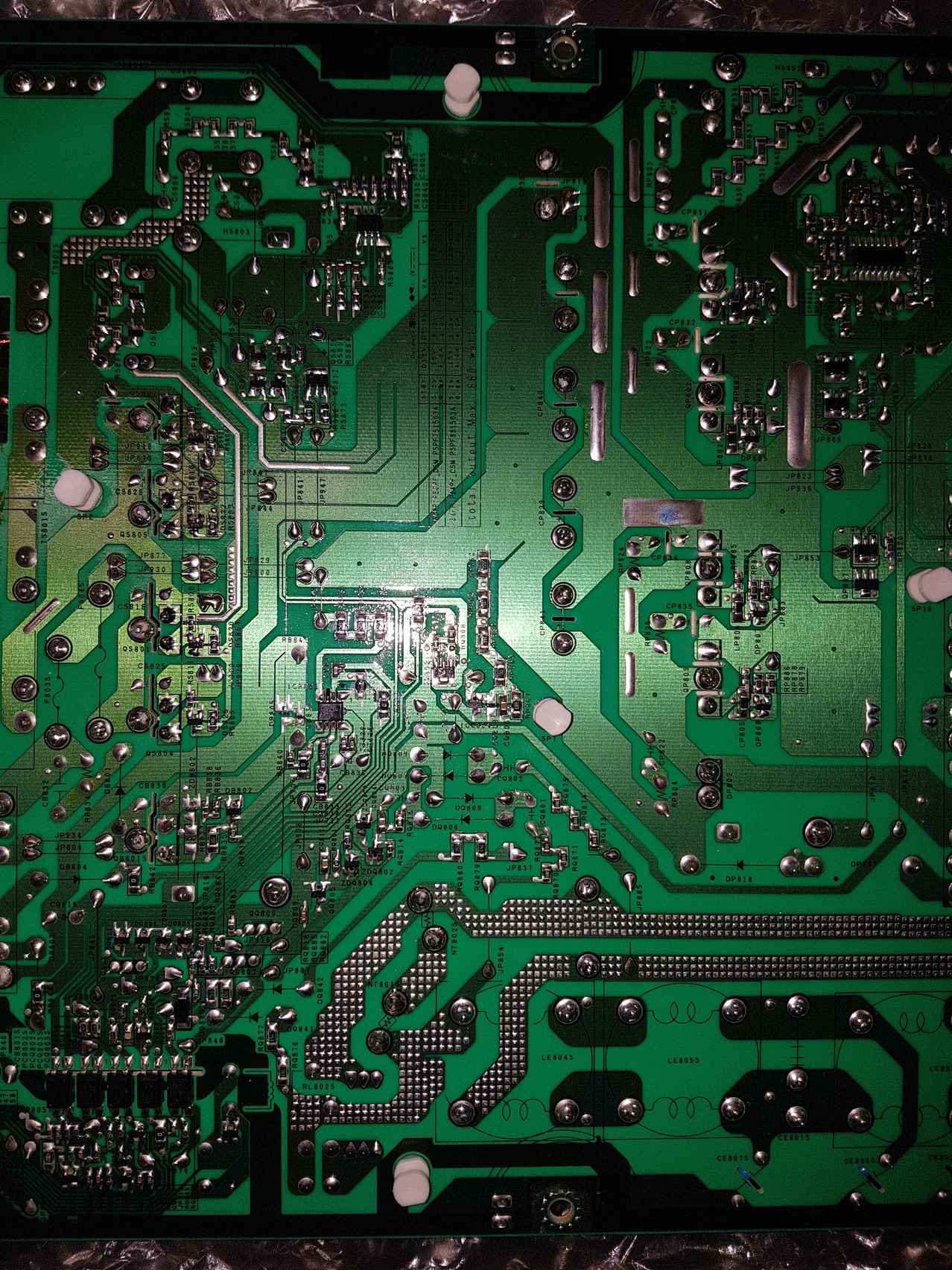

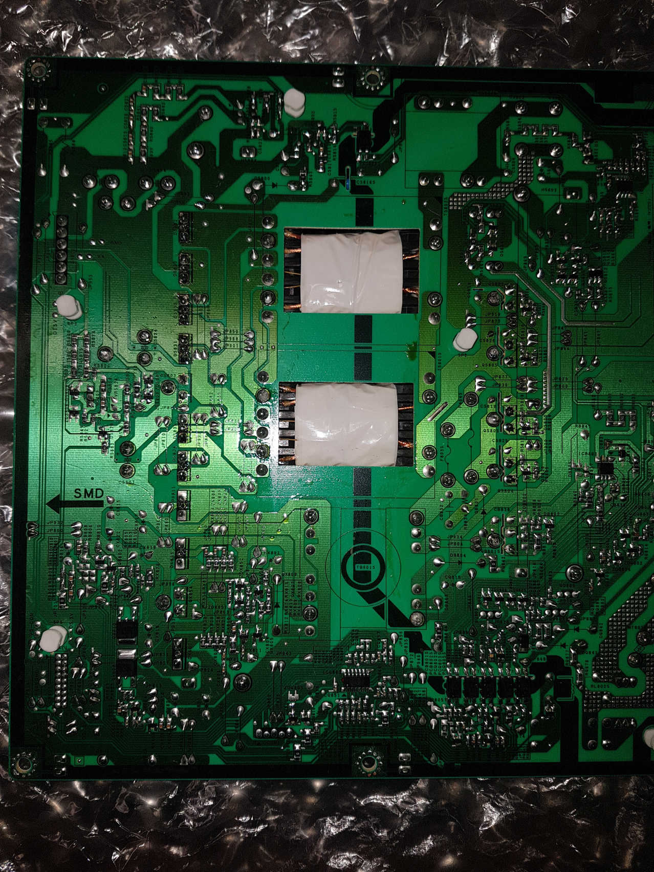

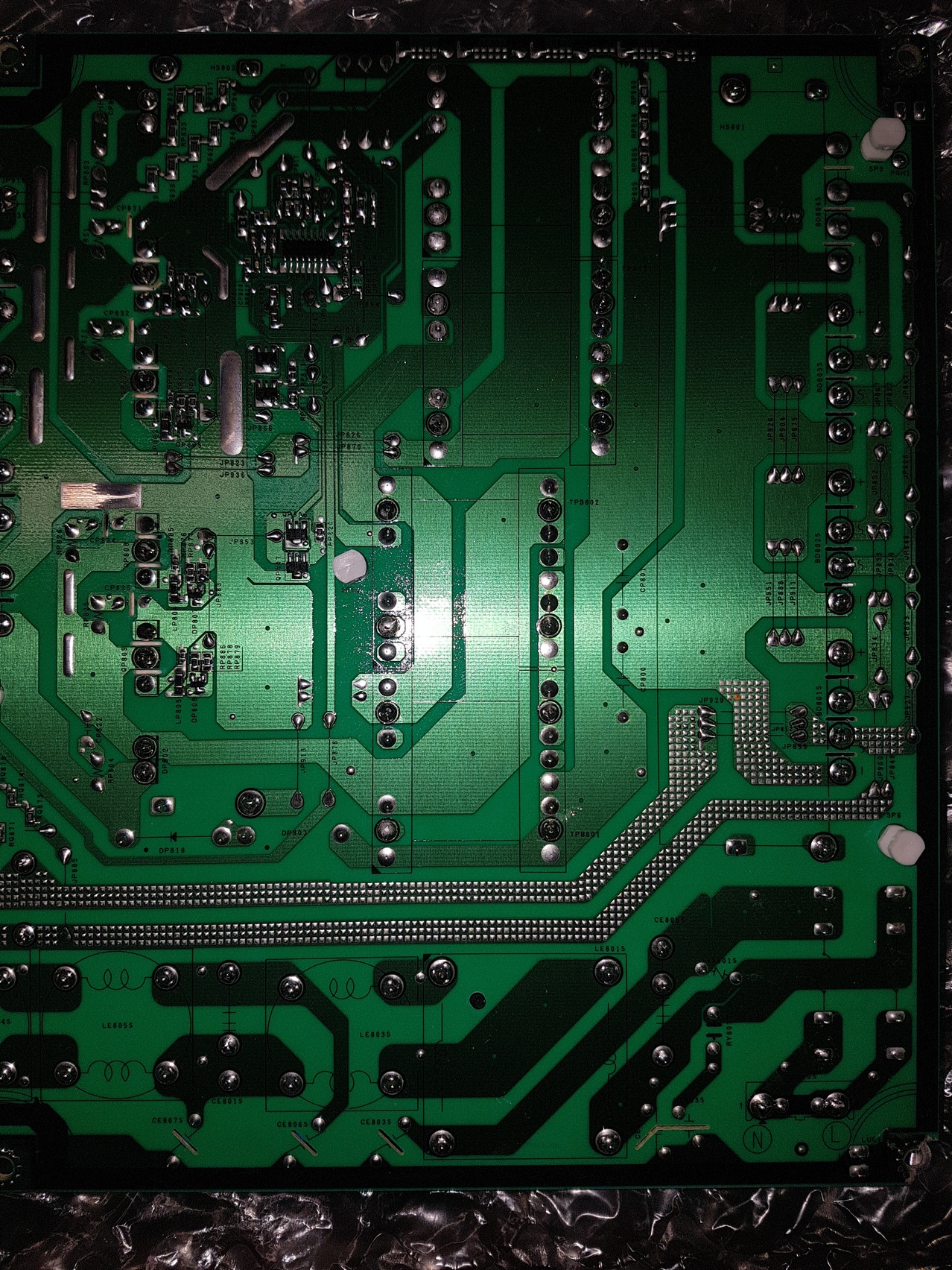

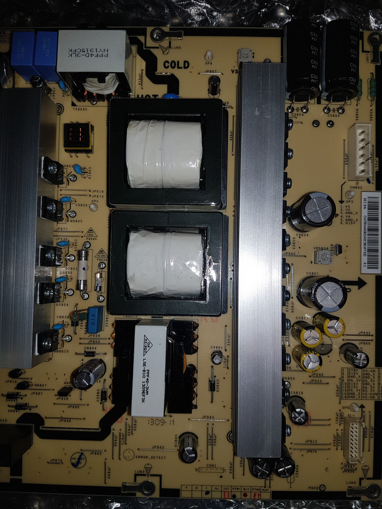

                                I've never uploaded pictures before, so this is my first go with resizing etc. I can take better pictures tomorrow in natural light.
                                I realize the bottom lug is damaged... I'll own up to that but it's just the corner of the PS.
