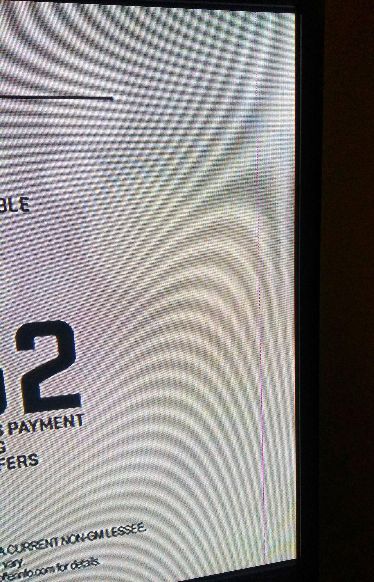

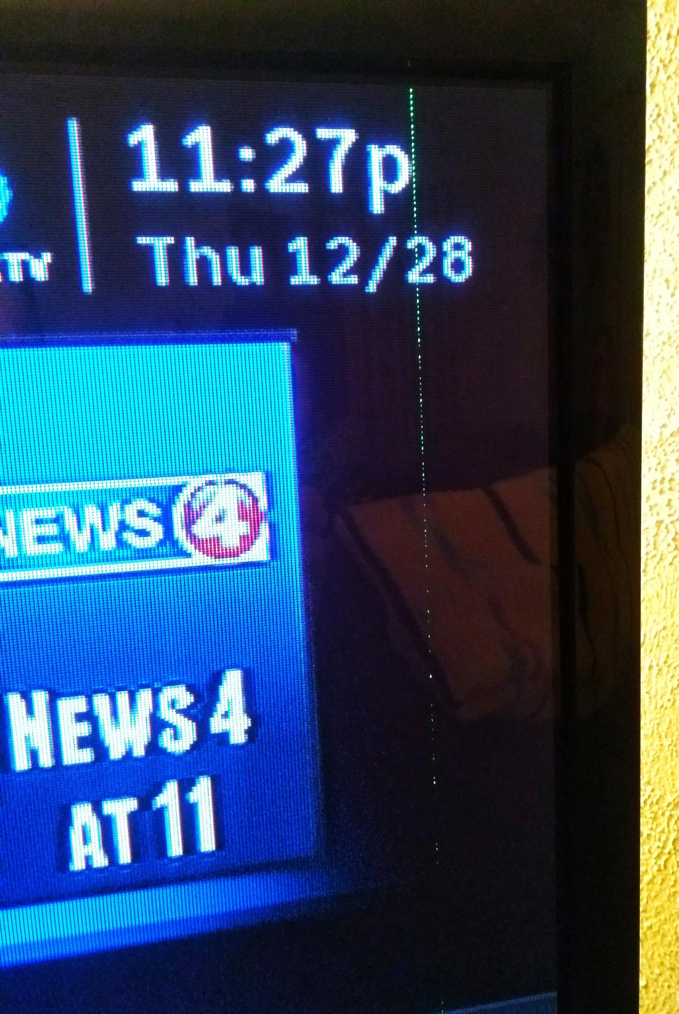

              I ended up buying this kit from ShopJimmy, which has all the boards and began swapping them in order of suspected damage.
              When I swapped the main board I finally got power and could hear the turn-on melody but had no picture. I then swapped the control board and finally got a picture but it has a broken vertical line of pixels at the right end of the display the appear green on a black background and purple against a white background. I've attached photos.
              I tried swapping the Y scan drive to fix that but when I do I get no picture at all (even with multiple attempts to seat it and the ribbons) so I suspect I have one that's DOA from ShopJimmy.
              For kicks I also swapped the X/Y Main and X Buffer boards but those didn't make a difference; I didn't bother swapping the power supply as that seems fine.
              But those aside, from what I'm reading this pixel problem seems more of an issue with the panel itself or even something in those ribbons than with any of the boards. Does anyone here know for sure?

                Re: Samsung PN51E450A1FXZA won't turn on, no standby light
                That is Not repairable. That is a problem with the chip film ribbon drivers on the bottom of the plasma display panel
