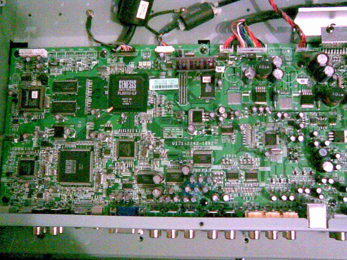

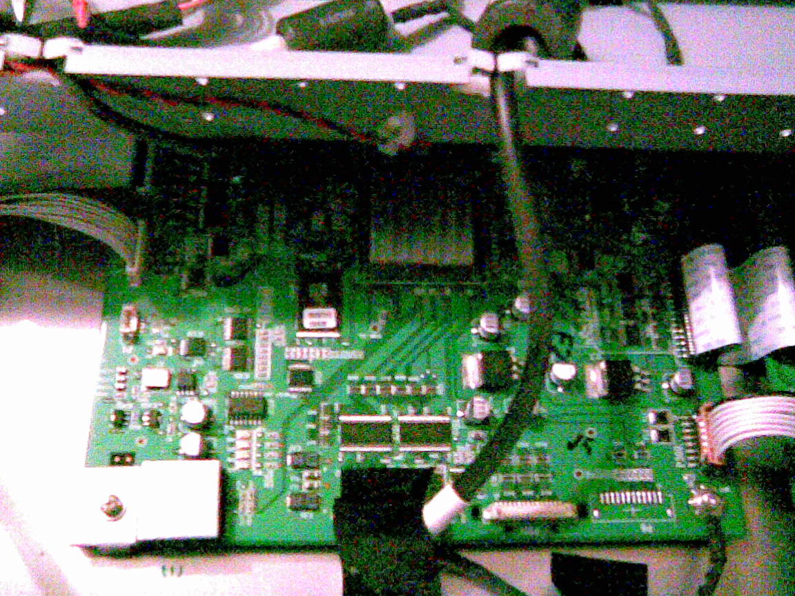

    I'm posting this for one of my neighbors who has a defective Plasma TV Vizio model# P50HDM
    The problem is that you turn on the TV, there would be sound, but screen stays dark, there are distorted images but once again, hard to tell since there are no backlight. Has anyone ever encounter this problem before that can tell me which parts are bad? It's a expensive TV and quite a waste to just trash the unit.
    I've opened up the unit and all the caps looks ok (no bulging), there are surface mount electrolytic capacitors on some of the boards so I don't really know if that were the problem or something else. Any help is greatly appreciated.

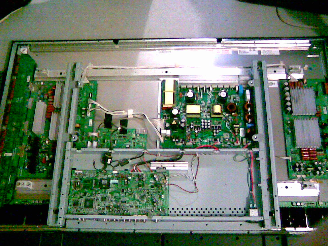

    Measure all the 4 voltages for the panel, be careful! (It is on the sticker) They are high voltage and high current. Measure the voltages on the power supply outputs.
    This looks like Samsung panel.

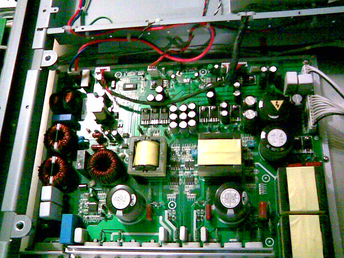

            If it hasn't already been disposed of, I'd bet on the inverter or the fluorescent backlights being non-functional. The third image - with the 4 toroids and 4 transformers is the inverter. It makes A/C into hi-volt DC, and sends it off to the lamps. Many times the transformers go bad, or the caps go leaky and cause the dark screen symptom. You can test or try to find replacement inverters (may not even be the same brand, generics can be made to work if they have the right amps/volts needed, and you can hide your frankenstein work behind the cover...).
