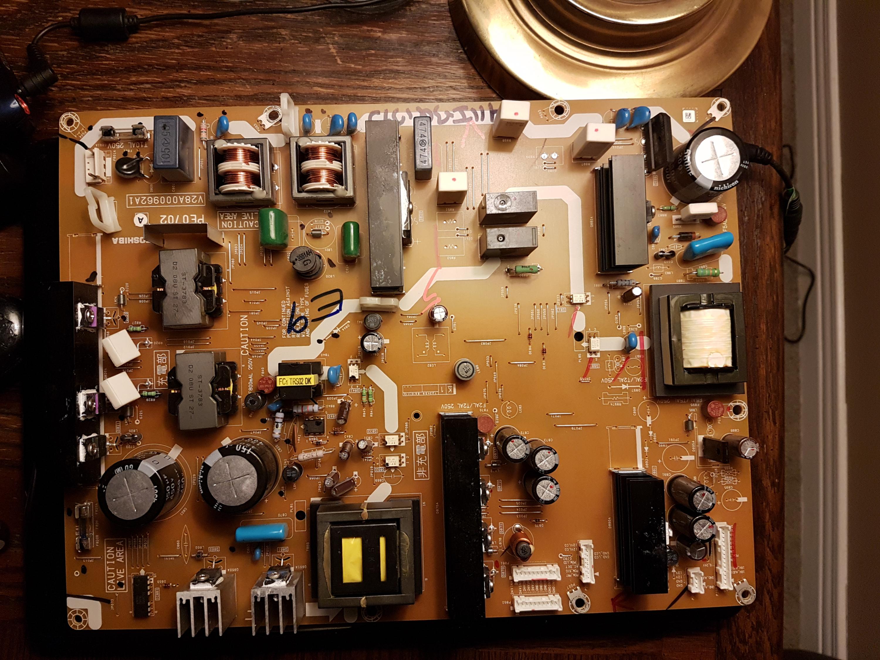

    Toshiba 55ZV650U
    Troubleshooting my brothers set. So far I have visual sign of blown cap at location C820, C821 looks like it may be going to blow. I know I'm not suppose to read uf while connected, but they both read 280uf (rated 450v 150uf) Next I have open R850 low resistance fuse? R897 and R898 both give 1.2ohms and seem to be ok. Given my limited knowledge, but after reading numerous threads, would I be safe to order and replace those parts only. Or should I also order and replace the Q880 voltage regulator to be safe?

    I think up load good clear pictures of your whole top and bottom side of the board will be a good starting point.

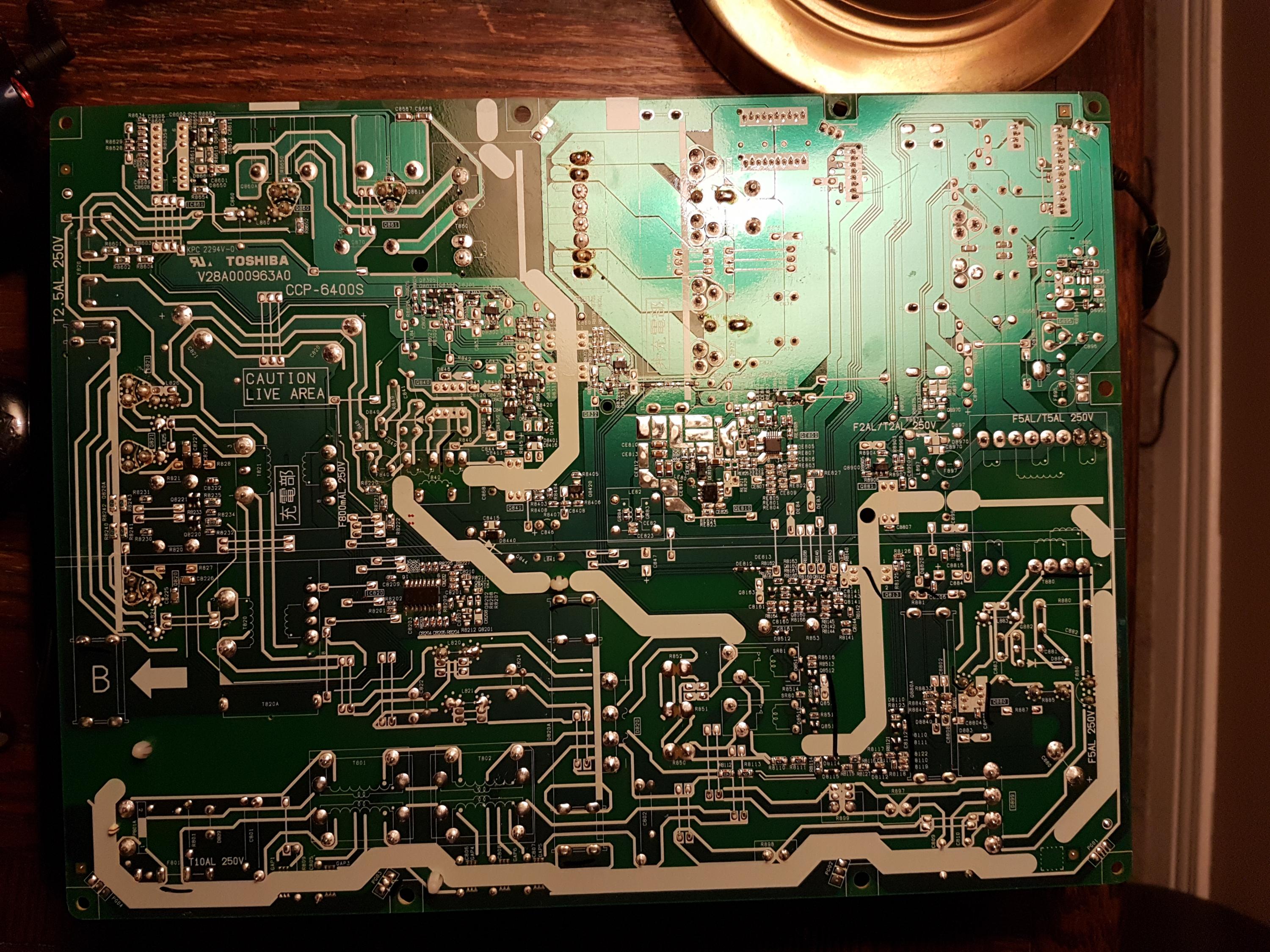

      Re: Toshiba 55ZV650U
      The board is a PE0702A fairly common along a series of sets from my reading. I'm only having trouble finding the voltage regulator given the numbers on the chip with mouser or digikey. Does anyone know if its one of the IC's that come with the SJ kit? Other than that, the LARGE caps 450v 150uf are approx 30x27mm, with a 15mm lead spacing. All I can find is a 10mm lead spacing, so hopefully that will work?
      See attached pics.
        PCB P/N PE0702A is the part number of a blank PCB, that blank PCB can be stuffed to make more than one PCBA (PCB ASSEMBLY) as needed for particular TV model as you can see here:
        http://www.shopjimmy.com/catalogsear...ult/?q=PE0702A
        R850 inrush current limitter will go open circuit if the bypass relay SR81 is bad due to not being turned or or burn out contacts, very common failure.
        ALL the red round fuses are good? you need to have that R850 replaced otherwise there will be no AC feeding the bridge DB820 to run the circuit in standby mode.
        You should remove at least one of those big cap and test if off the board first.
